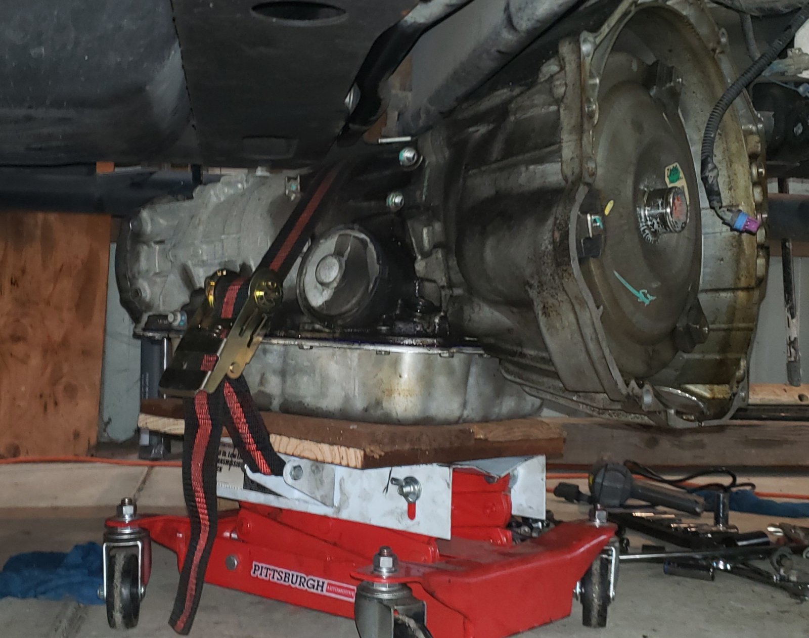

I use a scissor lift transmission jack, works pretty slick . Here it is below on a 4l65e I pulled out of a Hummer H2.
They're available online for right around $100. Works great on the front differential as well. It was just under $100 at harbor freight couple years ago.

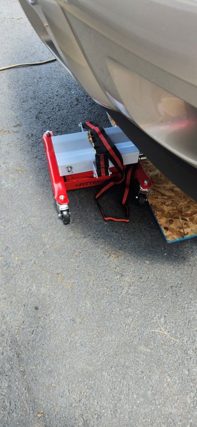

Fresh out of the box!
