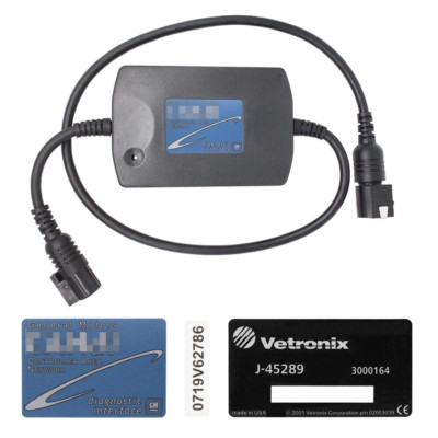

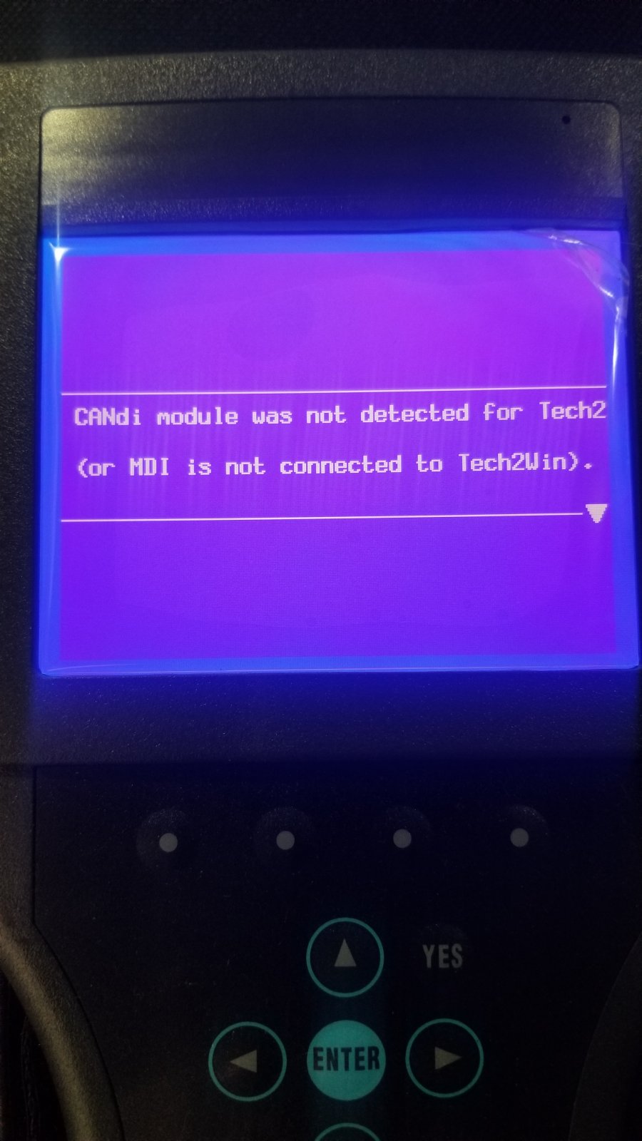

what is the problem you are having with the tech2?

I connected everything up with and without the candi module and it won't read anything from the vehicle. When I run the test on the module, I can hear it click a few times, but the light on the module never stays solid. I get the message on the attached pic even though I can see it's interfacing with it (clicks, light changes)
It's also possible that I'm doing something wrong. I've been following videos online to get it connected.

probably easiest method if the seller is not working with you is to just try another candi module

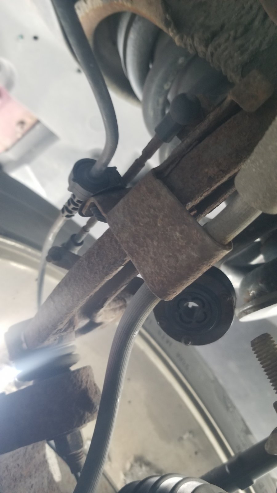

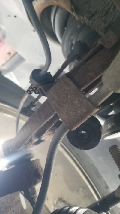

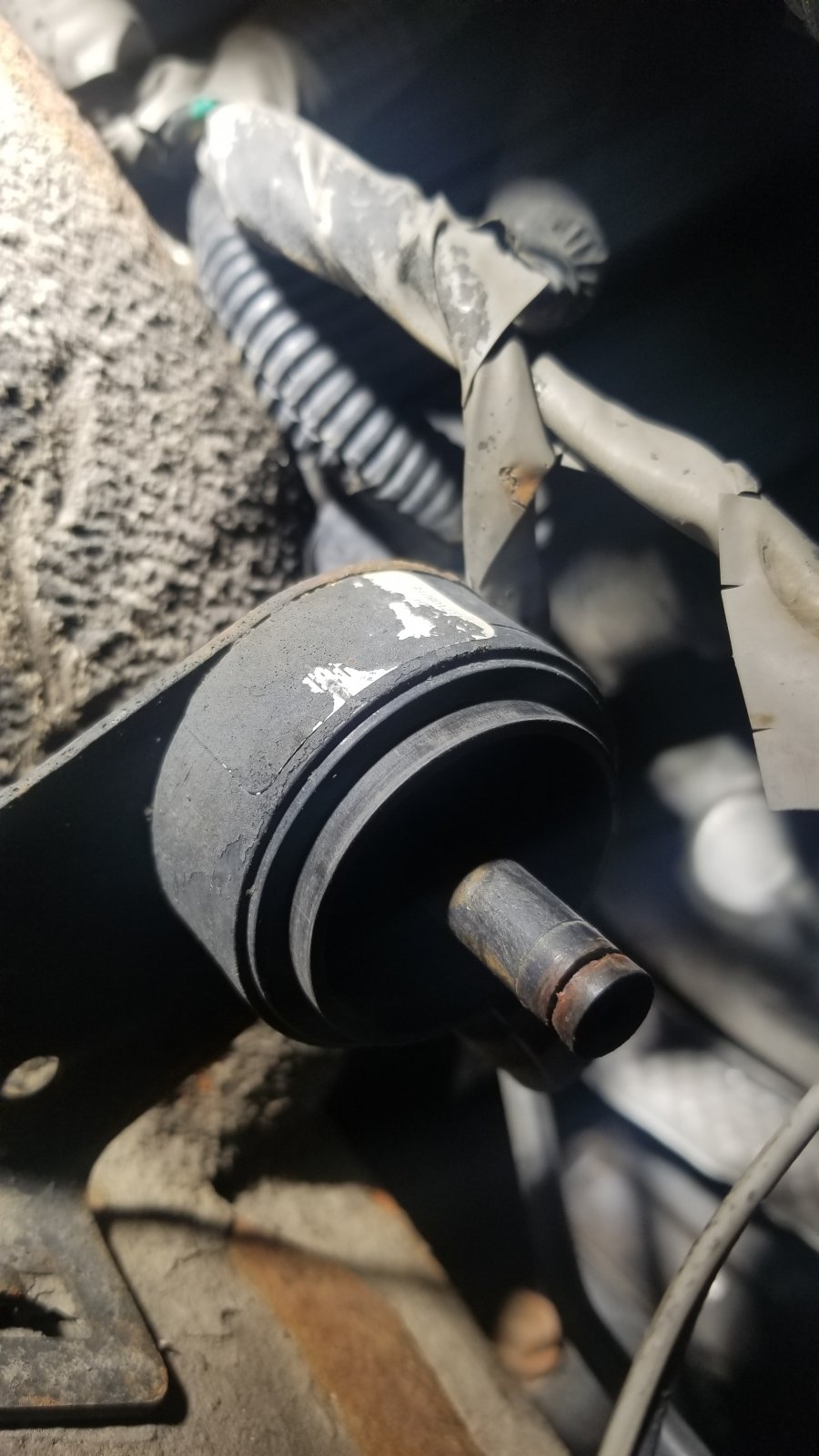

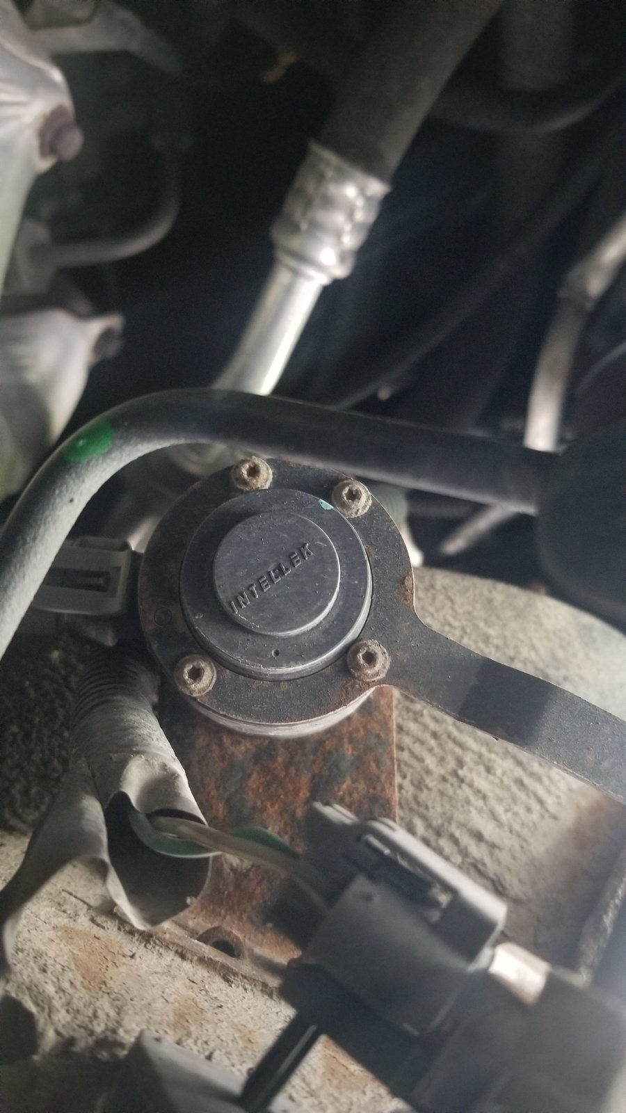

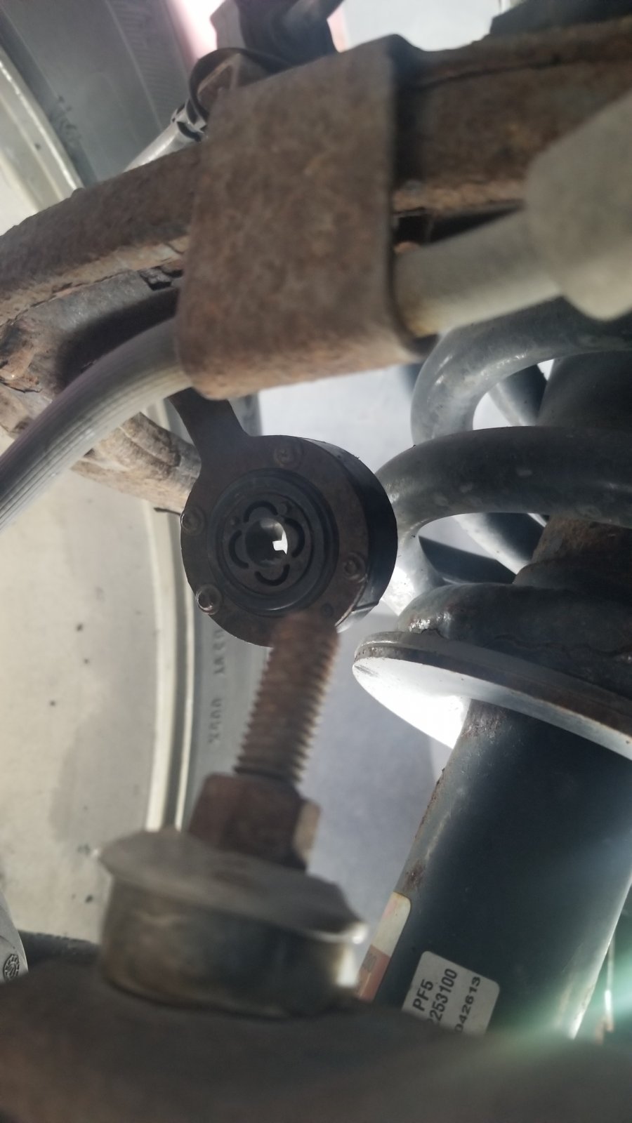

Hey Everyone,
Found a new issue today when going under to do an oil change. This is on driver's side. Pics attached of driver's side where it's no longer connected properly and on the passenger side where it all looks good.
1. What is it?
2. Is it just that cap in the center that holds it all in?
3. Anyone know a part number?
Thanks again!

I literally Googled the name I'm the cover and I still don't know what that is lol.

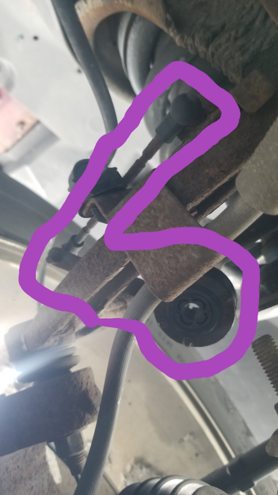

It's this entire part and just looks like it fell off the post it's supposed to sit on (also pictured) in my previous post. I think it's just that clip that fell off that needs to be replaced (the Intellek cover/clip).

hopefully someone else knows, I don't think I have anything like that on mine?
something aftermarket? can you tell what it's meant to do?
I'm going to take a closer look at it and see if I can get some better pics and describe it better. It's definitely not aftermarket. I'm the original owner of the truck and only started tinkering with it last year when I found you guys here.

oh wait.. is that what the ride height sensor arm mounts to?
if so, yeah I'm guessing it just popped off but you'd thing it would he throwing codes or atleast driving weird over bumps.
interesting.

Yup! That's exactly what it is. I took a bunch more pictures, but you found it! Thanks so much for taking a look at this.
The only thing I've been getting very intermittently is a service suspension system that will just come on every now and then.
I'm wondering if this could cause that?
