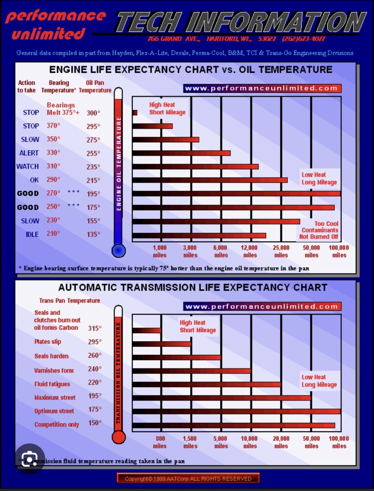

I always liked these graphs…sorta sticks in the head
when you are done with your trip i would automatically change both fluids… engine oil and trans fluid. Or….if you are staying in one place for a while you can always have it done prior to returning home, then again when you get home, If you are worried. i believe finishing the trip and changing when home is fine. Id rather have fresh fluids than swapping a transmission.

I always liked these graphs…sorta sticks in the head View attachment 490188when you are done with your trip i would automatically change both fluids… engine oil and trans fluid. Or….if you are staying in one place for a while you can always have it done prior to returning home, then again when you get home, If you are worried. i believe finishing the trip and changing when home is fine. Id rather have fresh fluids than swapping a transmission.
Thanks for the charts. It should be cooler and generally downhill on the way home. Yes, will change fluids. Can you add an aftermarket oil temp pressure gauge? And I have heard that maybe GMc/ Chevy engine temp gauges are not the most accurate. Can you add a more accurate aftermarket temp gauge? Thanks!
