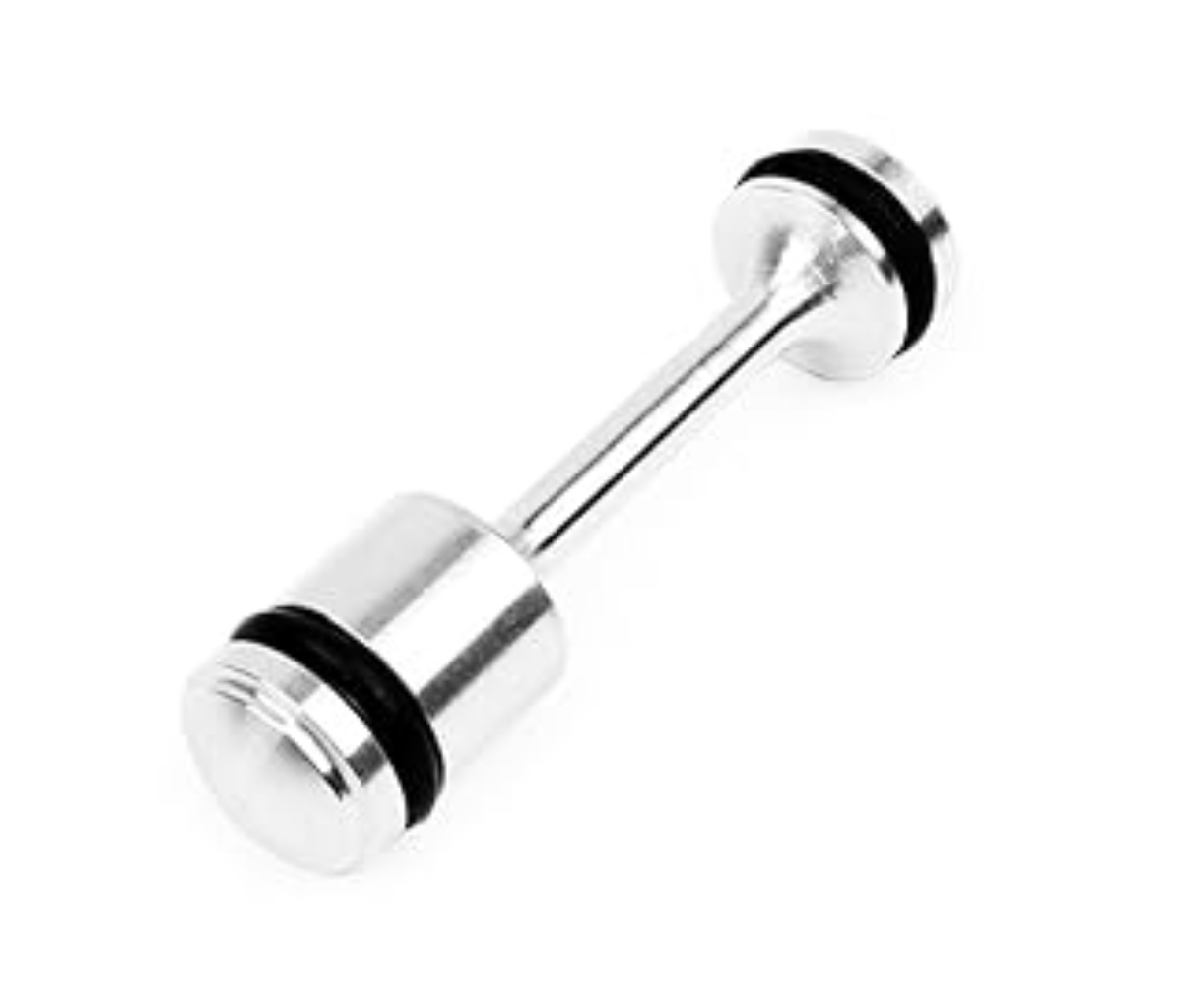

Ok, I'm getting ready for my next big investments in getting a long life out of the truck.
I think I found a shop with good reviews and had a quick discussion with them today - they seemed to be very familiar with the 6L80 and immediately mentioned the billet TC, so they are somewhat familiar with things. I'm going to head there next week and kick the tires a little bit. I've also been getting some tips from @NickTransmissions!
I also have main seal, oil galley dog bone, ARP exhaust manifold bolts? Anything else I should get done while it's at the shop?
