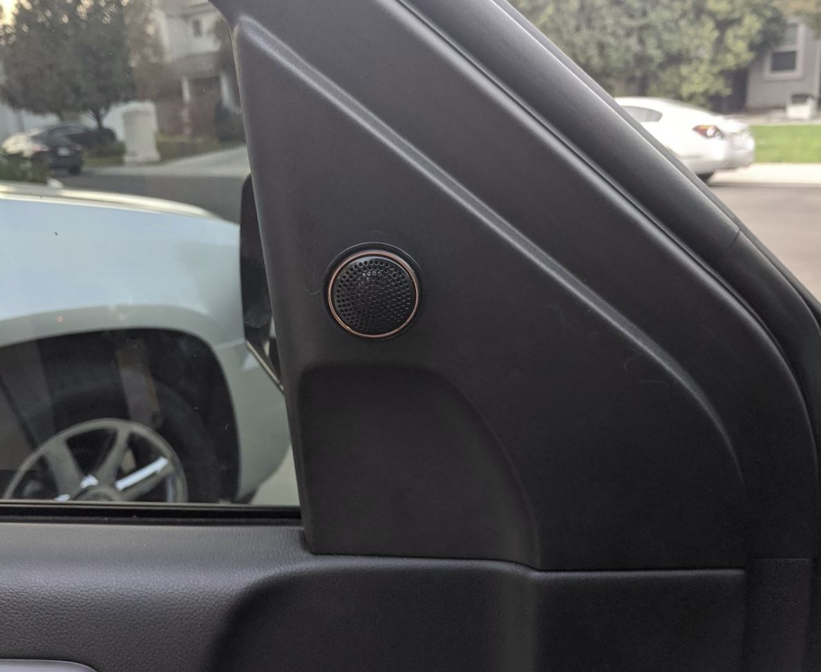

you might have a tough time running the crossover wire up to the tweeter, I believe there is a block connector on the inside of the body behind the rubber boot.
so I wouod mount the tweeters on the triangle plastic cover where the mirror access bolts are like I did on my silverado, then it makes it super easy
That's an awesome look!
I just bought a base blocker and planning to tuck it into the a-pillar, but that looks great! You running kappa's as well?
yes, but I need to upgrade the door speakers I have been running too much power to them so they are about done, tweeters seem to be able to handle it fine

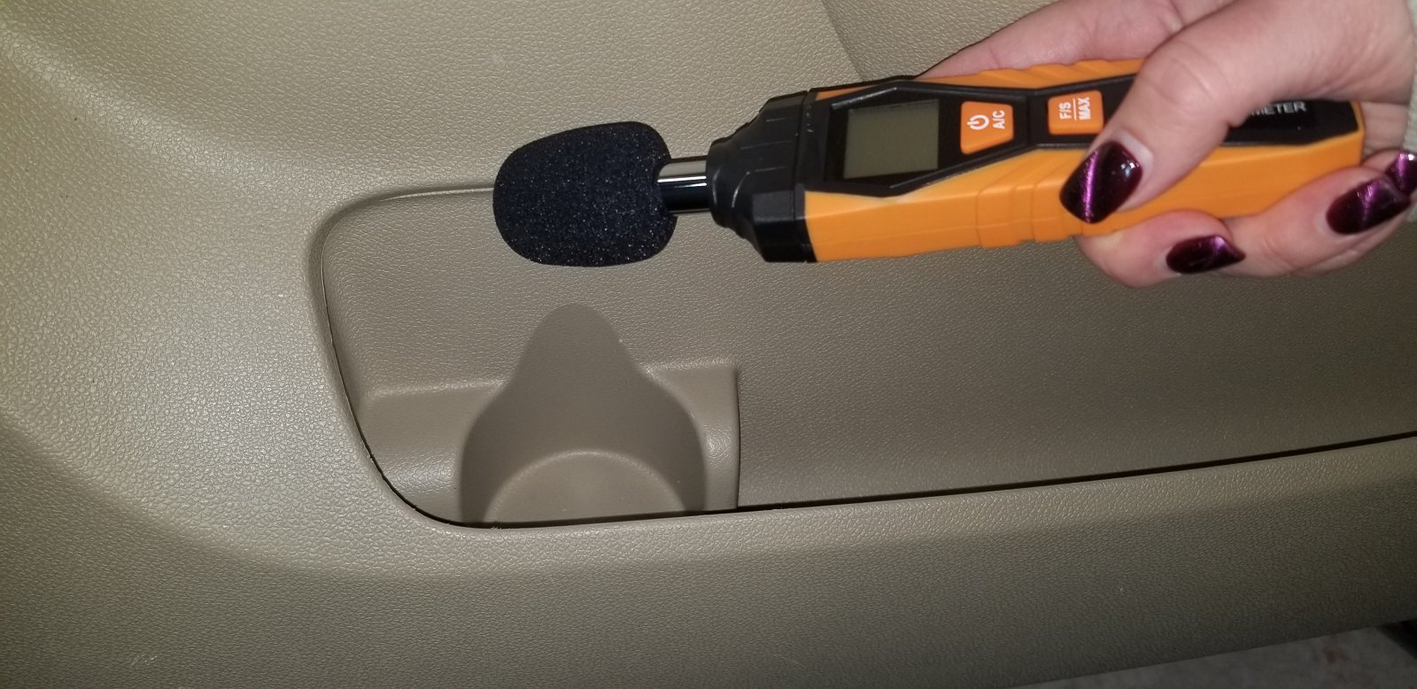

This was not very scientific, so take it with a grain of salt. But when checking the dB levels at each of the front doors - driver's side deadened (72-74 dB) and the passenger side as from the factory (77-78 dB) there seemed to be a 4-5 dB difference when on the freeway at 75 mph.
We checked one point consistently right above the cup holder.
I'm a little surprised it was that much difference....like really surprised - it seems like a lot. It will be interesting when we finish deadening the passenger door and see if we get a similarly reduced reading.
The middle of the vehicle above the center console was around 70 dB.
-10dB is perceived by the human ear as half as loud. 45% of that is significant.
There are free phone apps for measuring dB. I use Decibel X. I can't say how accurate they are compared to actual test equipment. But for comparison, they should be fine. I'd like to know how an app compares to your device.

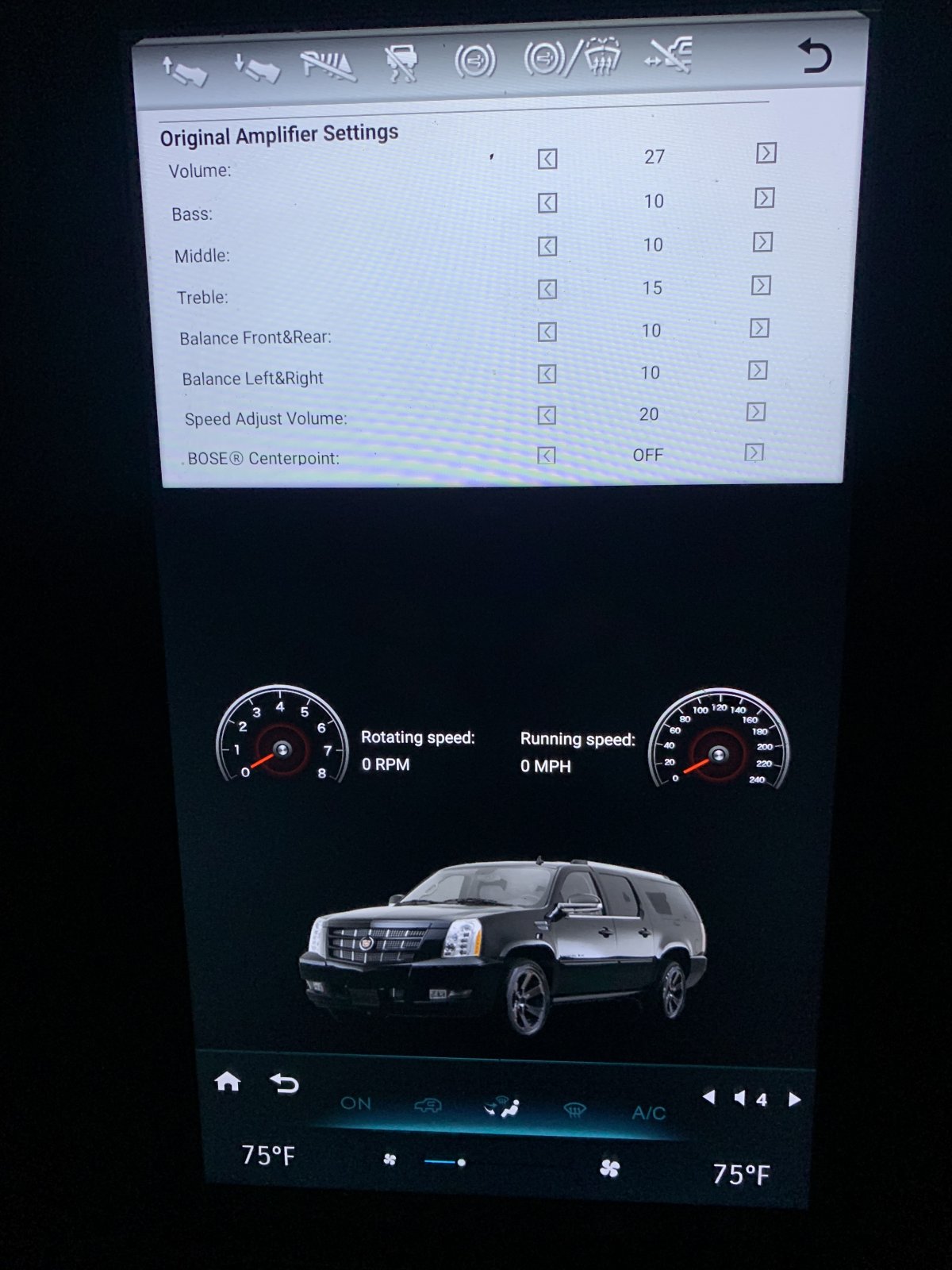

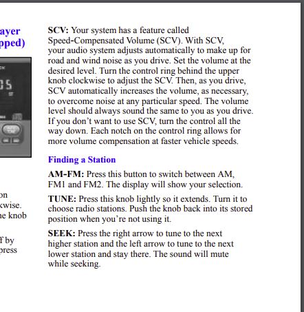

I wonder if your android is really disabling it or not, the bose system is digital. even with the maestro rr messing with it is tricky.
does your android head unit have dsp settings? does it support bose fade?
The head unit uses the canbus network. The pictures the main audio settings tab on the head unit. That last option doesn’t seem to do anything nor does the speed adjust.
30,576
48,070
I thought that’s what the speed adjust volume was. I don’t remember seeing anything about it on the OEM unit?
that is automatic volume with speed, so as you are driving it automatically adjusts the volume up/down to compensate for outside noise, that's not anc
anc listens to the sound waves and generates a negative sound to reduce it
automatic volume has been around for a long time, it's in the manual for obs, nbs, nnbs

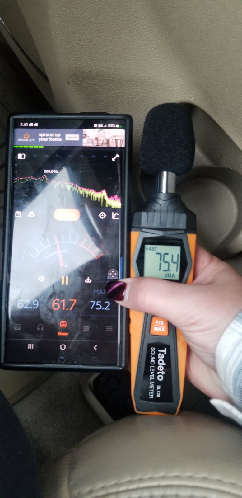

Finally finished the passenger door sound deadening and the dB measurement went from 77-78 dB to 74-75 dB. Not quite as quiet as the driver side door (72-73 dB), but definitely shows improvement!
Dropped in the Infinity Kappa speakers in the a-pillar tweeter locations and the front doors and it is incredible how much improvement there is. I don't know how much is the new speakers vs including the sound deadening, but it is a huge difference.
@iamdub - see pic here of the difference between decibelX phone app vs the decibel meter - pretty big difference. The phone is my wife's galaxy S24 ultra, so it's pretty new sound hardware (I know you apple guys will be slamming that)!
Much bigger difference than I was hoping for. But, it still might not be irrelevant info. Like, if you had tested it before with the phone and it still showed the same 3-4 dB change. Thanks for the comparison! I'll be sure to do a before and after when I do mine. I'm just gonna use the phone app and have as few of variables as possible. I'll pick the same testing locations (parked and driving), phone locations and angles, weather conditions, etc.
Oh, and I'll be using an iPhone so the data will likely be more factual! :p
