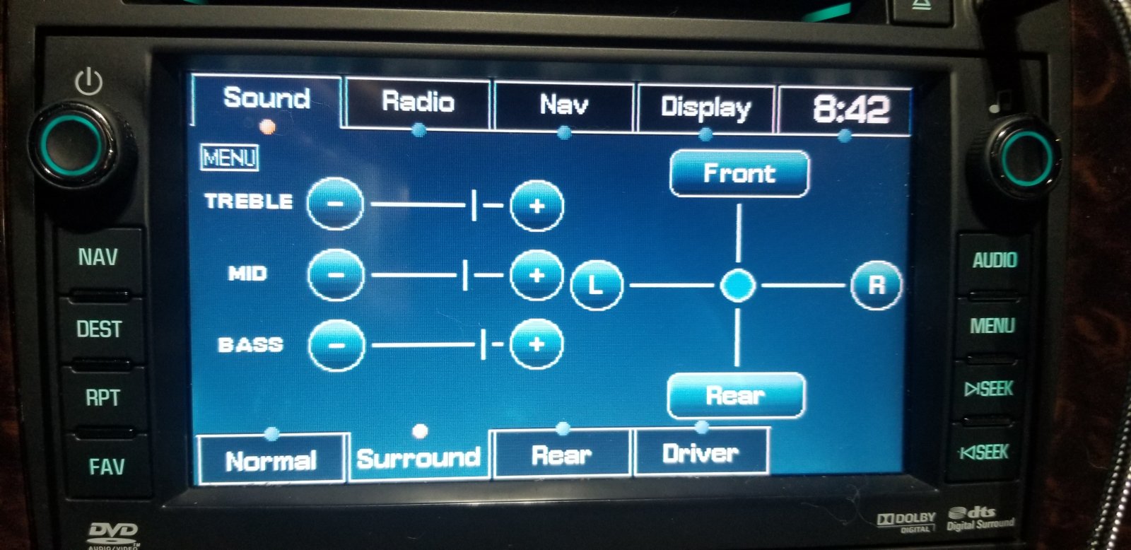

So, mechanically, the truck was awesome. Had no problems making our first stop in Charlotte so the kids could see one of their friends.
But ran into an issue with our new 2nd row speakers. There's a little back story, so bear with me.
I just started wearing glasses for the first time last week, so I'm still getting used to them. We left around 4AM, so it was dark out for the next several hours. I decided to use the dimmer switch in the truck to turn down the brightness of the instrument panel, but in particular, the stereo head unit because they just seemed overly bright with my glasses. No problem - it worked fine.
This is completely an assumption on my part, but I believe that once it gets to a certain brightness outside, there must be an automatic override of the dimmer and it just goes to full brightness where you can no longer adjust it.
The reason I felt this way was because once it got bright out, I noticed that the head unit and dash immediately went to full brightness and I couldn't make any adjustments. At the exact moment this happened, I heard a loud click sound through the speakers, saw the brightness go full and the 2nd row speakers no longer worked - all simultaneously.
How could all of these be related and any thoughts on how to go about troubleshooting this? I know the easy thing may be to pull the speakers from the front row and plug them in the back, but would love your thoughts.
Here are the speakers at the 2nd row:
No problems with the component set of front speakers:
Everything worked great for the first 6 hours of the trip and because people were still sleeping, we didn't even have the volume very high.

underhood fuse box check fuses 41 & 42, drivers side dash fuse box check fuse 19
are the flip down screens working?
check that the rear entertainment is not set to video input, etc

Checked all of the fuses and the flip down screen and they all look good/work. Rear entertainment is not on video. Any other suggestions?
meh, not sure
if you have a dvd inserted in the head unit remove it, then put it on radio and then on the rear control cycle thru all the inputs and see if the speakers kick on. that's the only thing I know of that turns the rear speakers off is when there is a dvd playing and/or the rear is set to another input.

Ok, figured it out and it was the dumbest thing. Actually, my wife solved it.
We started playing a DVD that was in the head unit to check the pop down screen and then stopped it which brought her to this screen:
She then started randomly changing the bottom buttons from surround to rear, driver, normal and ended up at surround again and it all worked again - all speakers were functional.
How would something like this even happen (or be connected) with the sequence of events with the dimmer, the display brightness, click at the speaker - all while nobody had a hand on the head unit?
it happens, especially with the oem head unit, turning on a dvd cut's the rear speakers I guess so they can hear better with the headphones thru infrared
I would say something got loose for a second and the unit lost some settings. Had this happen when the kids drained the battery and when the positive cable was loose on a trip. Both times the screen went bright which set internal codes.
