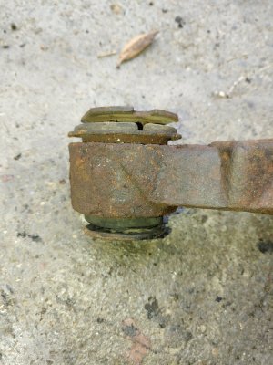

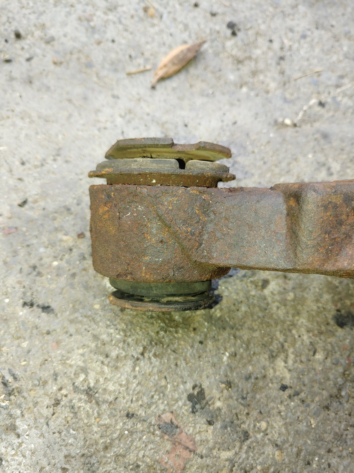

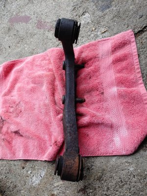

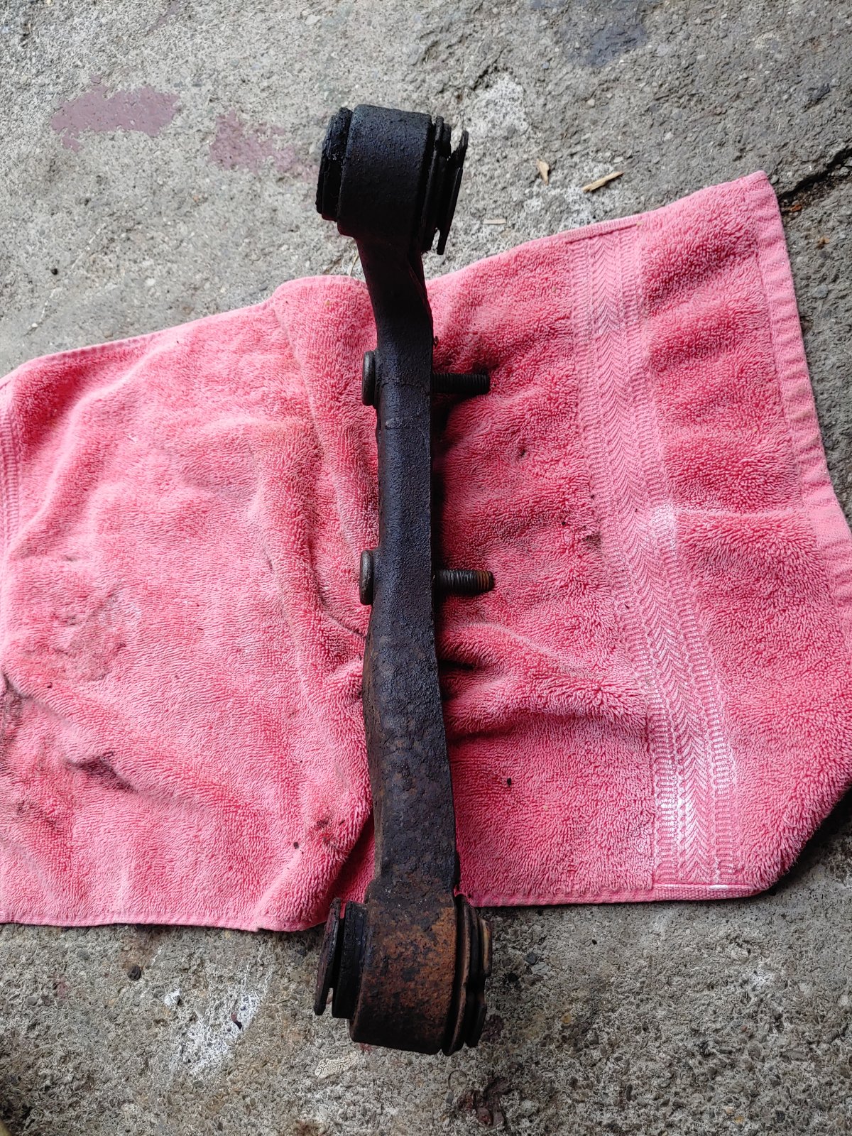

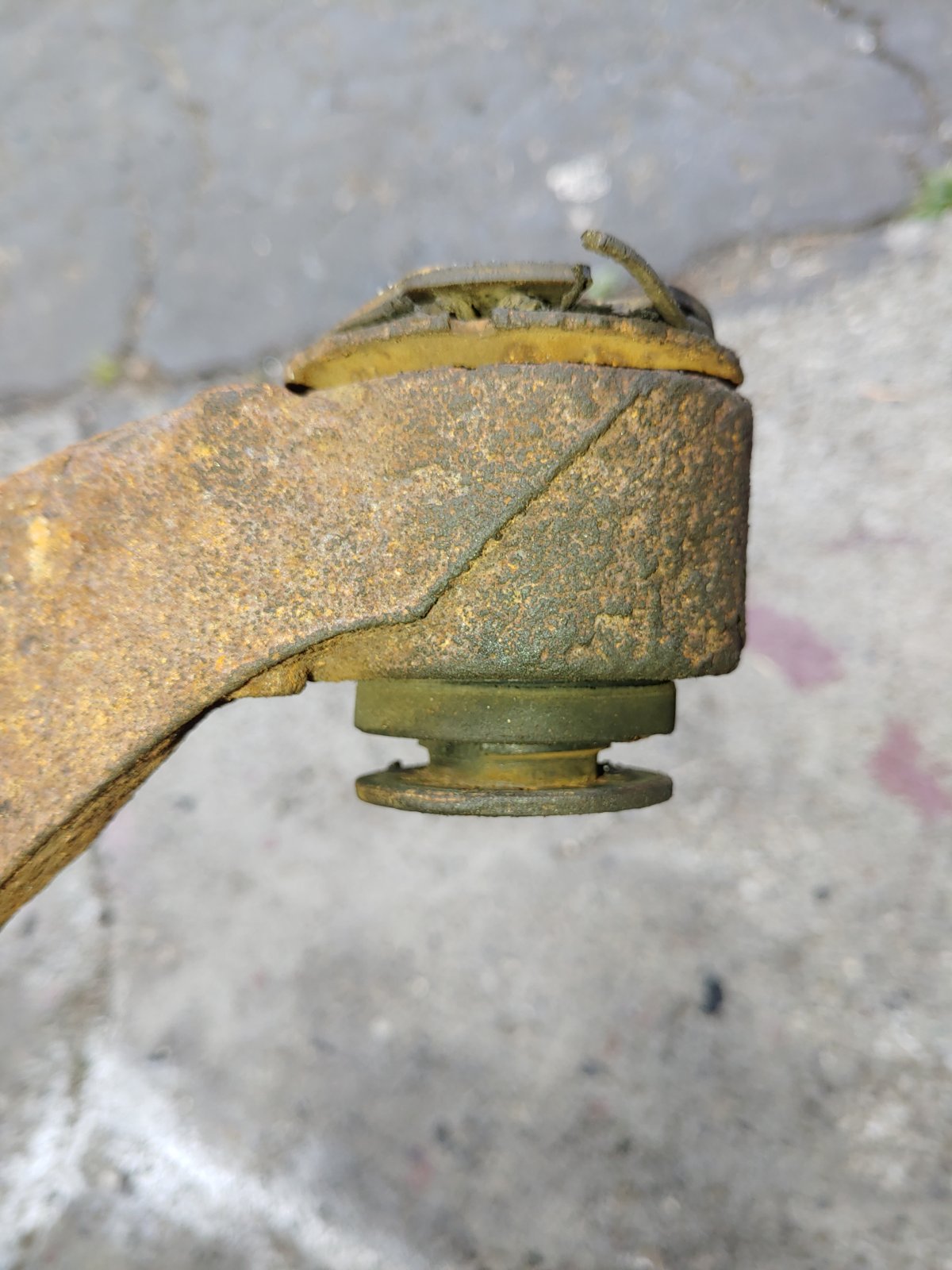

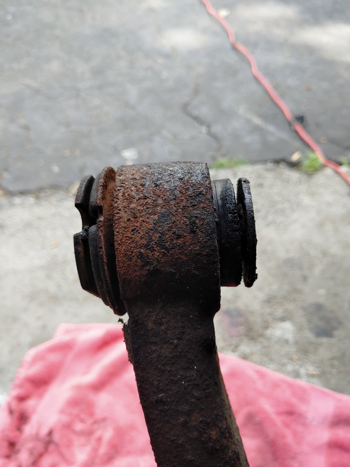

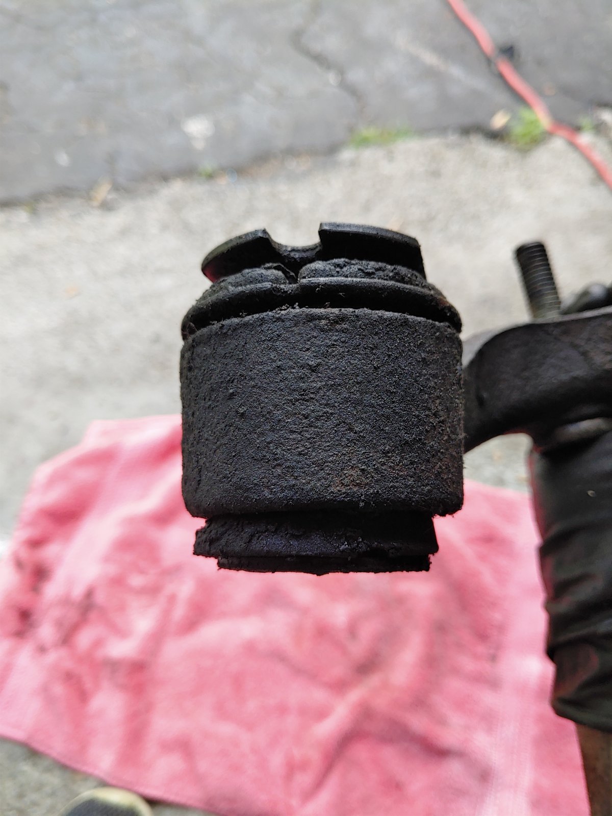

Went to replace bushings in the mounts of my 08 Yukon XL Denali, after messing with the bushing for 5 minutes in 90 degree heat and seeing the rust on the mounts I said no, and placed order through RockAuto for both new mounts with bushings to be delivered tomorrow. Ground was $7 and overnight was $16. Will update once I get new mounts in. There are the original mounts with 225K miles on them. I had developed a clunk and after recently replacing all front suspension items I figured I'd do these next. Will see if it solves it and if not...at least I have new mounts lol.

Overall 1.5 hours to remove.
Hardest part was getting my 16mm flex head ratchet wrench onto the four bolt heads holding the mounts in. The front passenger side I went through opening hear wheel well, front driver side I went down through engine bay, it's beneath steering shaft. Other two back bolts I was able to get at fr beneath vehicle. Maybe a socket and ratchet would be easier, I shockingly just found out I don't have one that size.
Both mounts were same price, $75.79 for AC Delco and then I got 5% off that. Part numbers are 23104736 for the driver side and 23104735 for passenger side. Again, these are for AWD on 08 Yukon XL Denali.

Installed the new mounts today, about 40 minutes to put both mounts on and then mount up the differential on both sides.
Took it for a ride and clunk I had is gone completely. To best explain it, intermittently when I'd get on it I'd get this clunk. Didn't matter if 15 mph or 75. If I'd give it some gas to pass someone on highway or push down on pedal to go up a hill it would happen. Sometimes I'd get it when braking hard to a complete stop, like if I was going 40 and came up to a light that changed to red quickly. As the vehicle would rock back from the full stop I'd hear the clunk. It makes sense to me now after seeing condition of old mounts and how they hold the differential, when giving gas or the sudden deceleration to a stop causes movement with the rubber bushings shot it was metal on metal and therefore clunk.
