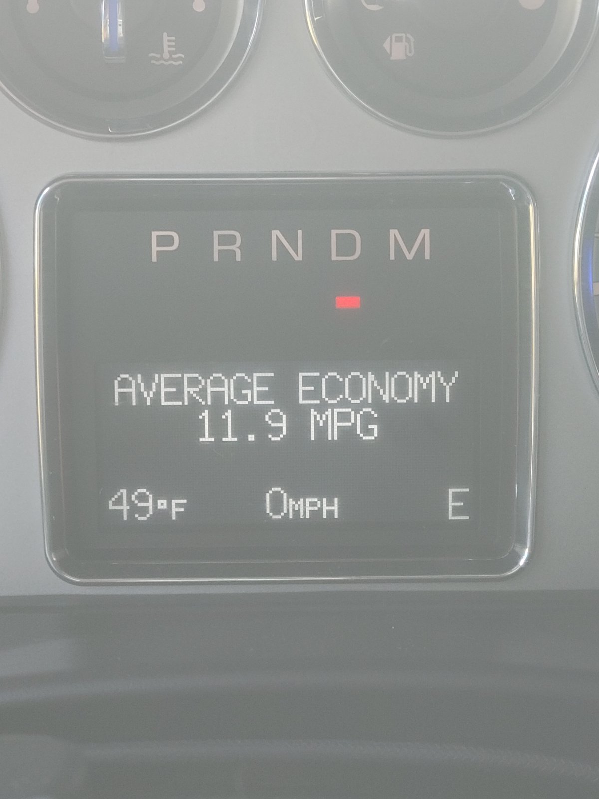

My current average

When was the last time you reset that?
You still need to do the old school calculation as the dash uses information from the sending unit. If the sending unit is off, the dash calculation can be off.
Fill tank (stop at first click of pump), note starting mileage on odometer, drive until you need to refill, note ending mileage on odometer, fill tank (stop at first click of pump), note gallons pumped, divide miles traveled by gallons pumped.
