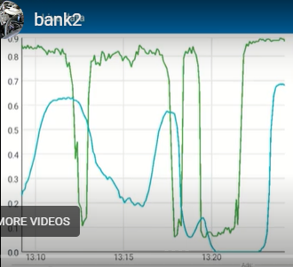

do you need to see o2 voltage for both banks or just bank 2?
mikez71
Mar 9, 2023
3,334
4,137
Both be better, but bank 2 more important.
You might reset code and see just how soon/when it pops up again.

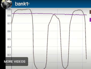

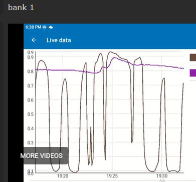

Graph at idle next, since it seems your trims move reasonably for driving around...

Nothing conclusive I can see..but..
Bank 2 peaks look noisy. Comparing to your bank 1 sensor which looks smoother always.
Since it doesn't happen for 2-3 days, its possible you haven't logged the worst of it..
Have heard these trucks can be picky about O2 sensors..

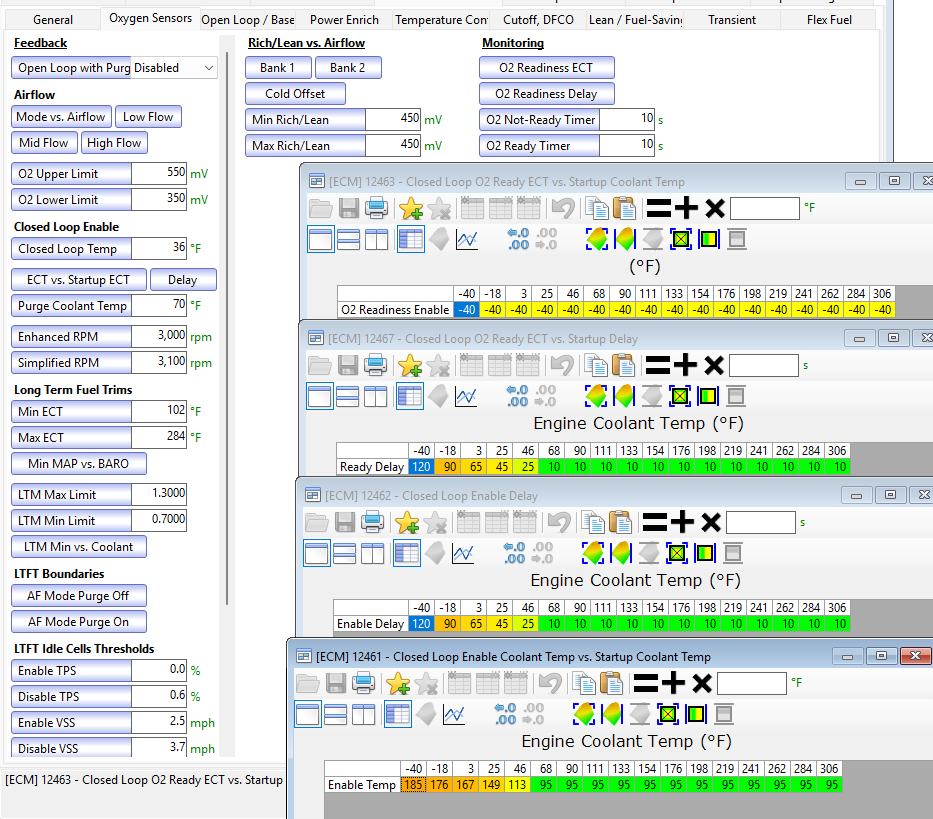

Closed loop has minimum temps, but the O2 readyness only needs -40deg and 120 seconds..
Looks like it's ready under a minute at freezing temps, 10 seconds if warm temps.
I'd say start logging after 10 seconds if ECT is 68deg or above.. Most likely when the ECM is doing it's O2 testing?

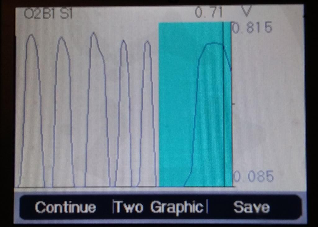

This picture is more typical of what you see in a pre cat sensor. Notice the line jumps from .085 to .815. It is consistent.

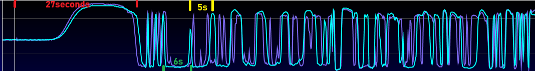

Sample of 1 (mine, most likely with 200k OEM sensors, no codes yet)
It's almost always less than 5 seconds for 1 oscillation.. mostly 3 seconds or less.
A few 10 and 15 second intervals, but I believe those were all coasting to a stop.
Your log had a couple 7 second intervals, but I don't know the conditions..
I see one cold startup of mine take 27 seconds for the first period.. (57degF ambient and ECT)
That would mean the O2 readyness wouldn't activate for ~17 seconds..
ECM should have seen 10 seconds for first interval.
Near start next longest interval is 6 seconds, then 5. Most are 3 seconds or less.
Another time ECT@145degF took 13 seconds for first period.. (45degF ambient)
ECM should see 3 second first interval.
ECT@115, ~16 seconds to warmup sensor
ECT@54, ~30 seconds to warmup sensor
Perhaps something over 10 seconds (after warmup), or multiple longer periods, or consecutively that triggers it?
ECM probably testing at idle or steady state cruise?
