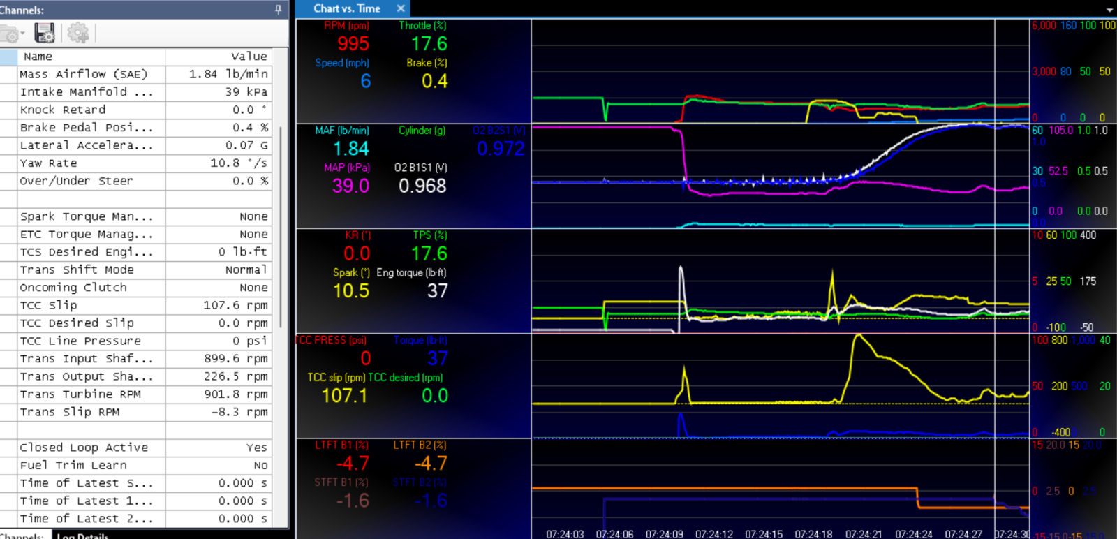

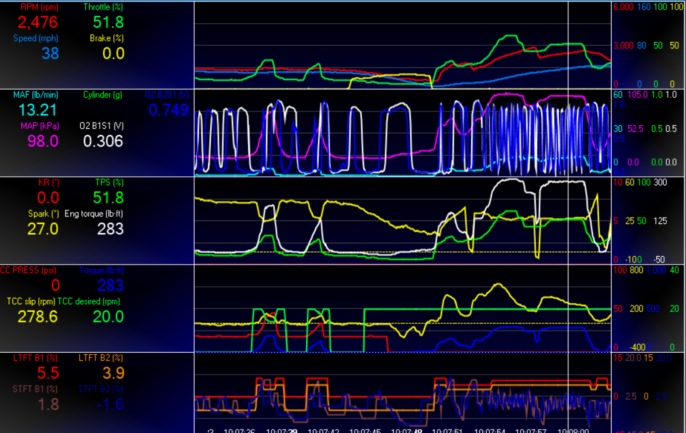

Tried this morning @West 1 !

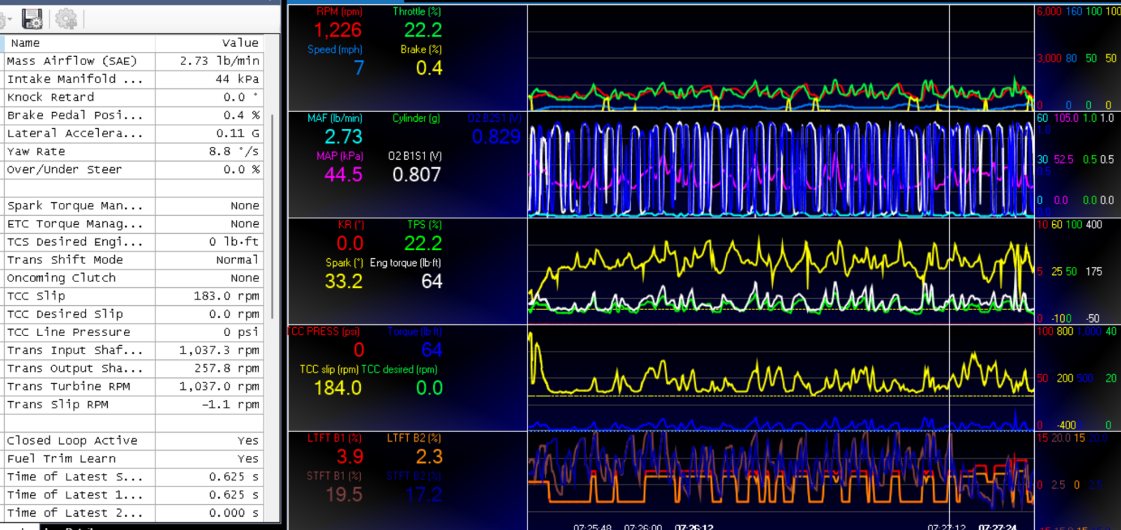

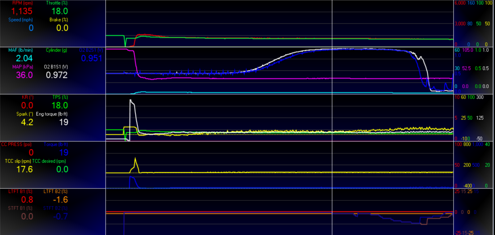

First a cold start, Short Term fuel trims start moving about 16 seconds in, ect was 56F.
Took about 28seconds before O2's oscillate normally..
I wouldn't have thought that manifold pressure would change enough to affect o2 readings.
But you're right of course, ECT 90F, MAP goes from 36kpa to 39pa, O2's peg lean.
second time just a few seconds later, ECT 95F, 32kpa to 39kpa while pumping brakes.
(Yellow squiggles is pedal position) STFT goes upto around +20! (after 10 -11 pumps)
WOT the o2s pegged rich of course.

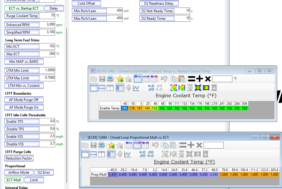

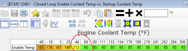

BUT if looking at the maps in tune, a startup coolant temp of 56degF should not activate closed loop until coolant reaches approx 105degF..
('08 has 102 instead of 95 in the table below, few other small changes between '08 vs '12)
(And I was at 90-95degF ECT during the brake pedal pump which came after the STFT's started showing..)
Perhaps a calibration period for the fuel trims, but I will log if closed loop or not next time to verify.
Maybe closed loop enables once the LTFT's start moving? (That short log ECT got to 99deg and no LTFT movement yet)

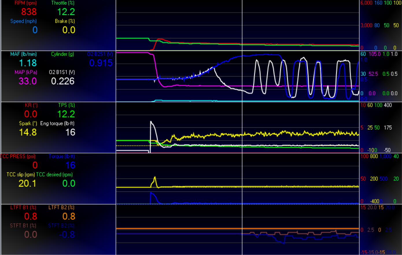

Another log, cold start ECT 129degF, LTFT start moving 17seconds after startup.
I think it could have moved earlier (10 seconds after startup) but I didn't touch the throttle (lightly) until 15 seconds after startup..
Despite being "long term" it can bump or dip in under 1 second..
Typically moving every few seconds while driving. (But doesn't move at idle)
Changes right along with throttle/MAP consistently...
It seems like smaller changes maybe based on STFT, but larger changes might take something else into consideration, like throttle input..
(STFT goes down, LTFT goes up, doesn't correlate directly, but LTFT matches throttle input)

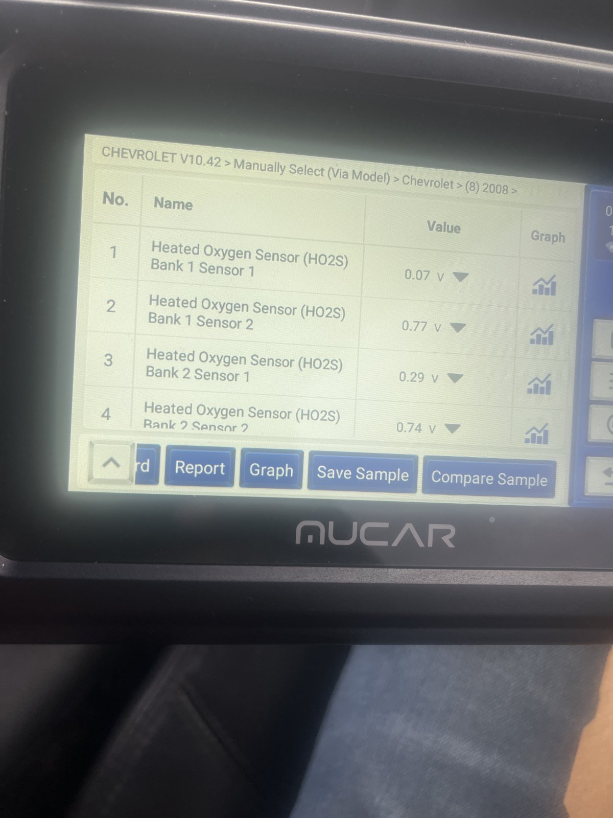

not yet. Im not sure I can do it with nucar or elm327

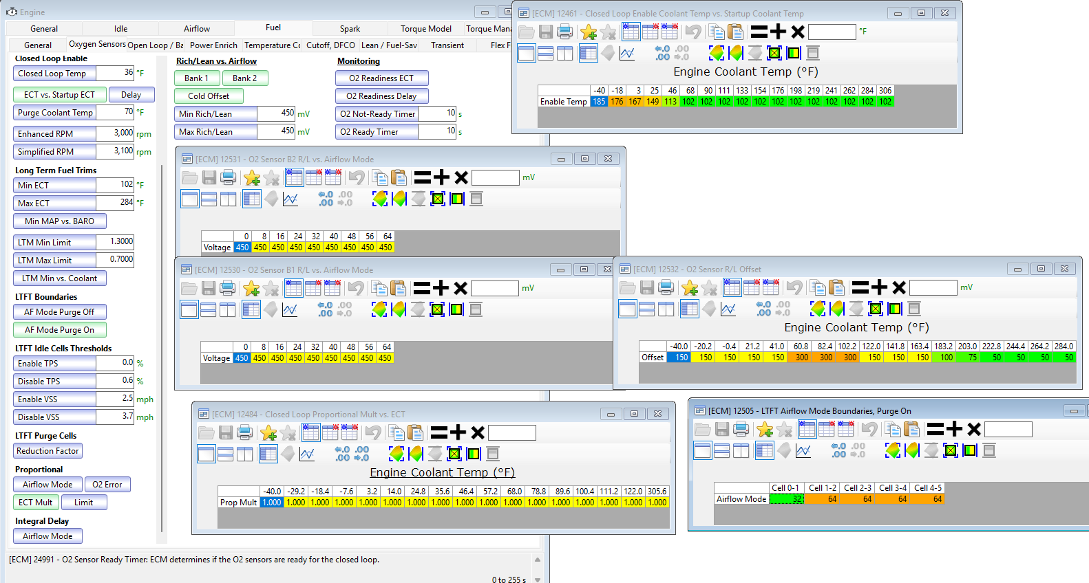

Searching thru the forum I did find a tsb that effects 2008. If it is a PCM issue anyway for a do-it yourself person to fix it?
https://www.tsbsearch.com/GMC/08-06-04-045A

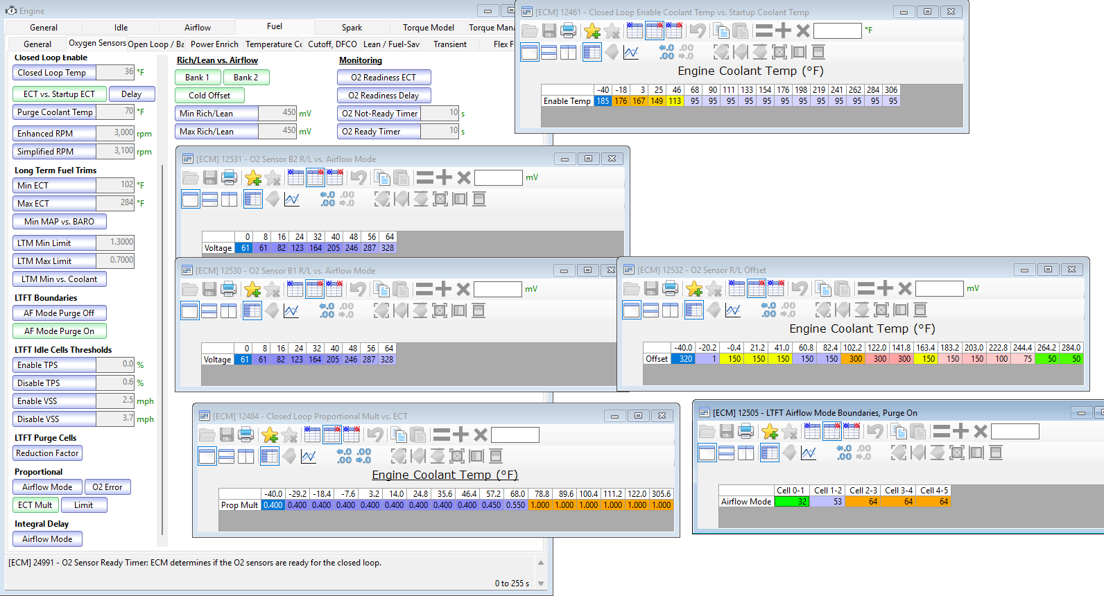

I did notice a few differences between '12 and '08 in hptuners, but that doesn't mean that's all the changes, so I would get an update with SPS..
I believe @j91z28d1 has used the OBDxPro? to program if you intend to program it yourself.
Here's a some changes that show up...
'08
just a couple changes in '09, main difference being the Closed loop proportional multiplier vs ect.
'12

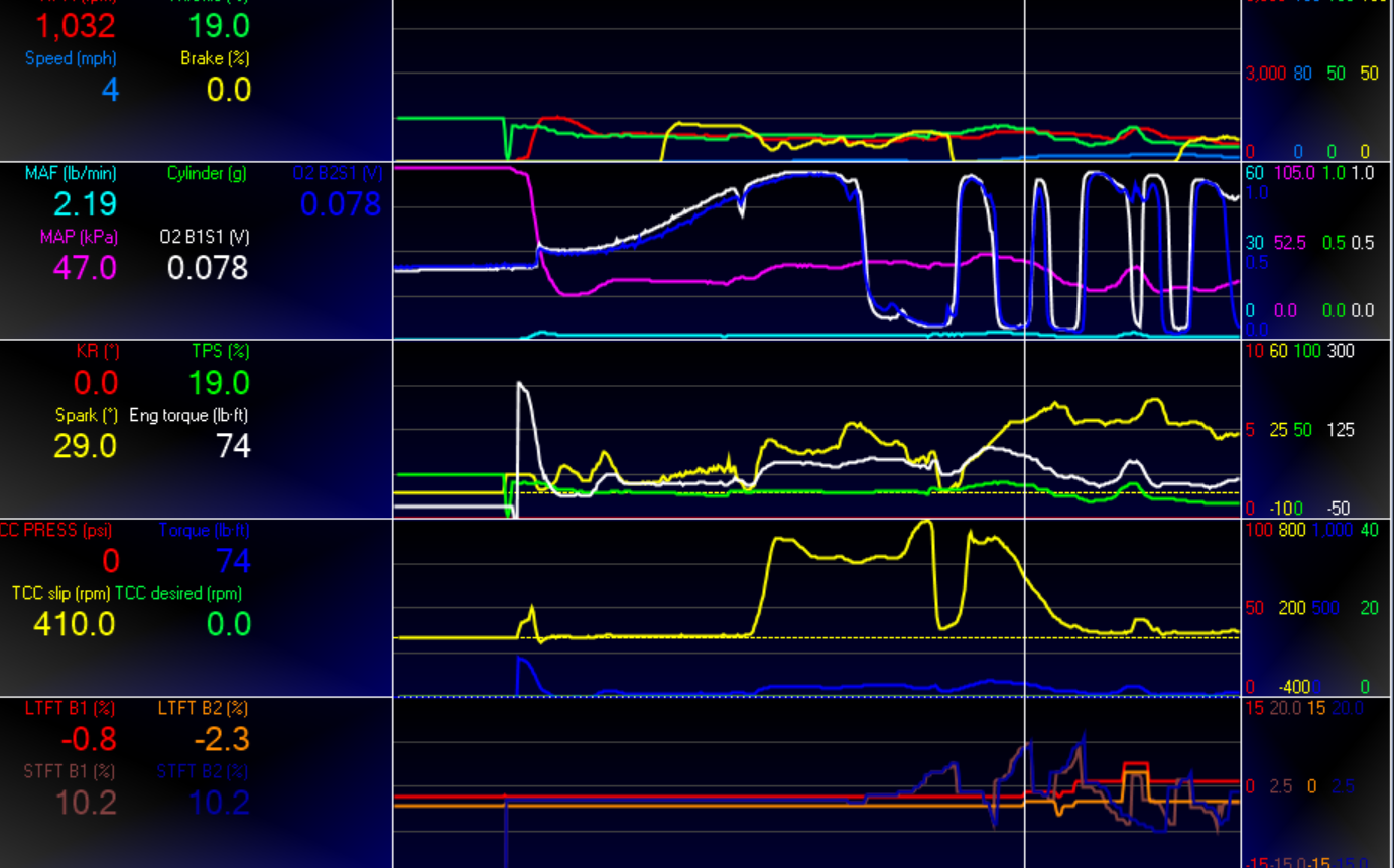

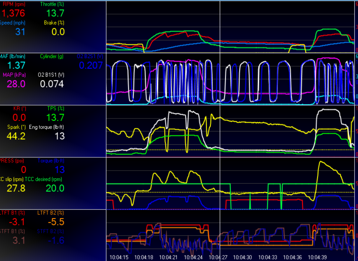

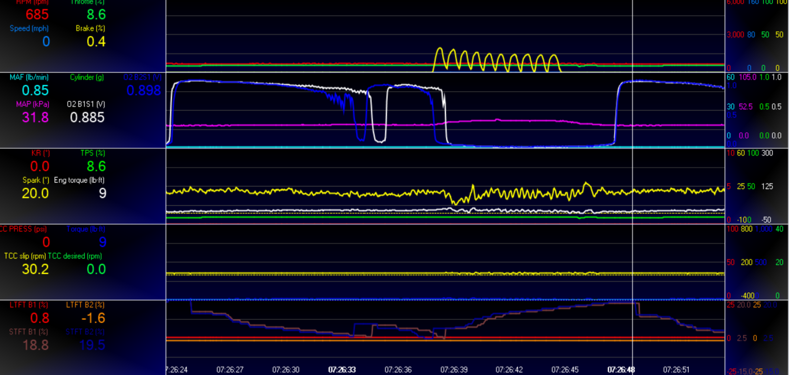

Last observations on o2/closed loop.. It's @lspann3525's fault!

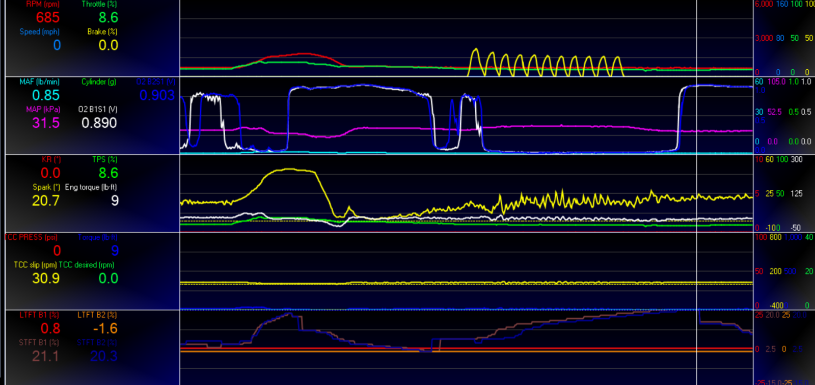

Cold start, 55degF ECT, LTFT dips 13 seconds in, after releasing brake.
Truck has been driving a few seconds, STFT no movement yet.
18 seconds in (cursor line) STFT moves and it is in closed loop, behaving as @Fless said, although my old sensors haven't warmed up yet.
Same cold start 'fuel trim learn' not active until 3min2sec after startup.
LTFT oscillating about every 3-5 seconds as truck is crawling around the lot in 1st gear.
More frequent than my light braking, and not really lining up with braking.
Warm restart ECT 122degF, o2's still warming up?
STFT starts moving and closed loop activates 10seconds after startup (cursor line).
Fuel trim learn active 1.7 seconds after closed loop activated.
LTFT no early movement (no braking/MAP change or driving yet),
