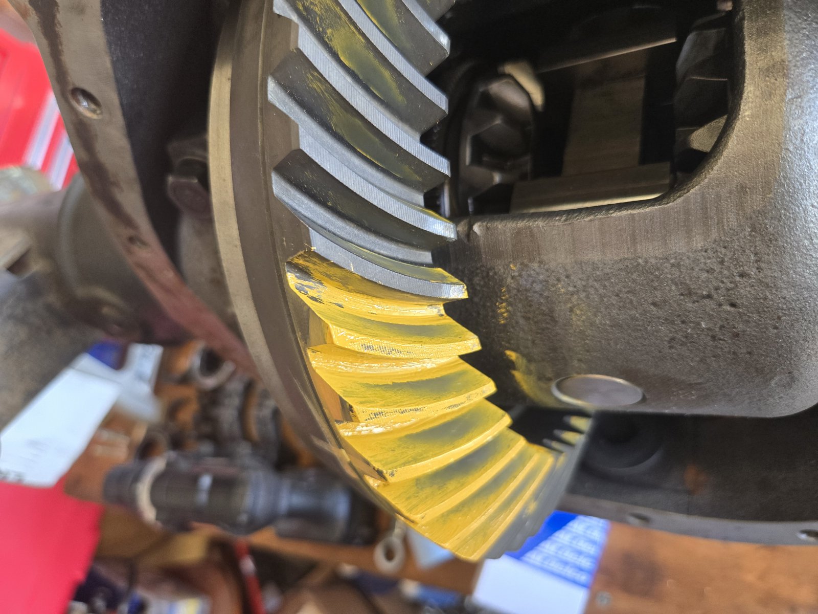

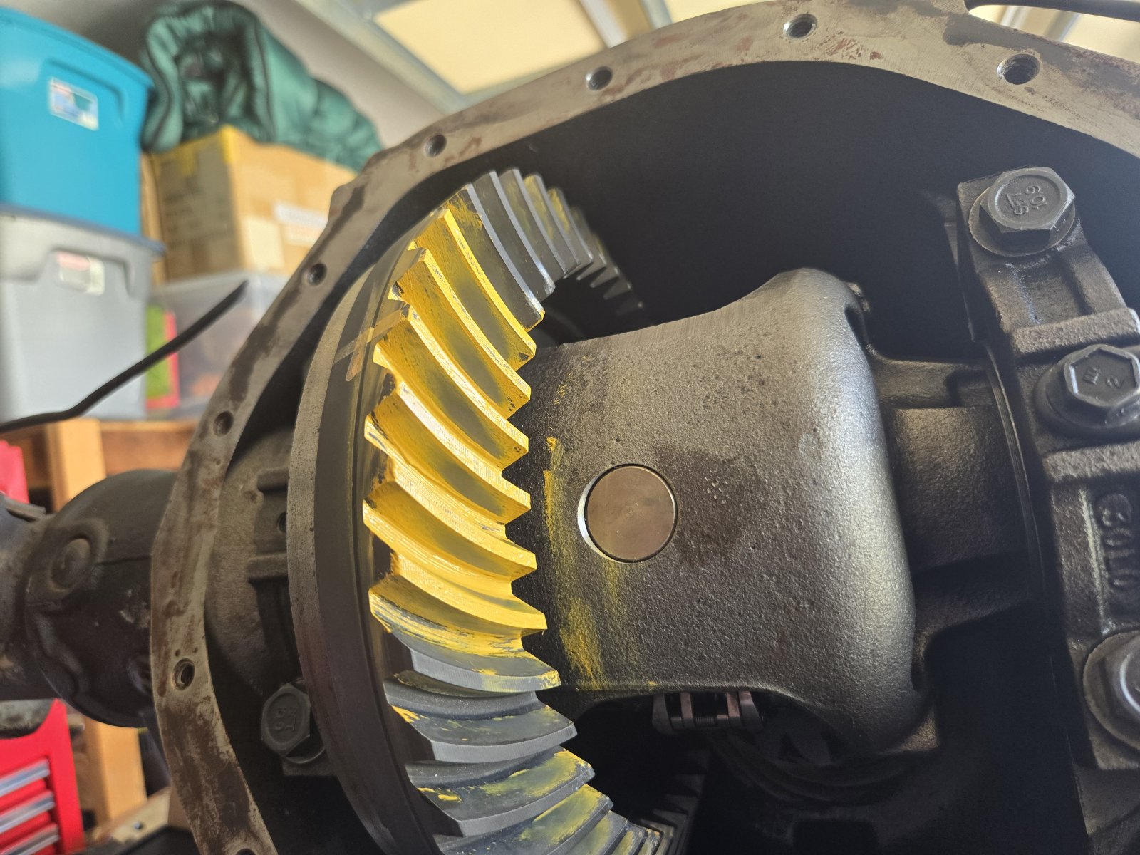

My helper and I got after the axle the other morning and got the backlash to .003 without using the J-24429 spanner. Using the spanner to turn the adjuster up another 5 slots got us to .005 and I called it good and went to doing the gear tooth contact pattern. As you can see, it's not perfect to my eye but not worth taking the axle apart to put a shim on the pinion gear. What say you?
We then moved to cleaning up the cast parking brake anchors and rubber gaskets and mating them up with the new brake backing plates until we ran out of brake cleaner and called it a day.

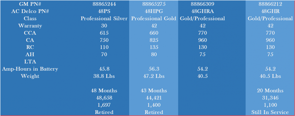

Back in April we walked out to start the Yukon after it had been sitting a while and it barely turned over but did. The Tech-2 showed that the State of Charge was 64%. That's replacement territory. I chalked it up to having been sitting and only making short runs.
Over the next few months I would spot check the SOC and it was always good, in the 70s and 80s.
This past Sunday we had used the truck in the morning for errands and then drove over to Bass Pro Shops to pick up a birthday present, about 10 minutes away. When we came out she was dead and would not turn over. A couple of jump boxes from employees could not get her started. So my wife started showing some leg in the parking lot and a dude came over with jumper cables that were falling apart and could not get the truck started either.
Then my daughter arrives with the jump box that was supposed to be in my truck. She'd been using while camping and of course it was dead. So I sent her down the road to buy a set of jumper cables and 30 minutes later I was on my way to birthday dinner for a nephew.
Drove the truck a few more times. Then made a 2 hour airport run and came home for an hour. Went back out to run errands and she was dead again. Put her on the tender overnight.
Went out this morning to check the State of Charge with the Tech-2 and the CanDi module was dead. My daughter didn't put it away properly, she twisted the cables all up which causes them to split internally inside the casing and you cannot repair it. So I ordered another set of cables from China. The problem is explained well in this video:

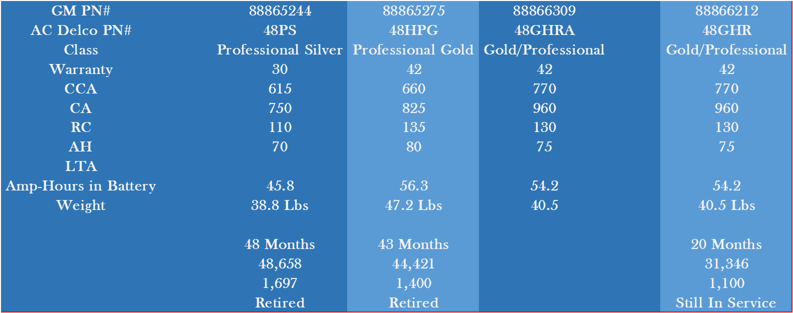

So I called my local dealership and got another high reserve capacity battery, a 48GHRA. We put a 48 GHR in the Sierra but as of late I cannot find out what the difference between them is.
So, the ACDelco 48HPG was installed on Christmas Day in 2020 and went 44,421 miles in 1,400 hours. I should have replaced it 5-6K miles ago so my wife wouldn't get stuck; even with me! Did I mention that this is a 42 month free replacement battery that lasted 43 months? LOL
The new batteries have more cranking amps, less reserve capacity and draw and are almost 7 pounds lighter.

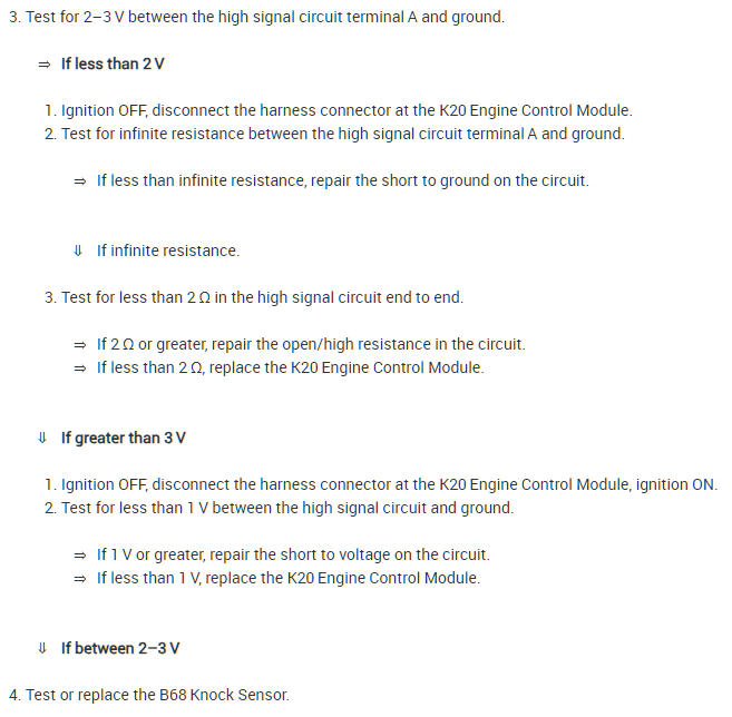

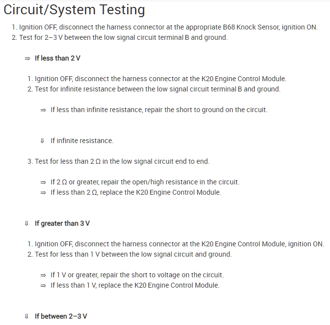

I think you have a wiring harness issue, a shorted wire probably. Here's what my shop manual says:
View attachment 435849View attachment 435850
You were right on the money with your assessment, as usual.
To make a long story short I also got a P0641 code the other day which caused the truck to go into "reduced power mode". Turns out the 5V reference circuit, which feeds 7 different sensors, was shorting out to the drivers side knock sensor signal wire.
The damage was caused by the stud sticking up in between cylinder 1 and 3 coil packs. It had found its way into the main harness from the ECM going up to the top of the intake manifold and nicked the Grey 5V reference and Blue Knock sensor signal wires.
