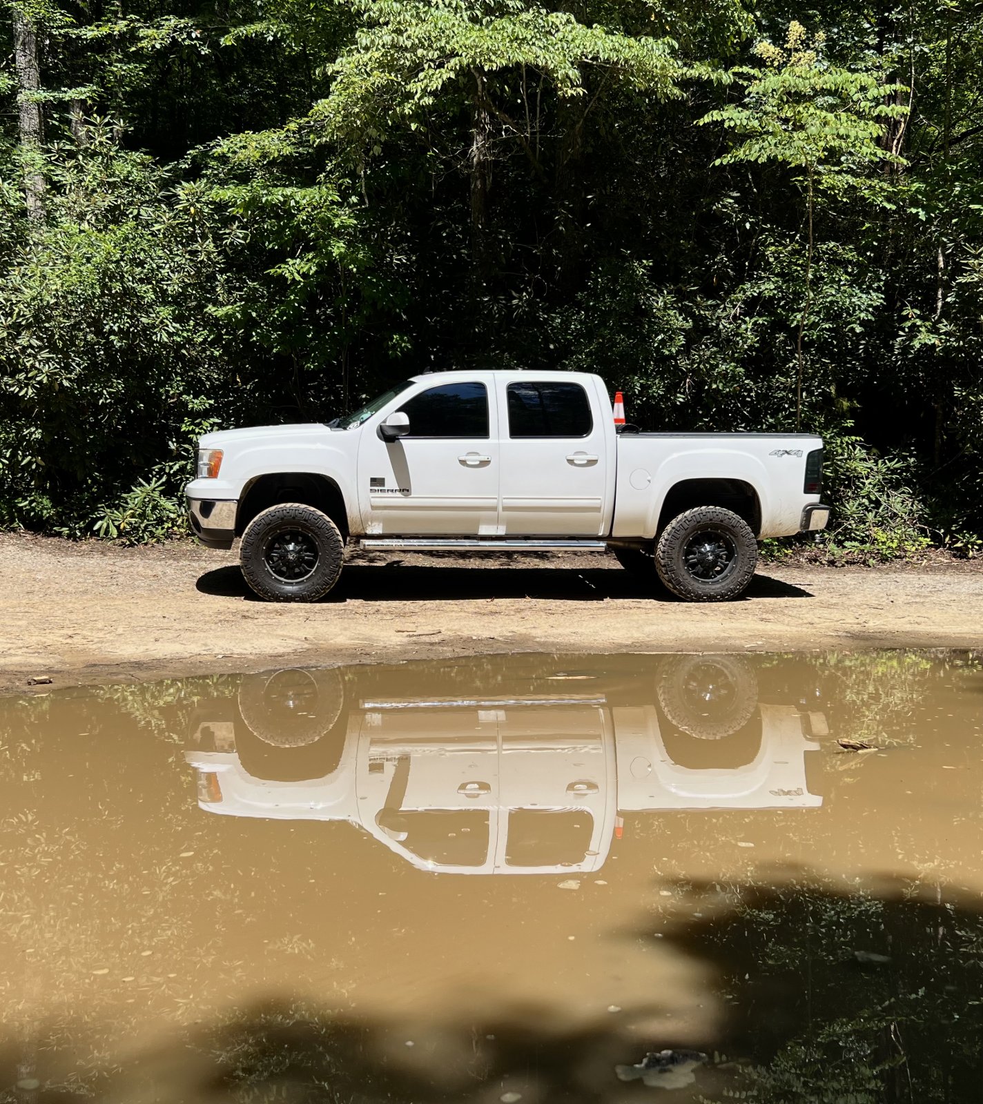

Cleaned the mass airflow sensors in the trucks today after church. Going to a mudhole to see how the Michelin Defenders do off-roading in a few minutes. Of course the kids are bringing their trucks in case Dad gets stuck!

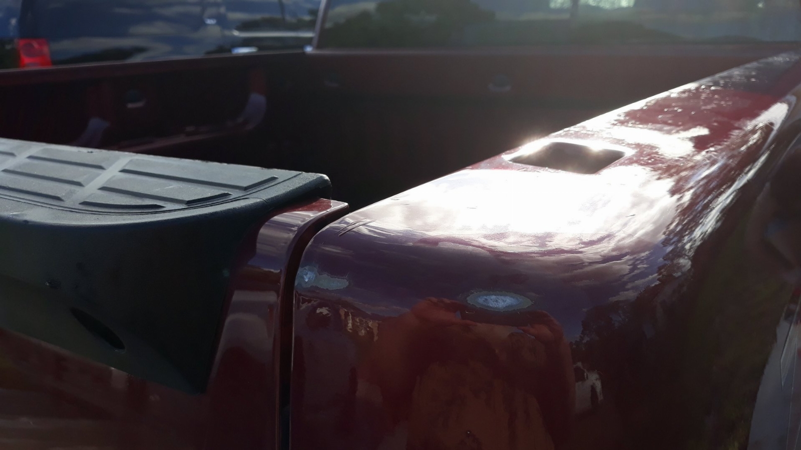

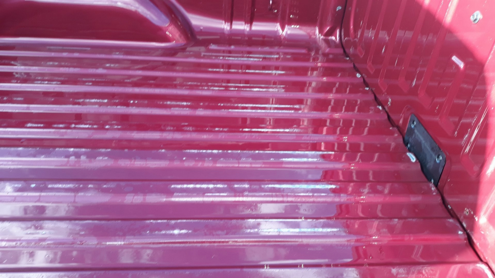

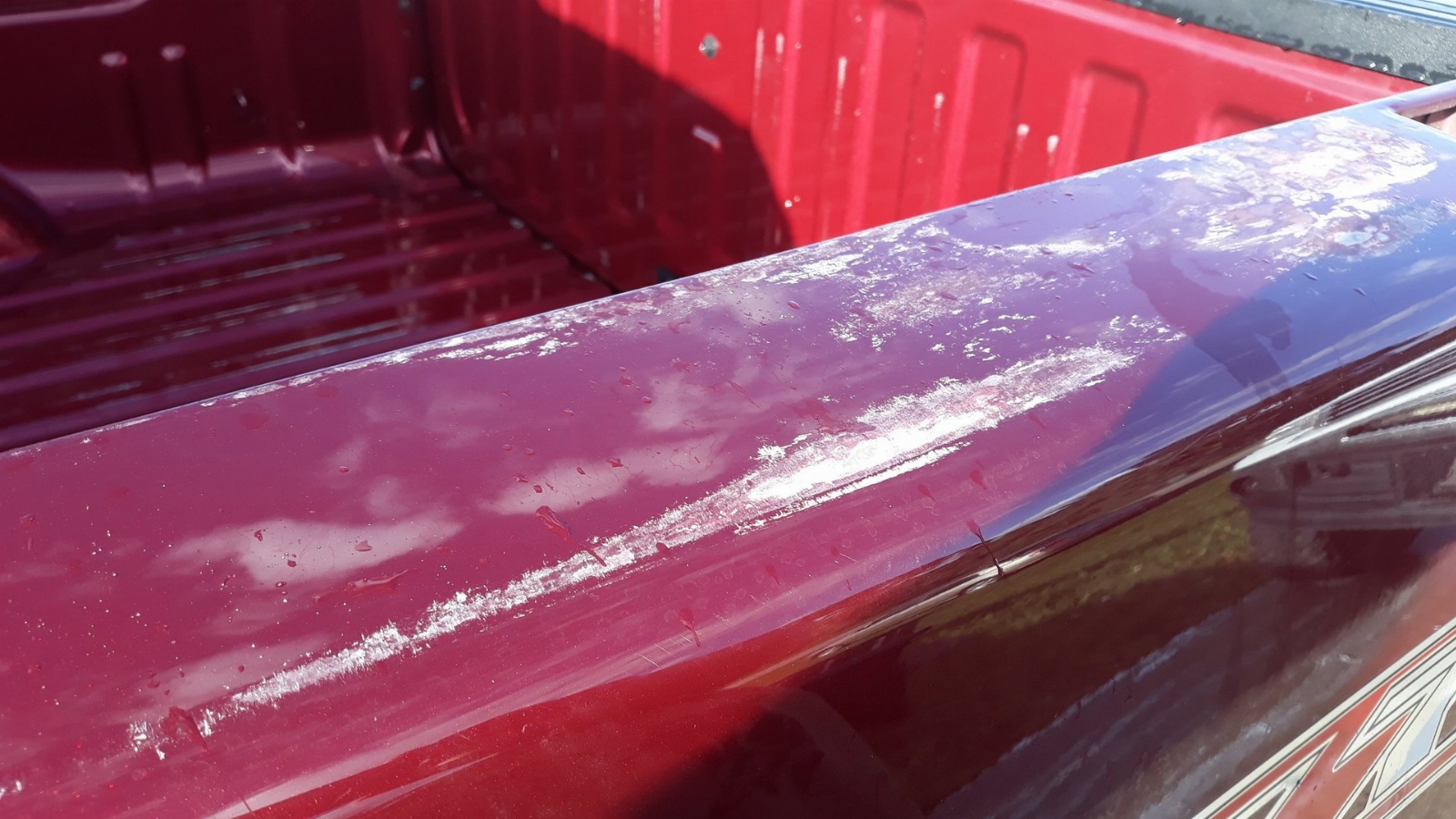

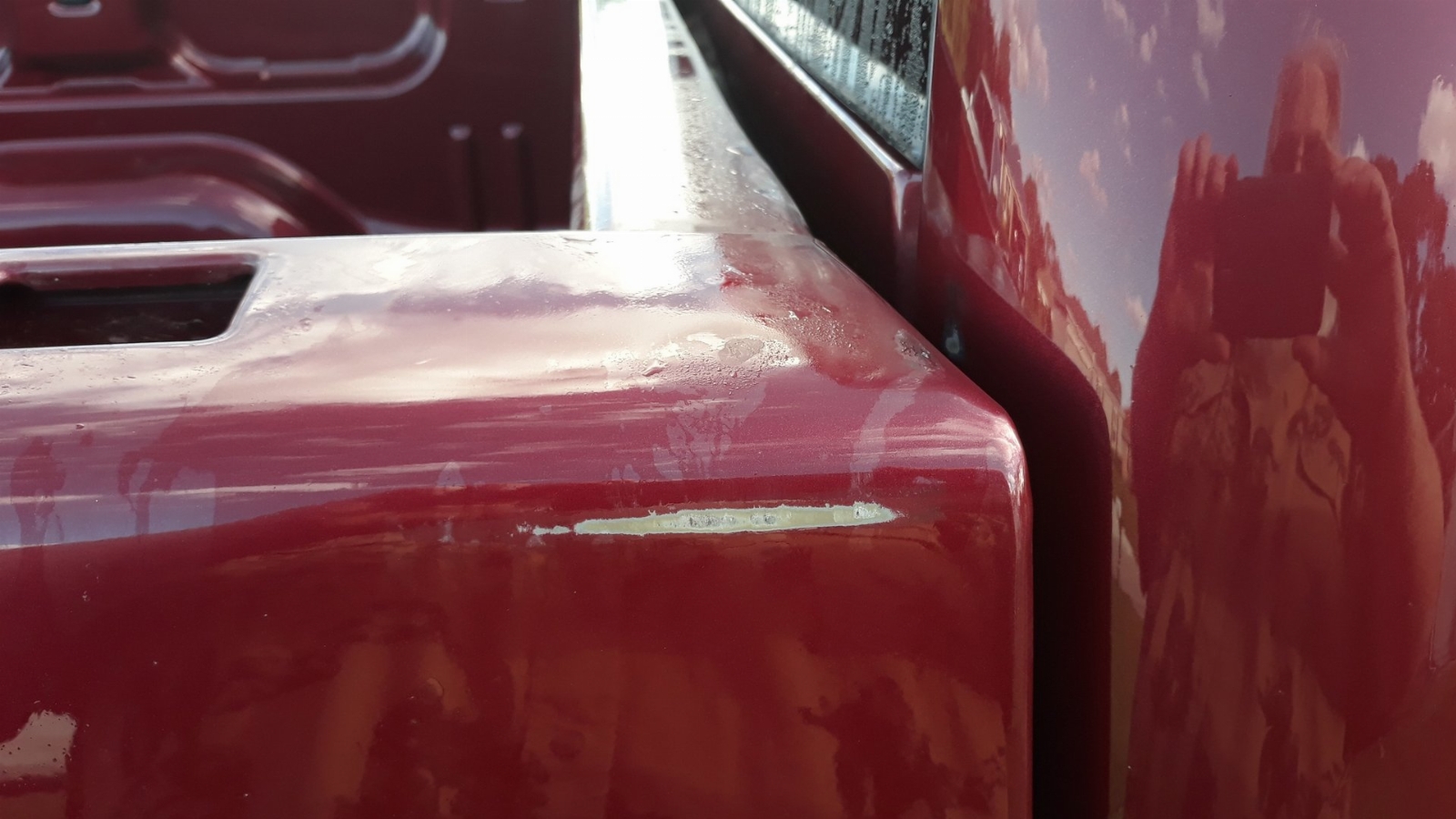

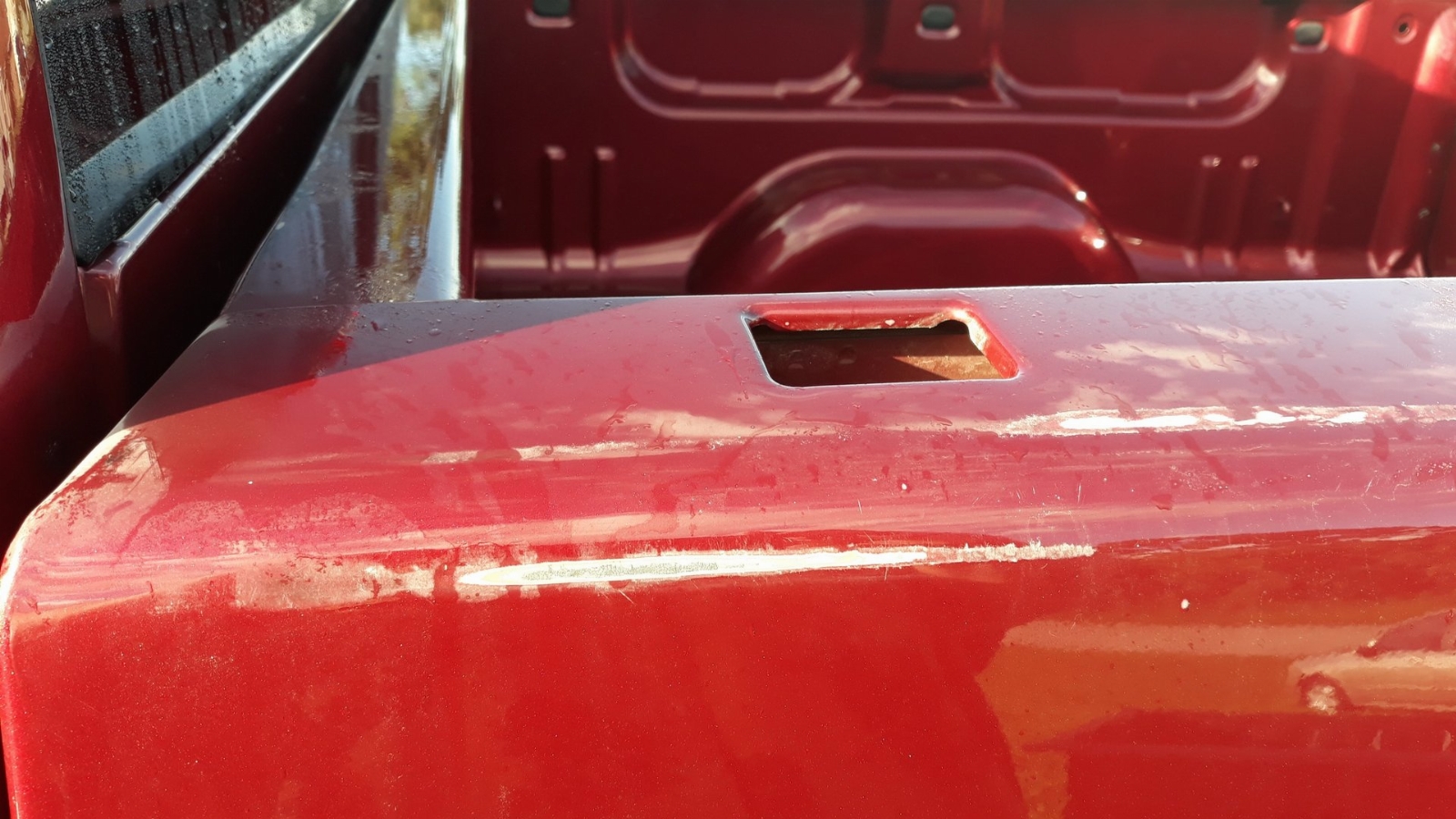

We recently purchased a 2013 Sierra with this Rugged Liner bed liner installed. It is the type that fits over the bed rails and is secured to the truck with 4 fastener clips. Apparently the thing moves around in the wind as it took the paint off the top of the bed rails at each end.
We're going to do paint correction and then cover the rails with the GM Accessory covers like the ones on the white Sierra. With clear skies we went after those fastener clips and had to break each one to remove the bed liner from the truck. Once done, it was obvious that it had not been removed in years, probably since at least 2015. There was a ton of Oklahoma dirt and leaves underneath. Once cleaned out the it was apparent that the liner had wore away the paint across the entire bed. The GM liner in the white Sierra has not done this. If the previous owners had done nothing, the paint would be in better condition. The bed and liner appear as if nothing was ever hauled back there, not a scratch in the plastic. Arghhh!
My daughter is washing the truck right now and I'll post up some photos of the paint later.
It's later:
Anyone else experience this? Any recommendations on paint correcting these areas? I purchased an ACDelco paint pen and rattle can and also have clear on hand in rattle cans.

I understand the concept of bed liners--to protect the body and paint in the bed, but it seems they cause more damage then protection most times. I always thought they'd move around back there--scratching up the paint in the bed. If I had a pickup, I'd get a spray in liner.
Maybe you can feather out those scratches and dust in the new paint using the spray can.

They rub the paint right off down to the bare steel. I repainted several beds in my day.

We did complete the paint repair on the outside of the bed today and Jaime went around with the pen filling in the rock chips and I used the rattle can on those unsightly ones. Came out pretty good with 2 or 3 light coats. Tomorrow we'll polish it, the bed rail protectors do not cover the front damage completely so I went to spend a little more time making them look good.
We've grown used to bed liners and the kids do not like the spray kind. They spend more time back their hanging out with friends than hauling mulch right now.
I'm going to leave the bed bare for a while and then will probably get another GM liner. Will also get another Truxedo roll up tonneau cover, this way both trucks will match.

You could also try to wet sand once it dries to smooth out the touch ups. Will make it smoother.
