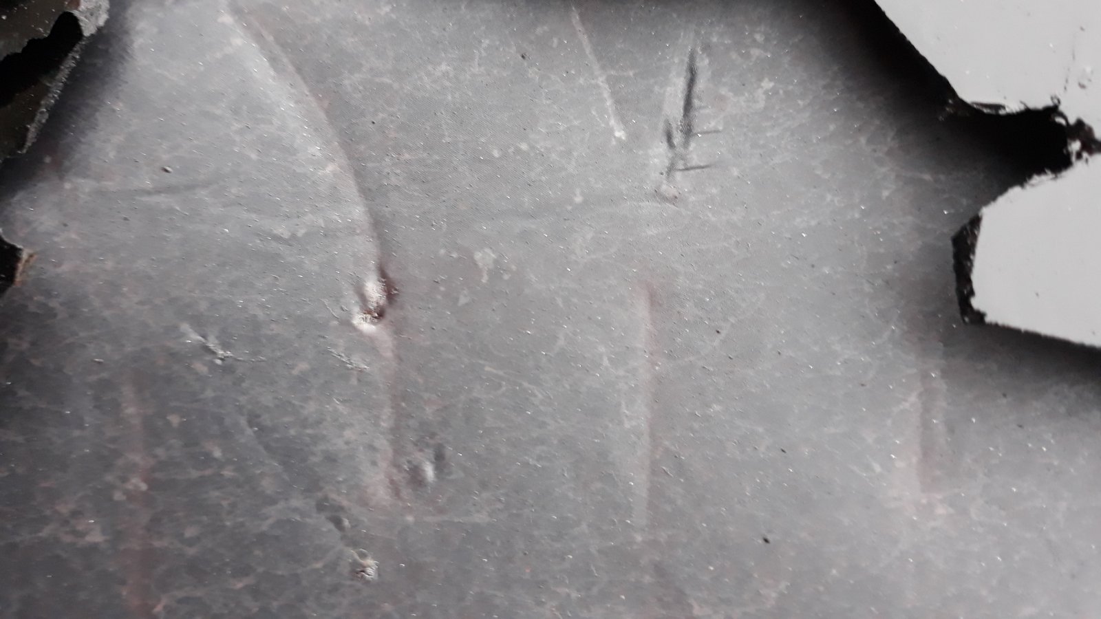

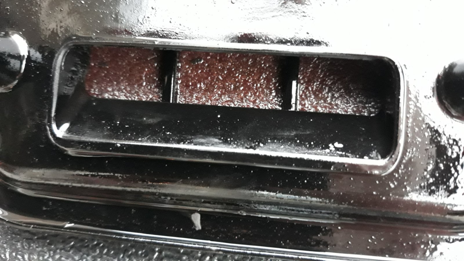

And as promised, here are photos of the filter:

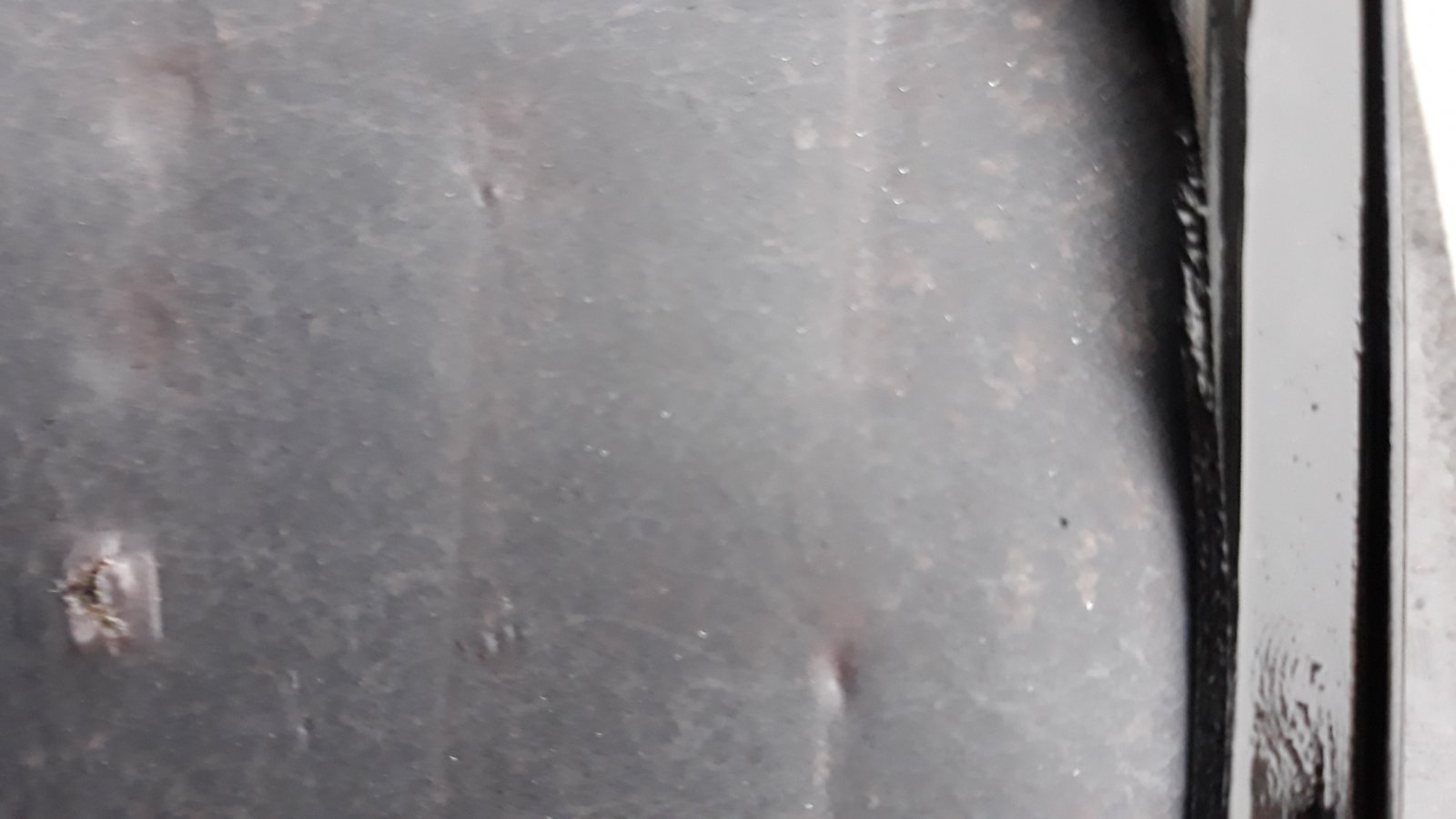

Very clean with some shiny flakes of metal (presumably aluminum) in the filter. The magnet was full of course, no chunks or large flakes of metal. We forgot to take a photo before cleaning it. We replaced the transmission oil pan gasket with a new one. The original stuck to the pan and got misshaped during removal.

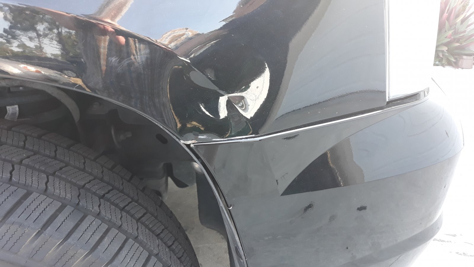

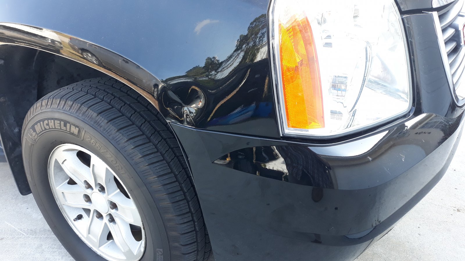

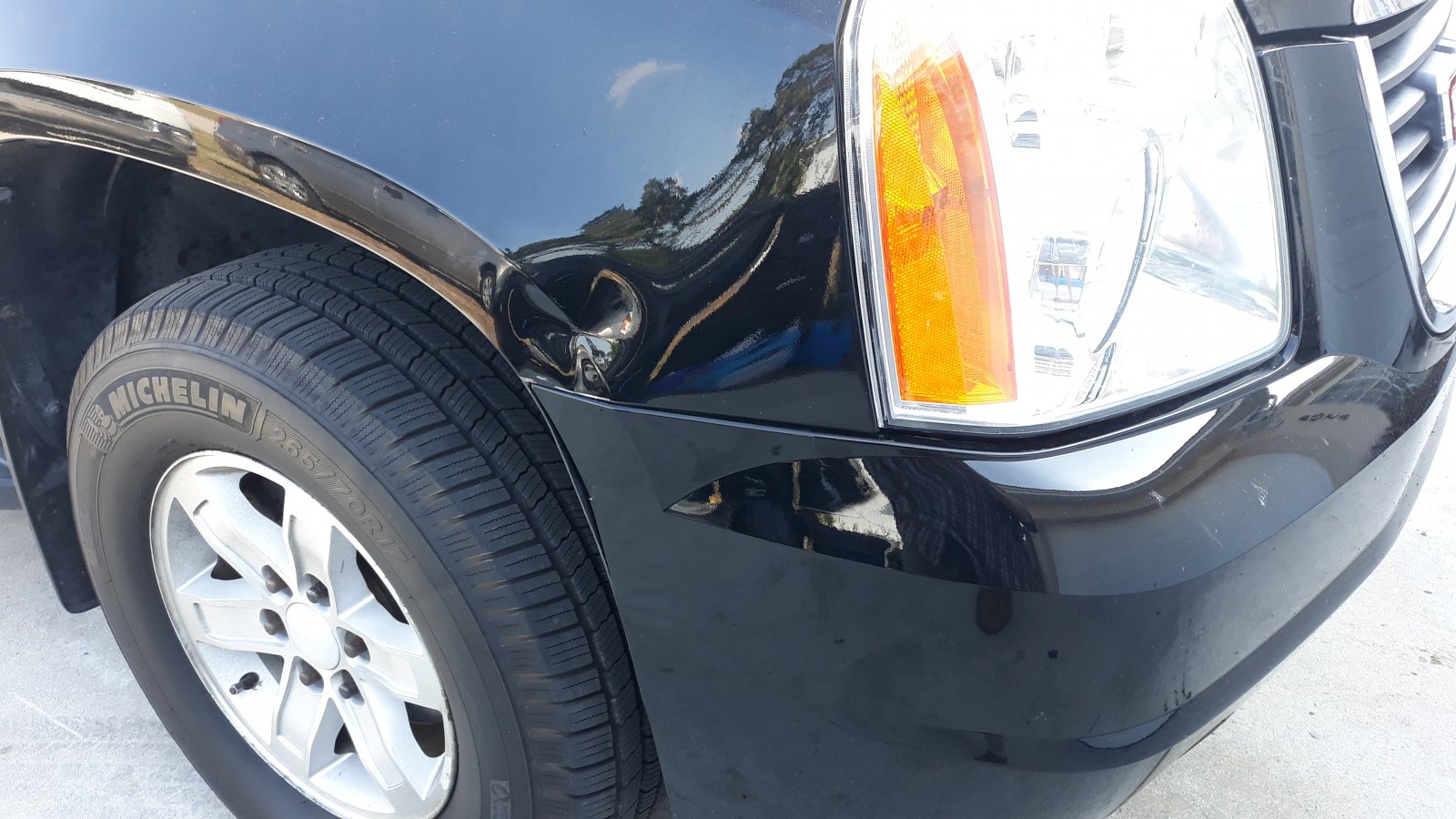

Oh, about a week ago, my other future son-in-law backed into my truck:
Grrrr!!!
Pretty sure a PDR guy can fix the fender and then the bumper will fit back into place. Unfortunately, the paint on the cover cracked and will have to be painted. Suggestions or comments appreciated!

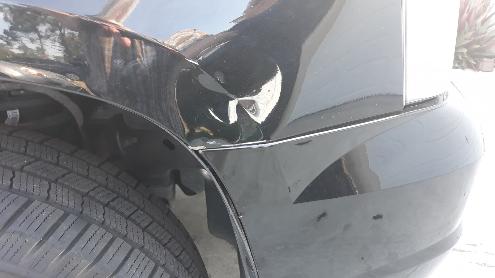

View attachment 394869View attachment 394870
Grrrr!!!
Your former future son-in-law?

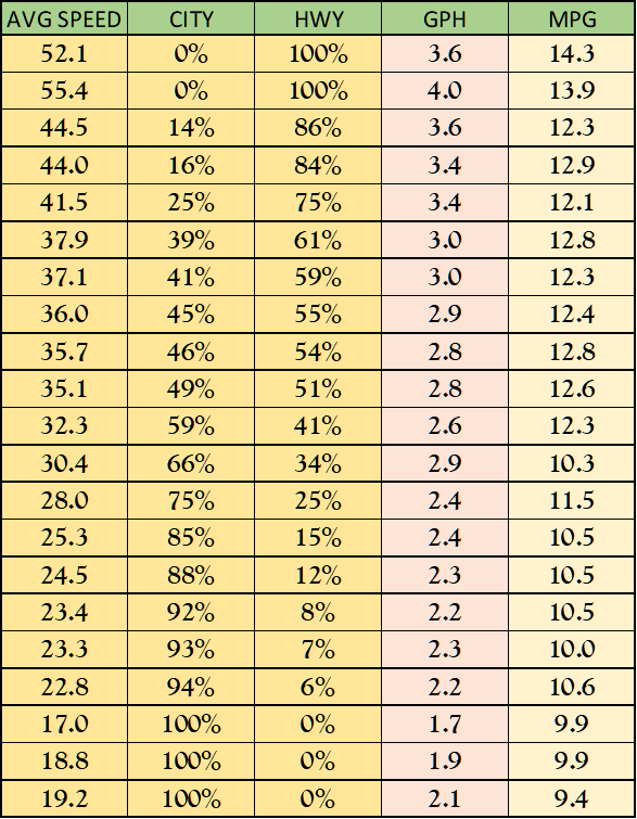

The truck has been burning E85 since November. So at 100% Highway driving with speeds over 48 mph she's averaged 14.1 MPG.
In mixed City/Highway driving, between 40%-60% or so she's averaged 12.5 MPG.
At 100% City driving with speeds below 20 mph she's averaged 9.8 MPG.
Not shown has been the cost per mile for every tank of E85 since November and she's averaged twenty-four cents a mile with a high of .29 cents and a low of .17 cents a mile.

Those 6.2s are more efficient as long as they stay out of the city. Our 2013 6.2 Sierra gets better mileage than my 2009 5.3.
Let's see, to compare to yours, between 40% and 60% city driving she averaged a burn of 2.2 GPH and 15.7 MPGs. Your burn rate is about what our 2013 does.
