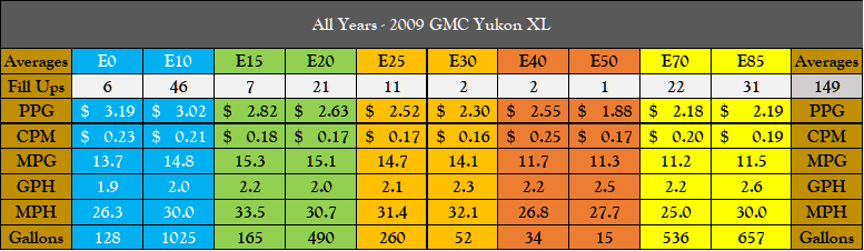

We've been recording data for some time now and always glad when something new becomes apparent. Came across a post this year where it was said that the computer system has a high and low alcohol content tables and that running 50% alcohol is no different than running 80%. So I looked at our logs and it became apparent that this is so on the Sierra but with the Yukon it doesn't seem to matter between 40% and more. E70 includes fuel with an alcohol content of 51% or more to 70%.
Still trying to run more mixes with the Sierra at E15 levels, the Apple IOS phone was not talking to the Foseal OBD WIFI adapter so I bought a Foseal Bluetooth adapter and it works now. So I expect to be able to get more accurate data from the Sierra from now on. According to the data, the Sierra may get its best economy on E15 and maybe E50.
Appreciate any and all input.
These alcohol content figures are as physically measured or with what the PCM is reporting?
45,012
Computer. We do spot check now here and there off the fuel rail and the computers have been very very close.
Nice. I haven't tried mine again since that time about a year ago when it was stuck around a calculated ~22% with a measured ~65%. I'm starting to wonder if I have a leaky intake manifold gasket. I've gotten an "insufficient switching O2 sensor" code for bank 2 a few times over the past year. It would clear itself and seems to be during extended periods of low-load operation. I swapped the sensors around during an oil change 5K ago and the same code reappeared once not long ago. I'm wondering if I have some sort of small leak on the RH bank that is affecting the way the alcohol content is calculated. I'd surely like to get the full benefit of E85.

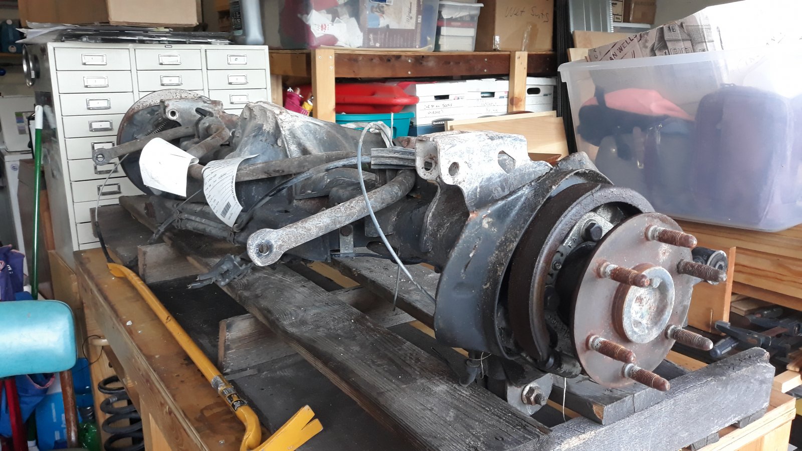

Just got back from a little road trip with my daughter Julia. For about a year I'd been eyeing 9.5 inch Saginaw 14-Bolt Semi-Floaters on LKQ Online and there were a few in Fort Myers at one yard and another in Melbourne. The latter one recently sold and they dropped the prices on the other two to less than $300! So I called and bought one that came out of a 2011 Escalade ESV. That was last week, we ran over today and picked it up.
Julia again learned why I prefer the six and a half foot beds (we had to leave the tailgate down) and how slowing down actually increases your gas mileage! Our 2-way average in the lifted Sierra over 273 miles was 14.60 mpg. 14.82 there and 14.39 back.
The backing plates are wrecked and an axle seal is leaking. It came with the swaybar, panhard bar and upper and lower control arms. The brackets look to be in good shape, you can tell the axle was dragged while probably still attached to the truck. There's little slop and the axle spins the yoke easily. I figured it would for 142K and out of an Escalade driven by a local doctor. It comes with a time and mileage warranty but I have no plans to put it under the Yukon until winter at the earliest. I'll take my time dismantling and inspecting it and making it ready for the truck and will probably put 3.73 gears in it.
There's still another one at that yard for under $300 fellas! LKQ wants $800 for 8.6s with 3.08 gears! LOL
What gears did it come with James? 3.08's?
All the AXNs in the Cadillacs and Denalis came with 3.42 gears. There might have been some Avalanches with the 6.0 L76 with 3.73s in 2007-2008 but don't remember for sure and there's not many around anyway to bother with unless spotted at a yard.
Apr 11, 2018
7,124
14,376
St. Louis
This video explains it more concise than I:
Even though the full floater is obviously more stout, for most of what we do with our trucks, the semi-floater is plenty strong.
Got it!
So basically, a semi-floating axle is pretty much like every other solid rear axle setup while a full floating is more like an independent axle.
I just wasn't familiar with that terminology.

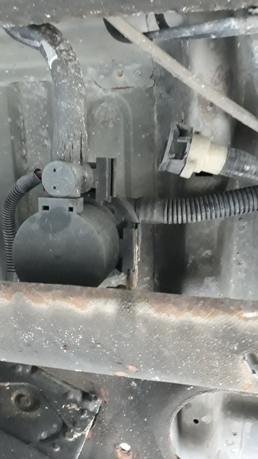

No more P0442, Small Leak! For three years or so we'd been slowly chasing an emissions leak. Like clockwork, right before the truck was due to be refueled the code would set while the truck was off after it failed so many tests. Replacing the gas cap caused the code to set more frequently so it was sent back. I procrastinated for years about buying one of them fancy smoke machines. For the same price, I could throw a bunch of parts at it.
Well, while I was still debating that one in my head, we were dropping the spare for its semi-annual exercise and I asked the kids to crawl under with their phone and take a picture of the canister purge valve. They did and upon examination I was fairly certain that that line was the culprit.
Curiously, the disconnected line to the left, was leftover from the original emissions setup that was replaced when the truck was new and this remnant was left there and it goes up the fill neck. Bought a new canister purge with new style plug and lines and they are plastic, not rubber and shrink wrapped to the purge and should never leak. If it ever does, the whole set up will find itself in the trash for good.
Anyway, no more annoying CELs.
Hopefully you replaced the canister VENT valve.
Yeah, yeah, that's what I meant! LOL Guess I was thinking one thing and typing another even though the photo was right!
The cheapo in me just wanted to replace the hose but the new one is made of a different material. I'll cut the hoses off the old one and throw it in the spare parts bin for the fleet.

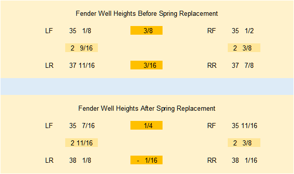

Gave the truck a full belly full of fuel and then took the fender height measurements and drove over to Sam's Club and borrowed a wall to aim the headlamps. We had to raise them 8 to 10 inches! The fogs are literally pointing at the ground in front of the truck but it was raining so that will have to wait for another day.
The truck looks like it was lifted much more than the numbers suggest but the math doesn't lie!
