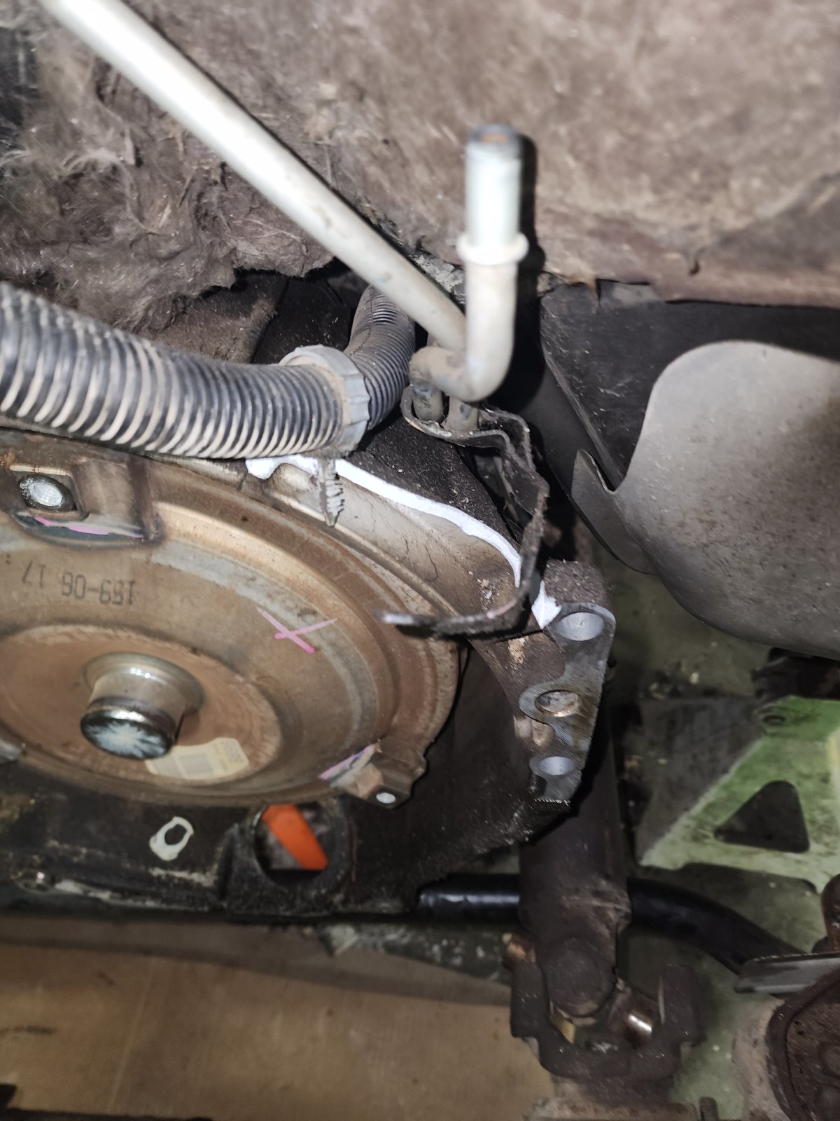

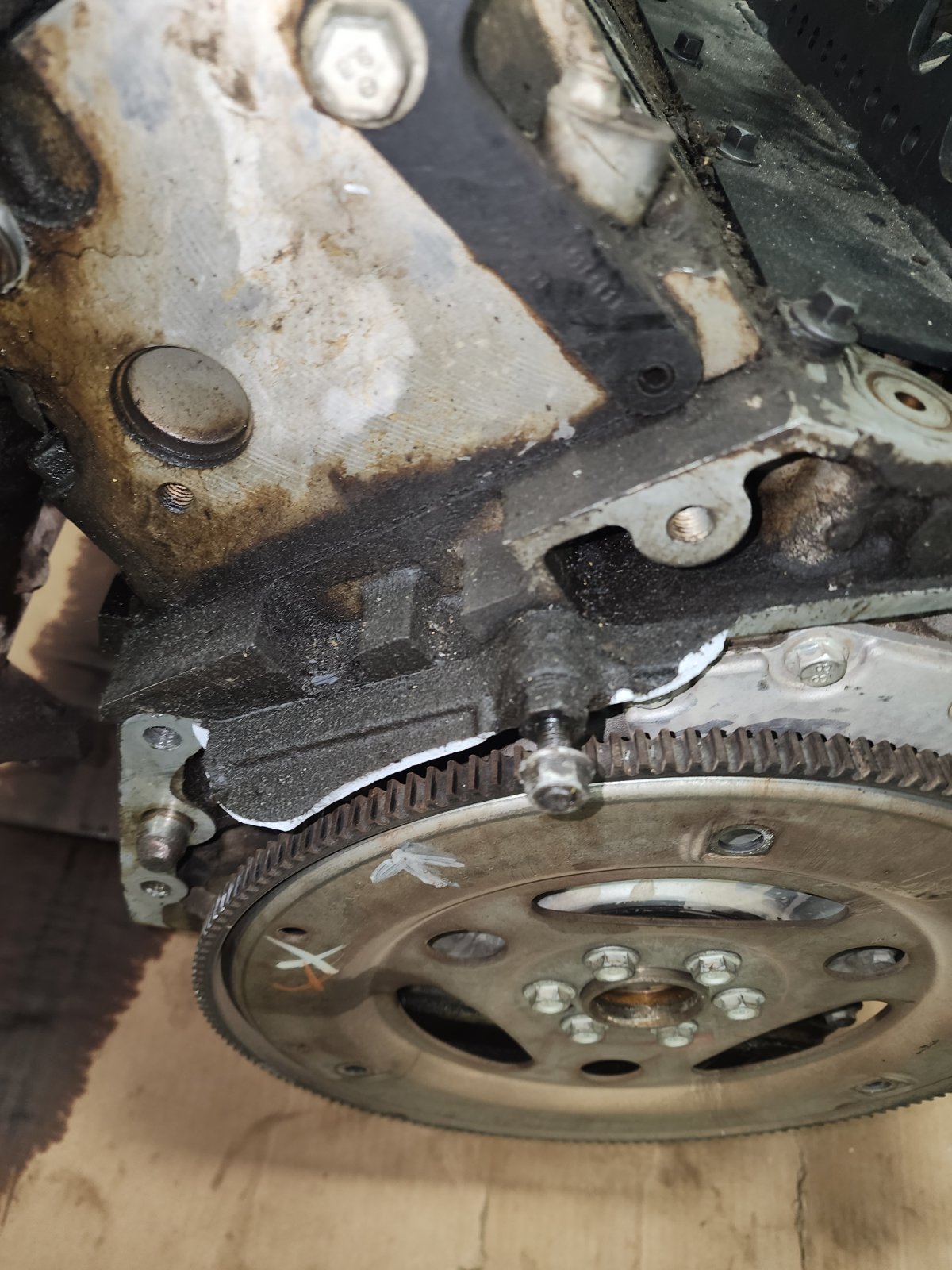

Make sure you get all the bell housing bolts..my "helper" missed one and swore it was just "stuck".
Man he must have really yanked on the tail end of that trans in order to get that much leverage and force to break the housing. Idiot. A guy can tell when what he’s doing is wrong if he just pays attention to that little man in his head that says “ I know I should stop but…”
It was me wiggling the engine, and twice I stopped and asked him if he was sure he got all the bolts. Oh yeah, for sure...
Third time was the charm.
