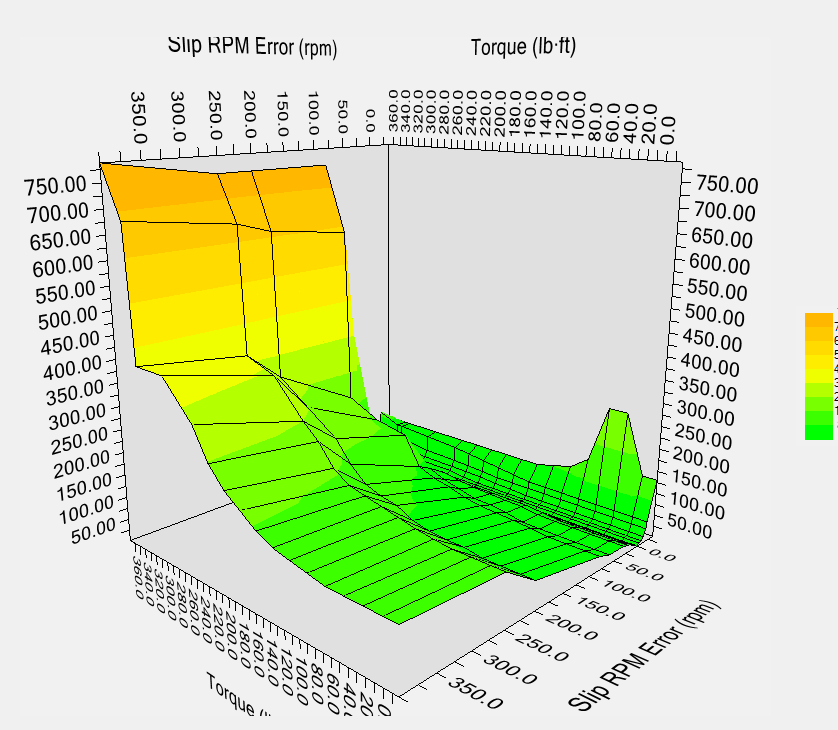

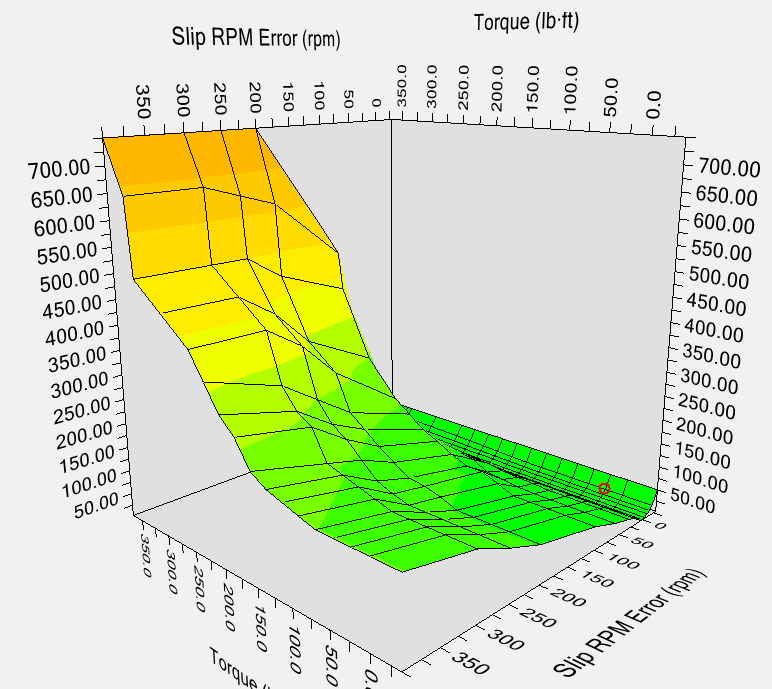

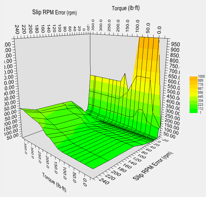

I do notice that in our 5.3 tunes, the tcc apply ramp has some big values for negative slip...
(but small for positive slip.. ?)
And if you look at 6.2 tunes, it's opposite.
Although they added a little bump for negative slip in the later years.
'08 6.2
'13 6.2
But also, the 5.3 does not lock TCC in 1st, while the 6.2 does not lock in 1st & 2nd.
