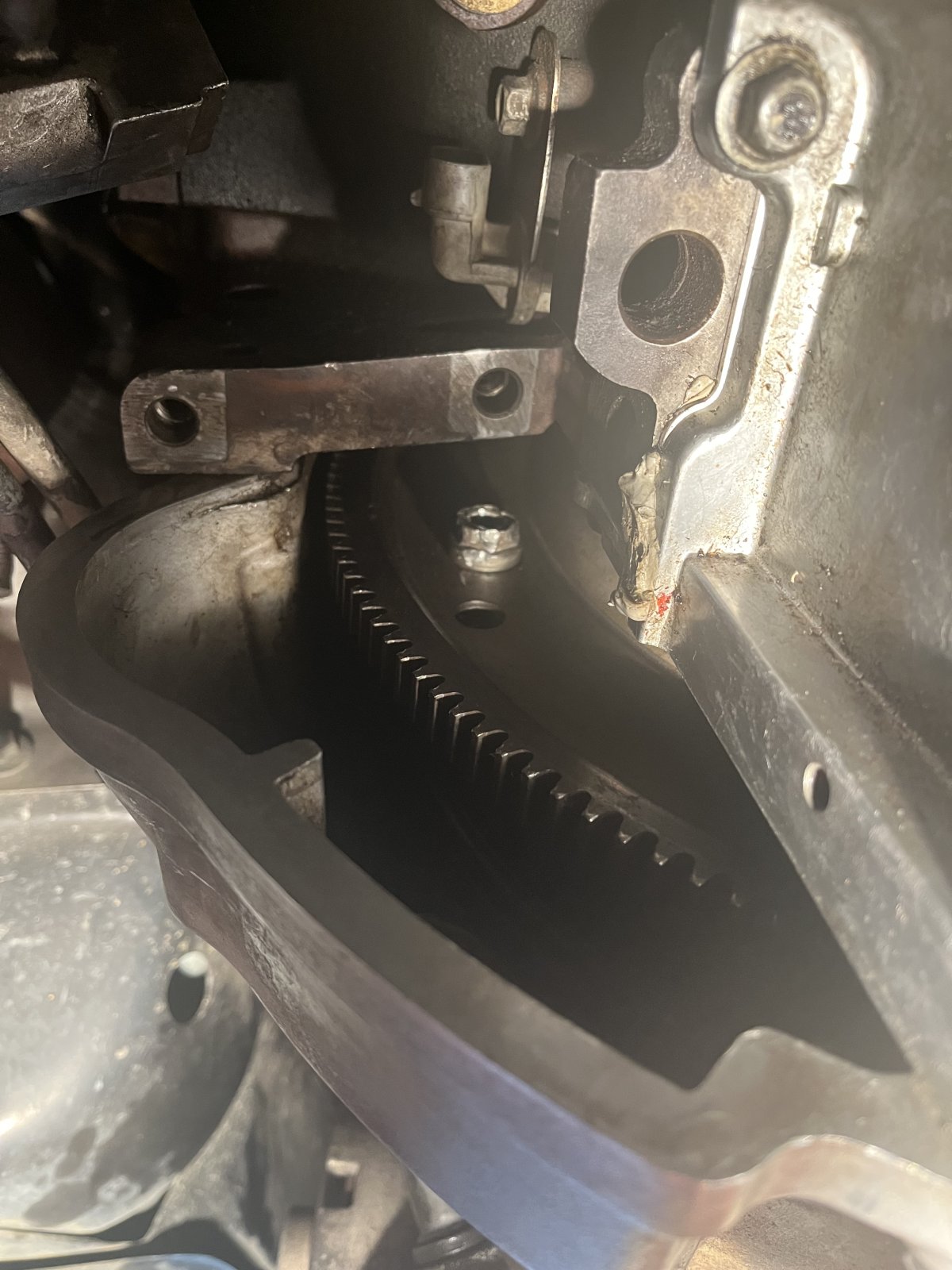

Im doing a rear main seal replacement on my 08 z71 again. Everything was going smoothly to I got to the torque converter bolts. I got 2 of them out but the 3rd started to strip and even the hex key is started to strip as well. Anyone have any suggestion or methods to get this bastard out?

can you get a pic of how bad the bolt head is?
some of the newer designs wrenches do a good job on mildly stripped bolt heads. if the threads are stripped, I'm guessing you'd have to pull it. I don't honestly don't know if something like a heli coil thread repair insert would throw off the balance enough to matter or not.

the head of the bolt is rounded the socket fits on the head but slips with impact. tried the allen key its starting to round too...
any good way to lock the engine i want to try breaker bar

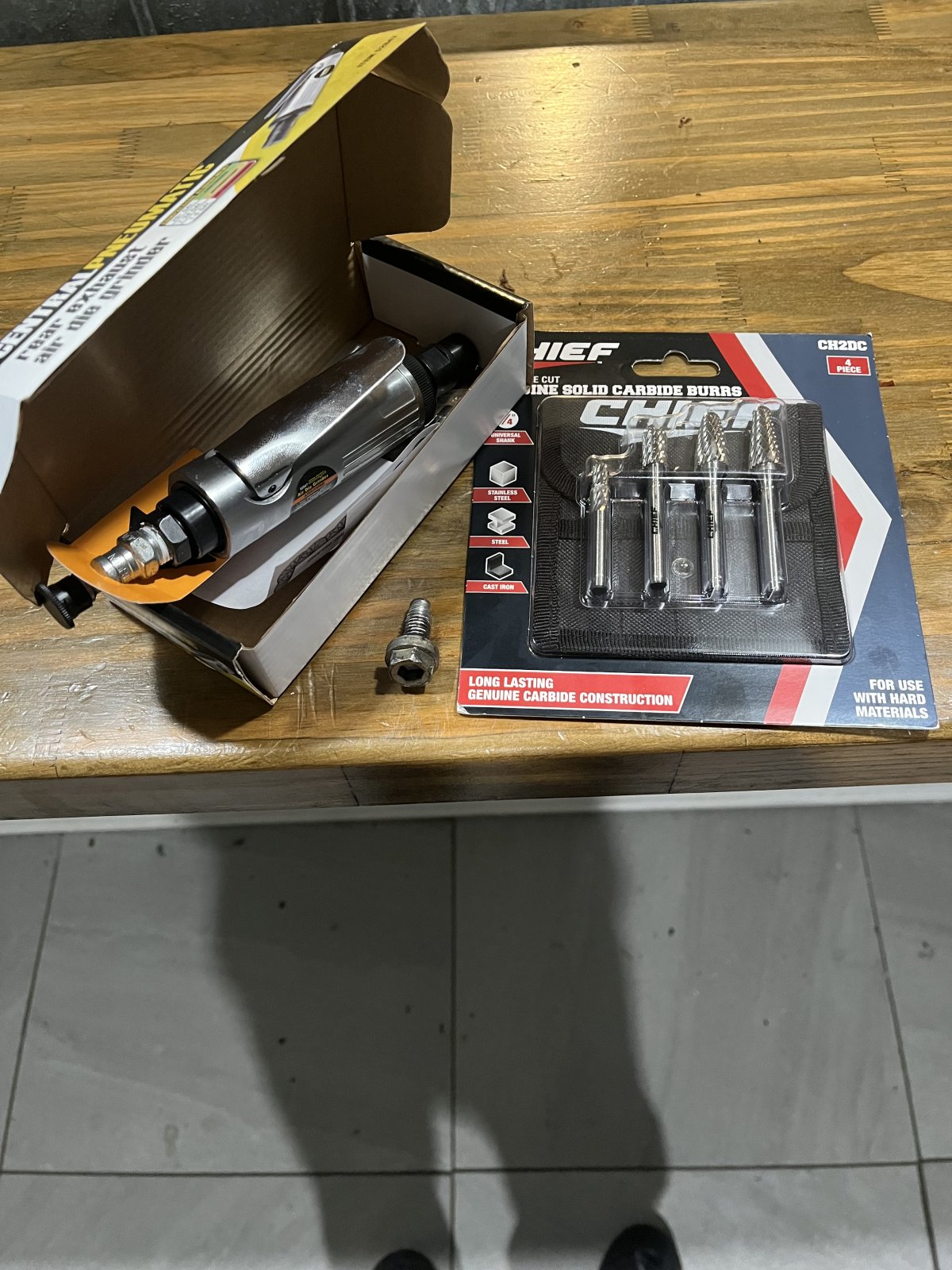

what type of cutting wheel do yall recommend to cut the torque converter bolt using air die grinder?
Also picked up the set of 2" genuine solid carbide burrs for 75.00 looking for a cheaper burr or cutting wheel that will do the job
