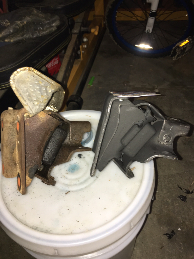

For the 6.0L 2500 with the 6L90 the engine and transmission mount part numbers respectively are 25828247 and 15113134.
45,014
Those are non-hydraulic mounts. In fact, they're the mounts intended for the trucks with the trailering package and should have a red stripe painted on them. I recently ordered a pair of these for my brother's '06 Sierra CC. I didn't think they'd put the hydraulic mounts on a 2500. His original mounts had 181,000 miles on them and were still in usable condition. I replaced them because the engine was out for other repairs and his truck is 4WD so replacing them later would've been a huge PITA.
