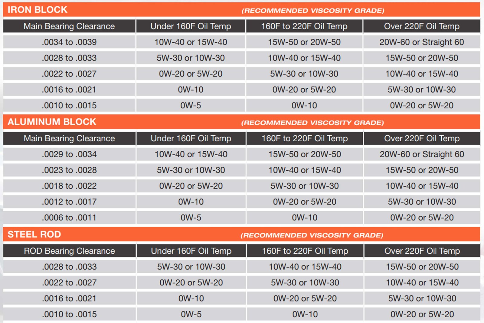

All about bearing clearance.
what-i-learned-today-bearing-clearances-vs-oil-viscosities-2022-04-04_12-49-04_516744-4173355170.jpg

I have not seen that chart showing clearance and recommendations before. I think I like it.
Federal Mogul used to print a chart that showed how much oil spilled as the clearances were increased but it was from the 60's and all oil back then was single viscosity.
The old FM chart showed oil spillage change from .002 clearances to .0035 clearances was an increase of about 10x as I recall. If I run across that old chart I will post it.
To the OP, I have used the washer trick to increase oil pressure on 2 engines. It works to help the pressure above say 1500 rpm but did not change pressure at idle. I think you need the high volume pump to get the pressure at idle to increase.

So I called TSP, and asked them and they said that there is a solenoid that controls the oil pressure and you can unplug it, but it'll send an error code light, though unplugging it will boost oil pressure as the solenoid dumps oil at idle. The tech guy said all gen V blocks have low idle oil pressure. Stumbled across this interesting article. What are the bearing clearances on the L86 6.2?

What are the bearing clearances on the L86 6.2L?
Also, what if any are the clearance differences between the L86/L87, vs the LT1?
'cause there are WAY too many of you who don't realize that the L86/L87 is very close to a clone of the LT1, yet L86/L87 require 0w20 or else.
