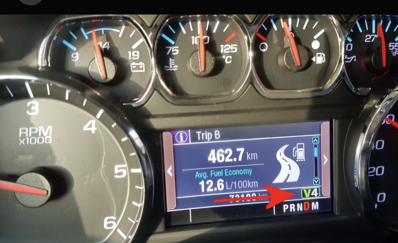

Range AFM disabler is plug and play or get it tuned out.
Next time you take it for a test drive, change the DIC to your fuel economy screen and you’ll see it drop to V4 once you get up to cruising speed and let off the throttle

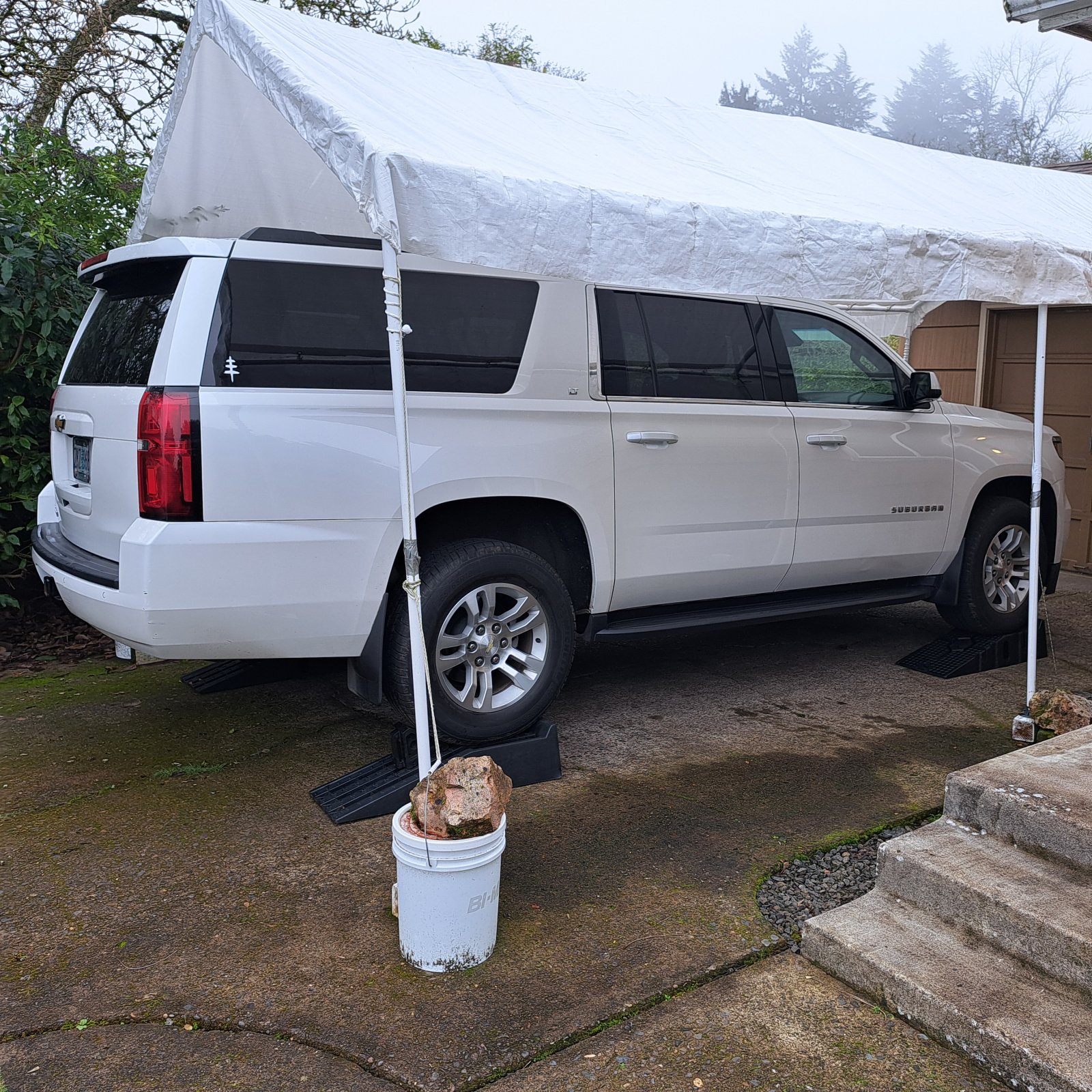

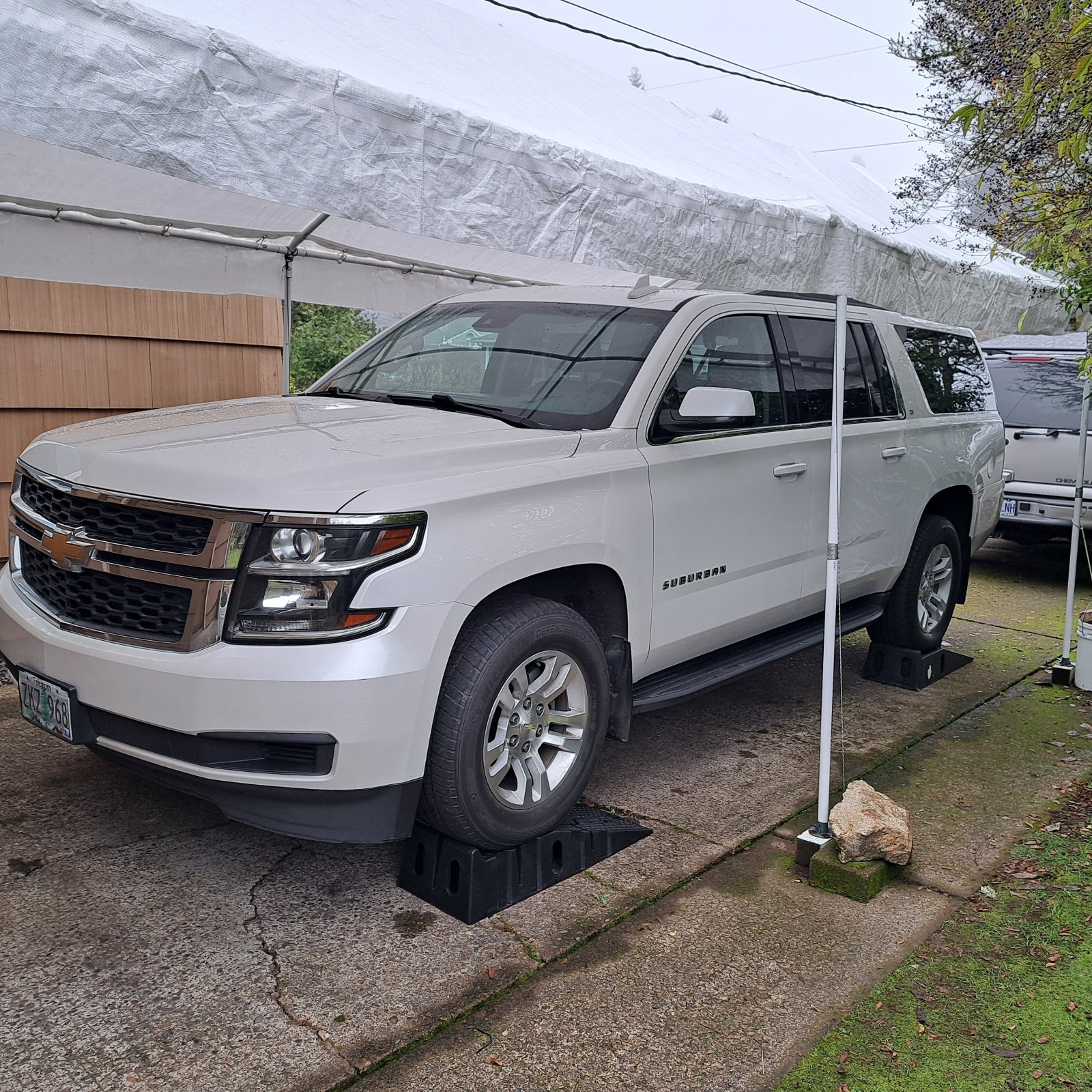

Finished the 2018 Suburban today. Sorry, no pics. cramped quarters under there and just wanted to get done. Was working in 40-42 degree weather. Removed the 2 nuts that bolted the transmission mount to the crossmember and lifted at the transfer case and then had enough room to unbolt and remove the transmission pan. The deep end of the pan was completely open and the exhaust was close to the shallow end. I had my normal round drain pan but had recently bought a much larger round catch pan that had holes in the center and it set on the drain pan and I did not spill a drop. When the deep end of pan was down, I started pushing up and ten releasing it and when it dropped, the fluid in the deep end sloshed out to the catch pan. Then it was almost empty and very light and easy to snake the shallow end out between the exposed transmission components and the exhaust. Pulled it all out and wiped it all down and installed new filter and the gasket surface at the housing was dry and I attached the holder tabs and set the pan up and started all the pan bolts. Tightened back and forth. lowered the transmission and reattached at the crossmember. It took exactly 6 quarts of Dex VI to bring to full when hot. Took off of the ramps and then rotated the tires and road test went smooth. Planning on a 30 mile road test over the next 3 days. Landlord back on the 29th.
At the end of all this, with my discount on parts and the labor fee I charge him, the total will be in the neighborhood of $2500.

The transmission fluid was very brown but there was only slight shavings on the magnet. Very grey but minimal amount, IMO. The fluid had never been changed. I am not, "In the know", about the 6L80E transmissions, so can someone share info about what me be expected in the future for this transmission. Does light towing. Just a flat bed trailer with appliances or furniture on it and a small boat. 50/50 mix of driving. I saw no clutch material but I know the fluid turns brown because of clutch material and heat.

Took it on a 40 mile road test yesterday and saw the V4 and the V8, changing back and forth.
Well it definitely has it.
I tuned mine out, not because I was afraid of it being unreliable, I just didn’t like the lag of power when passing on the highway. Although I tuned mine out, I still have the mechanical DOD lifters in my engine and I suppose they could still fail at any given time.
You’ll get a lot of mixed reviews as people will tell you to get rid of it, it’s a ticking time bomb. Others will say they’re at 200+ miles without an issue.

I want to talk to him about it when he gets back from Hawaii. He is just over 97k miles and runs great but I hear the stories. I will recommend he get it gone. How is it "Tuned Out"? Is it something that a talented enough tech can do with a scanner? Needs a pre-programmed PCM swapped out with Black Bear Performance? Attach something at the DTC connector? Or something else? I am in the dark because I own a 2005 Tahoe Z71 and do not deal with it. I did see this yesterday during the 40 mile road test and could feel the difference when it was switching.
