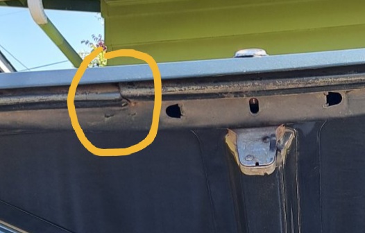

Trunk lid problem? What do you see that I don't?
Two things.
The first may just be the way the light reflection is, but around the latch mechanism not sure what's going on there.
The other thing is that seam and area just below it that I circled in the pic.
It's a nice car. Parts of it have been restored/replaced/upgraded. Not knowing the history of it (owned since new, bought restored, etc) and it only showing 16k miles, it'd be interesting to know more about it and would also determine about how much it's worth.

I did see the circled part when I looked closer after your comment. Gonna list at CL and FB first and then at B.A.T. depending on the money offers. Thanks for the info though.

Two things.
I did look at it today and the latch looks normal, so I am thinking light causing the look. The split seam you see is where the trunk seal meets. It is rubber on each side of split.

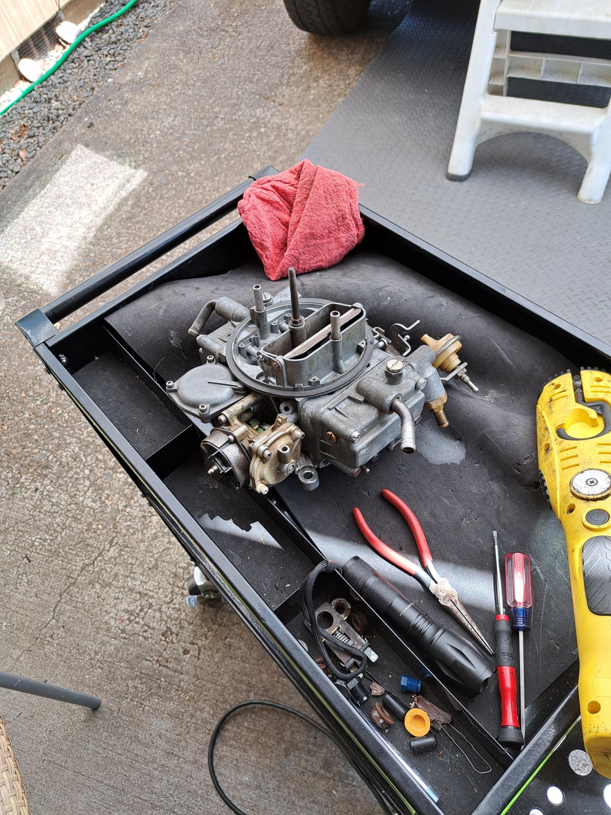

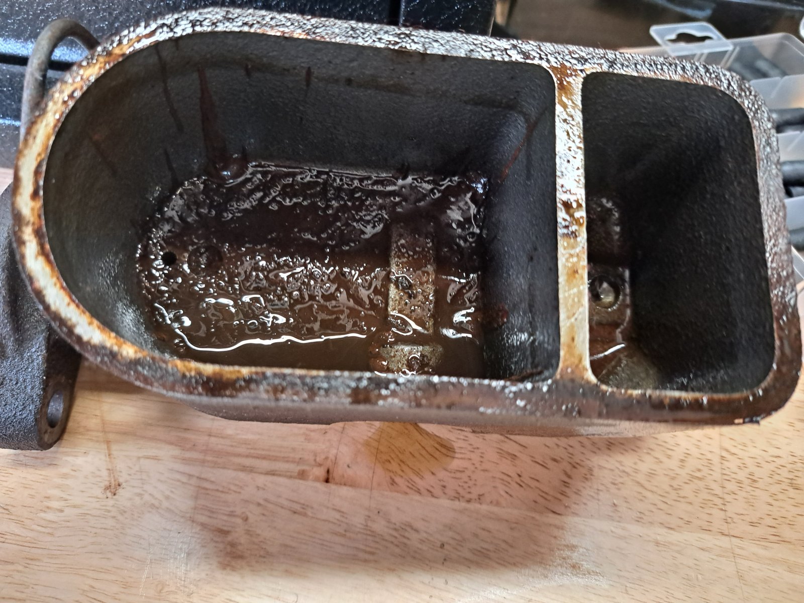

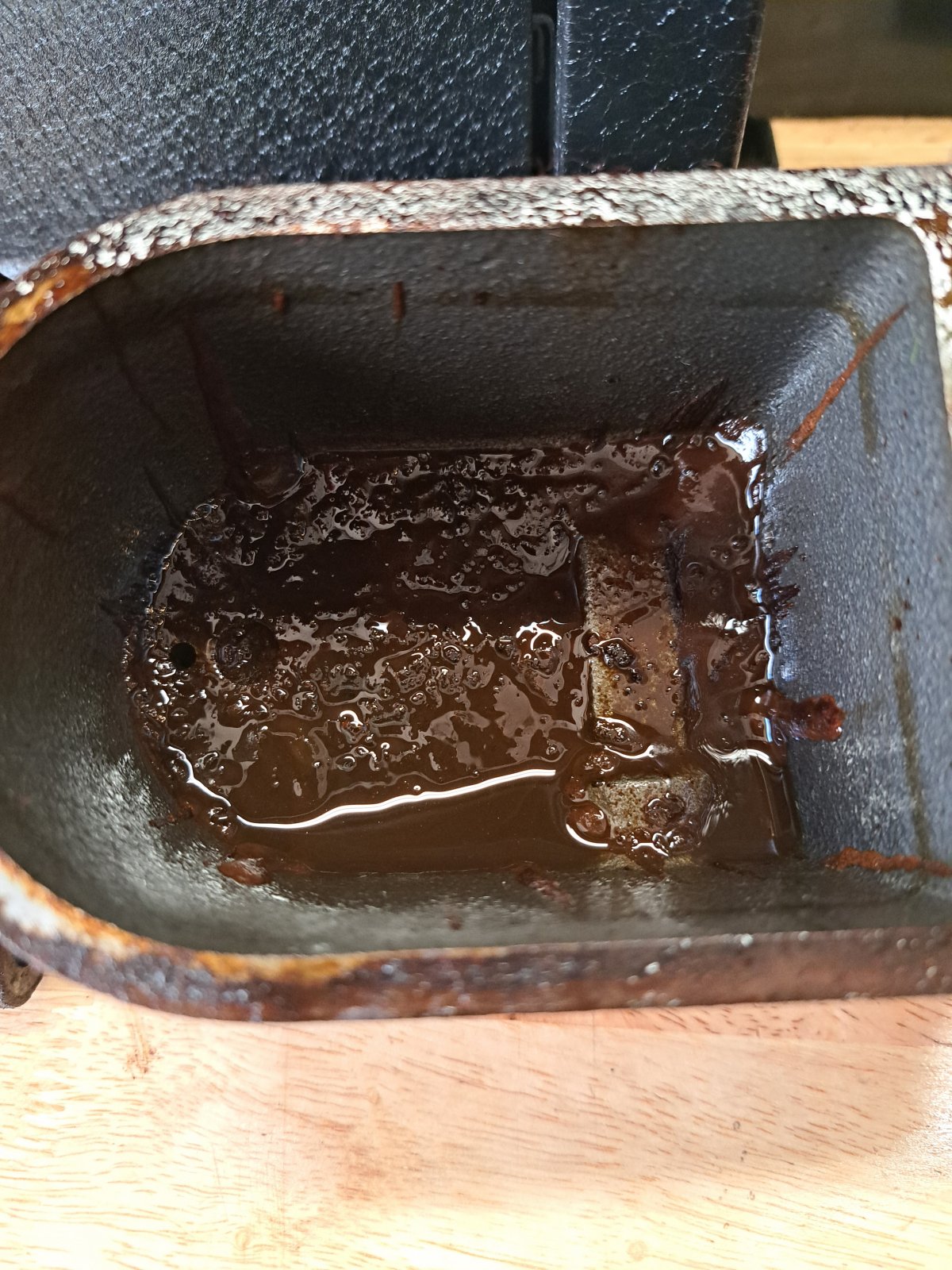

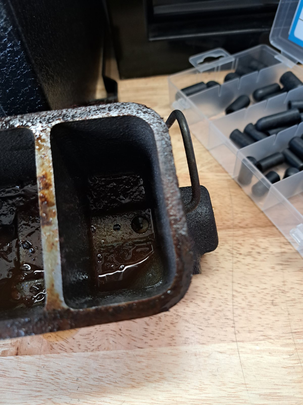

So, I did get that 1985 Ford F150 pickup here Saturday afternoon. As usual he added other work "while here".
Squeal noise when starting, that turned out to be a very loose set of "V" belts on the alternator and power steering. Especially the alternator. I could turn the alternator pulley by hand easily. The tensioning bolt was hidden in the backside of the lower bracket and was a PITA to get a socket on it because so close to frame rail. Fortunately I have a stubby 3/8" drive ratchet and was able to get it tensioned. Been a long time since I have tensioned "V" belts with a pry bar and ratchet.
Next add on was installing his brake master cylinder. The real clue that it was needed was the obvious brake fluid leak at back of master cylinder that had been going on long enough to allow the brake fluid to blister the paint on the booster. I removed the master cylinder in front of him, with lines attached, and there was a rusty mess at back of cylinder and in the plunger rod pocket on the booster. Biggest PITA was that the attaching nuts at inside firewall were rusted badly and took my 3/8" pistol grip Milwaukee impact to take them off after I broke loose by hand. Then the 4 studs were corroded in the thru holes and had to encourage the booster to let go with a pry bar on the outside and a hammer on the inside at the stud tips. Mounted the new booster, bench bled the m/cyl. and installed and then bled at the attaching lines and had a good pedal. Before anyone asks, yes I did measure the hole depth at back of m/cyl. where the adjustable rod sets in to and I also adjusted the adjustable rod to match the old m/cyl. I also did a new stoplight switch while apart.

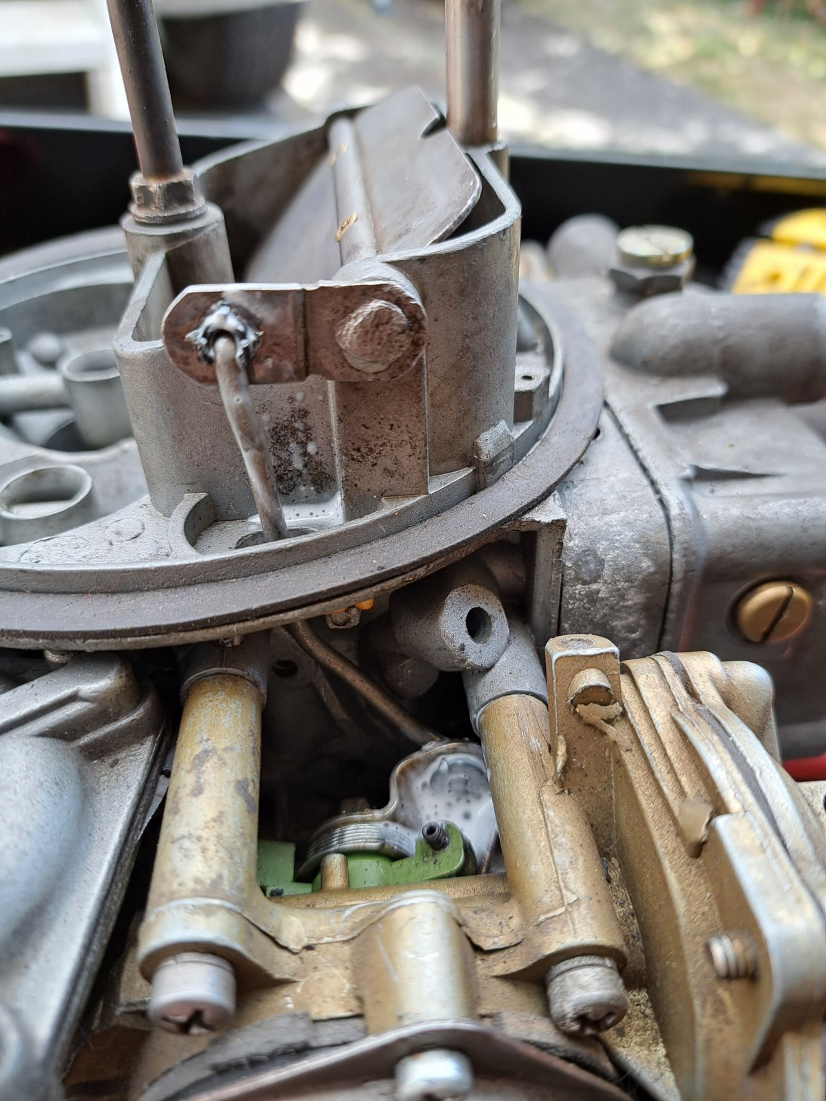

Then on to the carb. I did a cold start and sure enough the choke pull off was inop but did have power to electric choke. I knew I wanted to adjust the fast idle up on that cold start. The adjusting screw was angled down and while I was trying to bend over the back of carb and adjust that screw I found could not get a screwdriver on it but then I also noticed that the linkage from the pull off to the butterfly was not attached at the bottom. Could not reattach while on the vehicle so I removed carb. Worked on the carb on my roll cart and had to hold a small flashlight in my mouth to see down in there. Was a large PITA. Adjusted the fast idle, reattached linkage and lubed and reinstalled. By that time the owner had showed.
Did a cold start, set the choke with gas pedal, started engine, went right to fast idle and the owner said had never done that before, watched as ran and saw the choke open up the butterfly plate and stand straight up and then kicked down the throttle and went to curb idle and I adjusted that and road tested. All good.
4 hours labor at $75 an hour and $300 in my pocket. Told him I am not working on that carb again. You can see linkage that was unattached at bottom in the pic. You can see the brake fluid sludge too. I tore this all down on Saturday afternoon and installed new parts on Sunday morning.
Turns out, the next door neighbor wanted to buy my girls K2500 pickup but she does not want to sell but it turns out that the Ford pickup owner, that I worked on his 97 K1500 last week, is gonna sell that truck to next door neighbor and I am gonna do about $800 work on it after he buys.

This truck has numerous emission control components hanging here and there in the engine compartment. Disconnected one by one.
The carb removal and linkage fix was definitely a blast from the past for me. All I know is that I fixed that linkage, reinstalled the carb and when I set the choke and cranked the engine, it fired up and ran at fast idle. Had not done that for me since he dropped off for the cold start problem. I then told him I am not working on it any more, carb that is.
