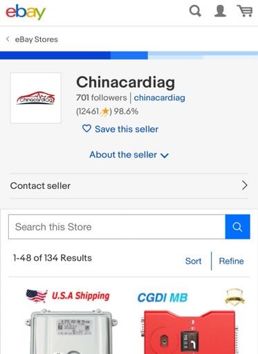

That same seller is on eBay however they do not sell the Tech II there. I got my Tech II from their shop in China without issues last year.
https://www.ebay.com/str/Chinacardiag/Car-diagnostic-tool-/_i.html?_storecat=3025941013
