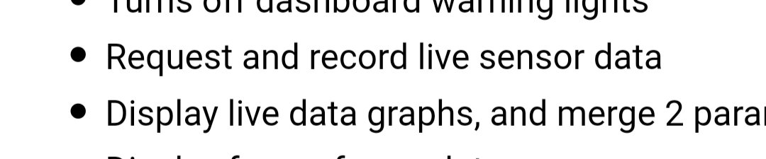

I'm thinking of buying this Vident scanner for my 2006 Suburban:
Am I going to be able to read live feed ac functions?
So going by that statement I'd say yes.

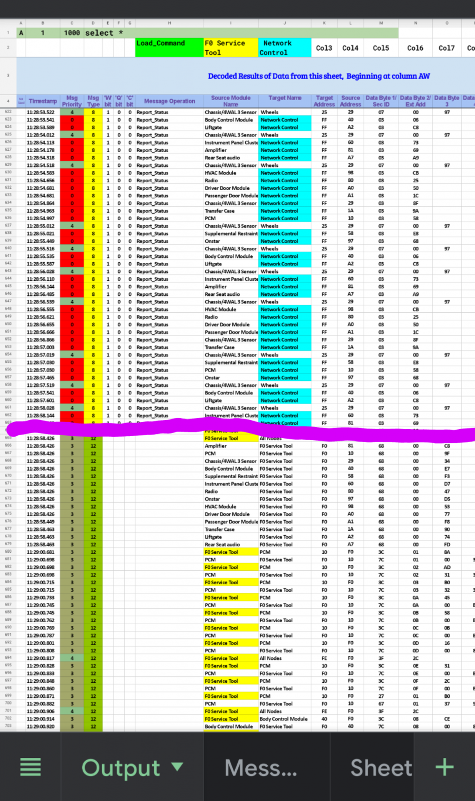

When requesting SPS data, (which is done by reading specific data blocks in the control modules) the Tech 2 first issues a "test tool present" message to all modules on the network. This is followed by a directive for all modules to cease normal data traffic. This cessation of normal traffic remains in force as long as the Tech 2 repeats the "test tool present" message every few seconds. And of course without this traffic the cluster can't display all that data that is normally sent to it through those normal messages on the class 2 data bus.
Here is a screenshot that shows the normal traffic seen above the purple line. Below the purple line only test tool requests and the respective module responses are seen...

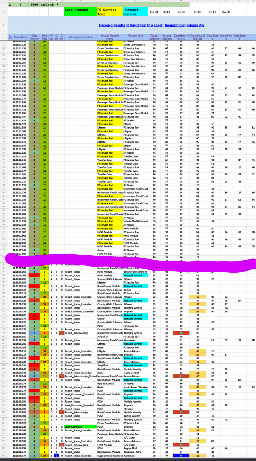

After the Tech 2 has gathered all the calibrations and such from the various modules it stops sending those "test tool present" messages and the "All Quiet" directive expires and each of the various modules resume operations. As a part of this it seems the cluster resets itself. Seen below is the network resuming normal operations beneath the purple line...
I was able to duplicate the cluster behavior by sending the "All Quiet" command myself using my Android phone, a bluetooth OBD2 adapter and a serial terminal app, and allowing the command to expire, causing the cluster to reset.
And so it looks like your Tech 2 is now working as designed.

The screenshots are of a Google spreadsheet I made while learning how to read the GM Class 2 serial data. It has become a hobby of mine that was the result of working with my TrailBlazer but is also of use with my 05 Yukon.
