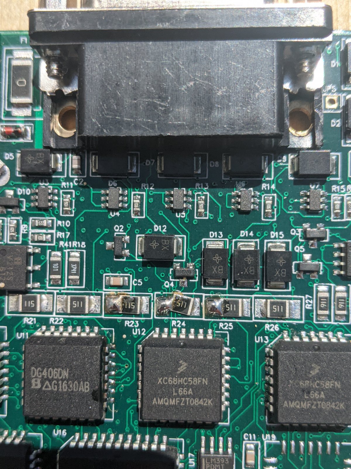

So I could resist no longer and opened my own VCI to inspect. When first I received it the unit passed all tests. It now fails 2 sub-tests, TPU 12 & 15 and MUX 4WAL of the level shifters. These failures don't seem to have affected my use of the Tech 2 at least as far as I am aware.
No jumper wires seen in mine but I did find some rework had been done as 3 surface mount components had clearly be touched up.
looks like mine. I have touchup in the same area! I am not home now but can get a pick when I get there.
That's some rough looking touchup!
