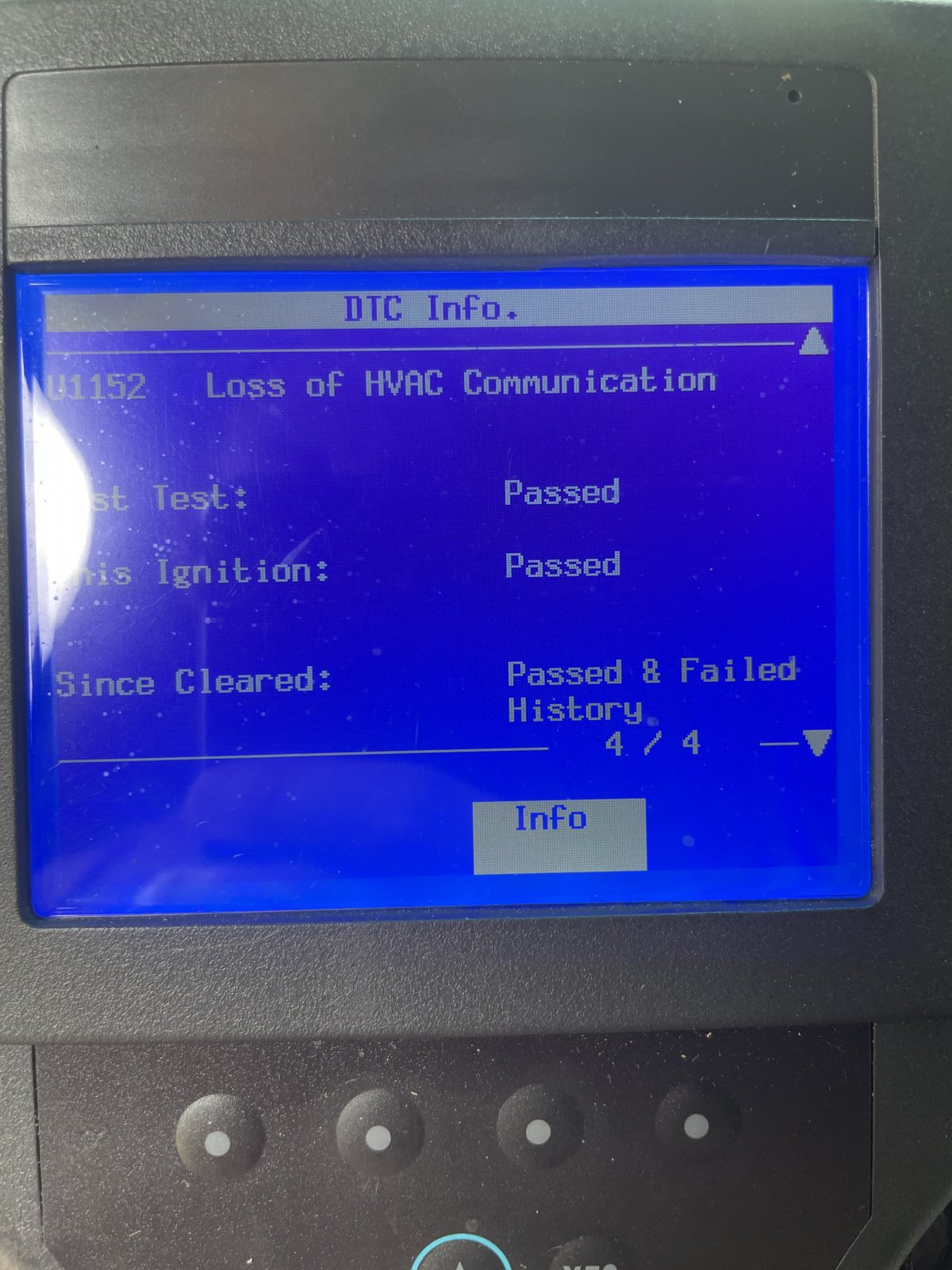

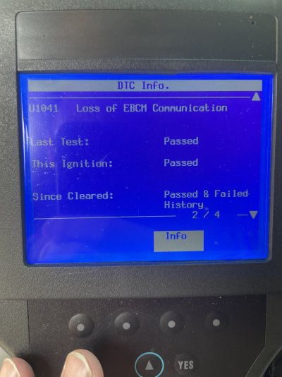

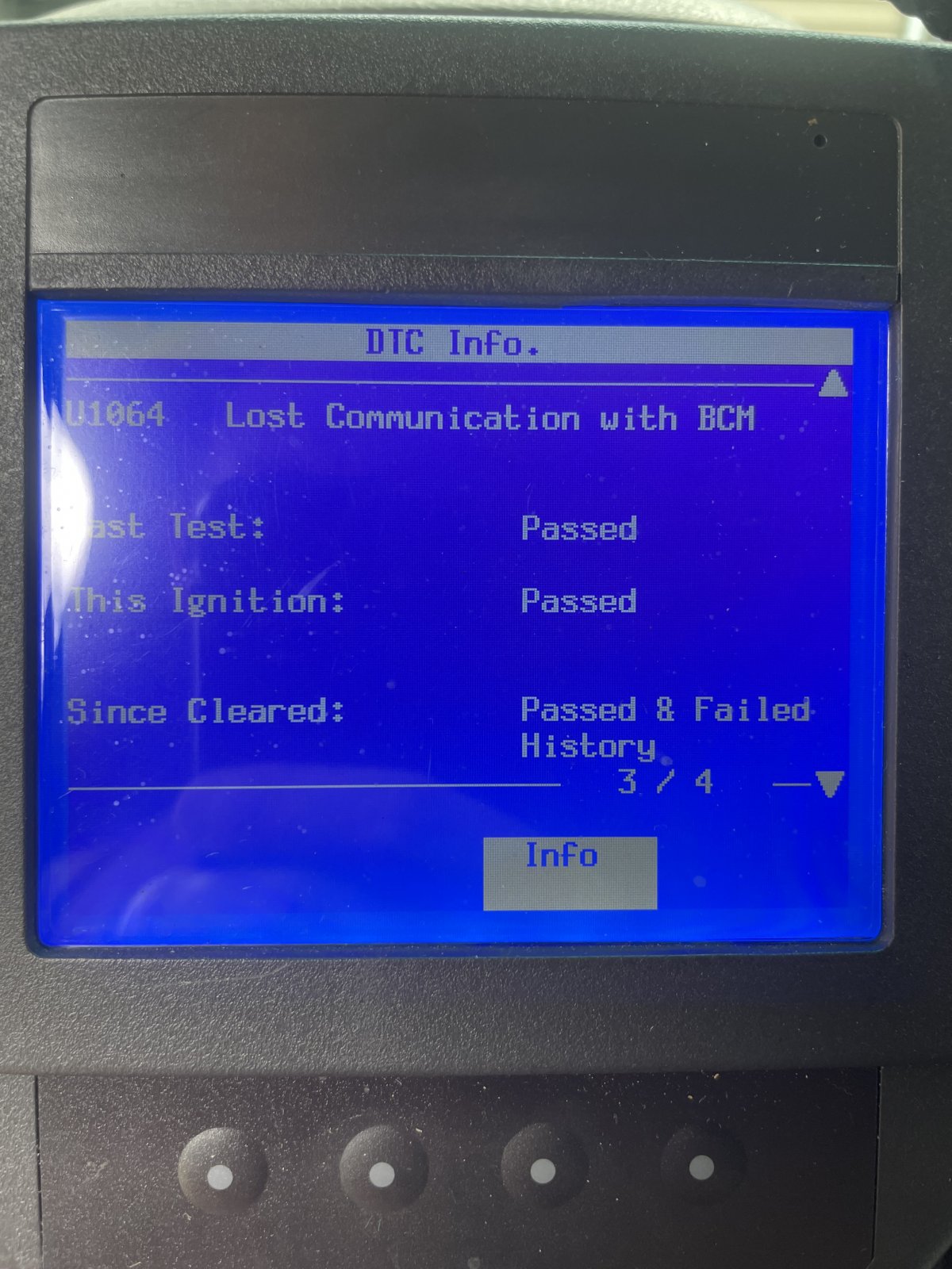

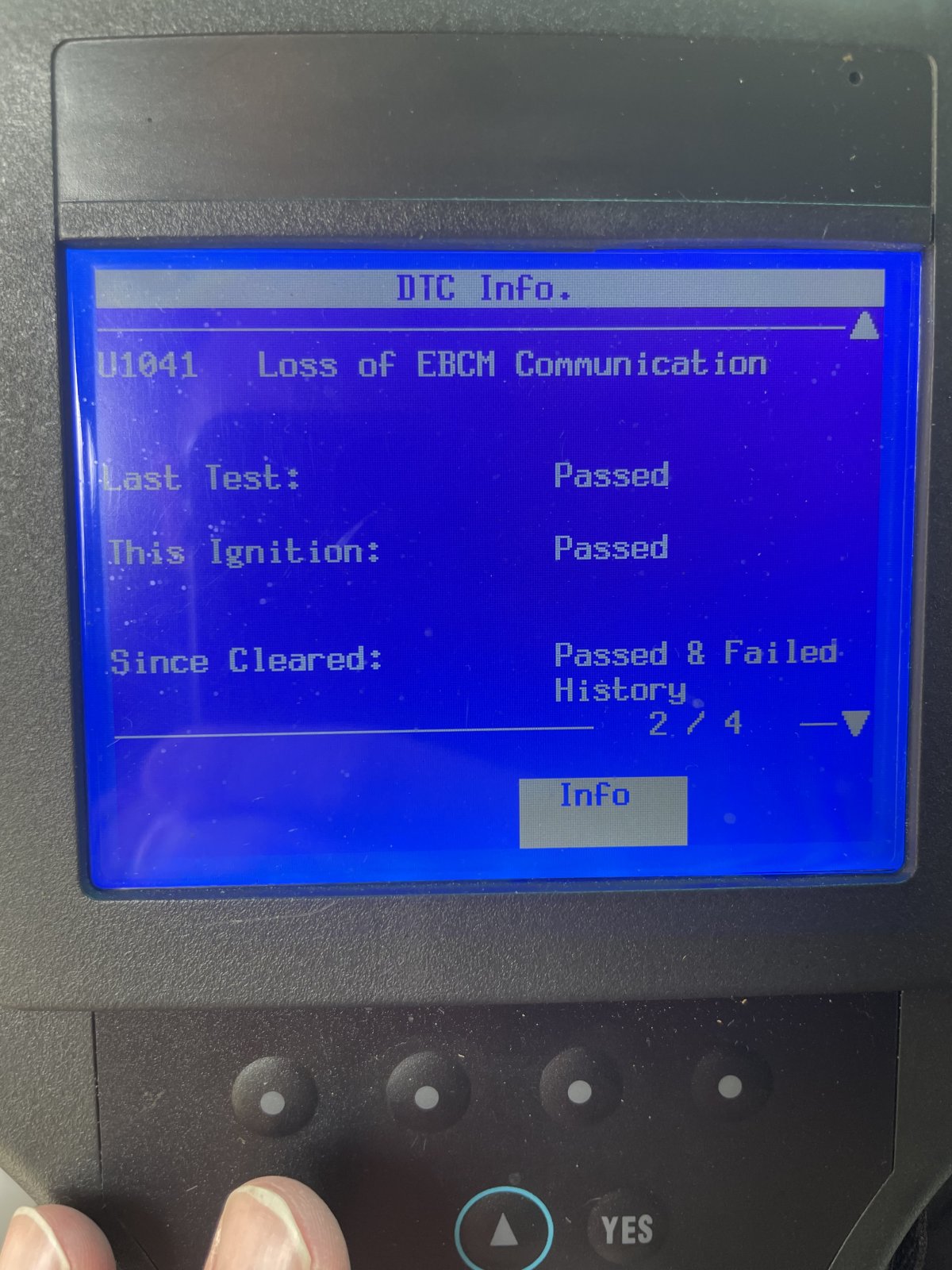

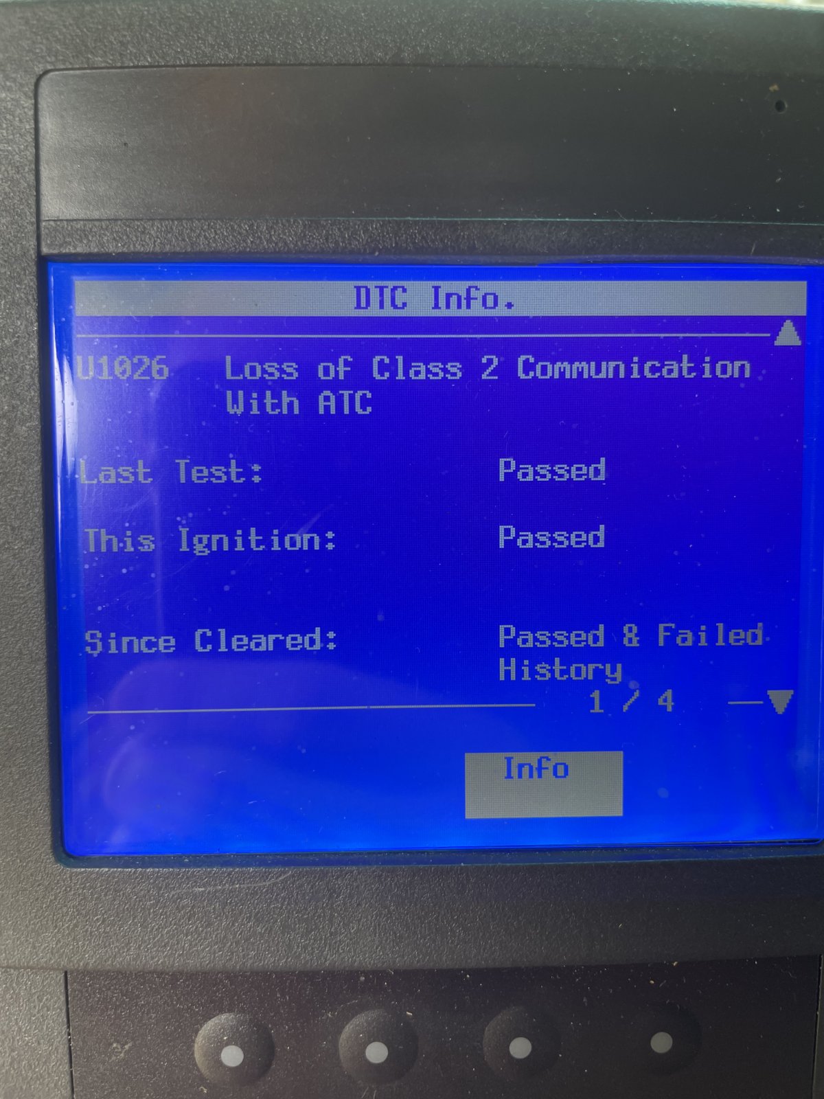

Here is a video I made. I also snapped photos of the codes produced. Is there a way to test if the VCIM of the Tech2 is shorting the serial data side to ground?
TJ Baker
Mar 5, 2018
282
356
Colorado
I will do some retesting today. Just by looking at the video I would say the gauge sweep to zero you have there is NOT a cluster reset of the sort that I have seen from a power loss. A power loss reset I think moves all needles to zero much more rapidly.
I have recently tried a 'short to ground' of the serial data line and I don't think it did what yours is doing. But I want to recheck.
The codes make it clear... something IS fouling the data bus. You are reading the PCM saying that it has lost comms with those modules. The "Unknown Driver" message is a direct result of a loss of comms between the BCM amd the instrument cluster.
