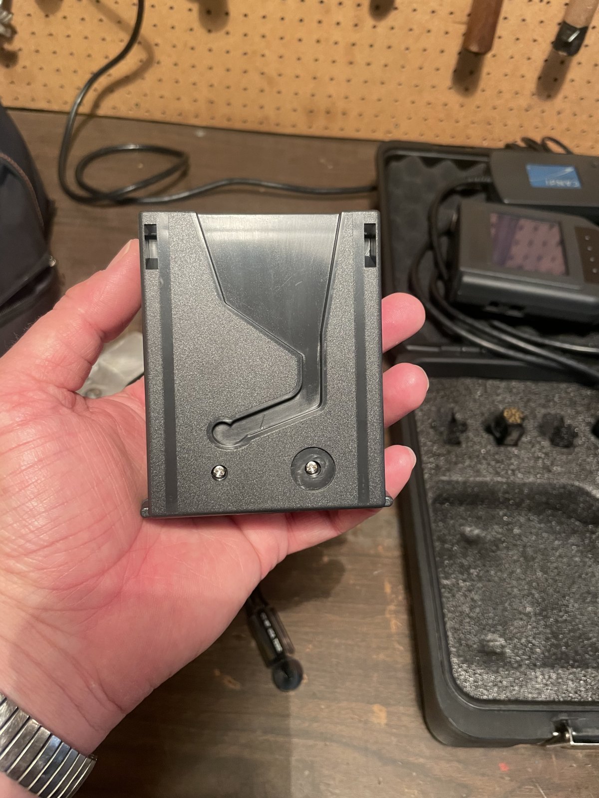

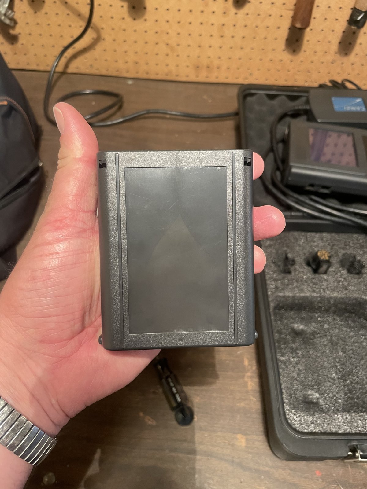

@kbuskill would you look at your VCI when you get a chance. I found this page that discusses an issue with the VCI. Mine lacks the QC mark near the top.

When connecting to our 02 Envoy it also takes several power cycles to connect. When it fails the DIC in the cluster indicates “Unknown Driver”, the security warning illuminates and all the gauges go flat. When I power down the tech2 all is well.
Does it matter what operation you are attempting, ie: SPS vs Diagnostics etc.?
George B
¯\_(ツ)_/¯
Feb 5, 2020
7,882
18,994
Oconomowoc, Wisconsin 53066
The issue occurs when first connecting. With the Candi it doesn’t see the candi and without it doesn’t connect to the vehicle correctly. After a couple tries it connects and all seems to work ok.
But I don’t trust it to not brick something on me someday.
