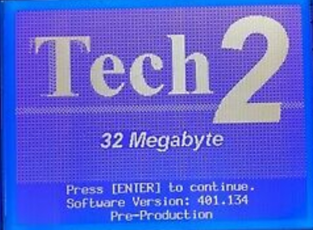

I didn't even know the versions went this high.

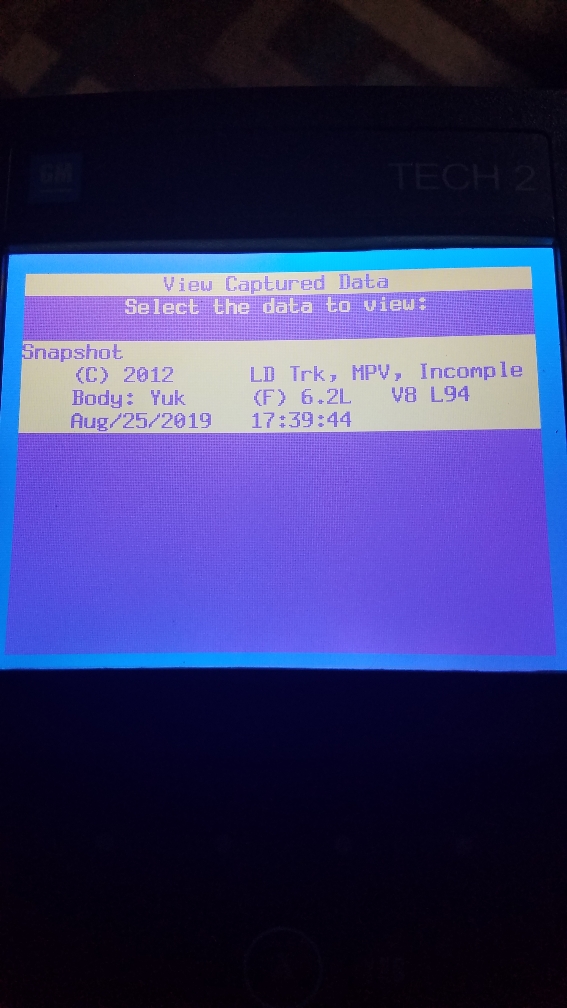

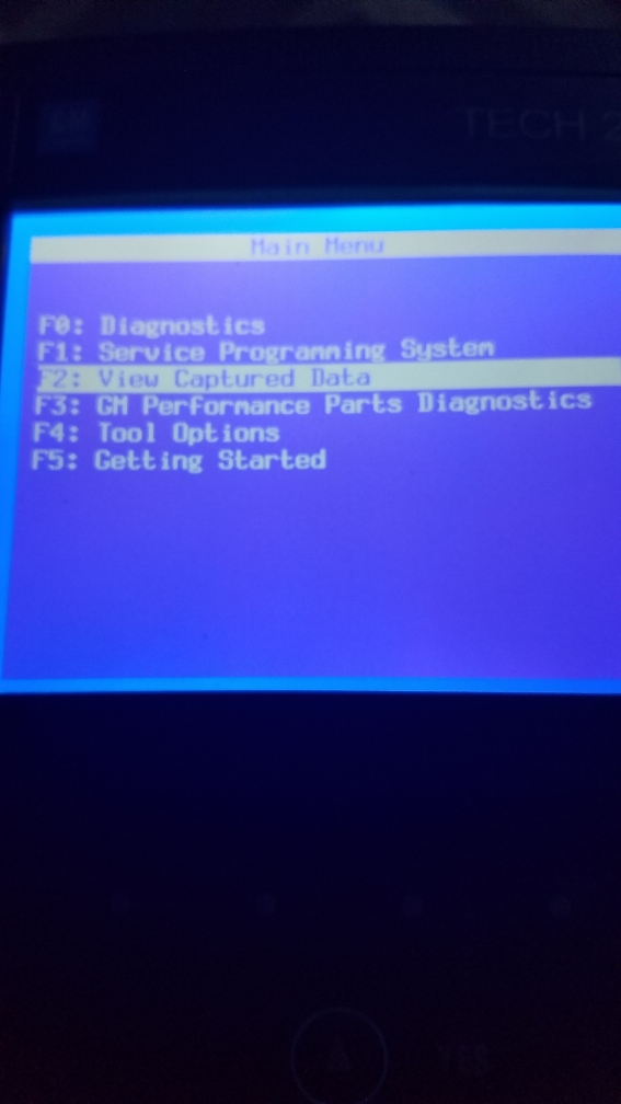

On the main menu there's option #F2 to view captured data and my snapshot data should be in there from 2019. I can't figure out how to clear/erase this. I also don't know if this is stored on the card or on a chip inside the Tech2 device.
I'm guessing if you can bring this capture up on yours then it's stored on the card

I was just now playing around with it hooked up to TIS2000 and couldn't find a way to delete it, only to download it from Tech2. I did save the file to my hard drive through TIS2000 just to see how big the file is, and it's only like 217kb. It's a transmission parameters data capture that's about 3 minutes long and 44 parameters, so really not that big size wise.
Just curious now if it saves these to the card or elsewhere in the Tech2
