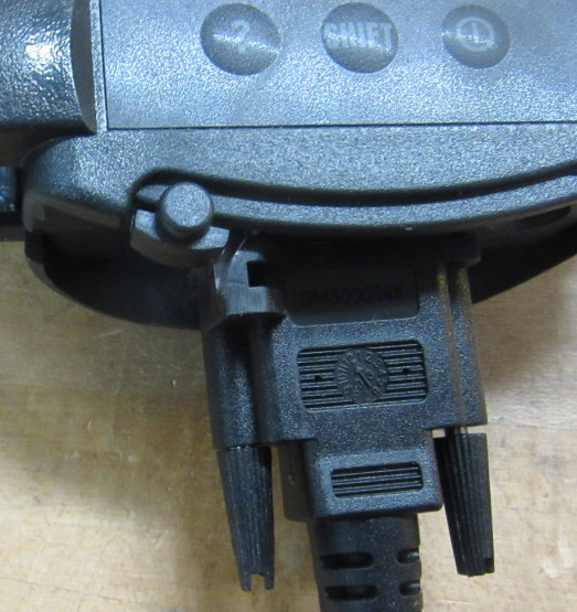

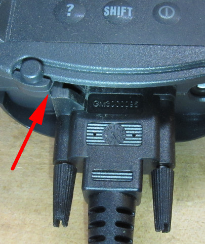

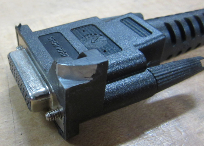

Only thing I've noticed on mine is the connectors are super tight and I can't get them to actually "latch" together. That little metal latch gets about a mm from actually clipping into its slot. When I first got it and noticed this I used dielectric grease on all the connectors/pins to help make it easier to assemble the cables

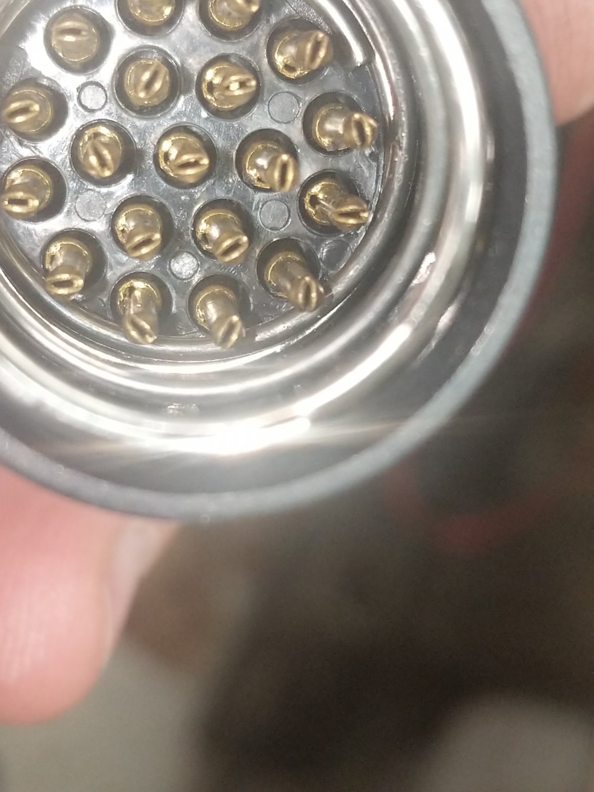

So I just tried ringing out my DLC cable to 16 Pin OBD2. Glad that I don't have any Canbus vehicles or this would have given me fits. 2 pins of the 16 on the OBD2 end have lousy connections through the 19 pin Burndy on the DLC cable. #12 & #14, #14 being absolutely needed for Canbus. Tried cleaning with electrical cleaner, removed the faceplate of the Burndy and removed the damned spring even and still no go. Would never trust that for programmimg.
EDIT: I wrote this wrong below, the defective part is the adapter, not the cable.
I think the defect is the DLC cable portion, on close inspection there are two areas crimped in a little to grab the inserted pin(s). The two I have issue with don't appear to be crimped deep enough to make good contact with the pin(s). The result is intermittent connections...
https://youtube.com/shorts/scy6yv5zPzA?feature=share
TJ Baker
Mar 5, 2018
282
356
Colorado
I have an update... I looked a little closer and discovered it is not a crimp but there are 2 wire like clips in there. With a flexible backprobe needle I am able to poke behind the clips making them tighter. It may "fix" this....

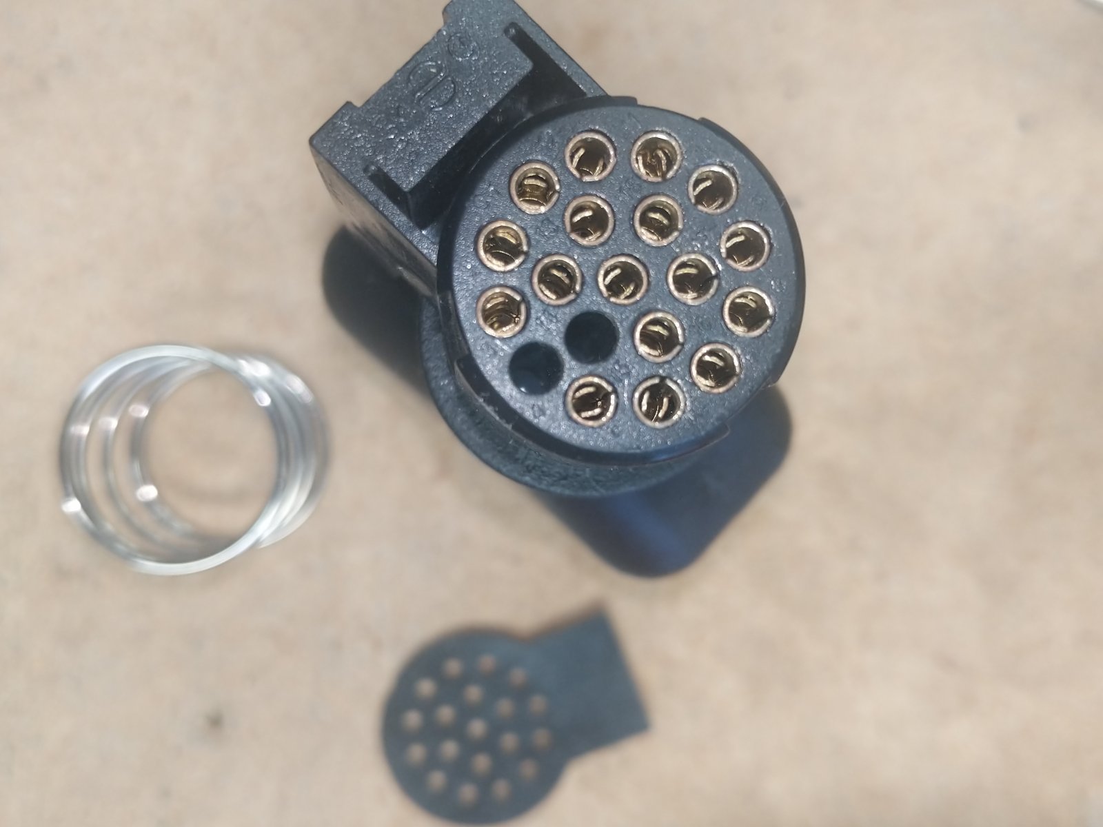

Got a better PIC of the "pins"
This what I have right now. About to retest. Getting that spring out is difficult, I 'screwed" it out with needle nosed pliers. I like it much better without the spring but it did not help the poor connections.
