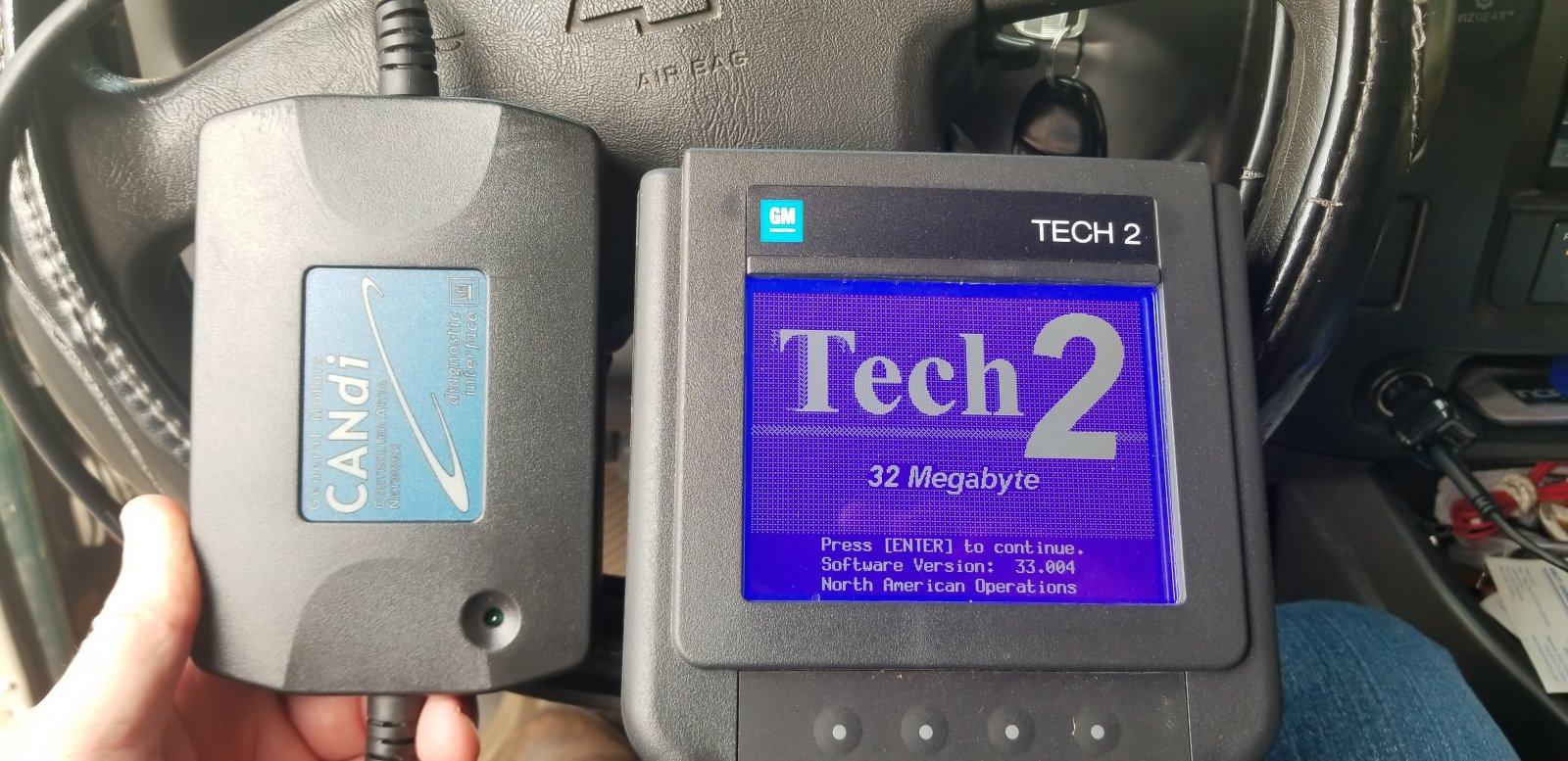

Should the light on the Candi module be lit at all times?View attachment 262221
It lit up for a sec then didn't anymore.
It should be lit up and or flashing and then show up on the splash screen as being connected which yours is not showing. Good news though, you do not need it for yours Tony, so unplug it and move on.
What does it do once you get into the menus? On my '04, when it's connected to the OBD port, the light flashes while I'm past that menu -- can't recall if it flashes AT the menu you show, but it does for sure after that. It also clicks when I am changing menus and selecting menu items. Mine also does NOT "show" that the CANdi module is connected.
Of course, I don't use it unless I need a few more feet of cable to reach.
