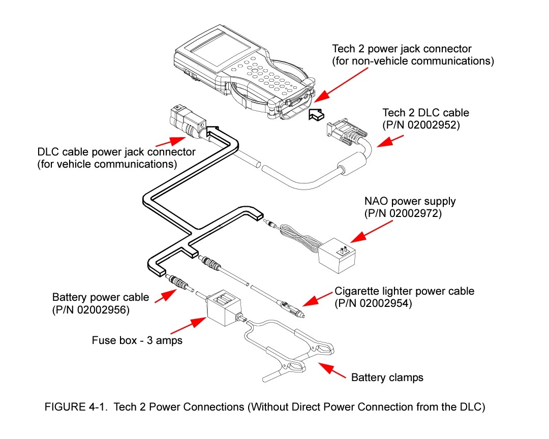

I believe he is talking about the power port on the DLC cable.
I don't have my hands on one yet but from the reading I have done there should be a way to plug in external power at the DLC adapter.

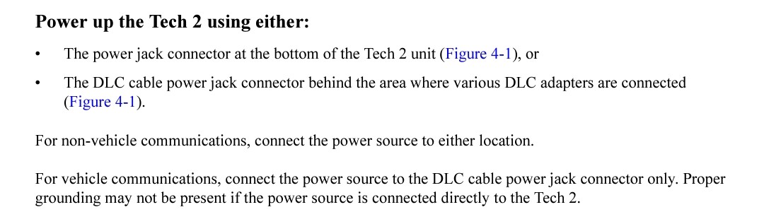

It also says this in the manual...
So for vehicle communication you should actually have it plugged into the DLC cable and NOT the Tech 2 power port, to ensure a proper ground.
Well I’ll be damned. I didn’t even know I could plug it in there which is cool since the dc input on my Tech2 is kind of wonky. Guess I didn’t read that part of the directions.
