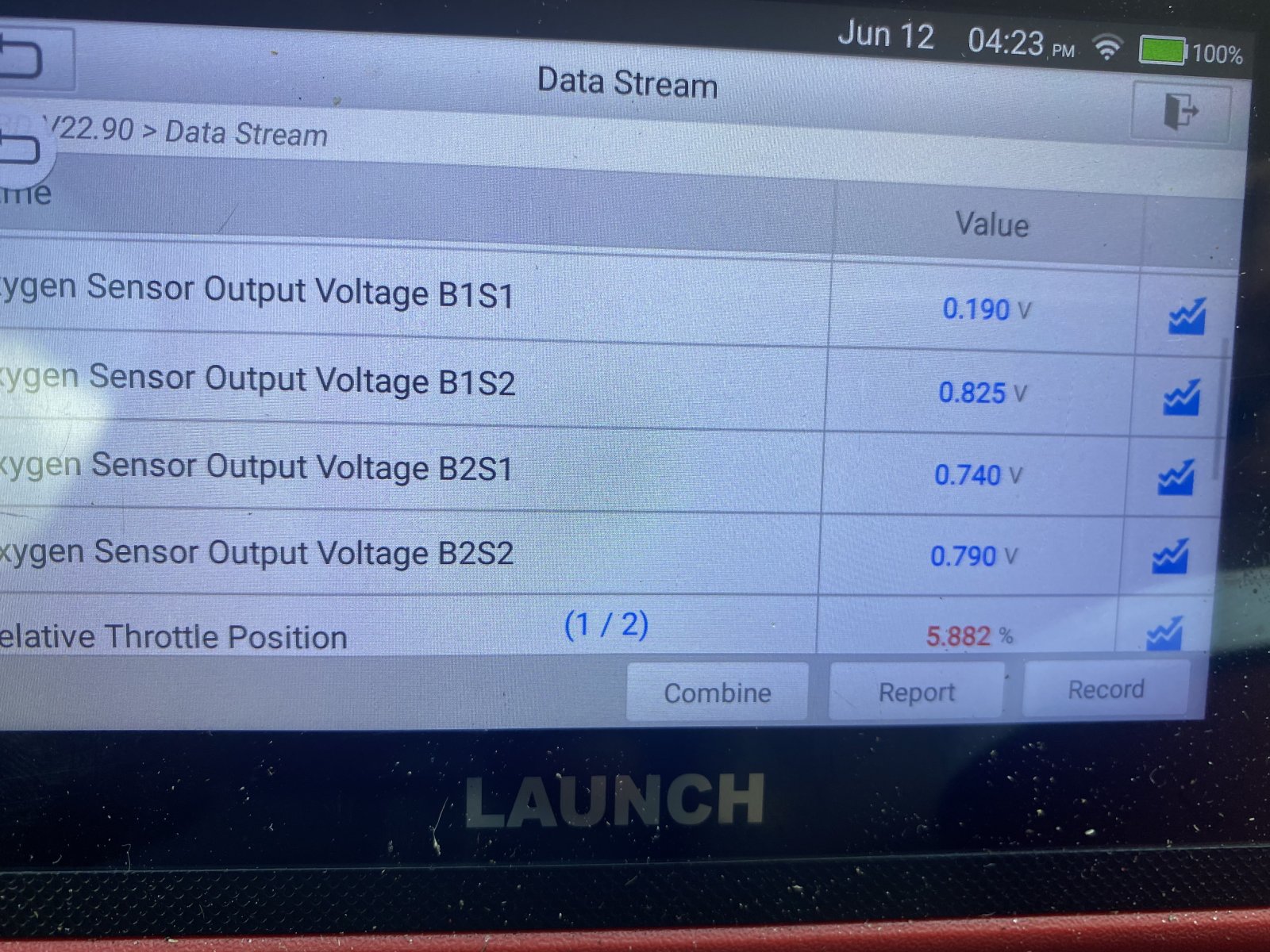

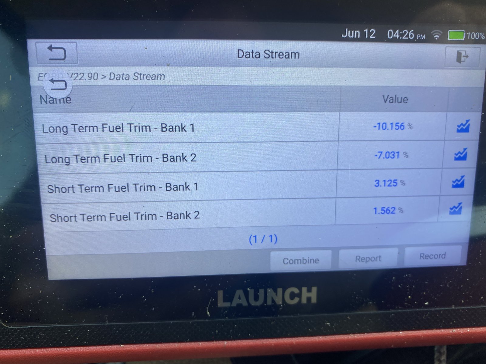

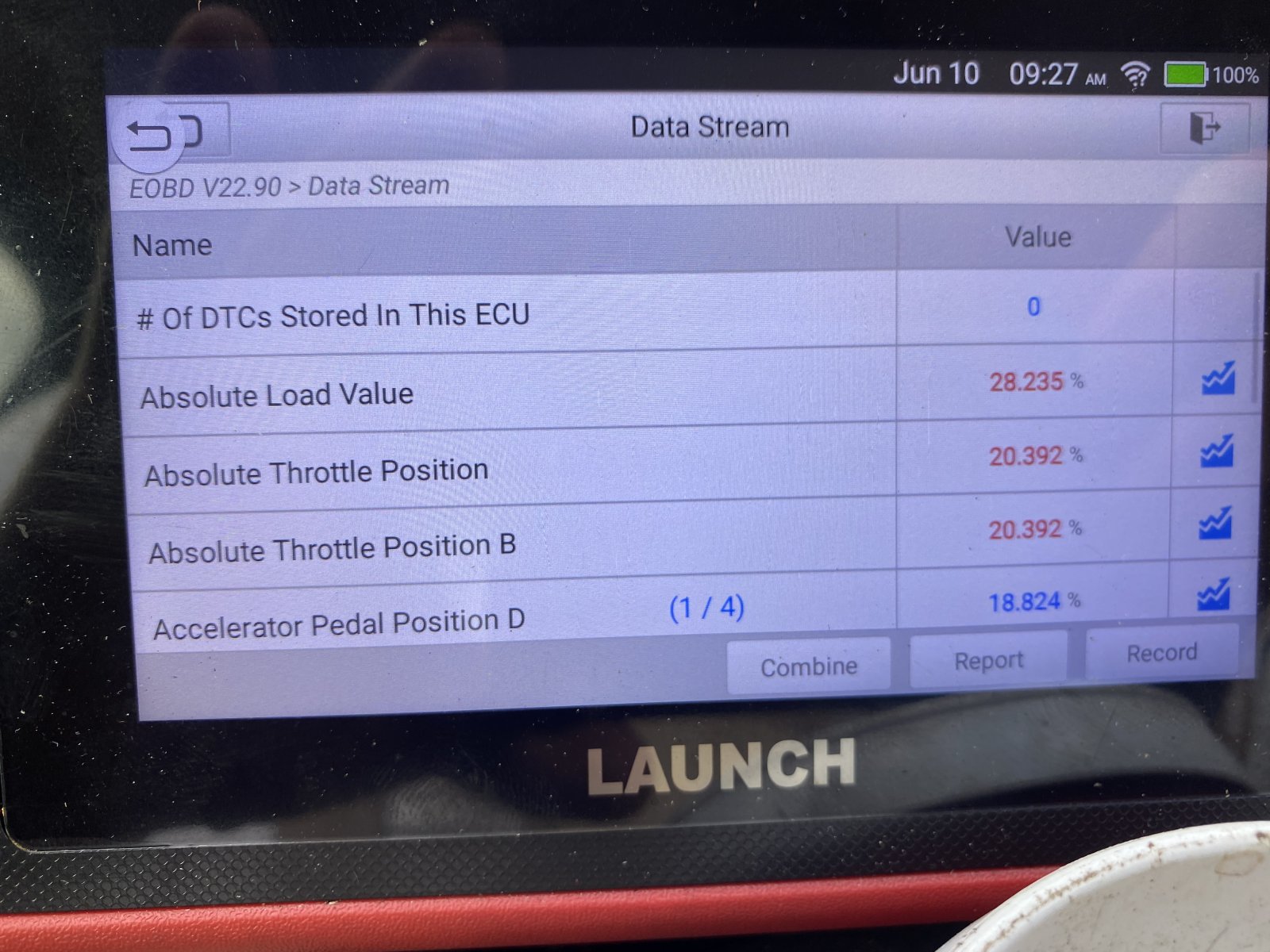

Yes I have been taking my scanner with me on my landscaping route and watching the fuel trims. They look fine. My o2’s also look fine at about 750 to 850. I added a pic of something I don’t understand. The throttle position numbers in the red.

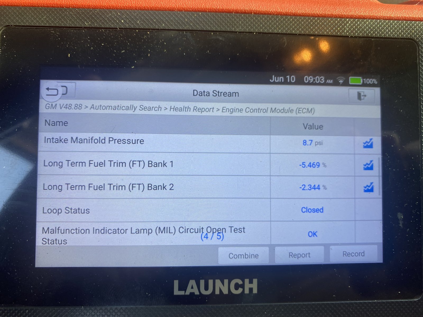

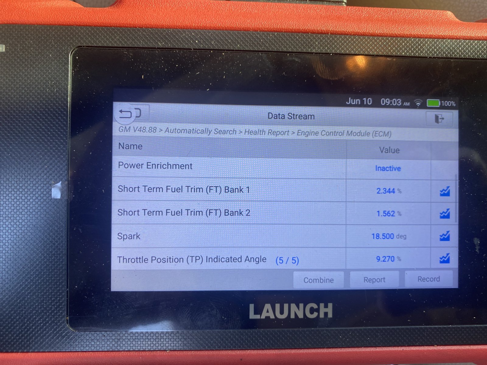

Looks like it's been running a little rich. Besides the suggestions that @wjburken had, have you checked the fuel pressure, key on - engine off, and with it running?
EDIT: can you graph B1S1 to see how much it's moving? Has the MAF been cleaned lately?

What caused you to install the new throttle body and throttle position sensor? Anything particular or were you just pulling the trigger on the parts cannon? Not throwing stones, but it’s always good to know what, if anything, drive previous decisions.
My scanner is showing in red some values for the throttle position sensor. Position A and B. And absolute throttle position at 5.8% at idle.
