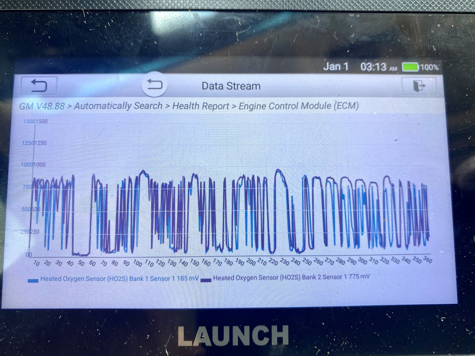

I’m doing the oil servicing this weekend. And plugs and wires and coils as well. Here’s some more O2 data.
21,322
30,319

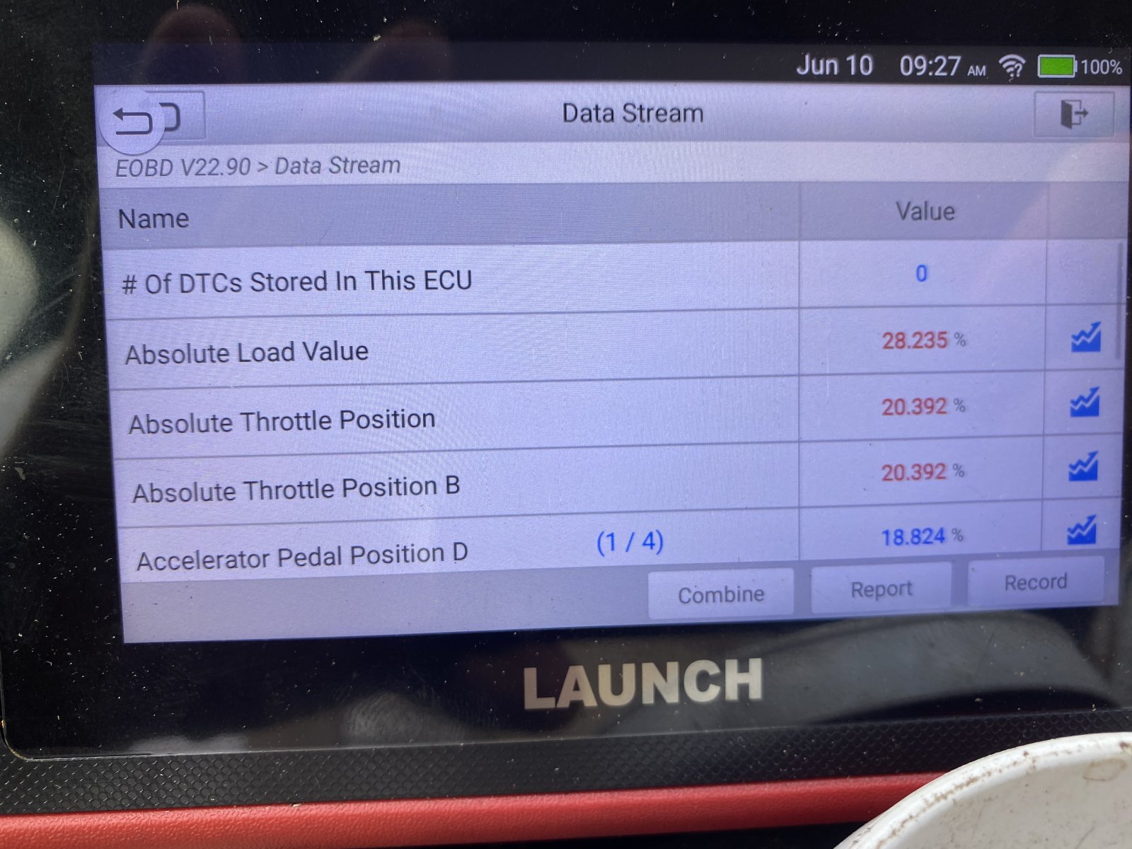

Ok @Chetty mo , have you run the smoke machine on the system yet? I suspect intake gaskets. Try tightening them down first.
Your throttle percent is high and if you took the throttle body off and cleaned both sides and the edge of the plate and it is still too high after a drive then you might consider replacing it.
Definitely get new plugs and wires for it. 748UU is for OE wires and 19417055/41-162 are the current OE plugs. No anti-seize on the plugs and use dielectric grease on the plug side of the wires.
