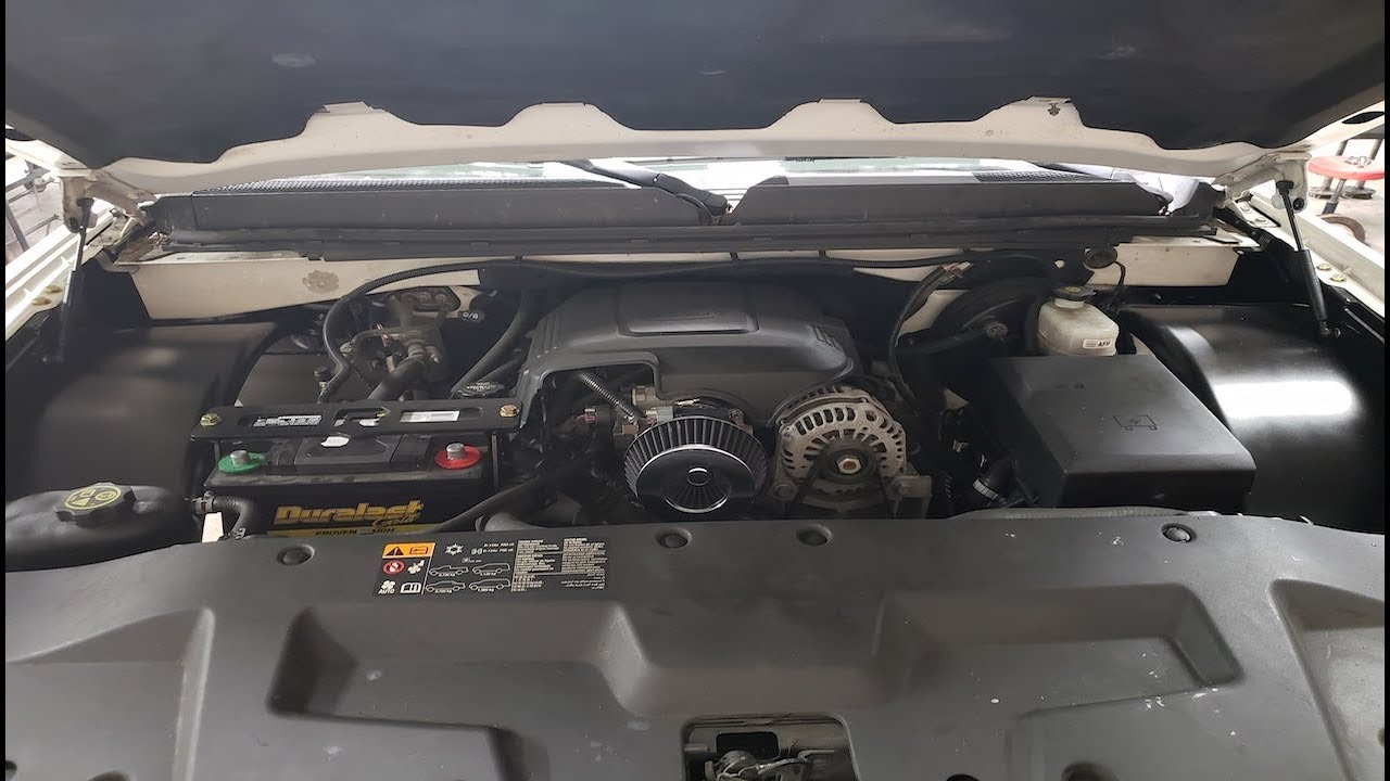

So I had to go back through your thread to see what they did to your engine bay... Different than mine. My coolant overflow is going where the intake box/filter was. The battery will go between the overflow and intake, and then my fuse box was moved closer to the motor...

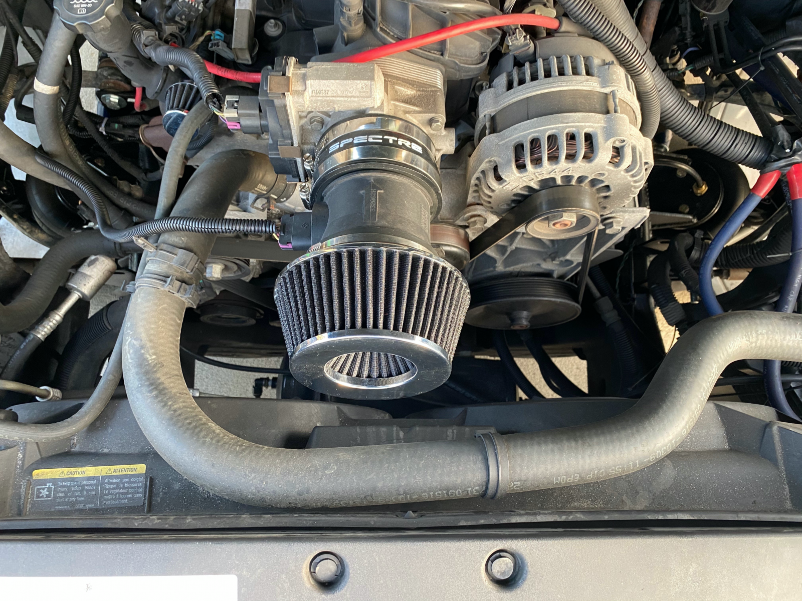

Not my pic, but this is what it's looking like. It's an entire relocation kit from Reklez.
where is the MAF?
My battery is down in the front center low, behind the bumper. What I don’t like about that setup is where the air intake is, right behind the radiator where the air is the hottest. Looks pretty clean though. I’ve been looking at a billet overflow tank to make mine look a bit better, and maybe a better CAI.

interesting, must have pcv hose there also?
Just a band, about an inch wide, enough for clamps. The filter is rubber so it attaches to the MAF with a clamp. Then you just need the band for the other side to attach the MAF to the intake. You can see the MAF in that pic if you zoom in, but that pic is also not formatted right. It’s “squished” so it looks shallow front to back and stretched side to side.

yeah, I think I'm going to have a friend make an intake tube to go straight down and then bend to go in front of the passenger side wheel
