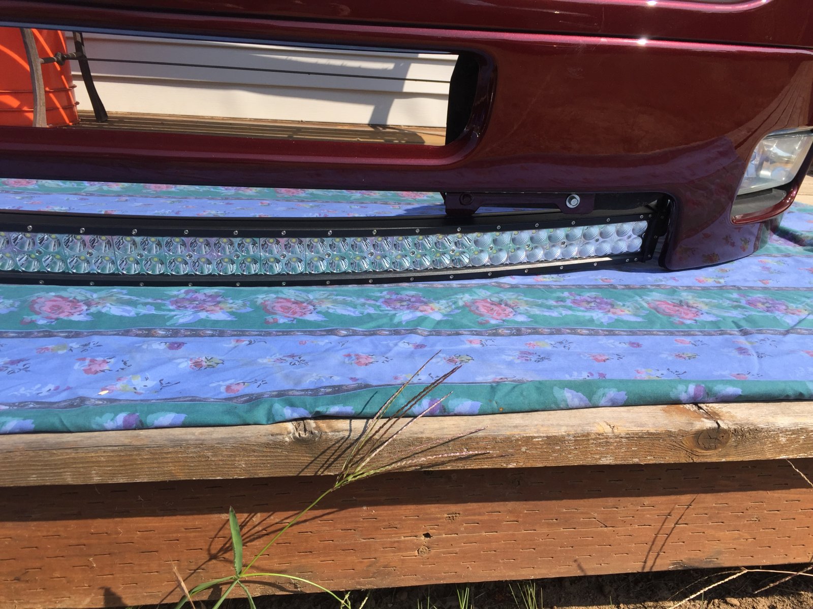

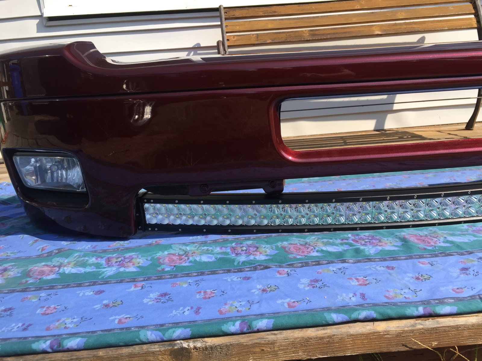

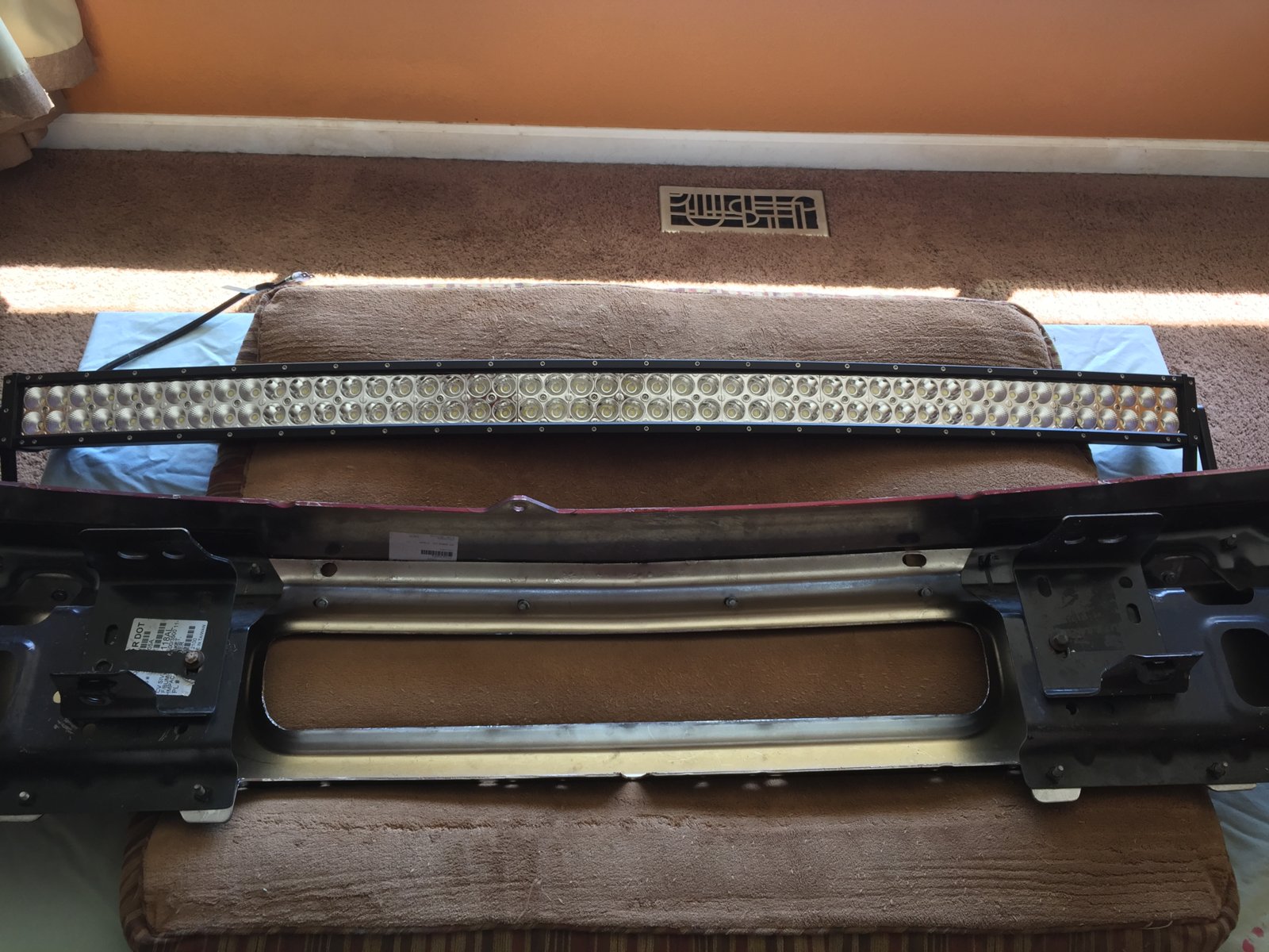

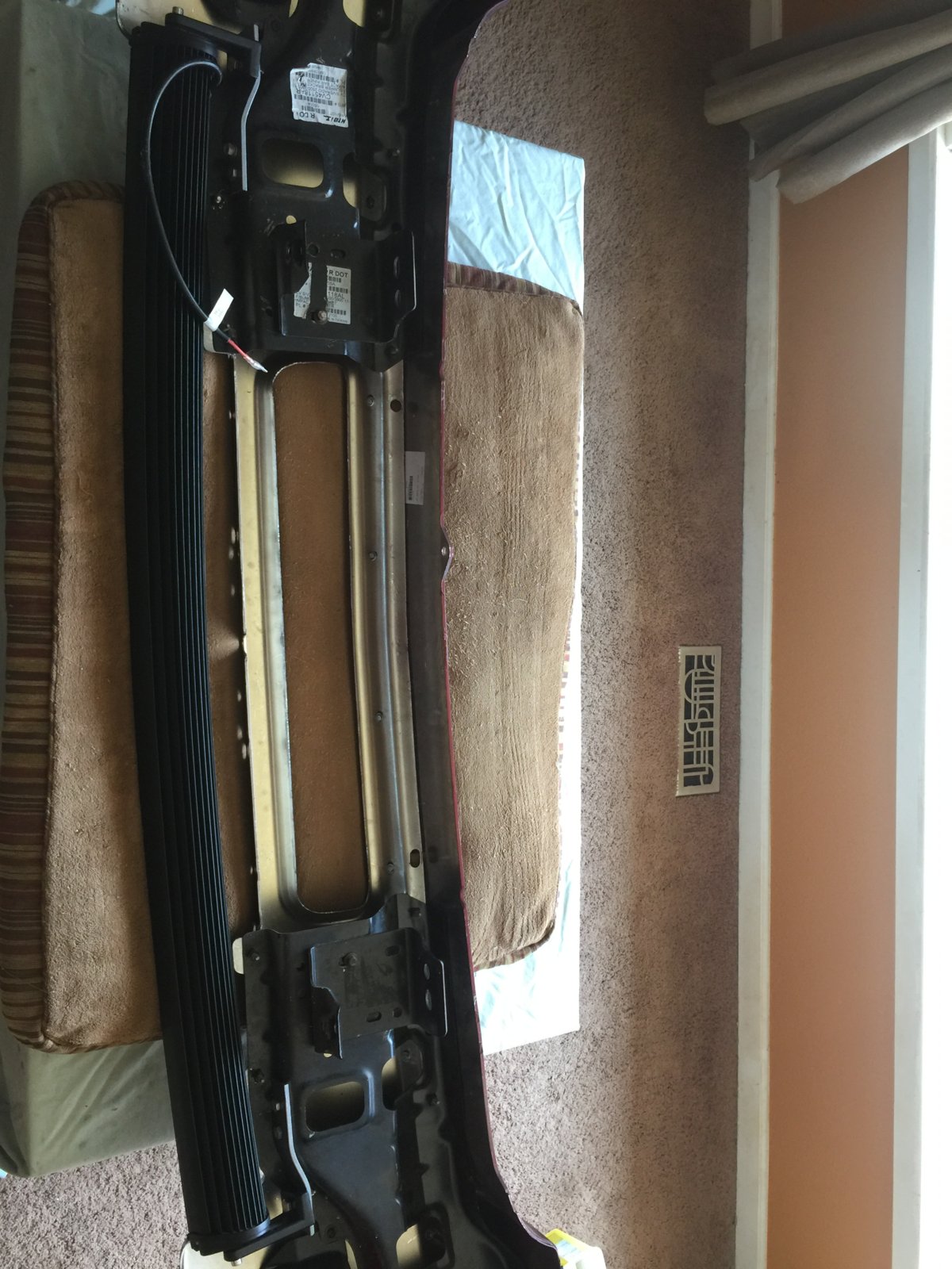

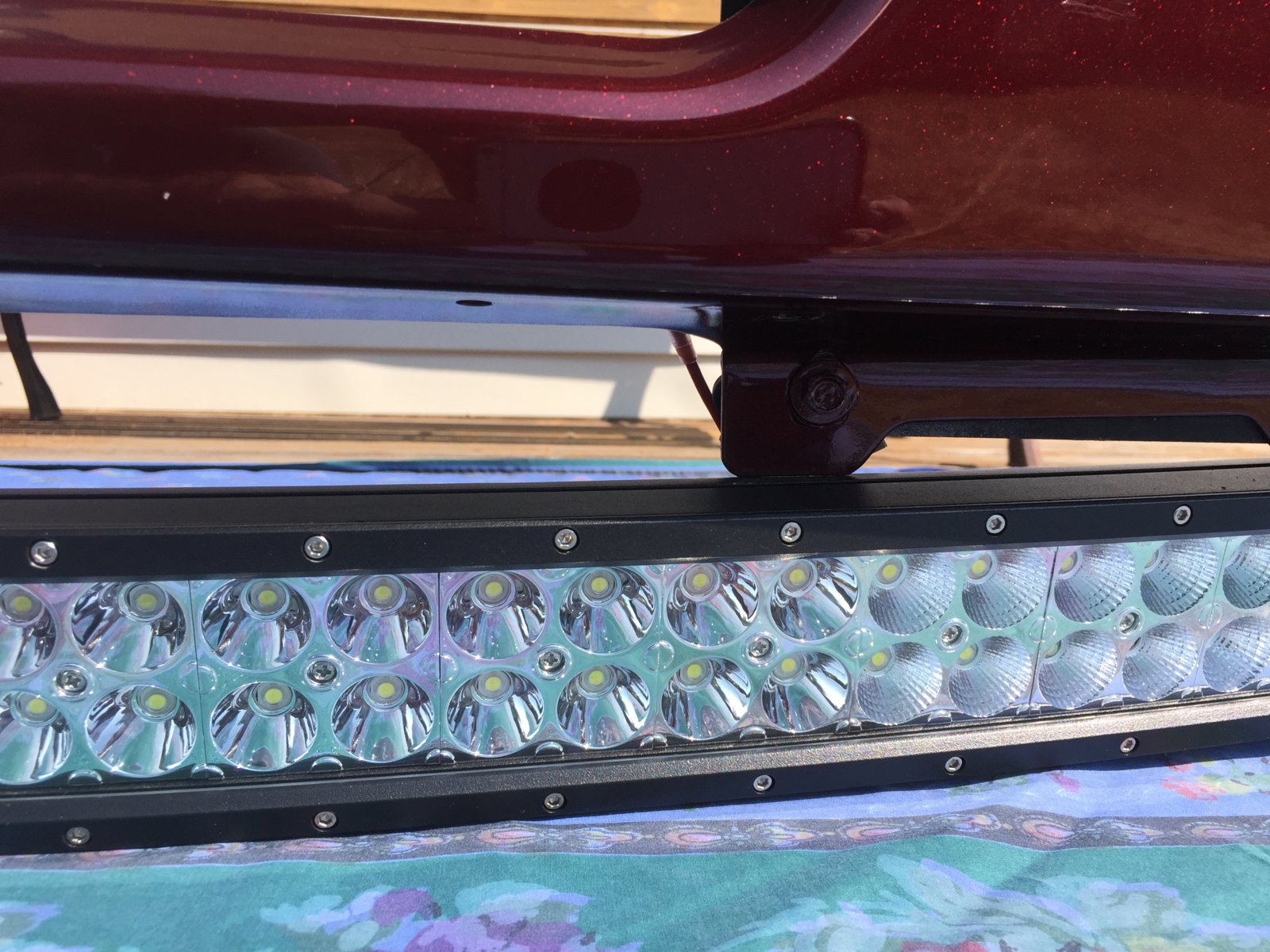

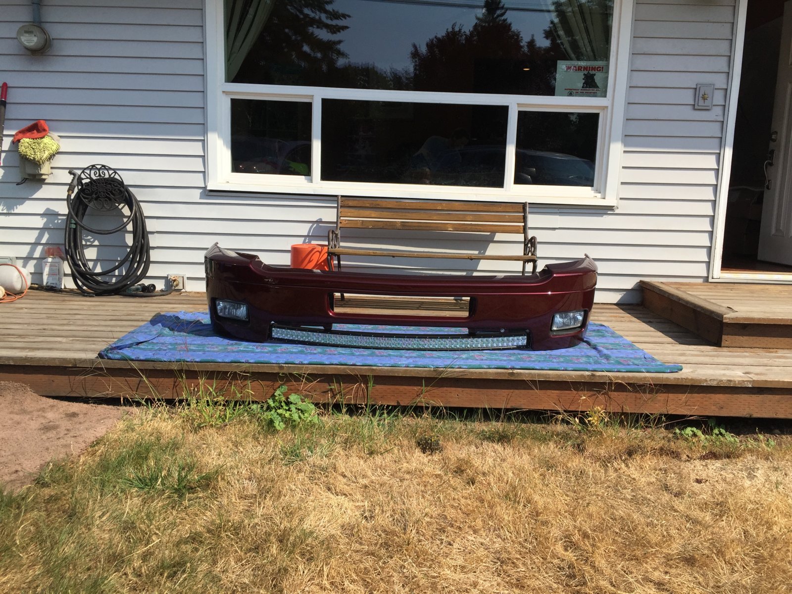

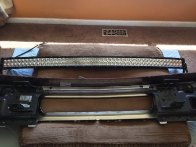

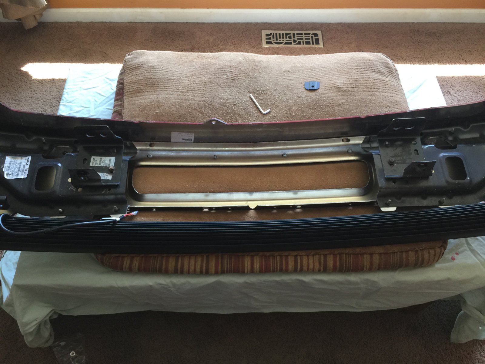

I got the 50” bar today. Just messing around a bit with it, trying to figure out how to mount it. I pretty much decided the upper area is going to be a panel; the 26” bar just won’t look right there. I ordered a billet grill that is made for that area and plan on modifying it to a black textured panel or similar. I’ll also trim out the lower opening with that same material around the light bar. A local plastics shop has the material in many thicknesses and any size up to 48 x 60.
33,341
51,827
View attachment 205501 View attachment 205502 View attachment 205503
Just as a precaution, I'd run a thin bead of silicone around those light bars, just like the aftermarket lights. I've seen tons of those led bars with moisture and water in them--which eventually kills alot of the leds.

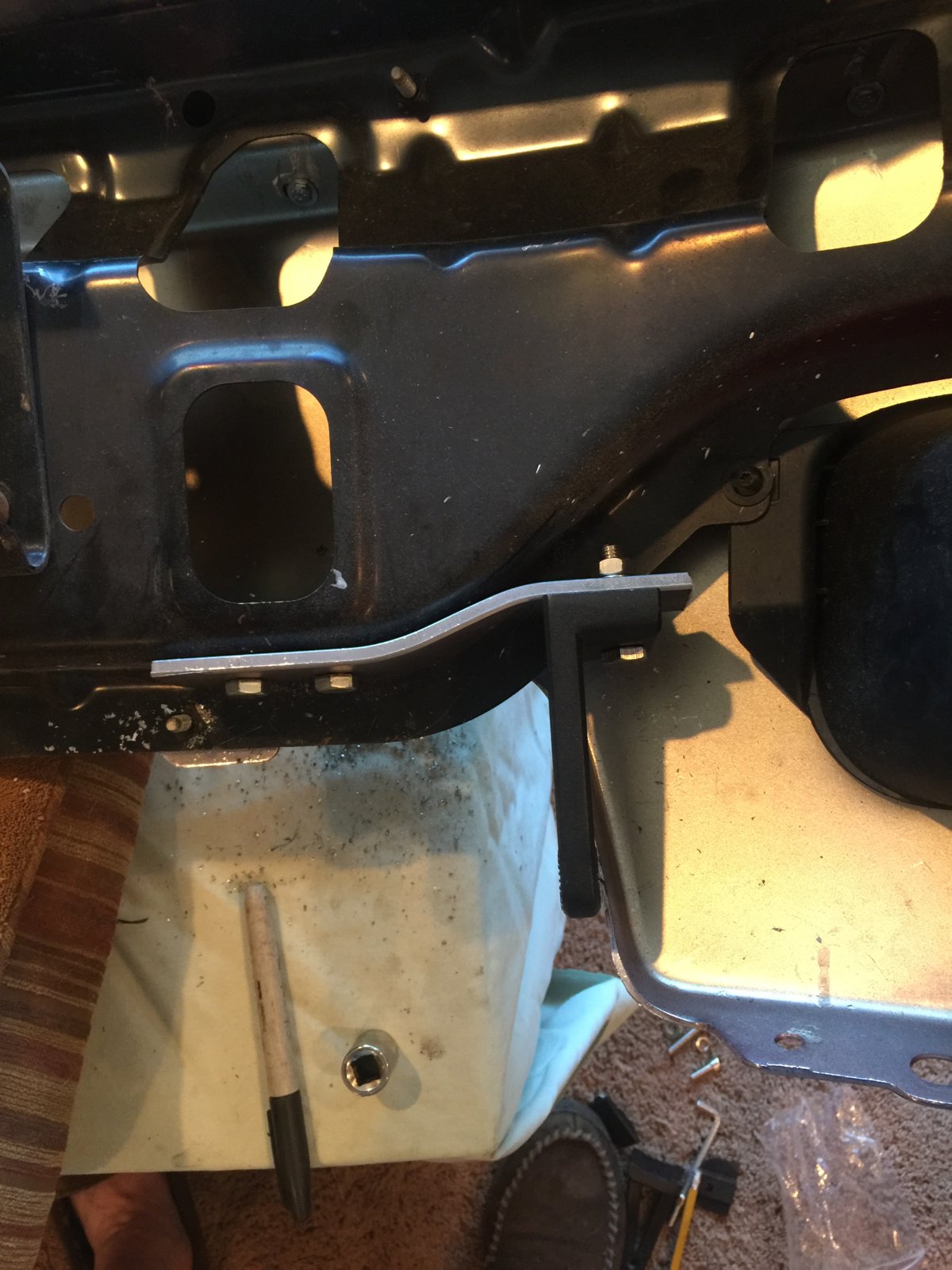

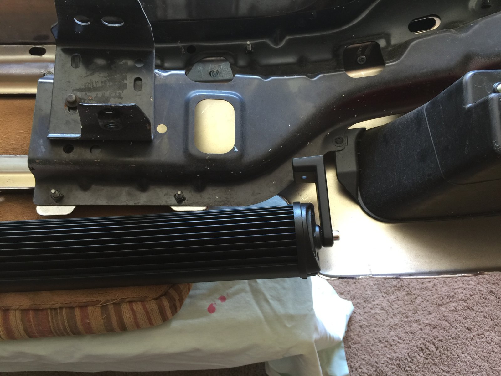

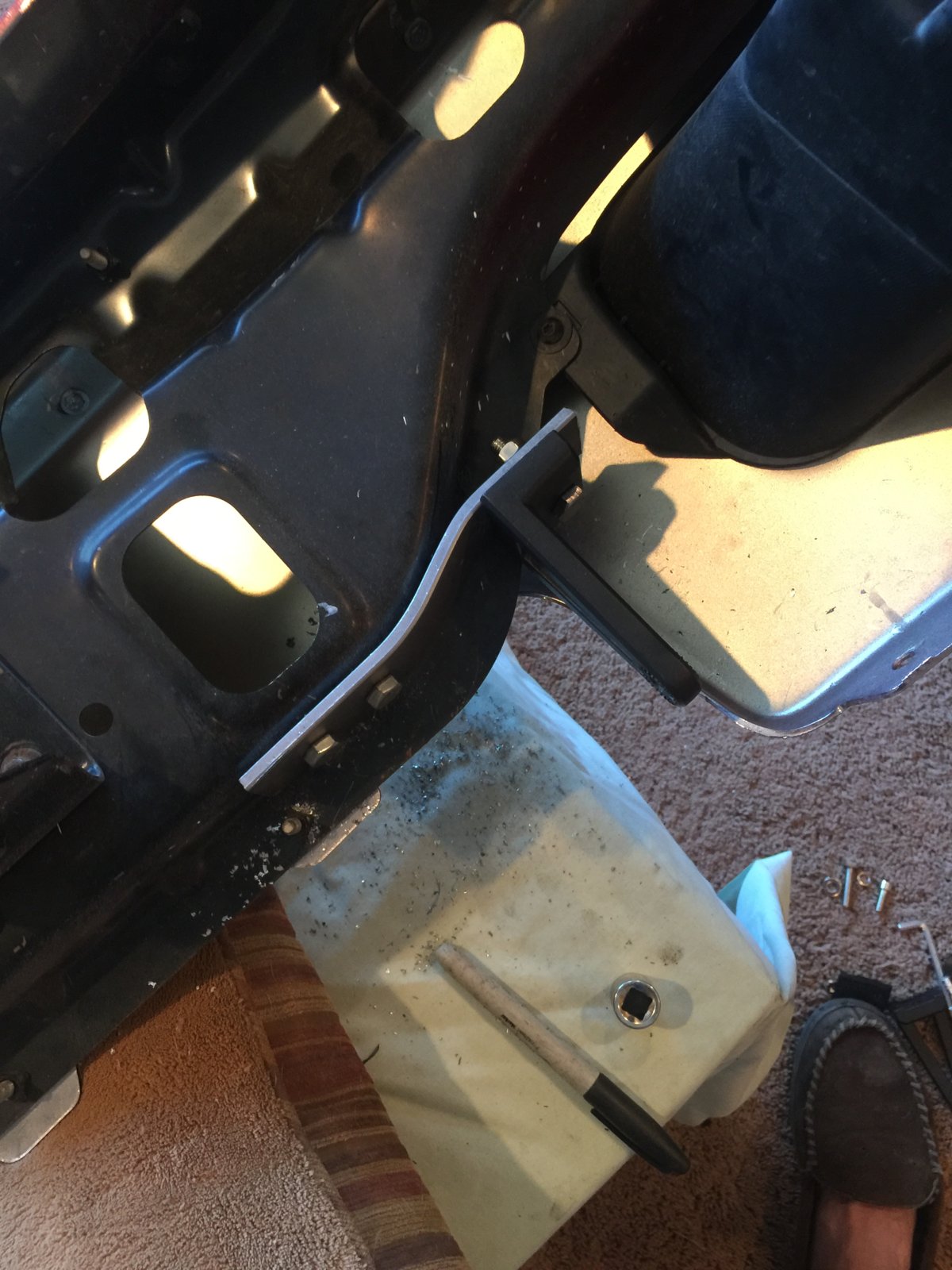

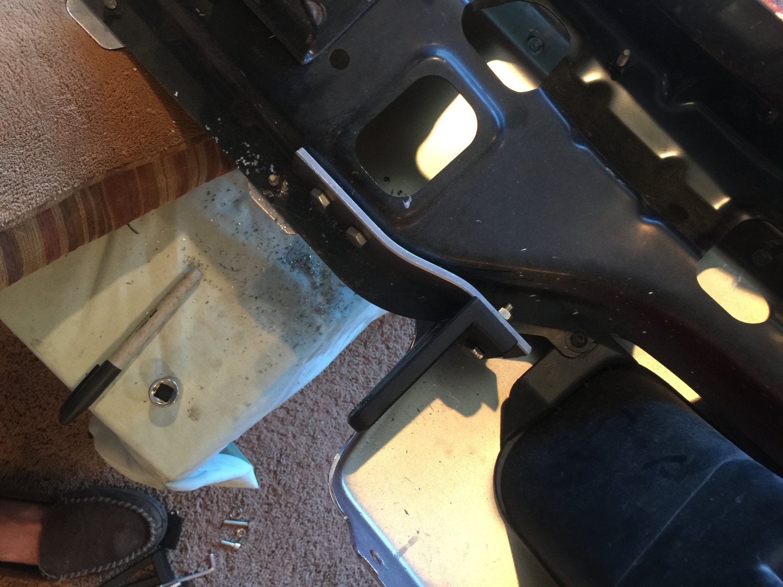

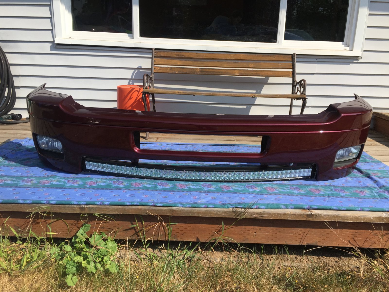

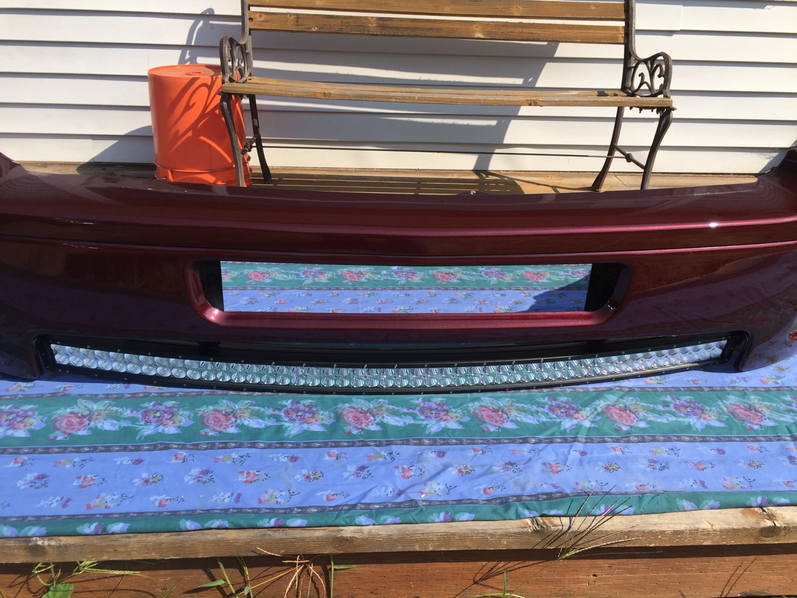

Brackets both done, light test mounted. I'm trimming up the ends of the brackets and painting them now. There's a couple of tabs on the bumper at the top of the light that I just trimmed off that will allow me to adjust it up a tad more. This light is mounted solid.
52,954
The curve is close to perfect, even the bottom as it sits on the ground as the truck is aired out. I will adjust the angle of the light bar after installing the bumper. The top area between the bumper and light will get a black textured 3/16" thick ABS piece that I will cut to fit and mount with the 4 bolts that are there. That will fill the gap and make it look finished off.
