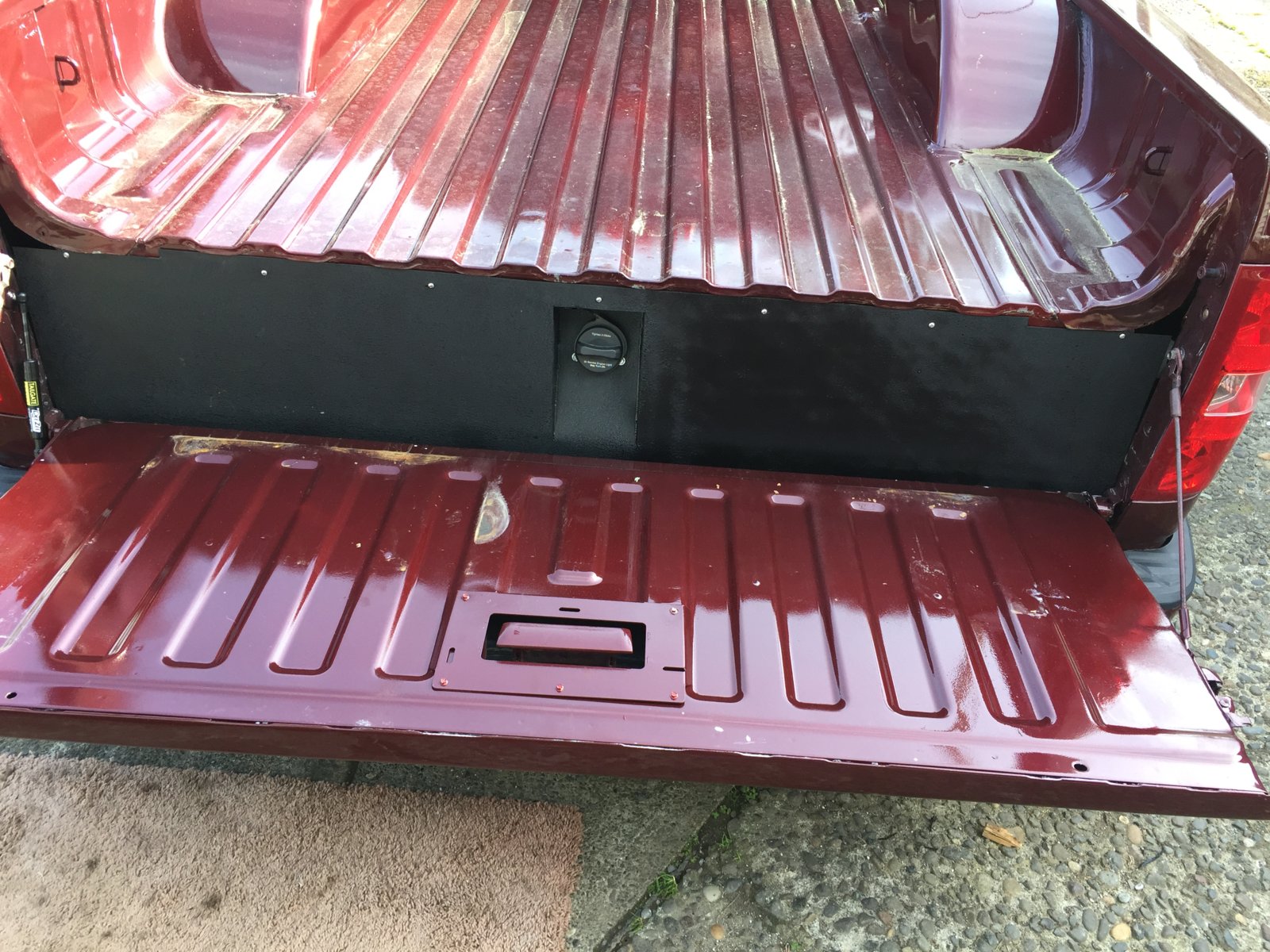

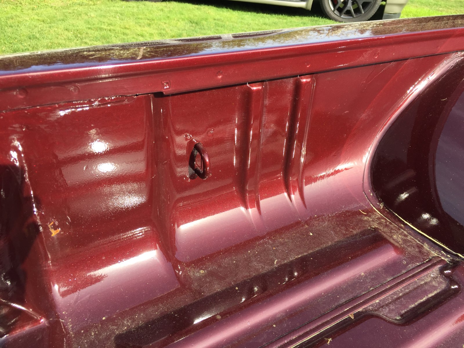

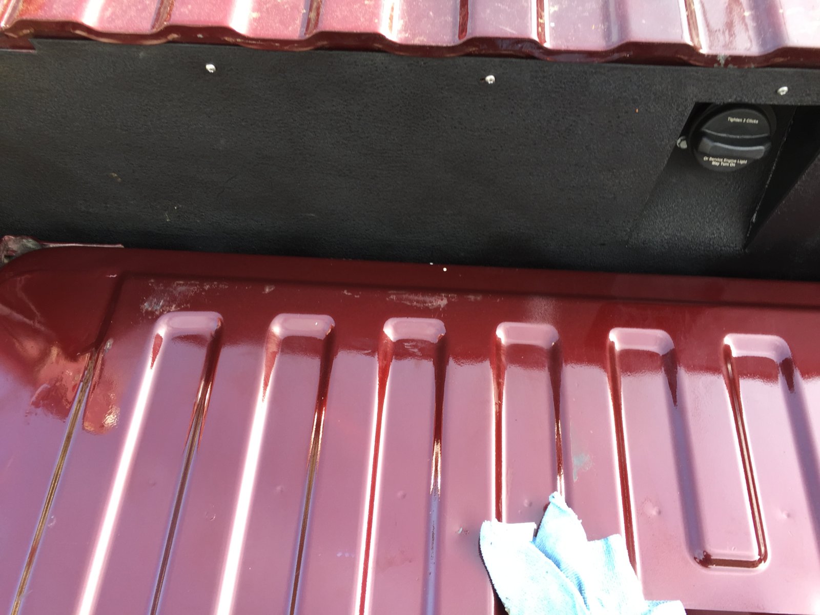

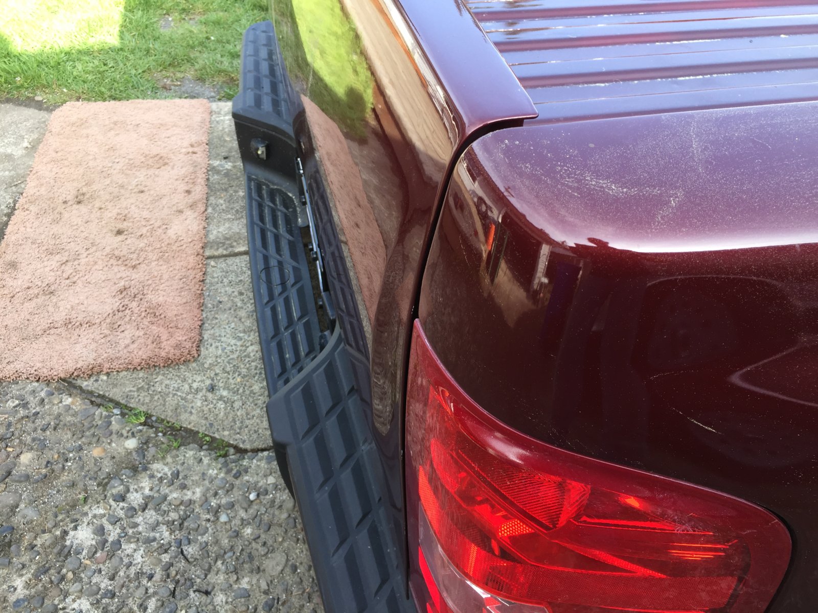

Now it pops open easy, closes easy and actually closes flush with the fenders. It used to stick out about 1/4" proud of the fenders. Combined with the tailgate assist, it's super easy to open and close. I cleaned off the surface rust with Meguiar's Fine Cut. It was mostly rust from the unpainted steel but it did rub into the inside of the tailgate a bit. If the crinkle paint doesn't crinkle the rest of the way, I'll pull it off, sand it down, and repaint that half. I just wanted to get it installed today because it's supposed to rain for a week starting tomorrow. At least it will wash all the pollen off.

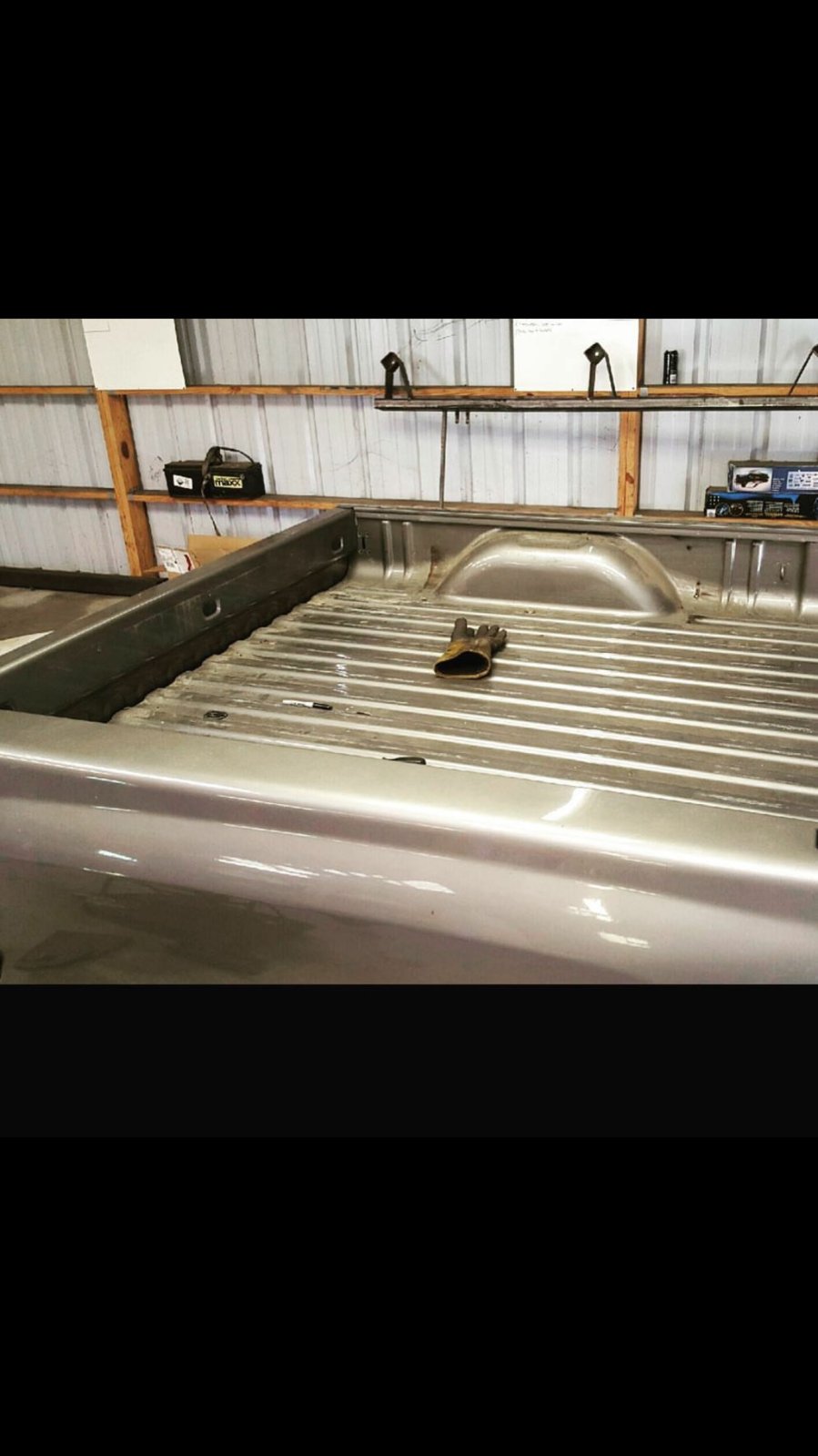

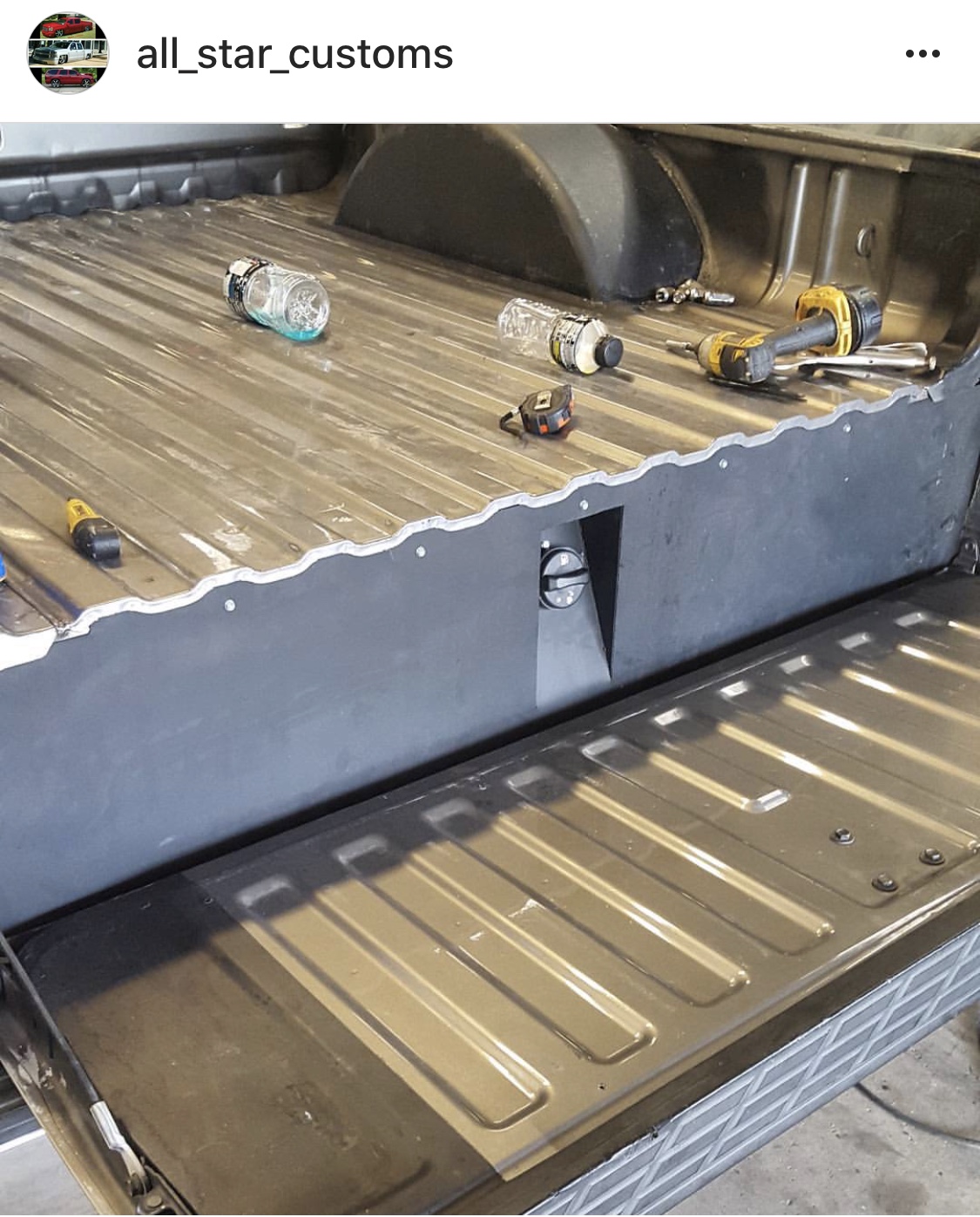

It looks like they cut the entire bed at the top edge, shortened the sides and rehung it if that's what you mean. They did a pretty good job. View attachment 196578
Yes, looks good, I’ve never seen it done. Do the newer bedsides all unbolt like the older ones(70-80’s) used to? That and a few pinch welds up top and along the edge it was off...
I don't see any bolts so I don't think so. I only have a few pics of the bed from the build. Here's a couple but they don't reveal much.

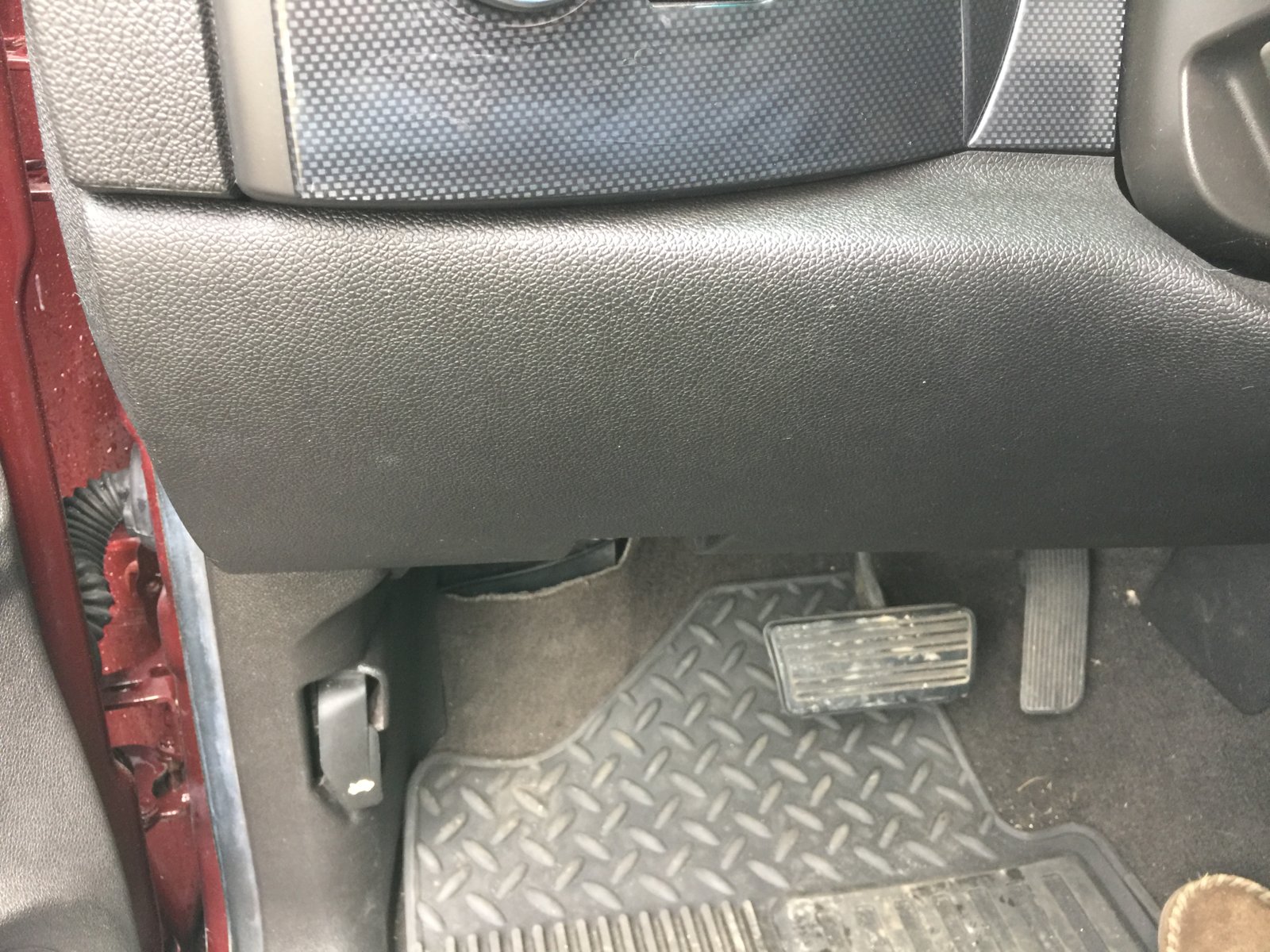

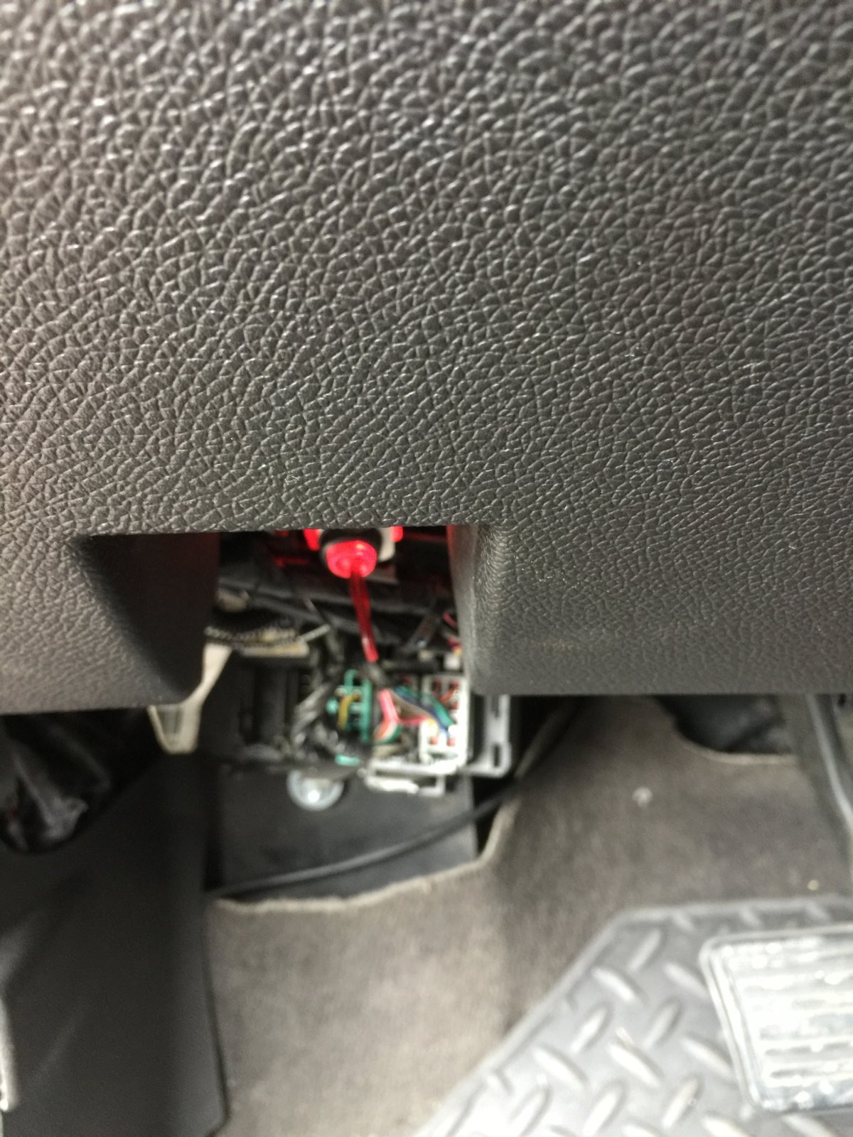

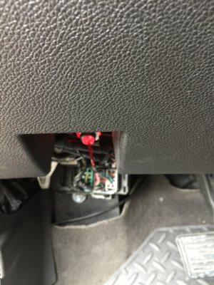

I took the demon eyes / RGB controller off the park light circuit and added a separate switch for them so I can control them easier. Also when I'm at a show or just hangin', I can turn them on without worrying about running the battery down. And without the white park lights up front they'll look better. I decided that the little nook where the park brake release used to be would be perfect for the switch. It's super easy to find by feel and the switch isn't even visible unless you bend down and look. It lights up red when it's on so I can just look for the glow.

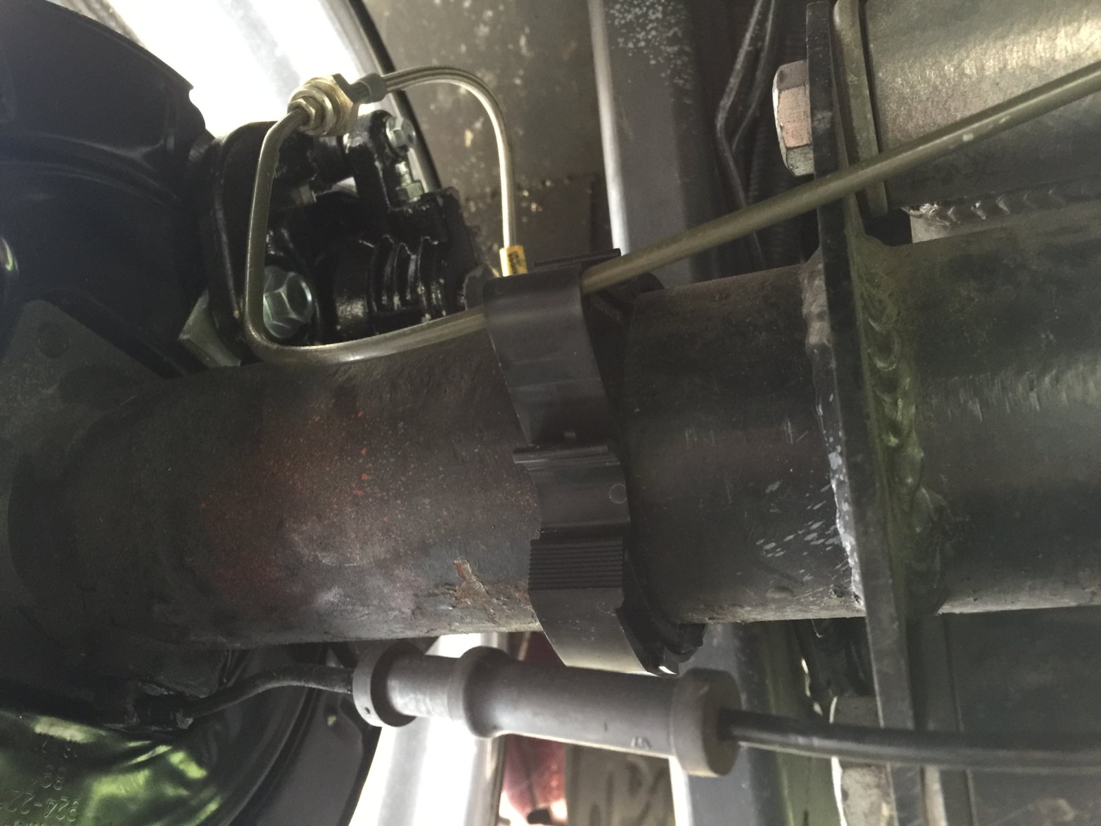

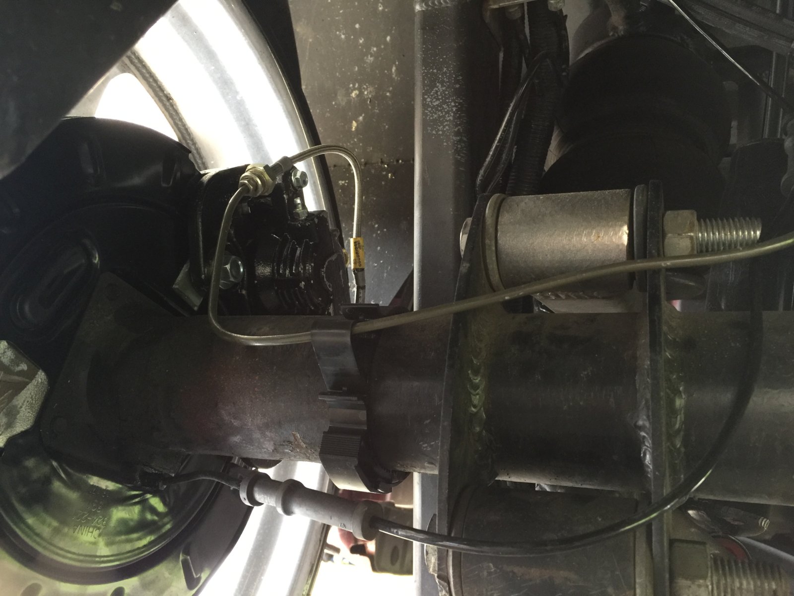

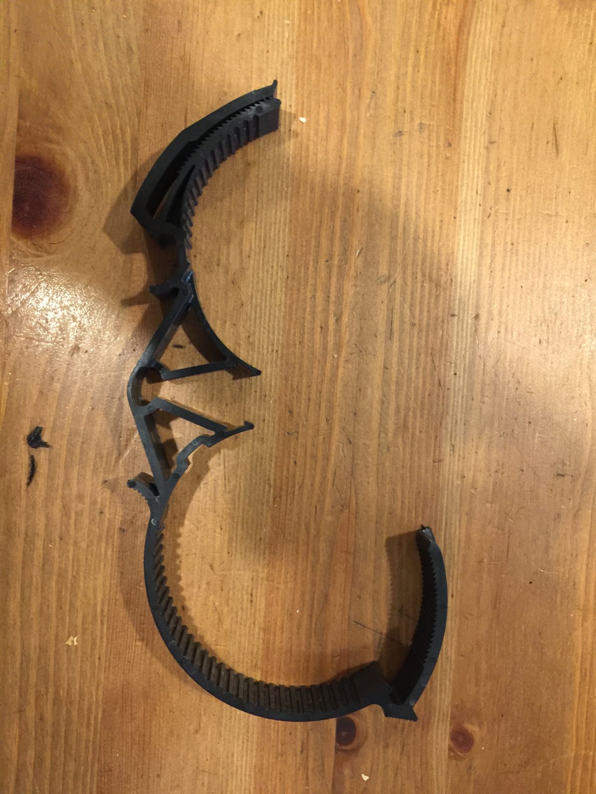

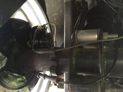

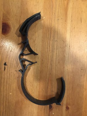

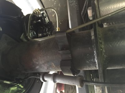

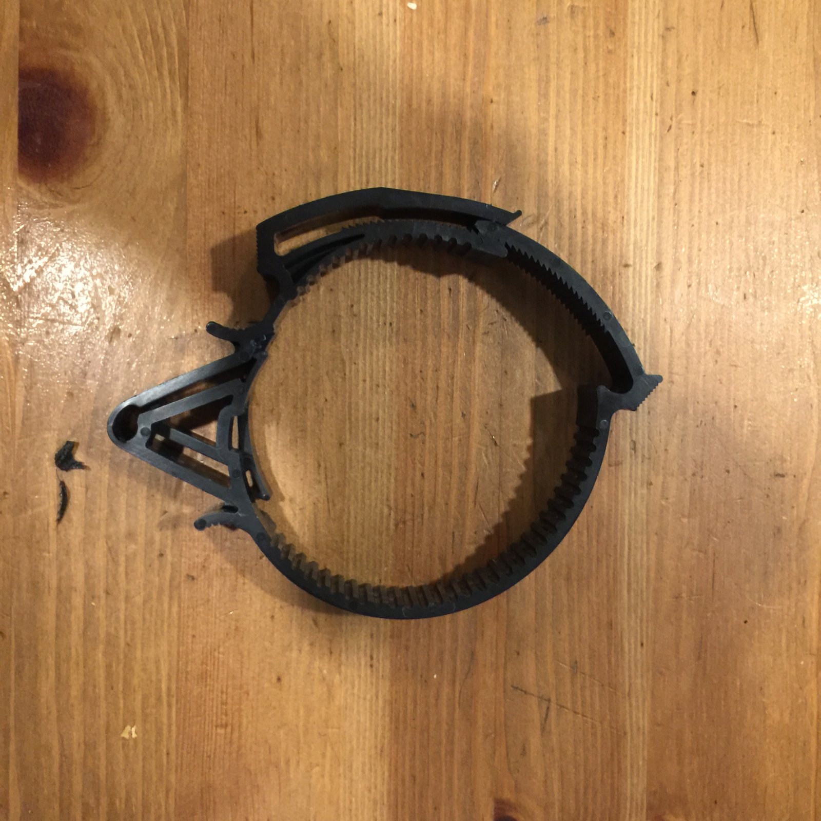

I also got the clip for the brake line where it runs across the rear axle today. The passenger side had one but not the driver side so I added one. It keeps the line away from the flanges on the axle so it doesn't rub, plus it holds it securely. The flanges stick out over an inch from the axle so it's not good to just zip tie it because it will rub even though I had put a rubber hose around it when I did the brake conversion. When the line was connected solidly to the back of the drum brake backing plate it wasn't as critical since it couldn't move much but once I connected it to the stainless flex line it needed to be secured. It's the little things.

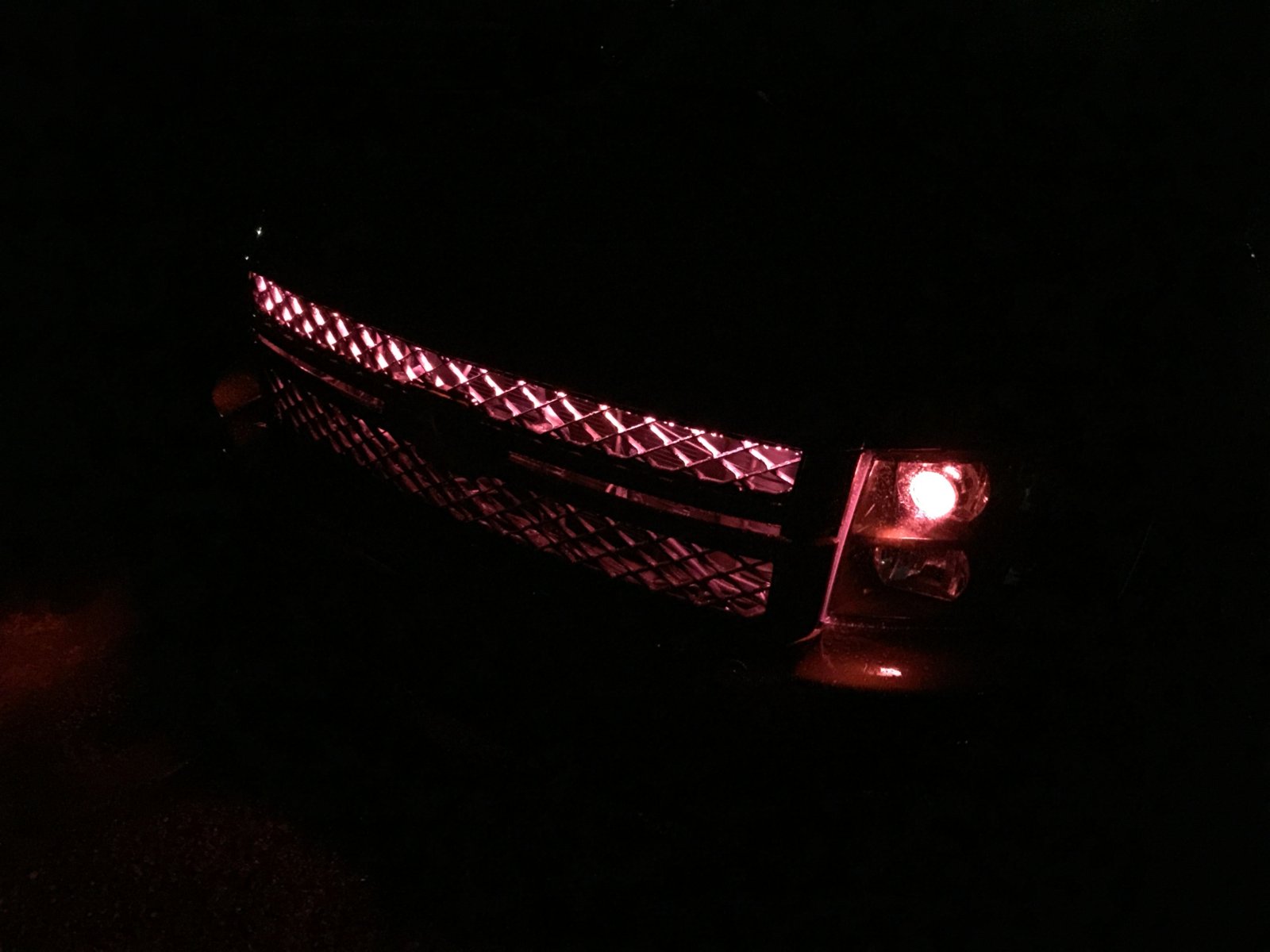

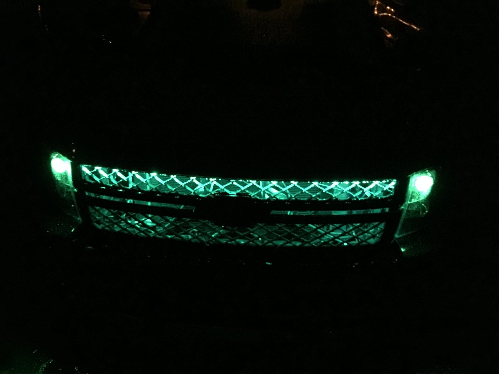

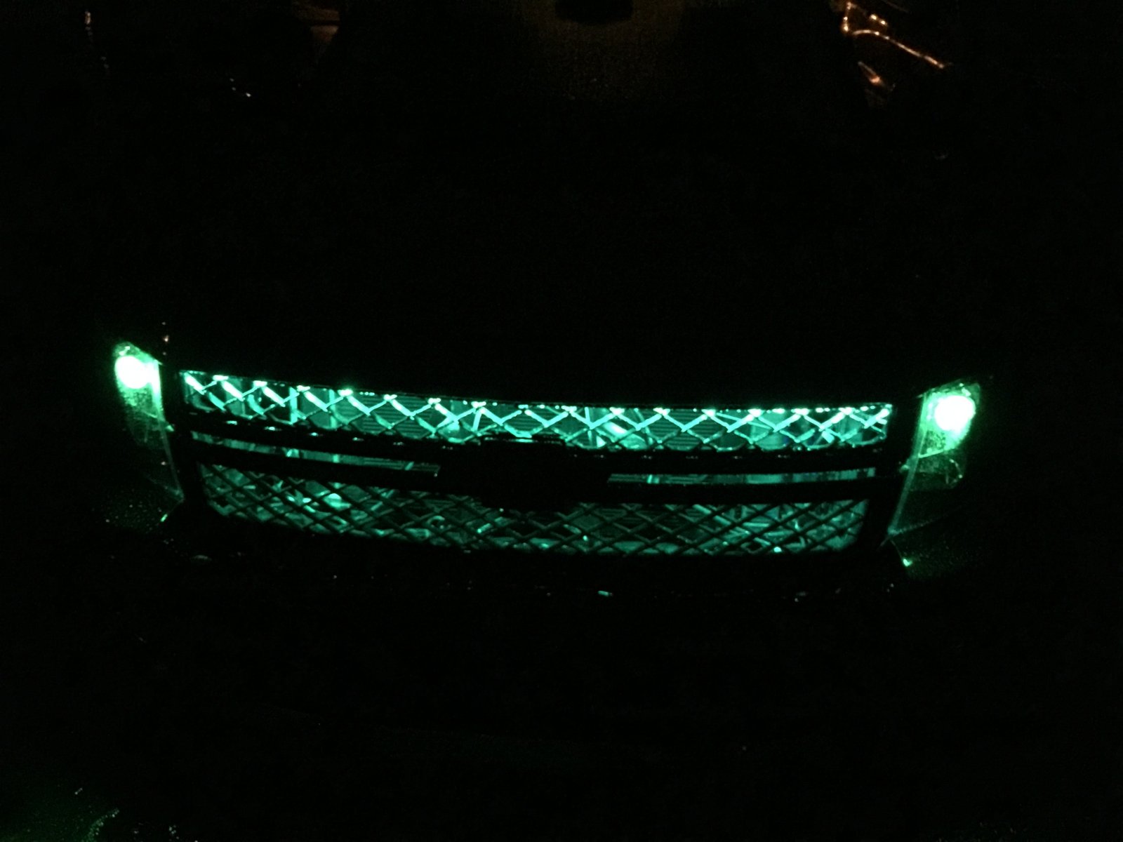

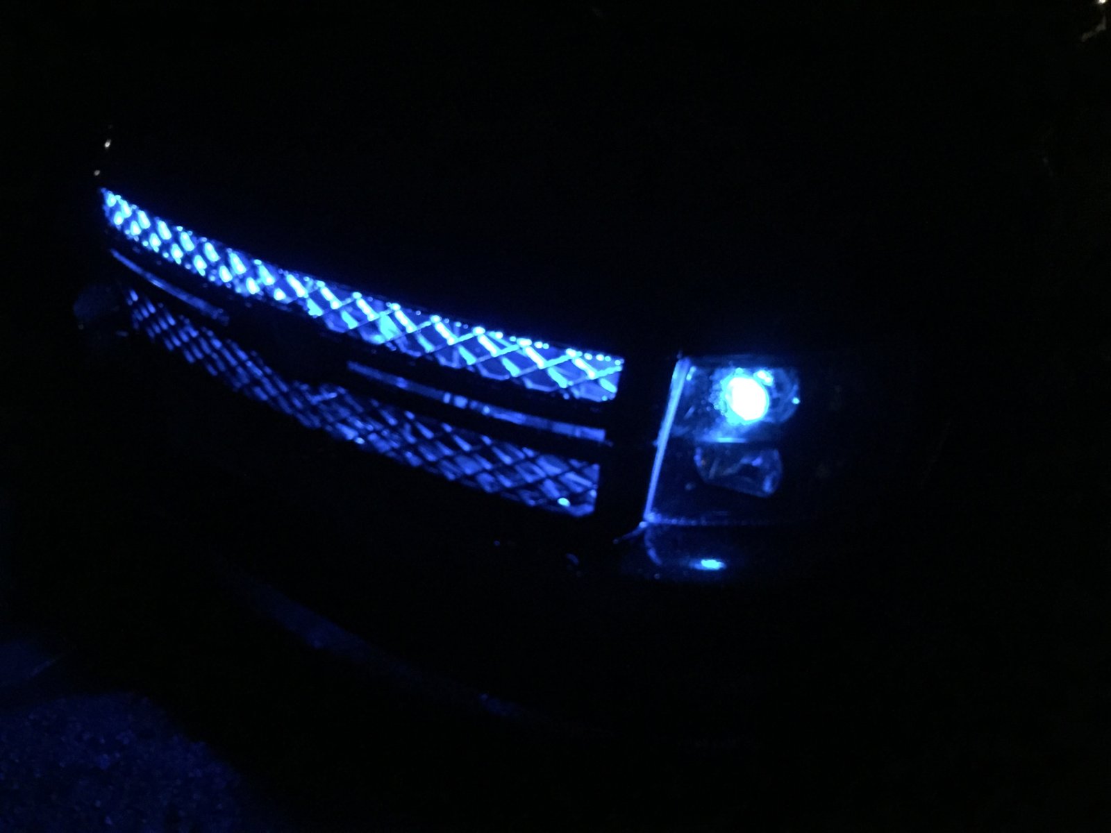

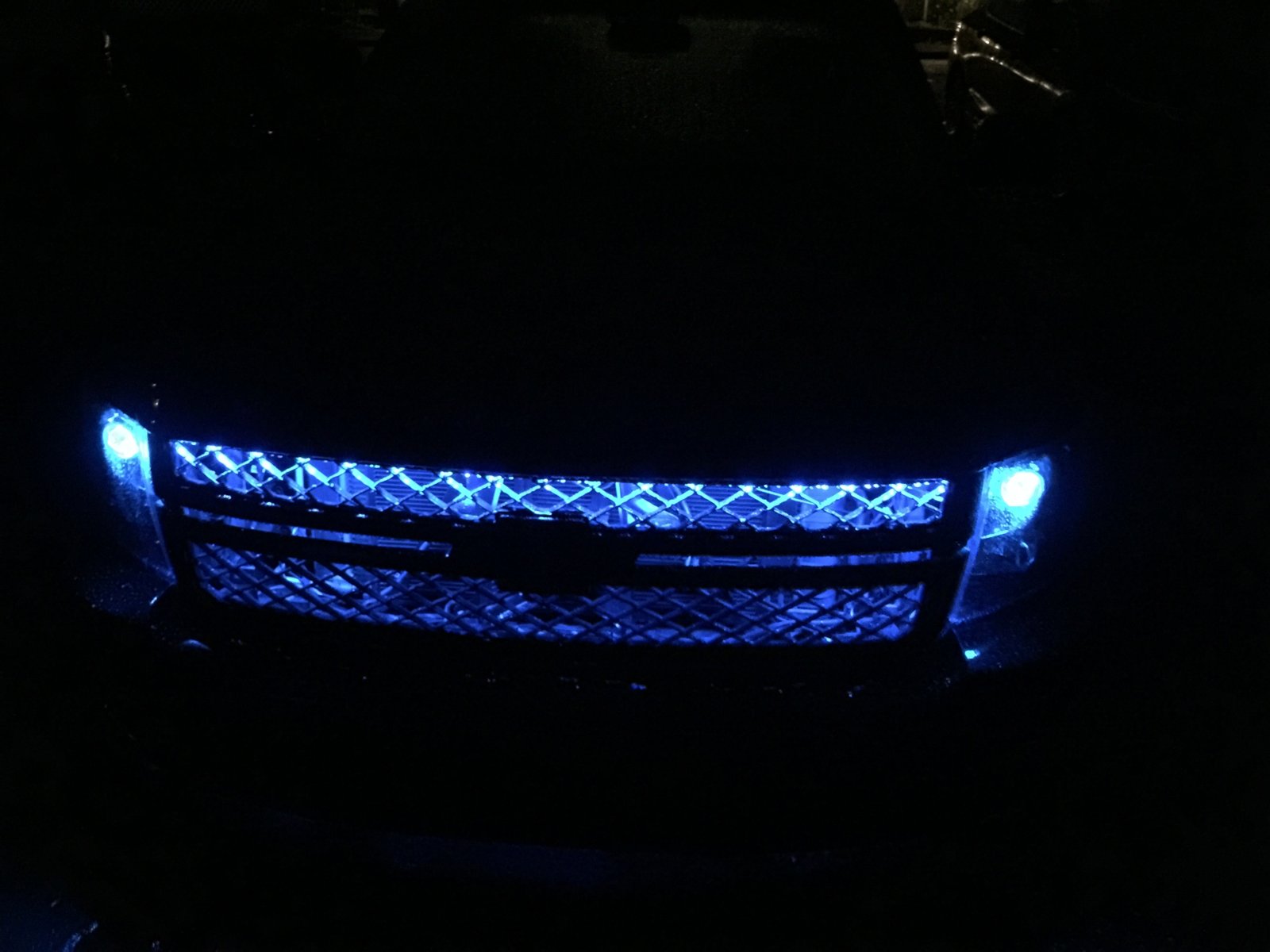

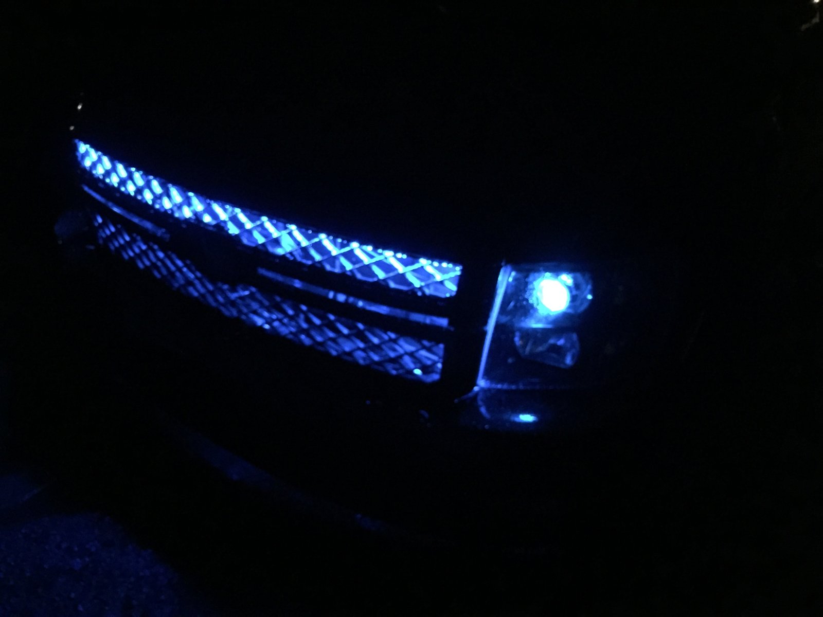

Without the park lights, the colors show up way better. It's a rainy night but here's some shots. The one strip across the top actually lights up the whole grill pretty good. BTW I had to pull the passenger side headlight today, dry it out, and reseal it. I really hope this fixes it; I noticed it fogged after I washed the truck the other day and I hosed it down hard. The design of the NNBS Silverado headlights aren't the best for sealing and I really hate doing things twice.

Looking great! It takes a lot of butyl rubber to seal them back up. Sure they will hold up now. How do you enjoy the retro?
52,949
Yeah, I used the retro rubber from TRS when I put them back together, and also black RTV. I added some more RTV. I just drove it at night a couple days ago for the first time and I was impressed especially when I hit the high beam and the shutters opened as well as the regular high beams at the same time.

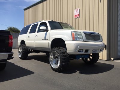

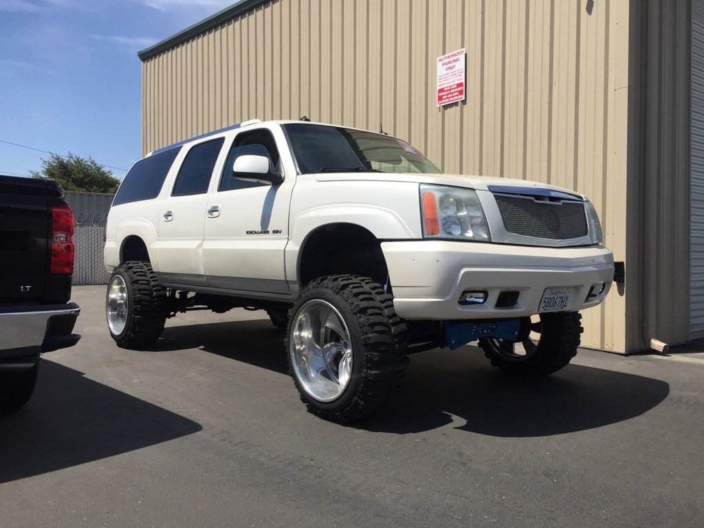

Those kits don’t work for the escalade/denali.
Showoff/fts/tcs esky/nali 6.5 kit is 3k with no shocks, control arms, or anything. Believe it comes with new front driveshaft.
Never seen a cog/rcx/bds for those either.
I have the quote in my inbox lol. It’s not on the website. If you’d like I’ll dm you.
