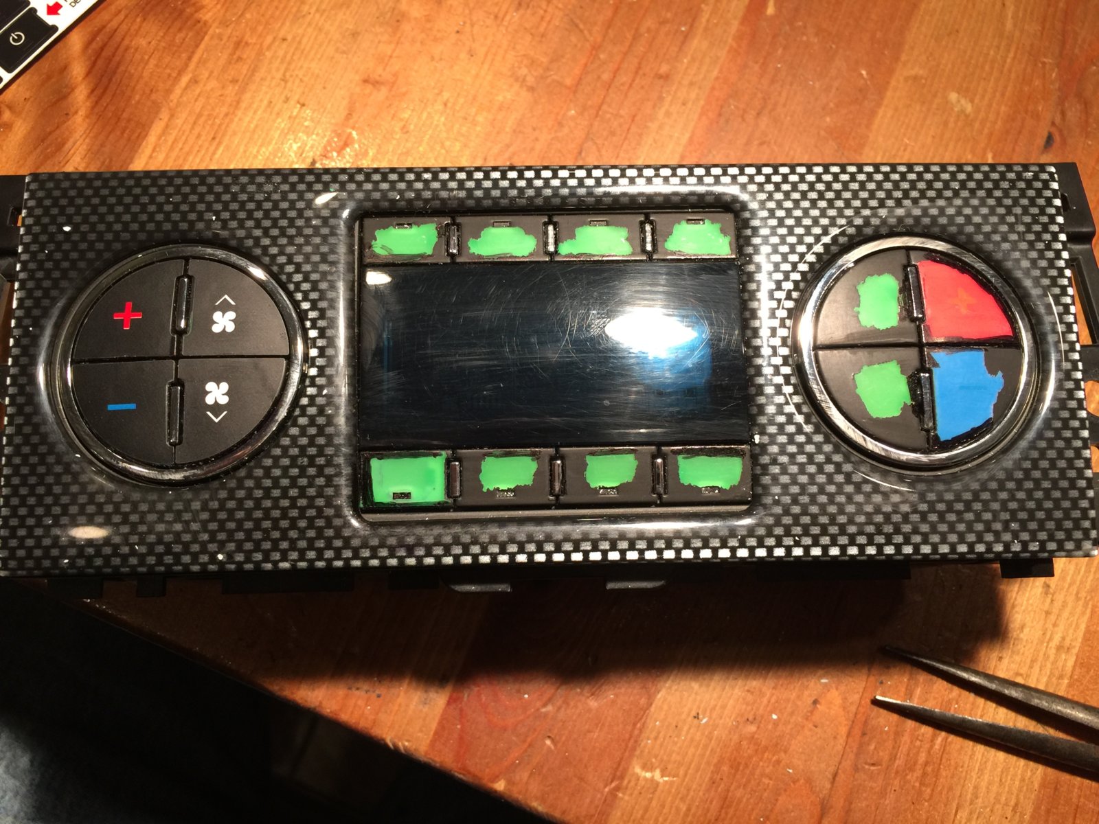

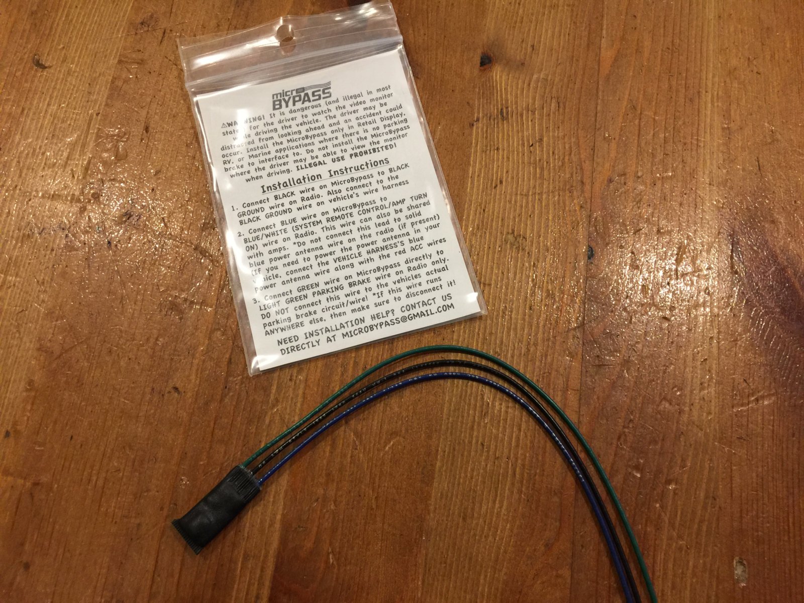

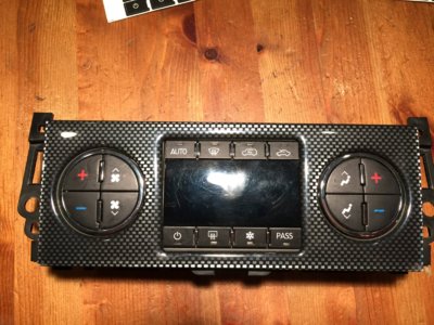

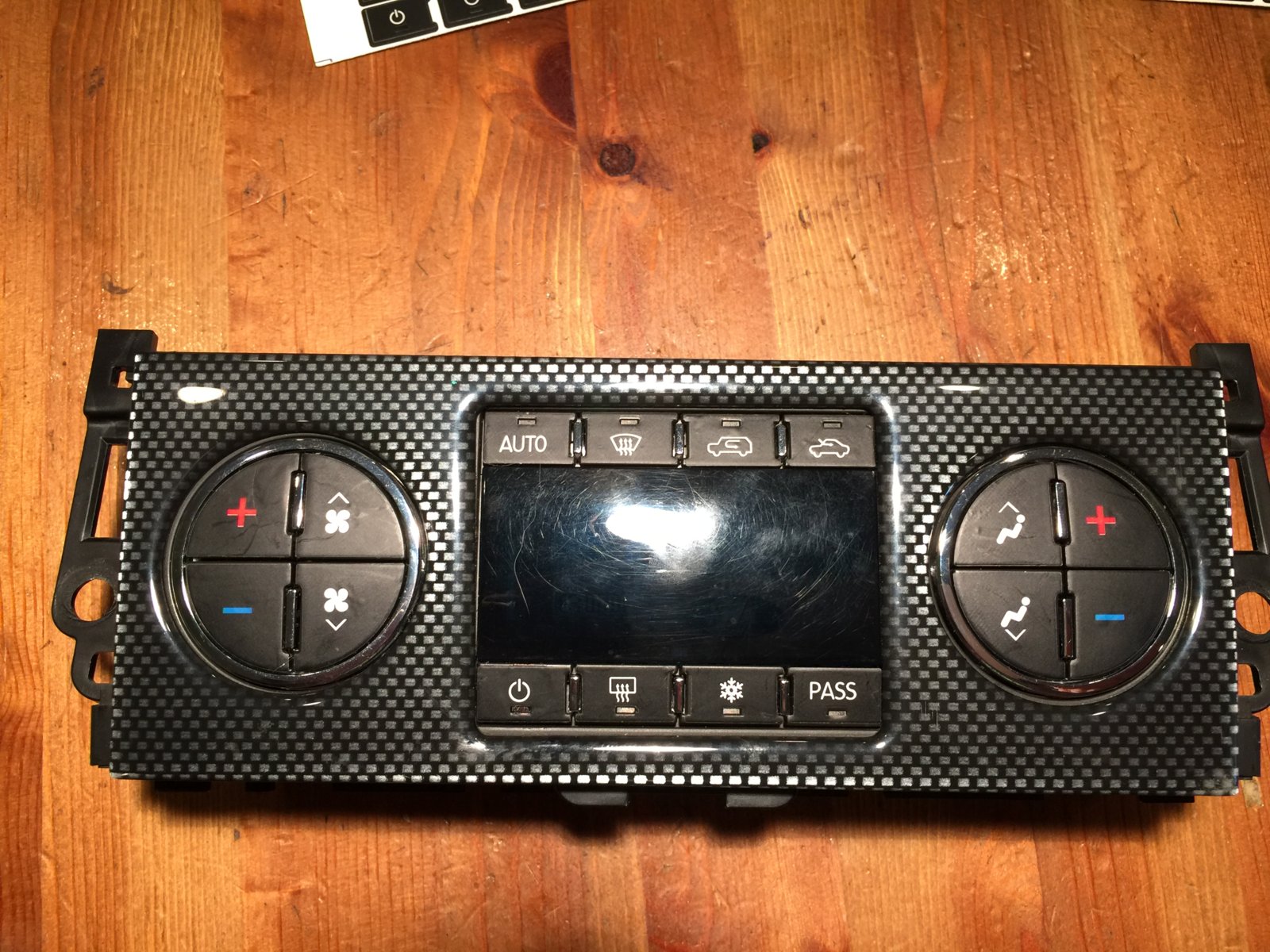

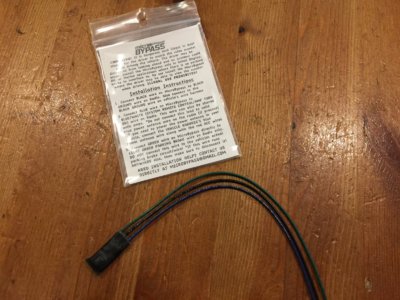

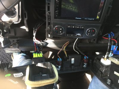

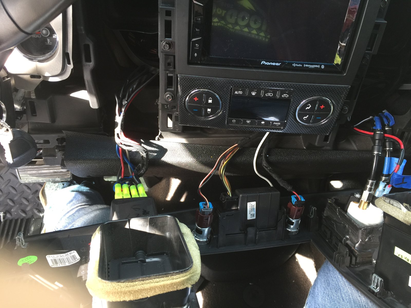

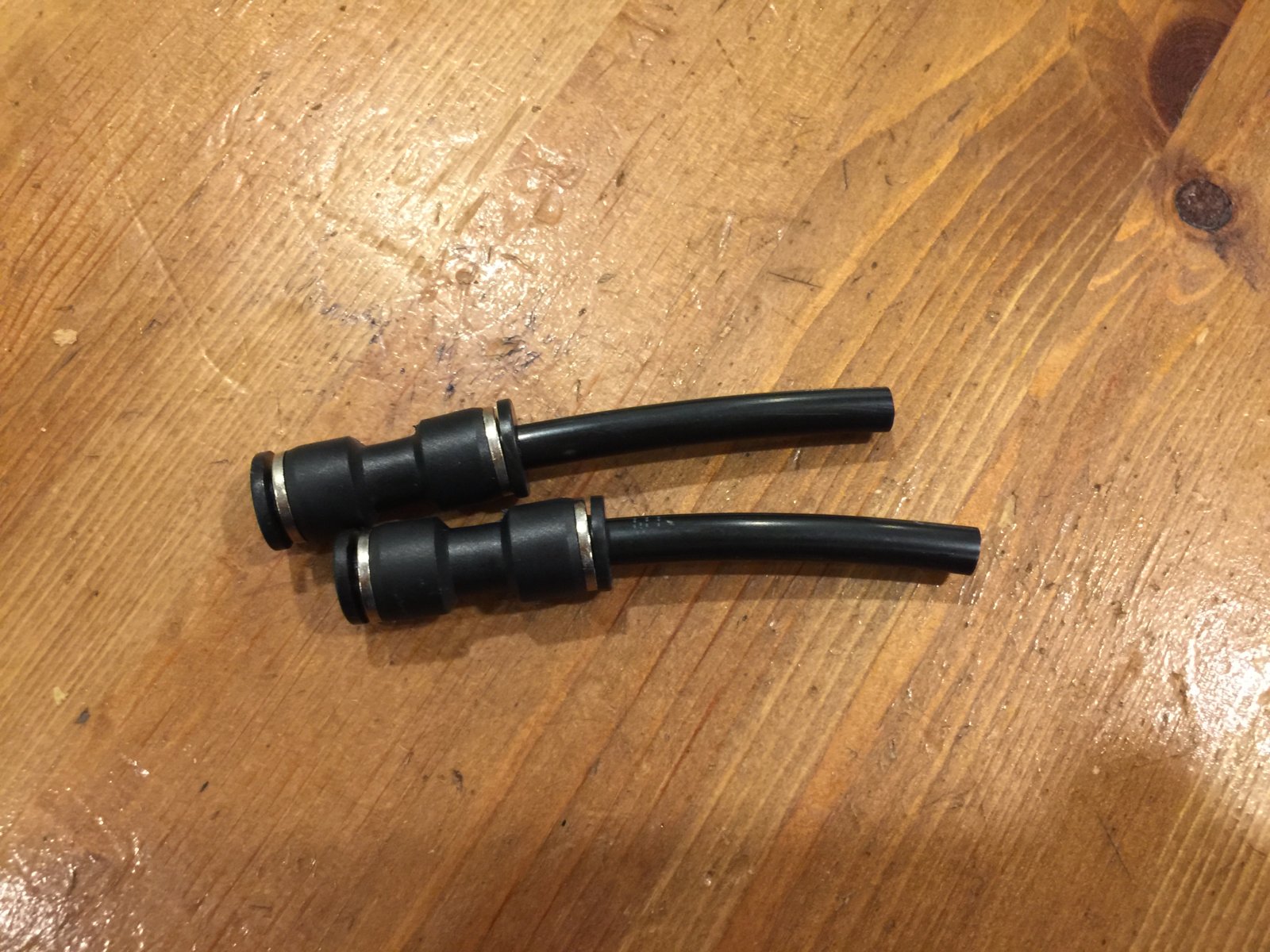

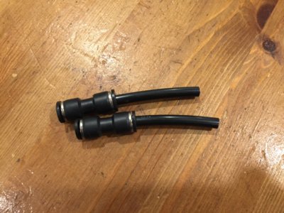

Today I tackled 3 items on my to-do list. Which BTW is now all checked off so I'd better get to making a new list. Maybe a subwoofer box behind the rear seat against the back wall....anyway, all 3 of these were in the same area which happens to be my least favorite area of the truck to work on. The dash area where the stereo is. Due to the air switches, the air gauge and the heater ducts, the panel is super hard to remove and harder to reinstall. In fact I can't even completely remove it due to the switches. There's 8 wires going to them and I don't want to disconnect them if I don't have to so the panel just hangs when I'm working back there. I had a DVD bypass module to bypass the parking brake switch since I have no parking brake. I also wanted to remove the HVAC control and remove the labels, scrape the paint behind them, and put new ones on so when the lights are on at night they would look right. And the other night while I was out checking out how bright my retrofits were, I noticed the air gauge light wasn't working. I need that gauge, day or night. I got some 1/4" air line quick-connect couplers to extend the air lines going to the gauges because there wasn't any room to reach behind and release the air hoses when I'm pulling the panel so I got those ready. (I had some air line left over from when I bagged my Harley). So I managed to pull the panel out and removed the HVAC control, took it inside and scraped the symbols off the buttons and reapplied new stickers. BTW when I removed some of the stickers they removed all the black paint so I used a sharpie around some of the edges so the colors wouldn't show. I installed the DVD bypass which worked as advertised. So that's it. Extend the air lines, fix the HVAC buttons, install the DVD bypass and fix the air gauge light which had just come loose from the gauge and was dangling behind it. I guess that was 4 things lol.
