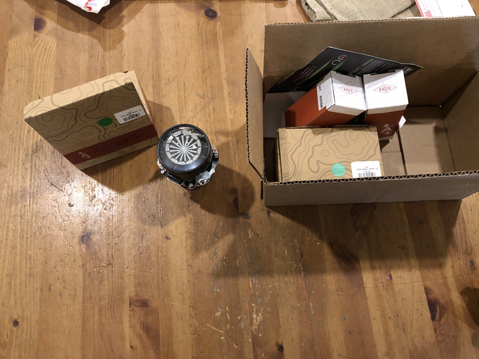

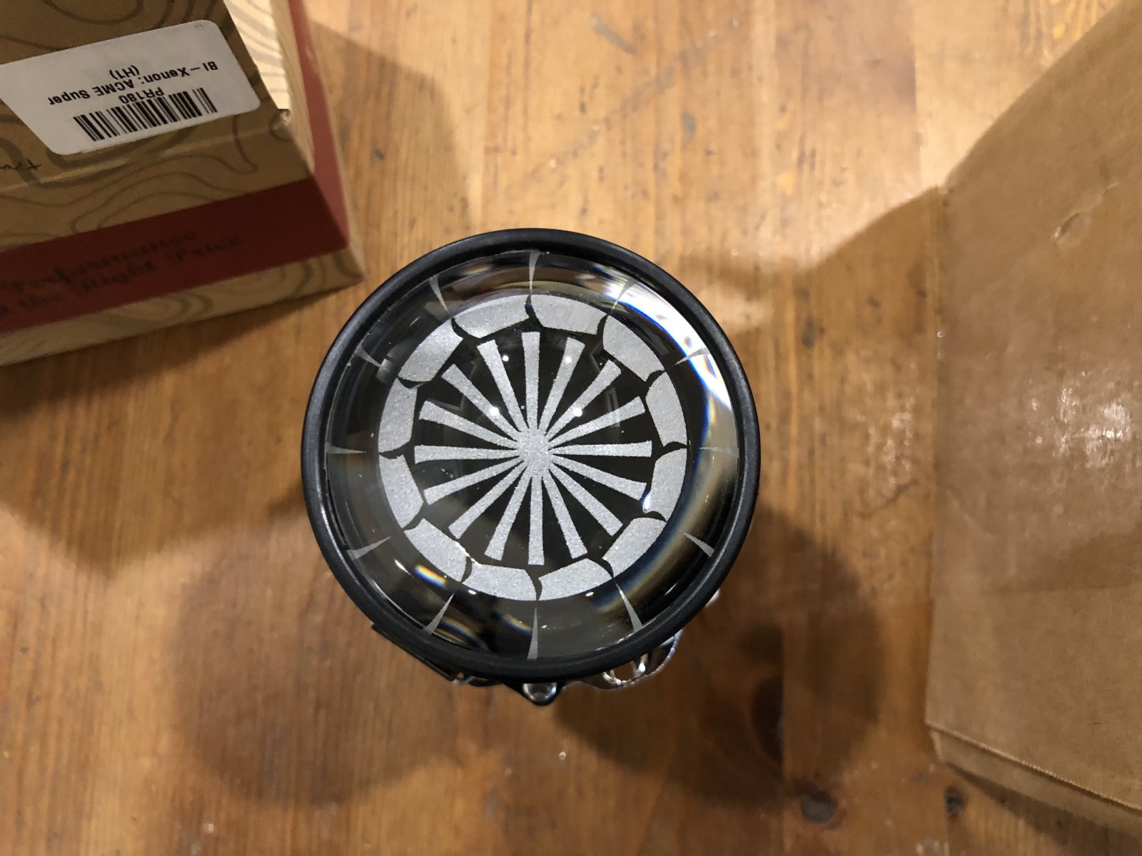

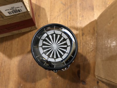

Well shit. I was thinking about the fact I’m planning on opening one of the headlights back up due to the dust. So of course I’m thinking is there anything else I’d like to do while this is happening and of course there is. I regret not spending the money on etching the lenses so they all match. The bulb color is easily changed to match. The projector etching isn’t and since I’m gonna open one up, I’ll open them both up and replace the Acmes with new Acmes with 6000k bulbs that are etched to match the Morimotos. It cost me the same as just plain Morimoto projectors. $40 for the Acmes, $110 for etching, and I ordered another pair of 6000k bulbs so I know they will all match. Gonna get these bitches right one way or another. Another $180 into these expensive things. Oh well. I just got the rest of my stimmy after the IRS processed my 2020 tax return and my income level dropped below the threshold. Yay!

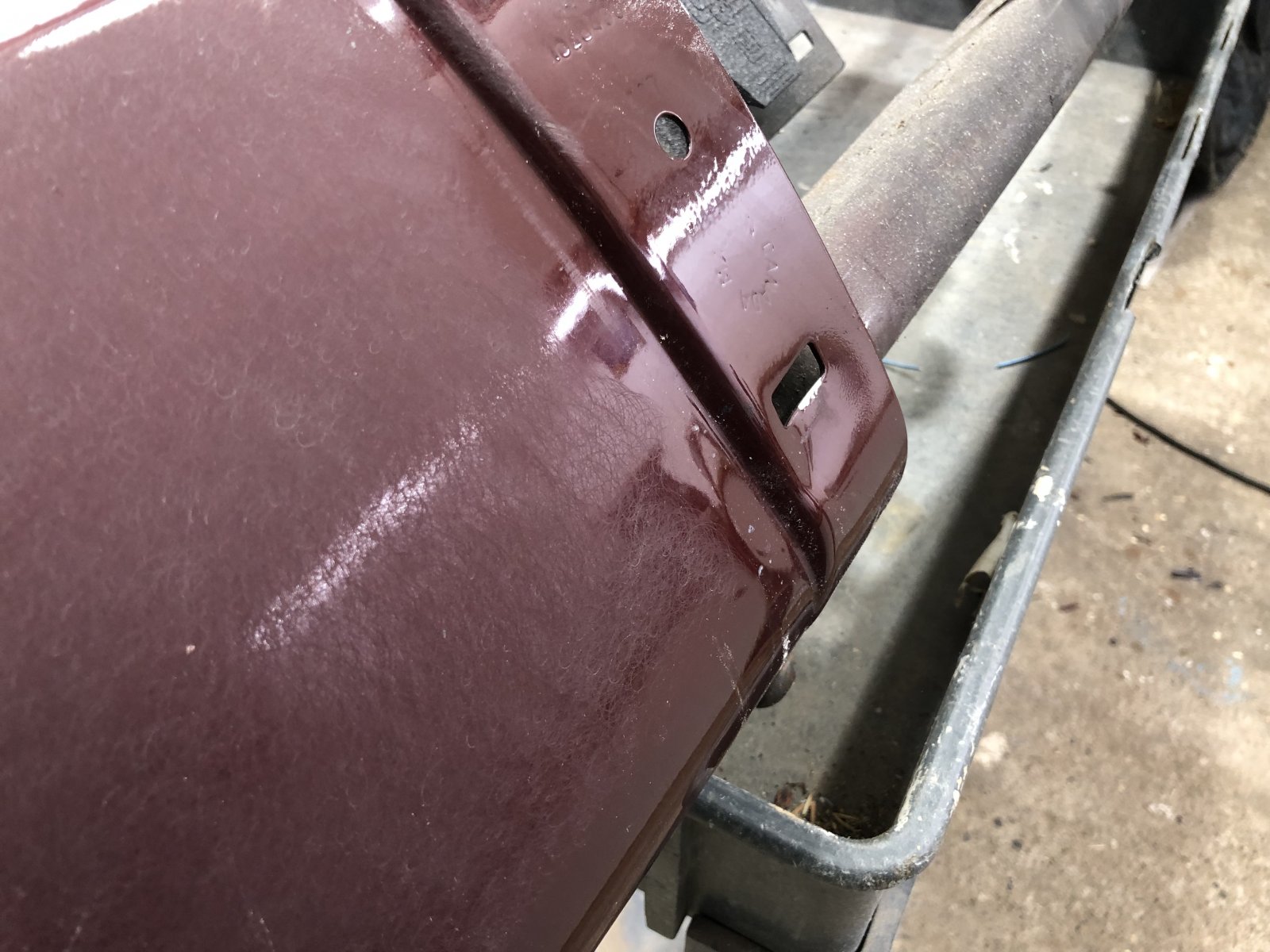

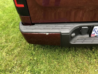

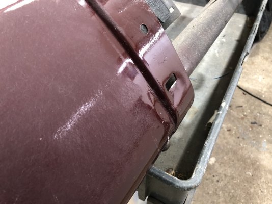

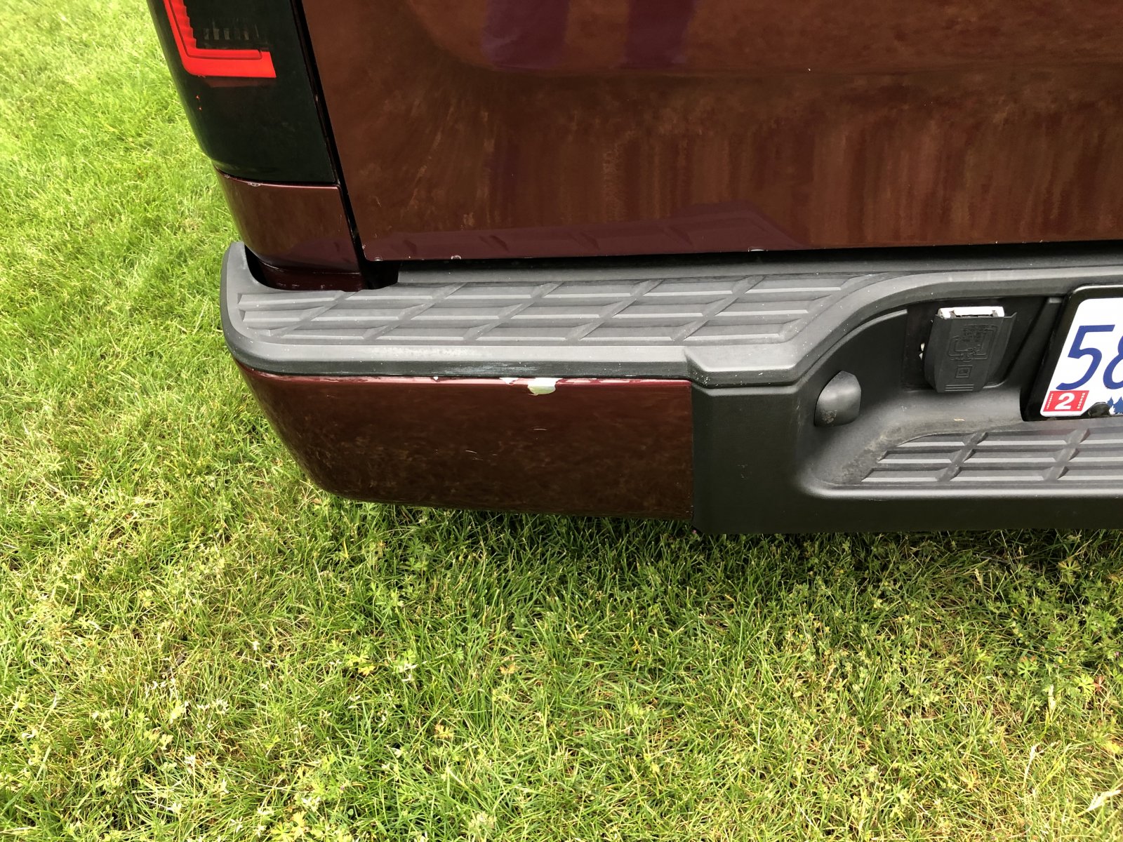

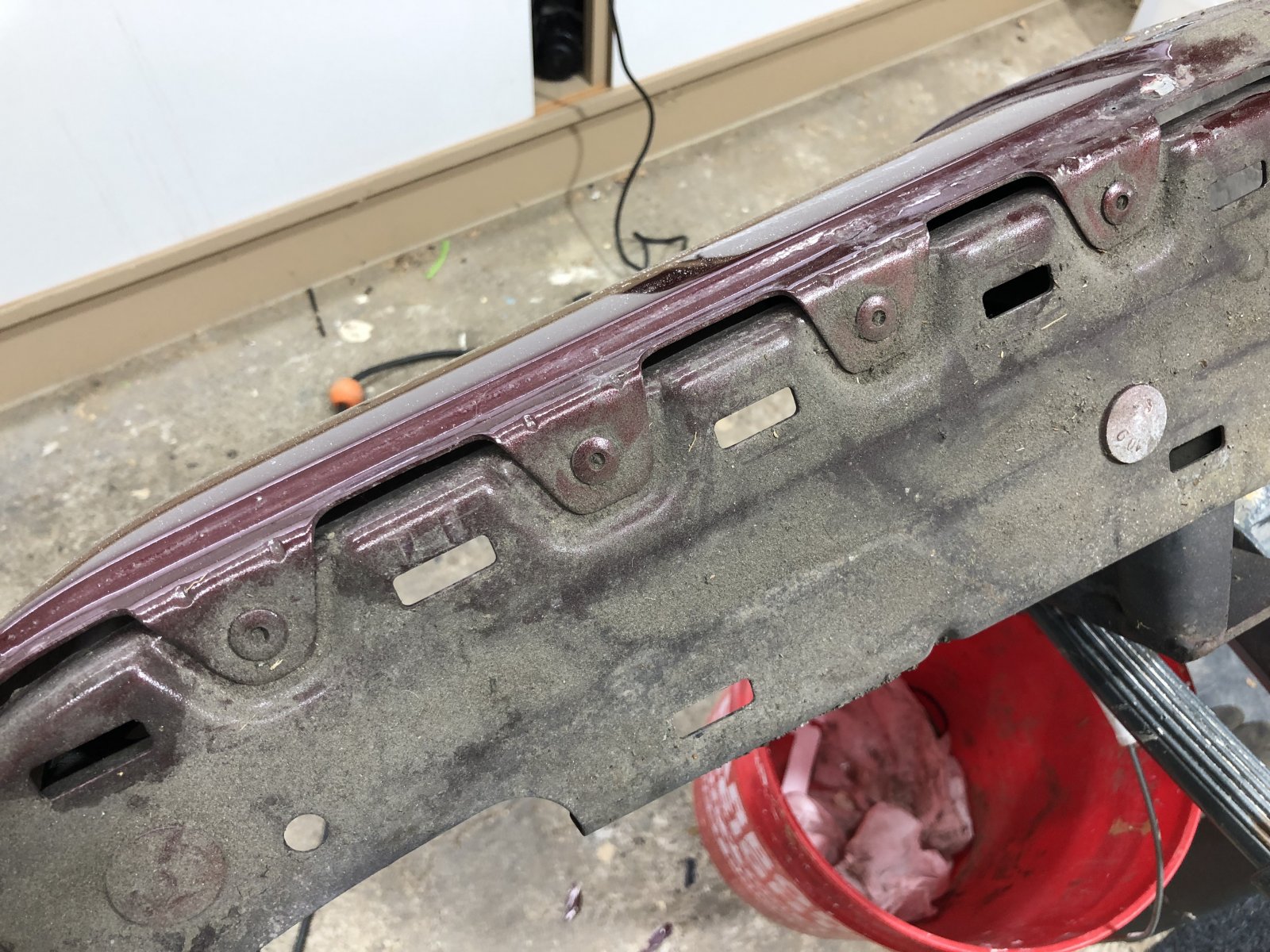

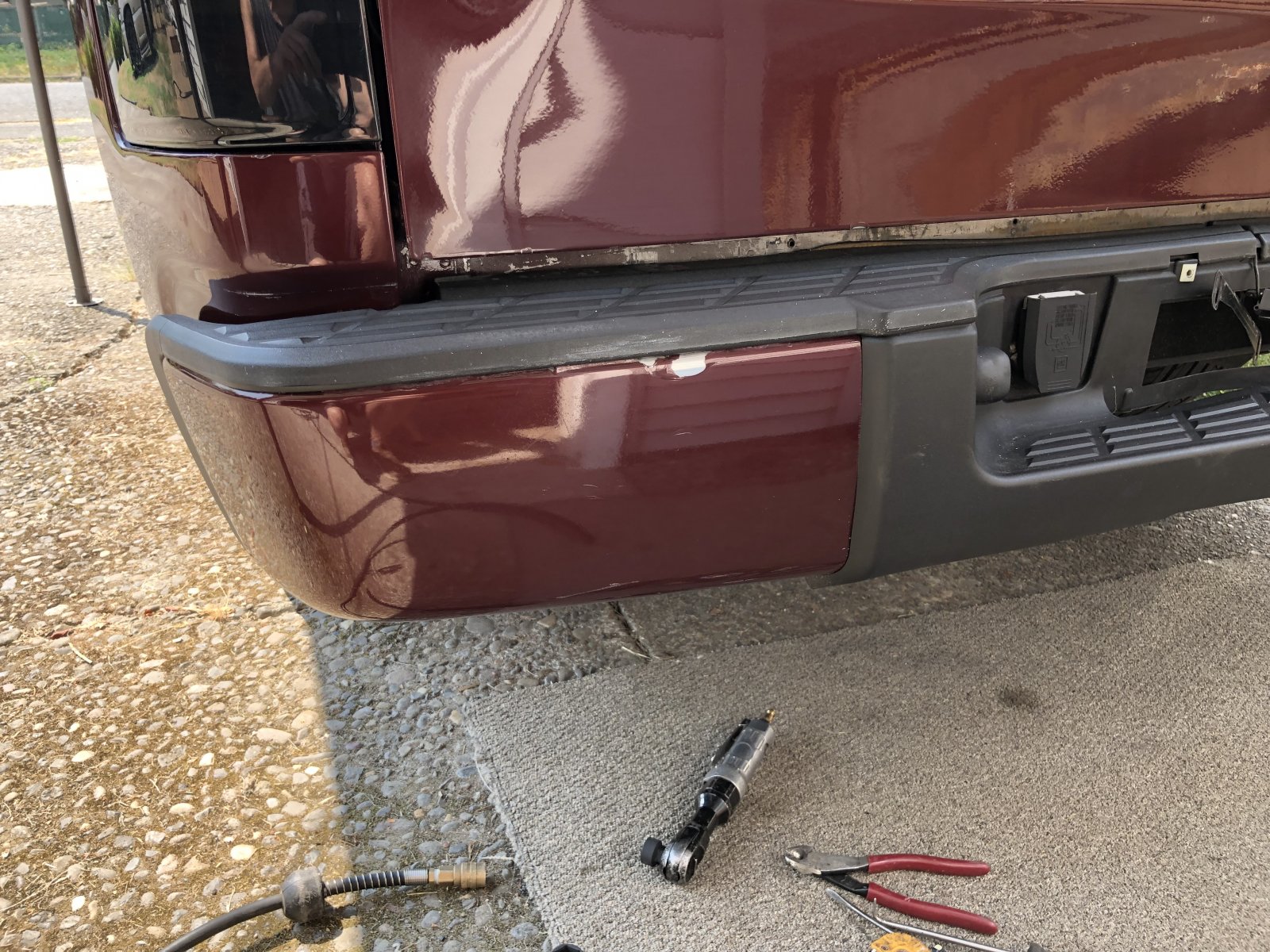

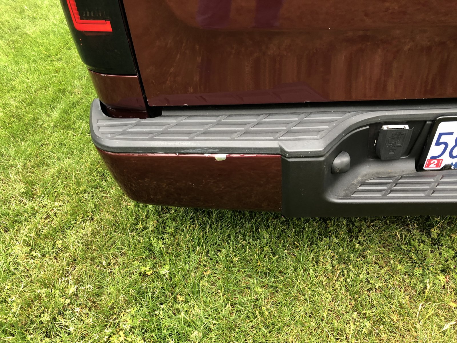

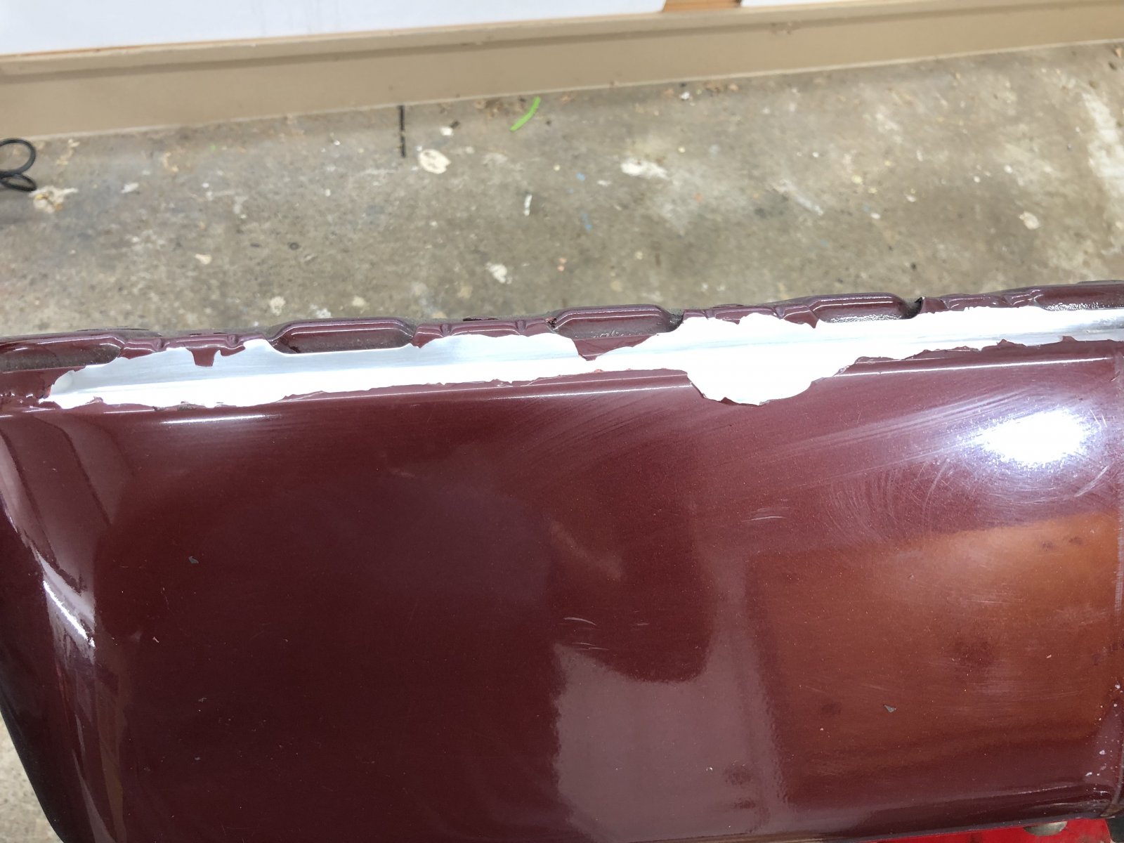

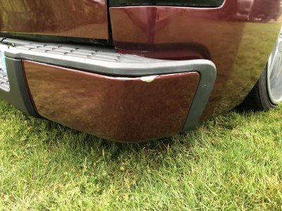

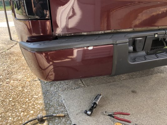

The paint on the rear bumper has started flaking off. I see shiny chrome underneath so it looks like they didn’t even sand it before spraying. I ordered paint from automotivetouchup and I’ll do this myself. Headlights are pushed further back since right now I’m in the middle of a backyard makeover. The bumper will need to be done before the headlights, it looks horrible. ****** assholes. :mad:

Well... do NOT like.. man, those clowns seem to have taken every damn shortcut possible. I swear, in the next 6 months, you will have rebuilt / refreshed the entire truck, minus some strategic chassis welds. [emoji35][emoji2959]

I wonder if sandblasting that chrome would help for the paint to adhere---if possible.

That sucks... Didn't know yours was chrome. When i did mine, I got the painted bumper

Eh, I’m just gonna sand it. I’ll start with 60 grit. I don’t have a sandblaster. It’s not a big area and it’s relatively flat so that will work.
I have successfully sandblasted chrome and used a good "self etching" primer before painting but sanding will accomplish the same thing.
The self etching primer helps to bite into the chrome and adheres better.
Sucks that you have to do this but at least you will know that it is right when done.
52,956
Well... I didn’t know mine was chrome either until lately. :crazy::gathering:
Edit: this is the bumper that was on the truck when I bought it but I was thinking about installing a 2015 one. I actually have one of those I got for free but my mounts are made for the 07-14 one and won’t work on the 15. My frame isn’t stock so it’s not an easy swap like yours was. I’d have to fab mounts and decided to just run the one I have for now at least.
50,986
19,536
To be fair, painting over chrome is not the easiest thing to accomplish. Doing what @NathanJax did and painting a painted bumper is more ideal
52,956

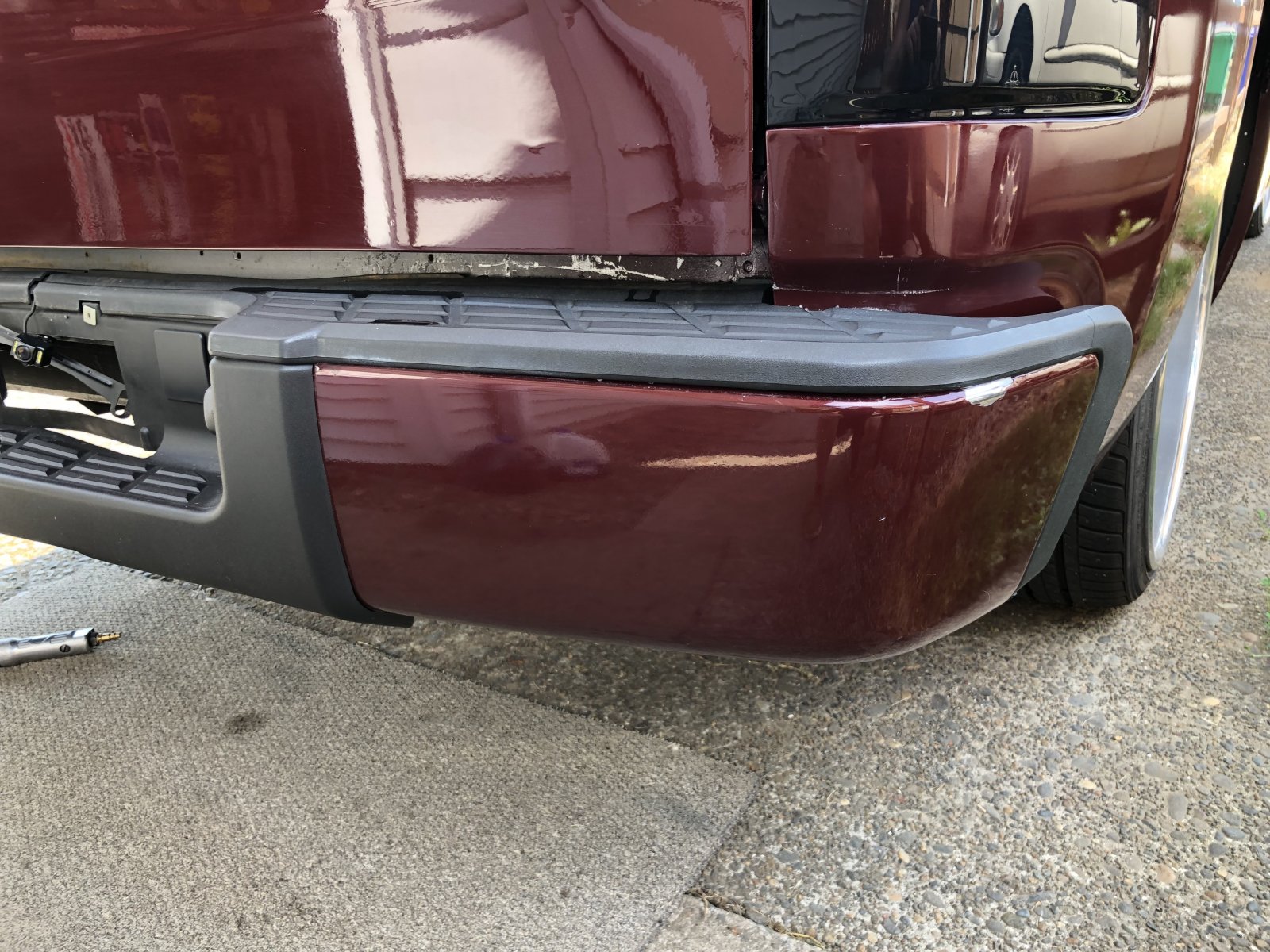

Agreed 100%. I waa under the assumption I needed to buy the entire bumper minus the black plastic parts because that’s what I found when I searched and they’re $400 aftermarket. Today I pulled it and went to my auto paint supply store to get aircraft stripper but they don’t like Mondays. Tues-Sat only. Which was great because I came home and was looking at the thing and noticed the ends are riveted on. So I looked up the parts schematic and I saw I can buy just the paintable ends. And then believe it if not I can get them on Amazon for about 50 bux each. And I had just dropped off parts from my Denali that I was returning and by the time I got home that was already available in my Amazon account. Love their return policy- as soon as the boxes are scanned in at the shipping place they put the money in my account. So it was almost a wash. Score! Too bad it’s not Prime 2- day shipping but that’s fine. Oh, also I noticed one side had a small dent anyway. It doesn’t look like they even roughed up the chrome before painting.

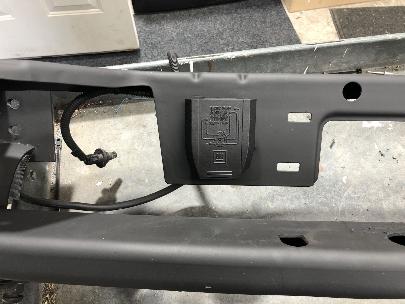

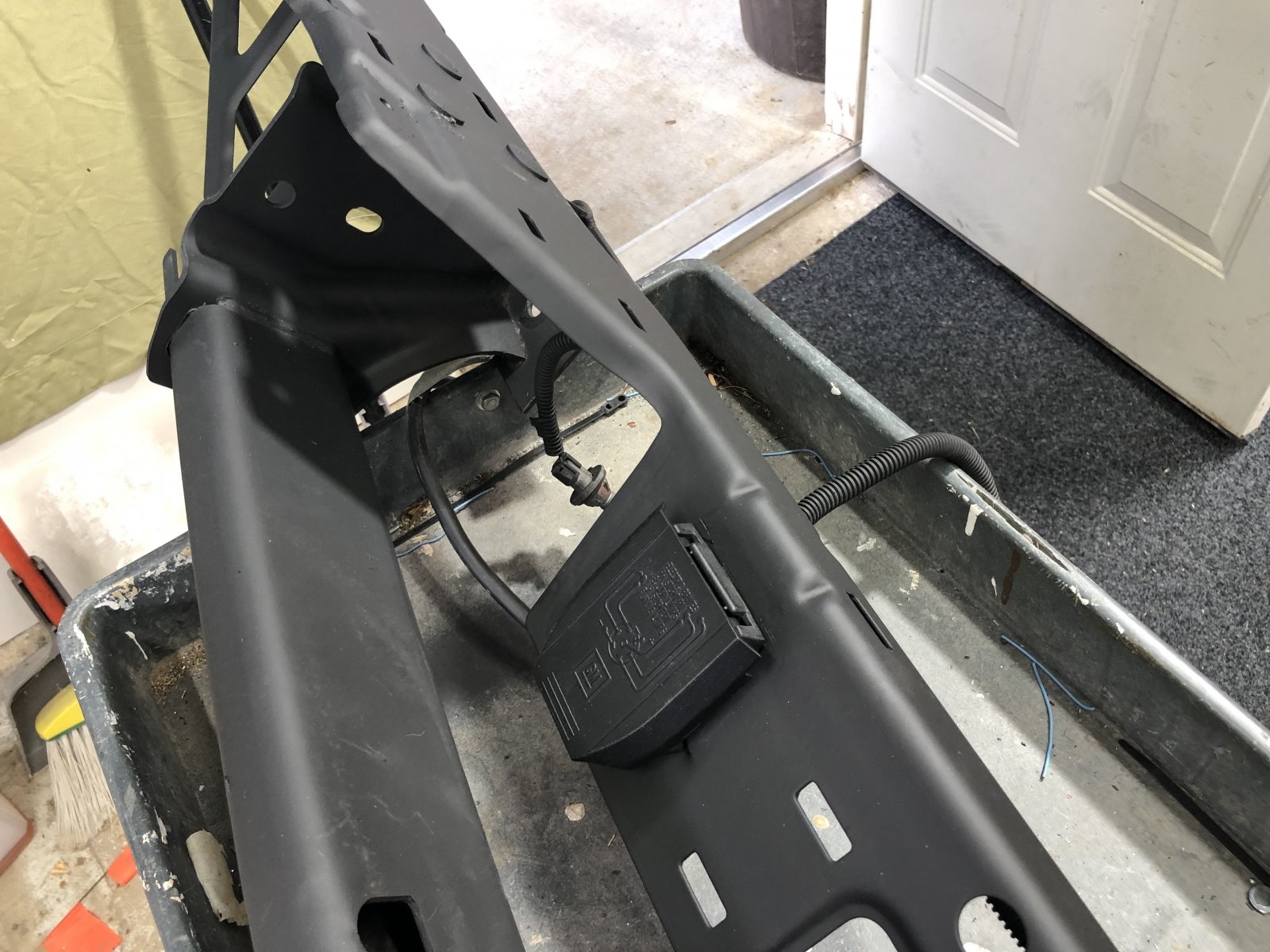

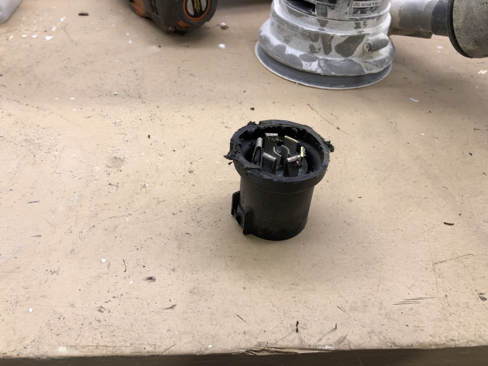

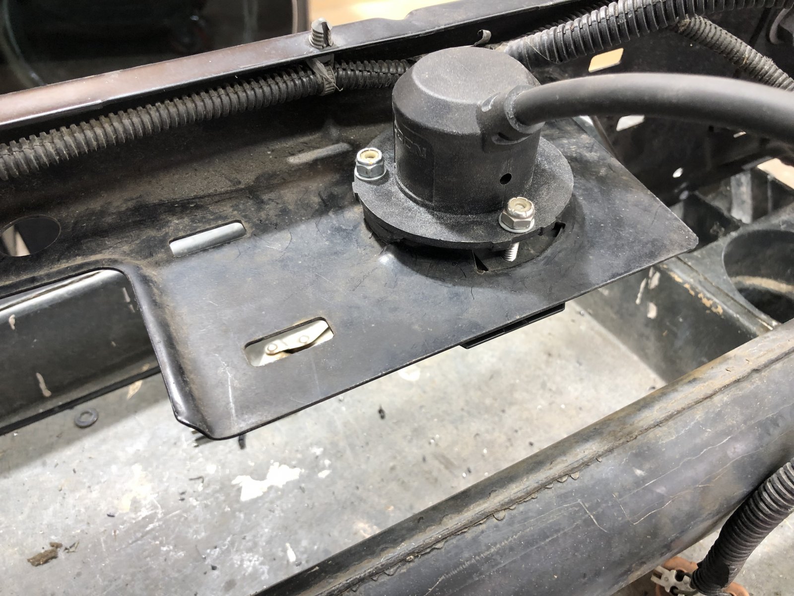

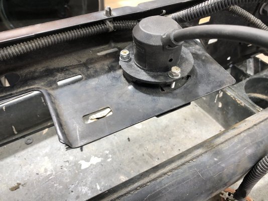

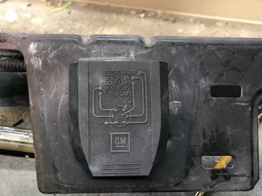

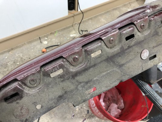

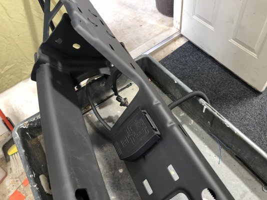

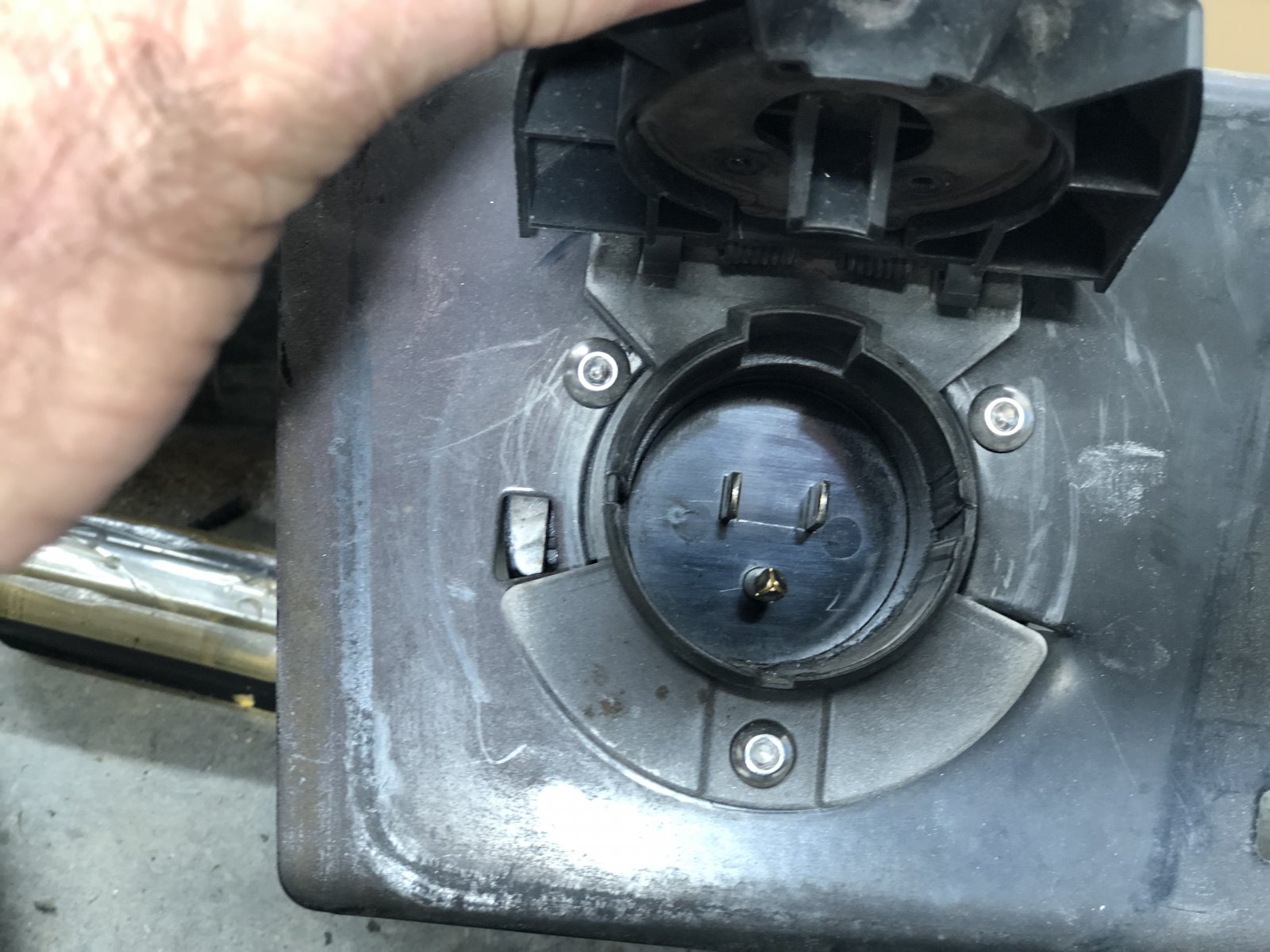

I decided to look at installing the 120v receptacle in the rear bumper. My goal is to be able to plug in the battery maintainer at the back of the truck. I installed an outlet in that corner of my garage when I remodeled it so I’ll just need a short extension cord. No more opening the hood and having a wire hanging down and a cord run along the fence. I ordered a mountable tender which OptiMate doesn’t make so I bought a Noco. I’ll extend the power cable and run it with my other harnesses along the frame.
At first I was going to remove the trailer wire receptacle and replace it with the one I bought from Noco. Which would have been ok but I decided since I wasn’t going to use the factory one anyway, I could see if I could cut it up and use it as a cover for the new one. So now it will look like the factory trailer connector but when you open it up there’s a 120v receptacle instead. The tender will be all wired in so all I’ll have to do this winter is open that cover and plug in the cord. I still have to take it apart and paint everything but the prototype is done.

Now you got me thinking. If the charger was not mounted in the truck you could just charge it through a modified 7-blade adapter, using the 12v Aux (connected at the fusebox, of course) and ground conductors in the trailer connector.
52,956
But then the charger would be out in the weather, snow and all. Or I guess I could extend the 12v output wires from the charger and keep it in the garage. I like this way better though with an extension cord from the garage to the back of the truck. The charger is pretty small, it should be easy to mount even though my under hood space is limited.
Agree completely, what you have is perfect for your setup.

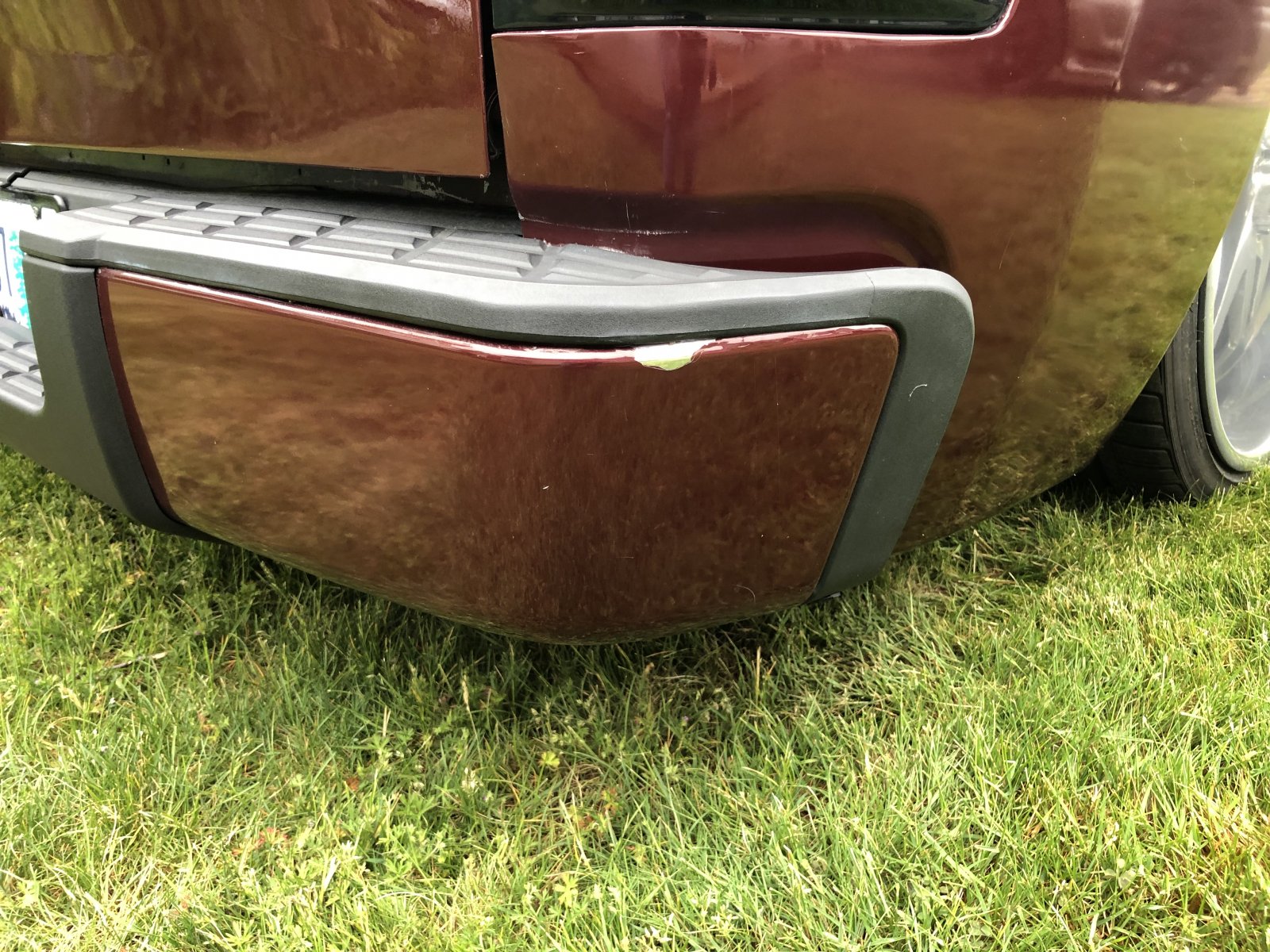

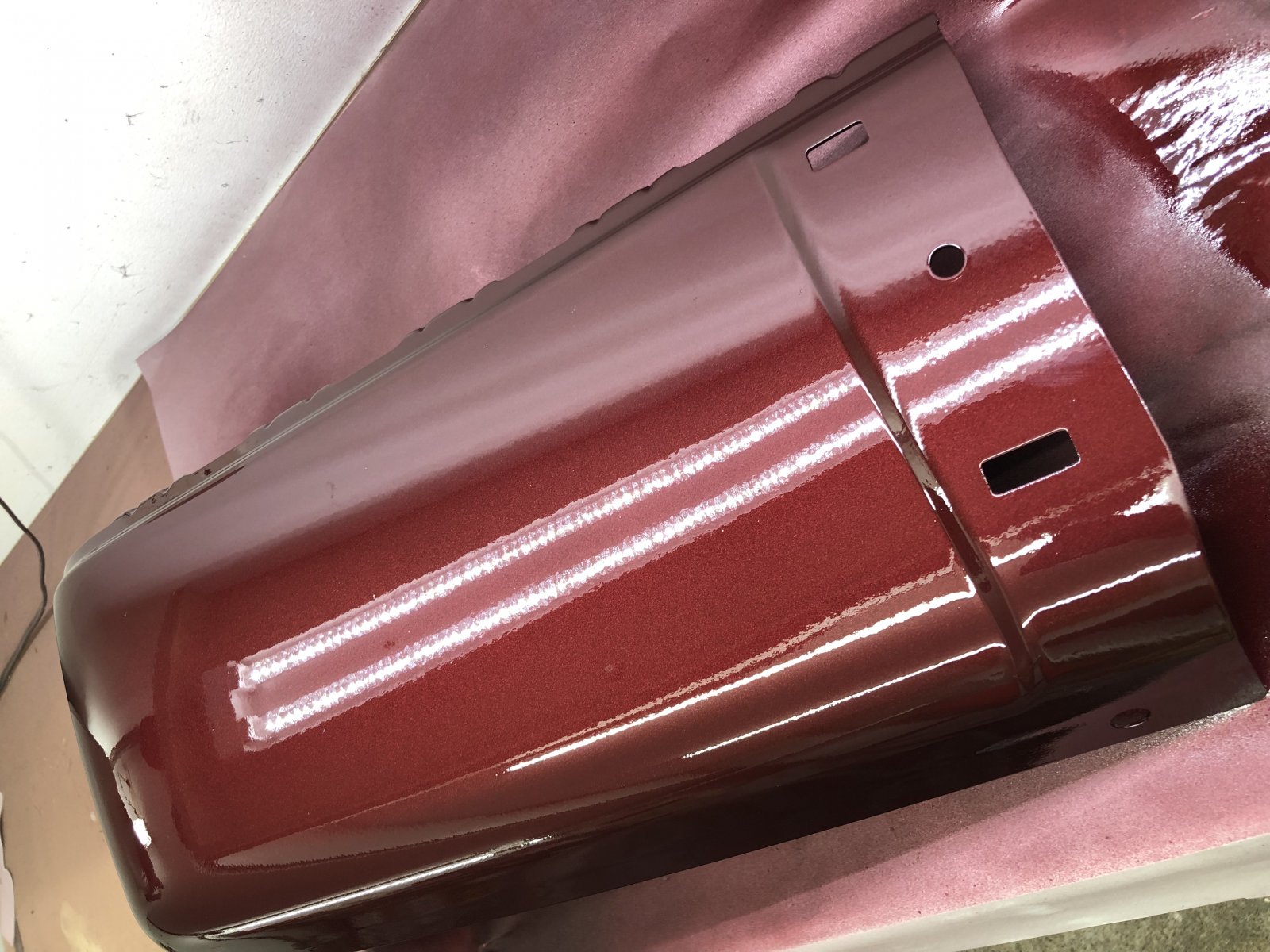

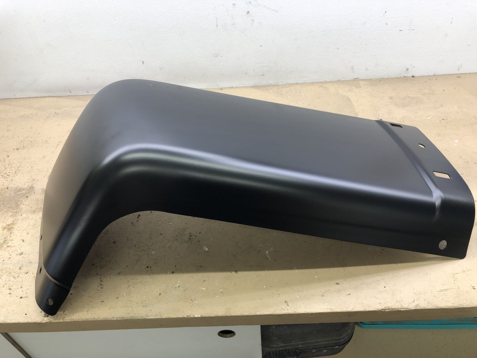

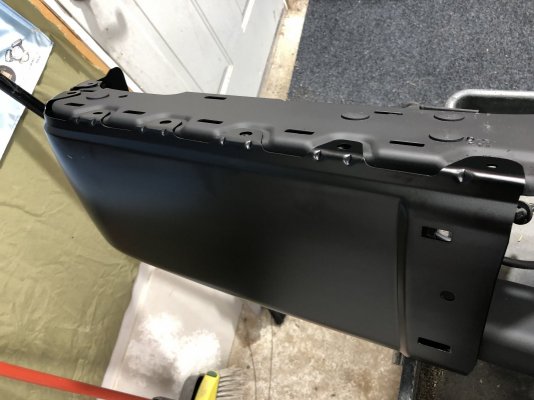

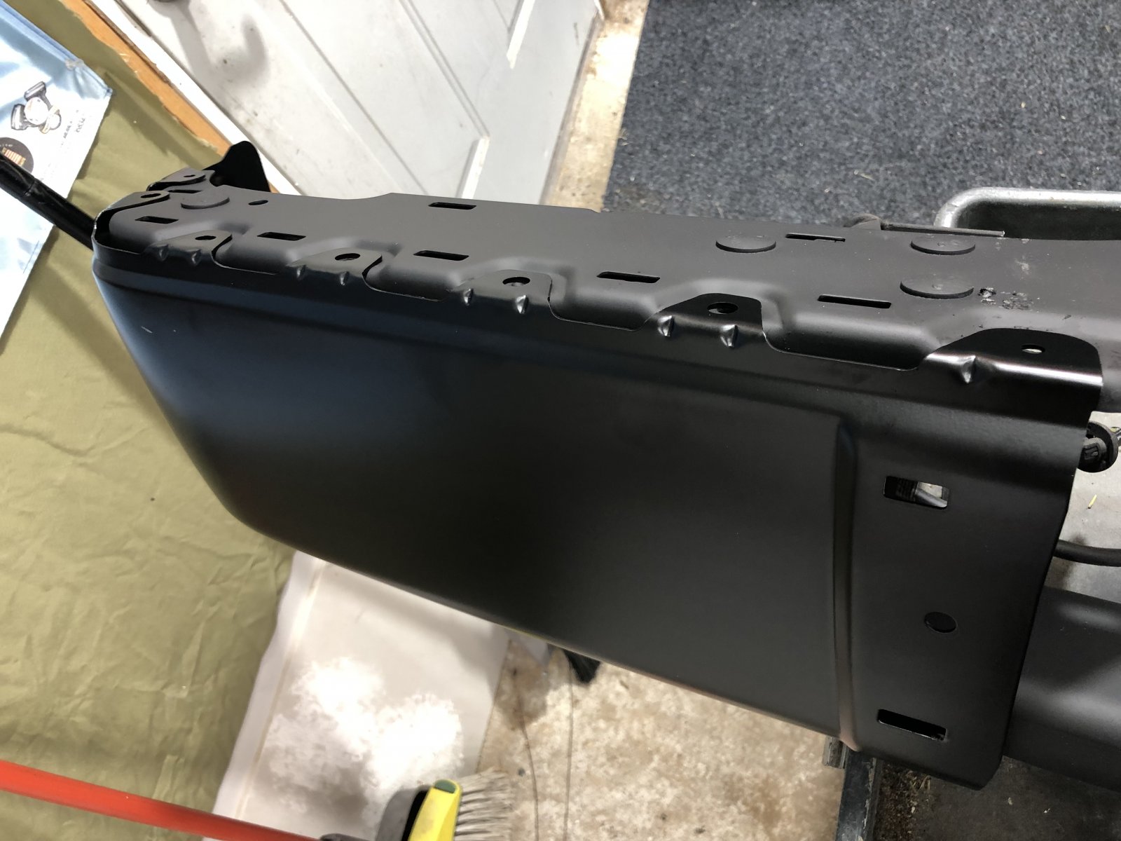

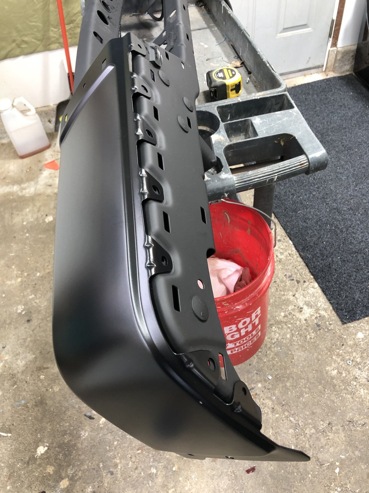

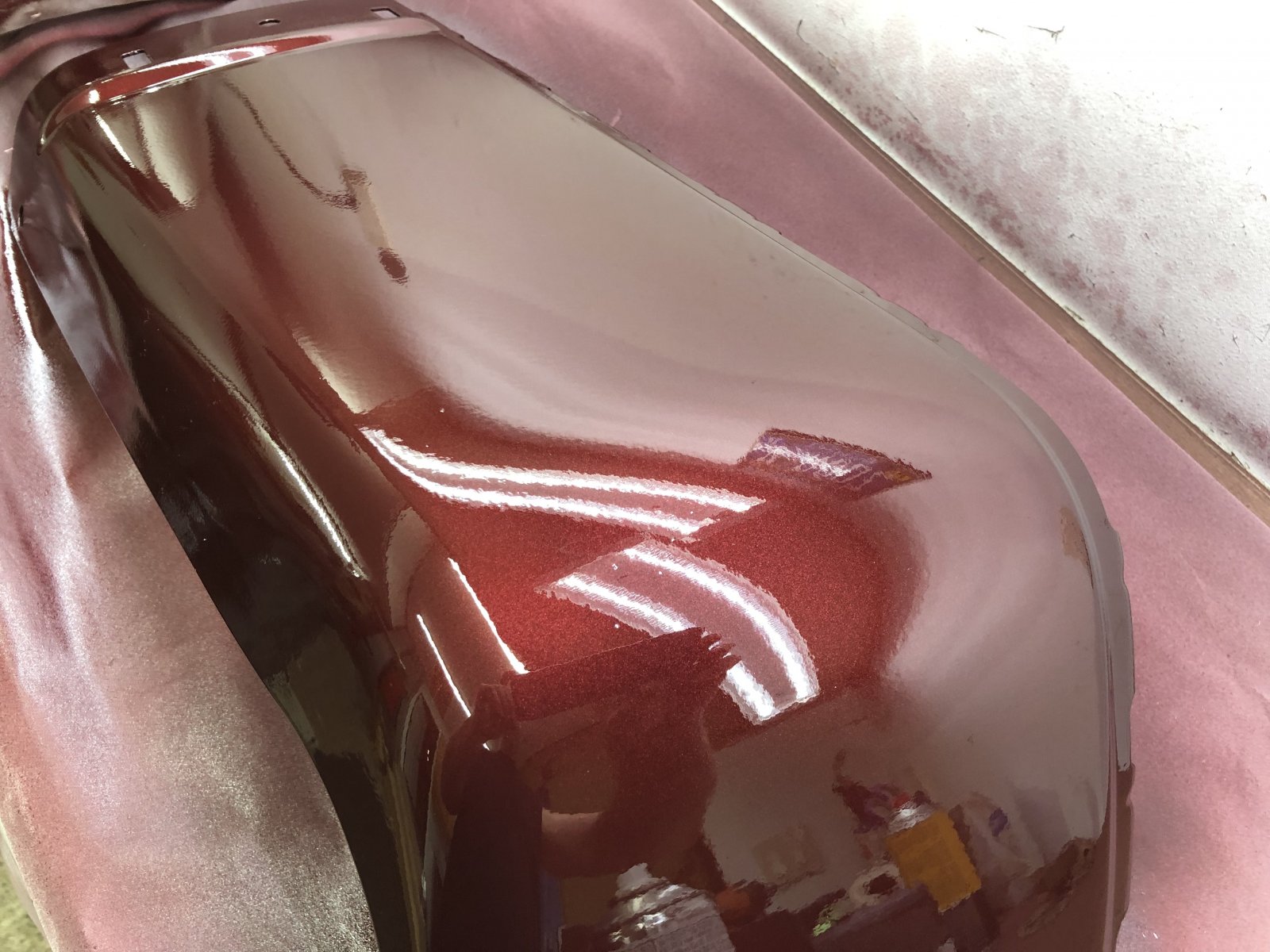

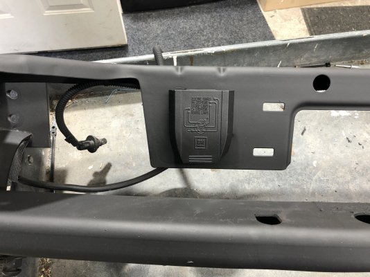

I got the bumper ends today. I need to sand the orange peel out of them and then paint, clear and assemble. I painted the main bumper parts in flat black.
