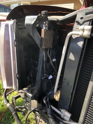

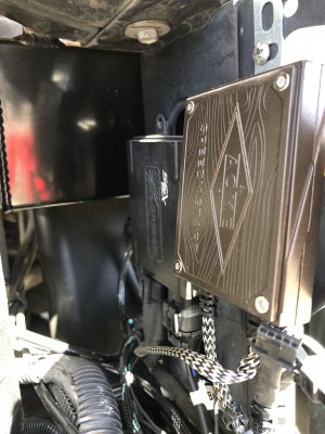

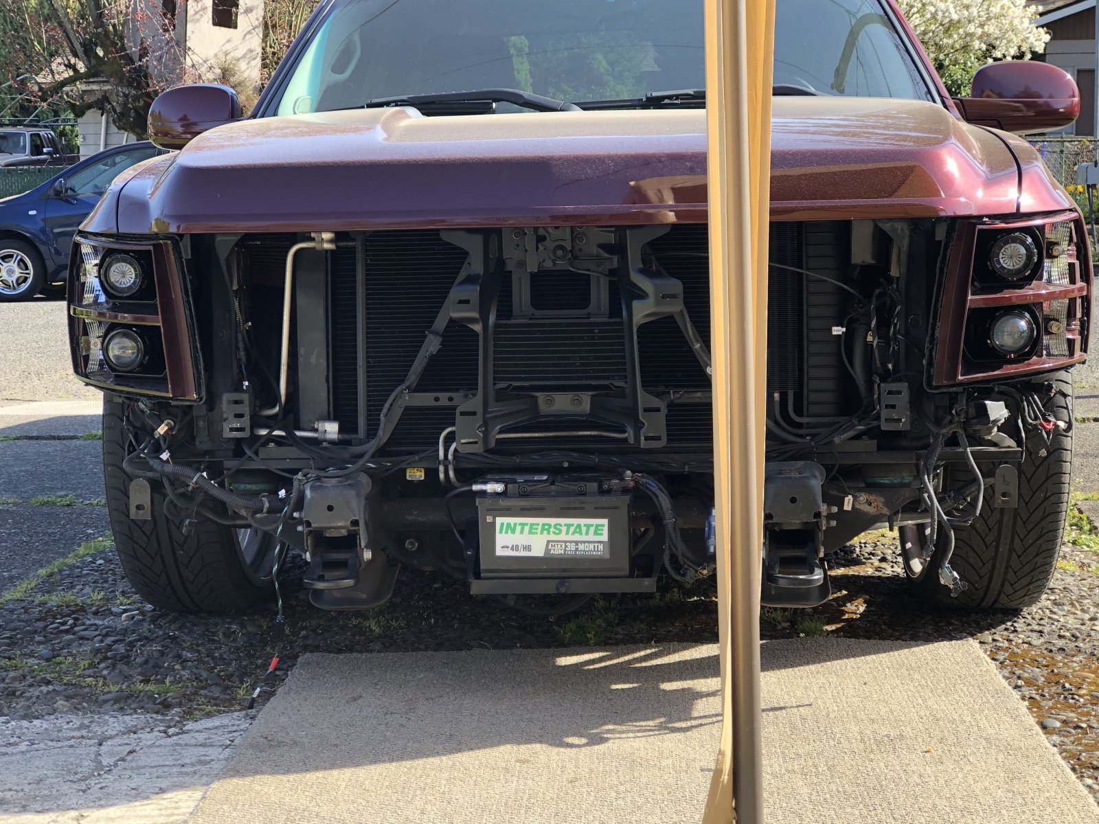

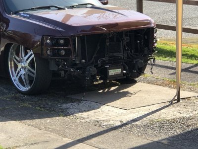

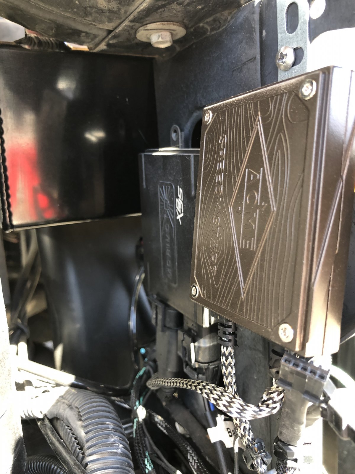

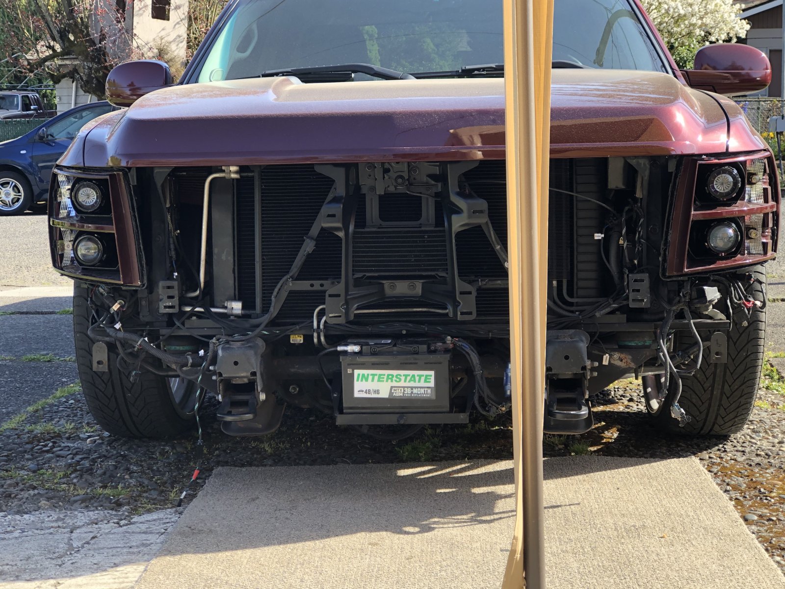

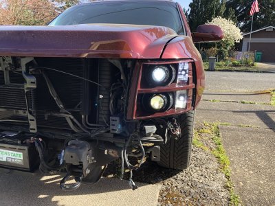

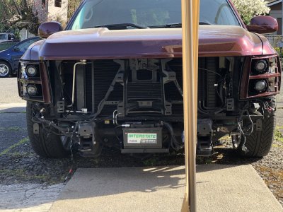

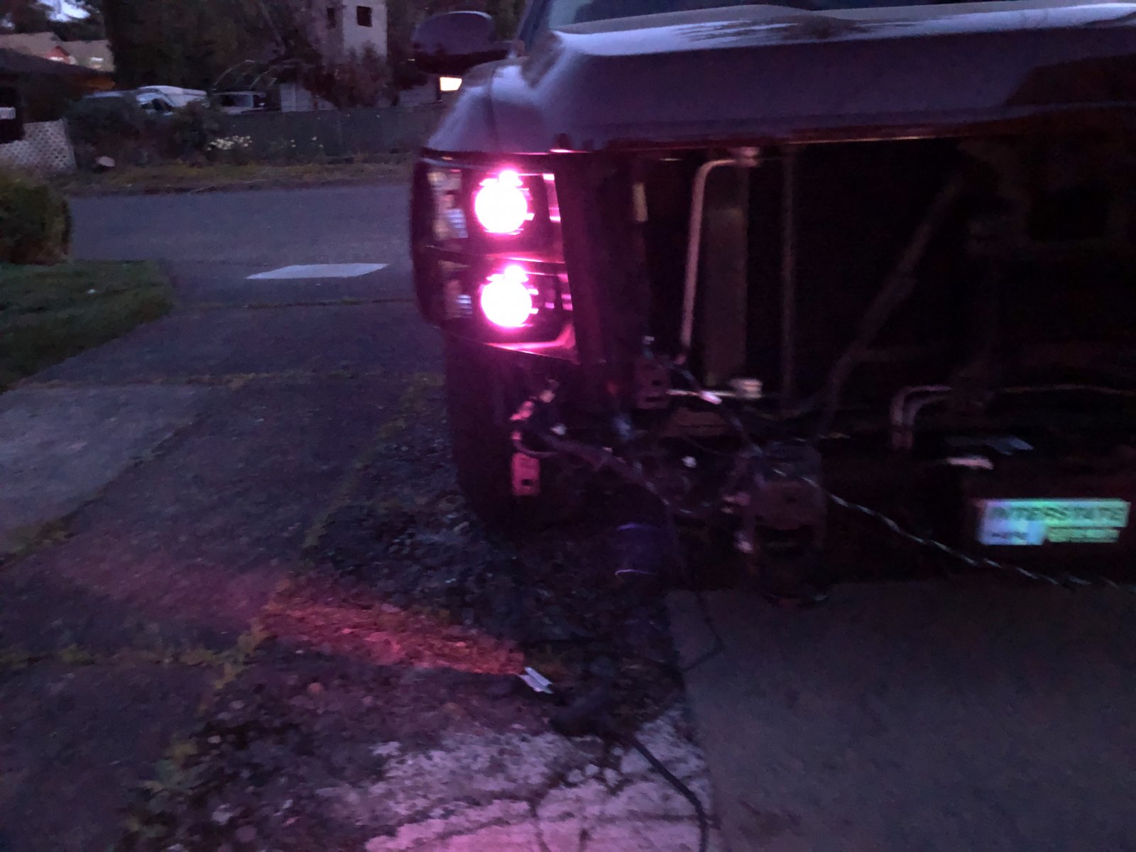

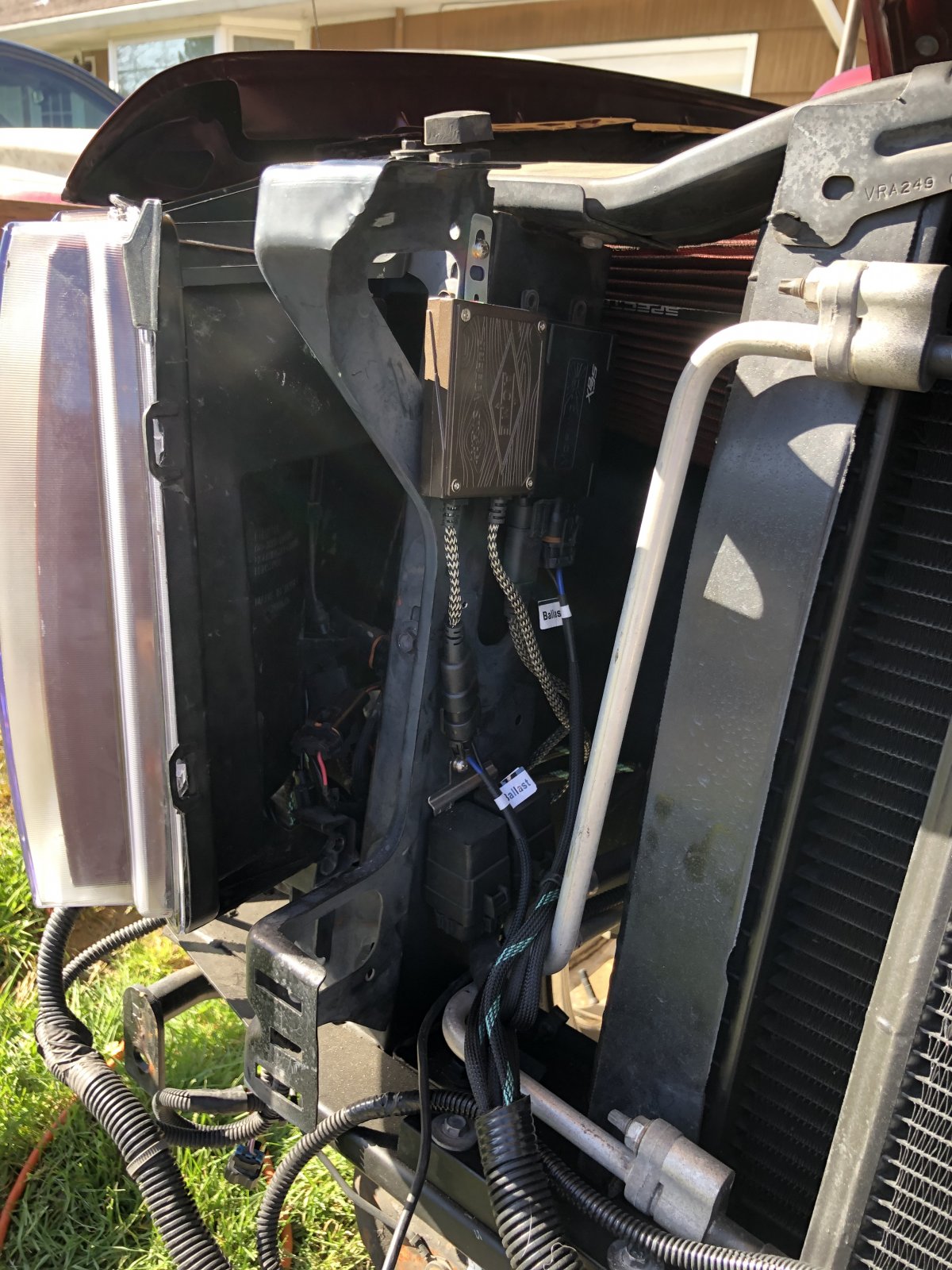

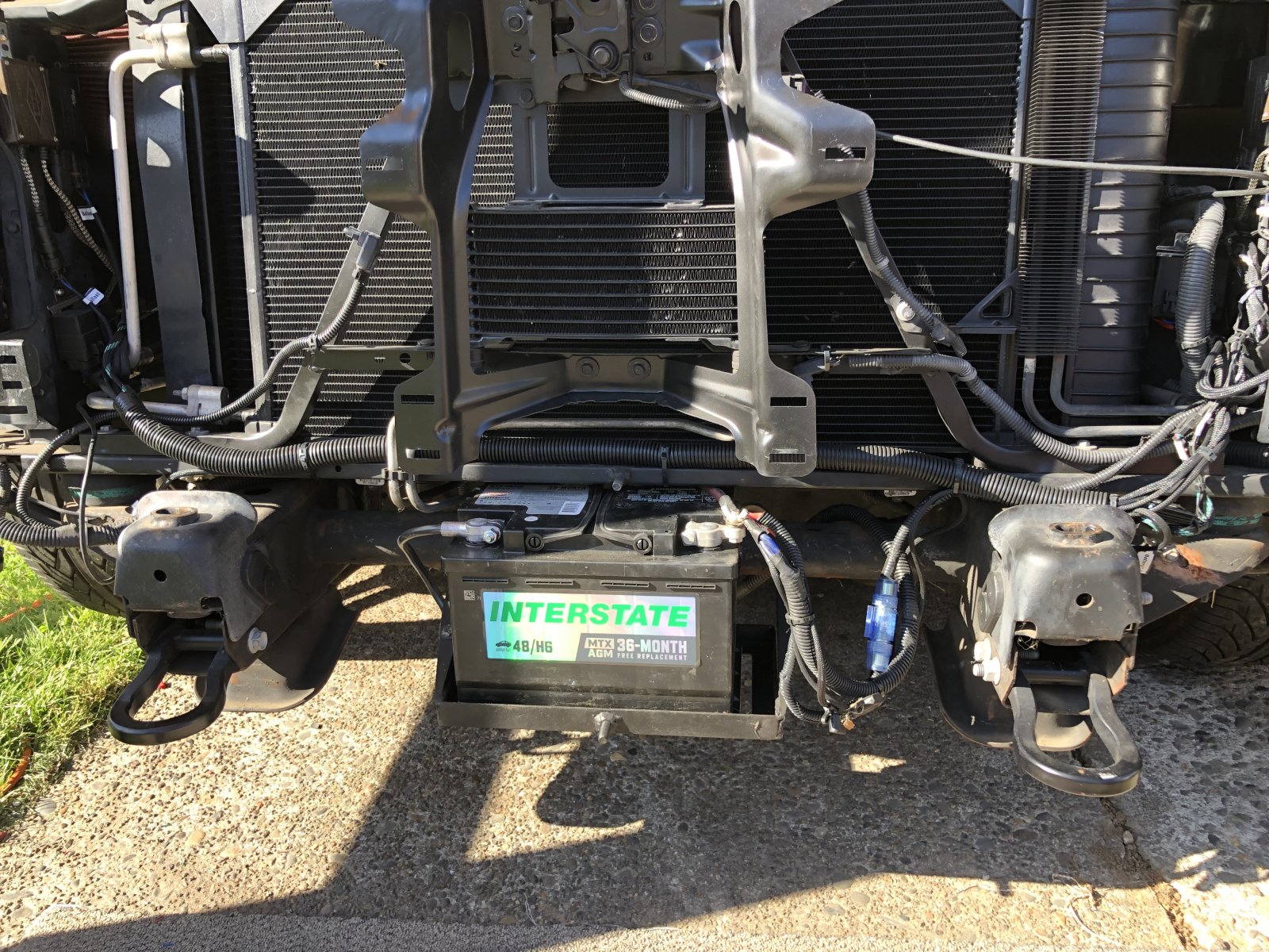

I got the projectors in and mounted the new ballasts and relays. I did most of the wiring but still need to add the drivers and wiring for the second set of demon eyes. I have the lights mounted and the truck is aimed at my garage door and leveled out so I can adjust the horizontal lines by rotating the Acme’s. I’m hoping the horizontal height is ok on the new projectors because there isn’t a separate adjustment for the upper and lowers, just an adjustment for both at the same time. I guess I’ll see tonight. These are gonna look badass.
A74D3209-1646-4127-99AF-D35CA01D189E.jpeg 10C3C4B5-DD27-4576-9983-B45D74E81F4B.jpeg 23EE7407-F027-4B0F-9802-589DF6E550A1.jpeg
52,956
Of course the bulb colors don’t match. Back when I ordered this stuff I couldn’t find what color my Morimoto’s have in them. Tonight I found what I think are the boxes from the Silverado but might be from the Denali. They’re Morimoto 5500k. The Acme’s I ordered were 4300k. I was gonna order the Morimoto 5500’s but it looks like they’re either 5000 or 6000k now. I’ll look at the bulbs tomorrow when I pull the headlights again. Might just get Acme at 6000 k, they’re less than half price of the Morimoto.

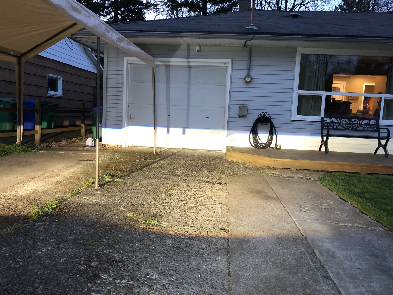

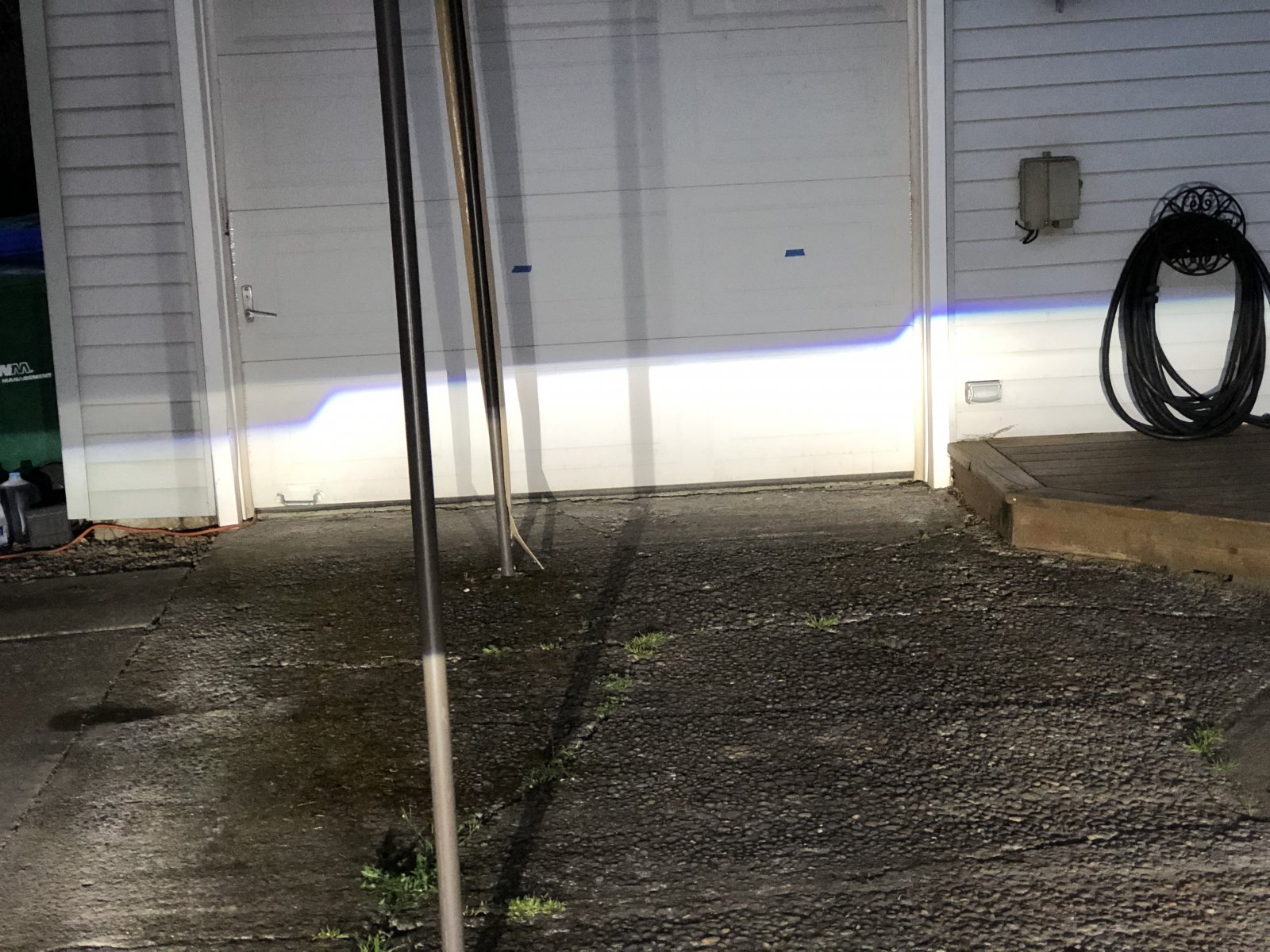

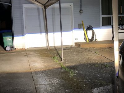

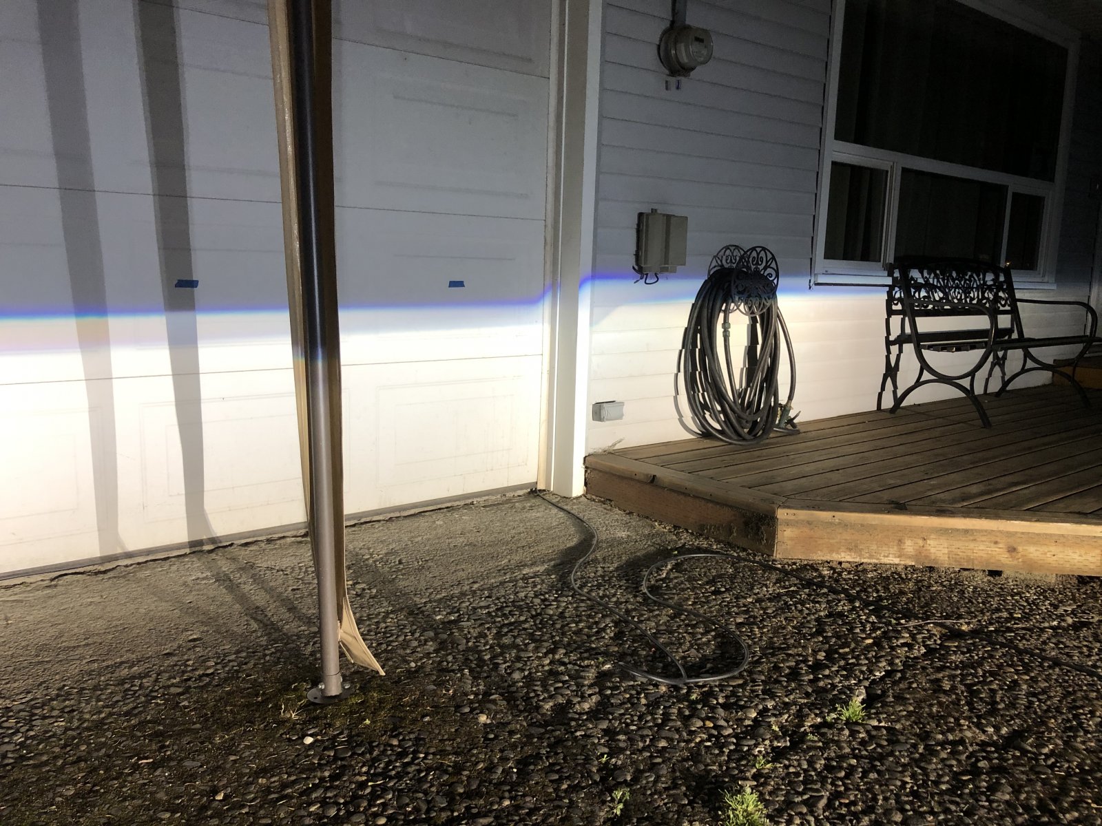

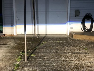

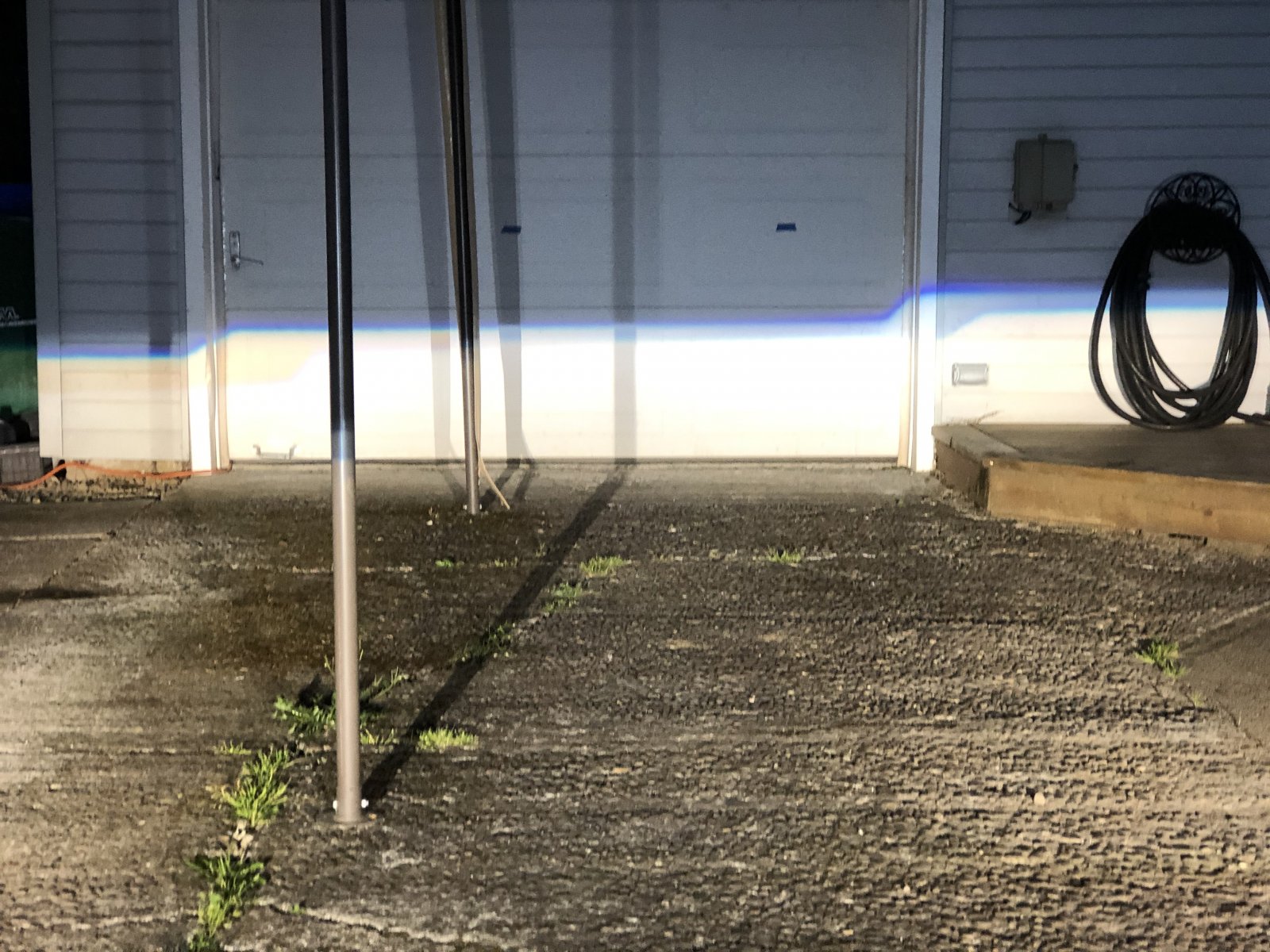

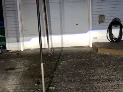

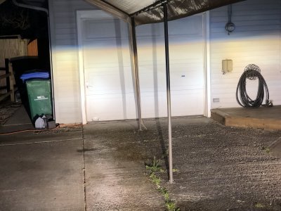

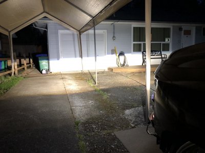

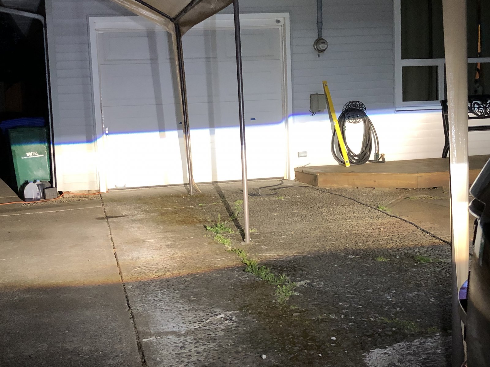

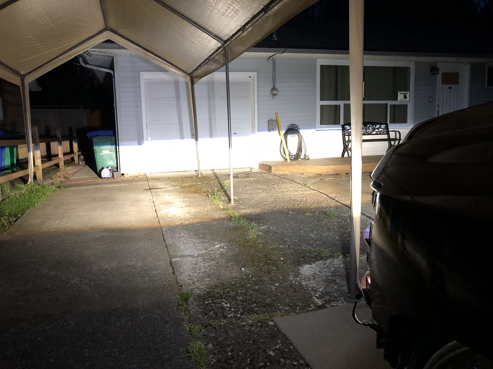

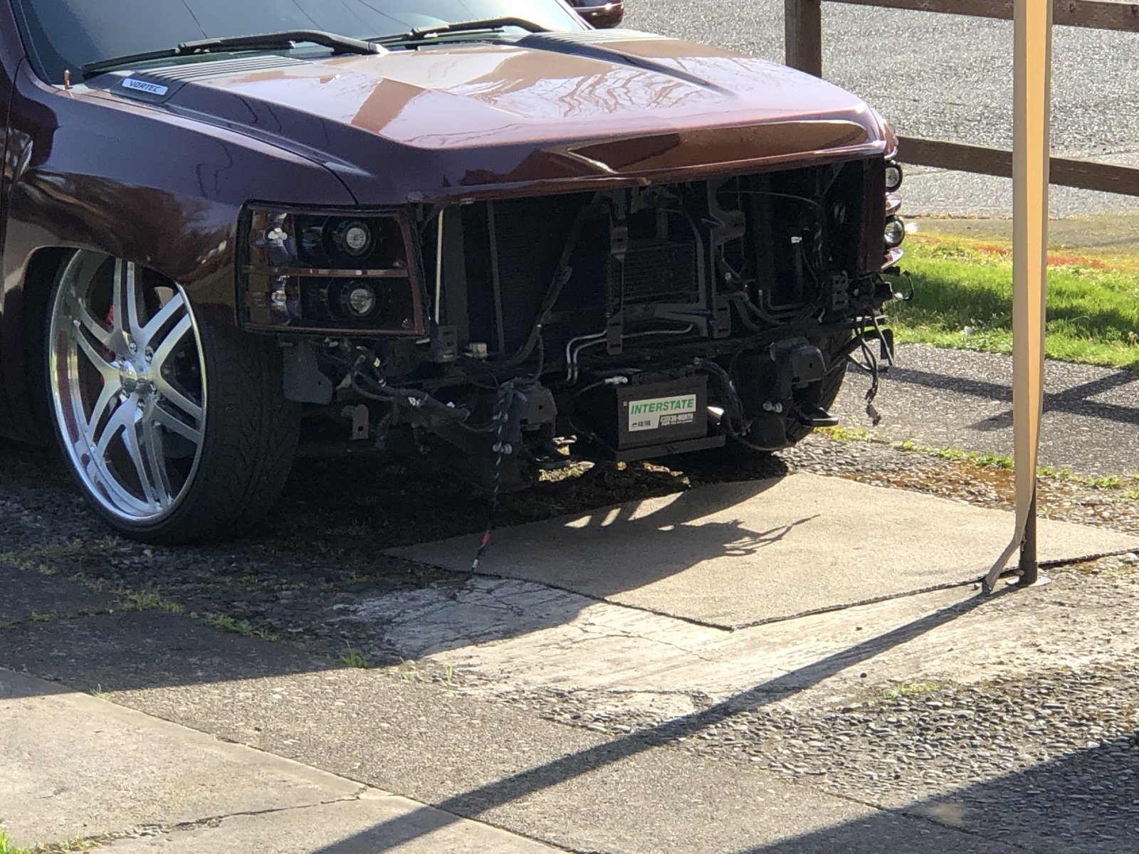

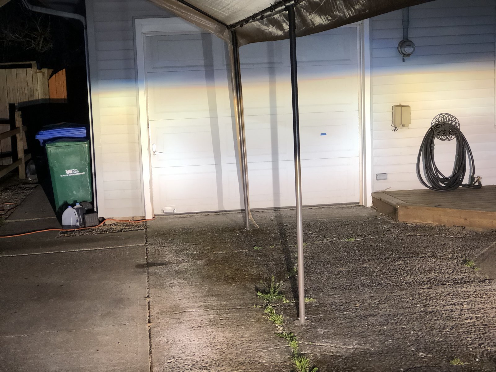

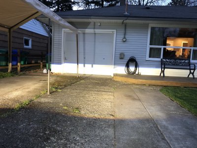

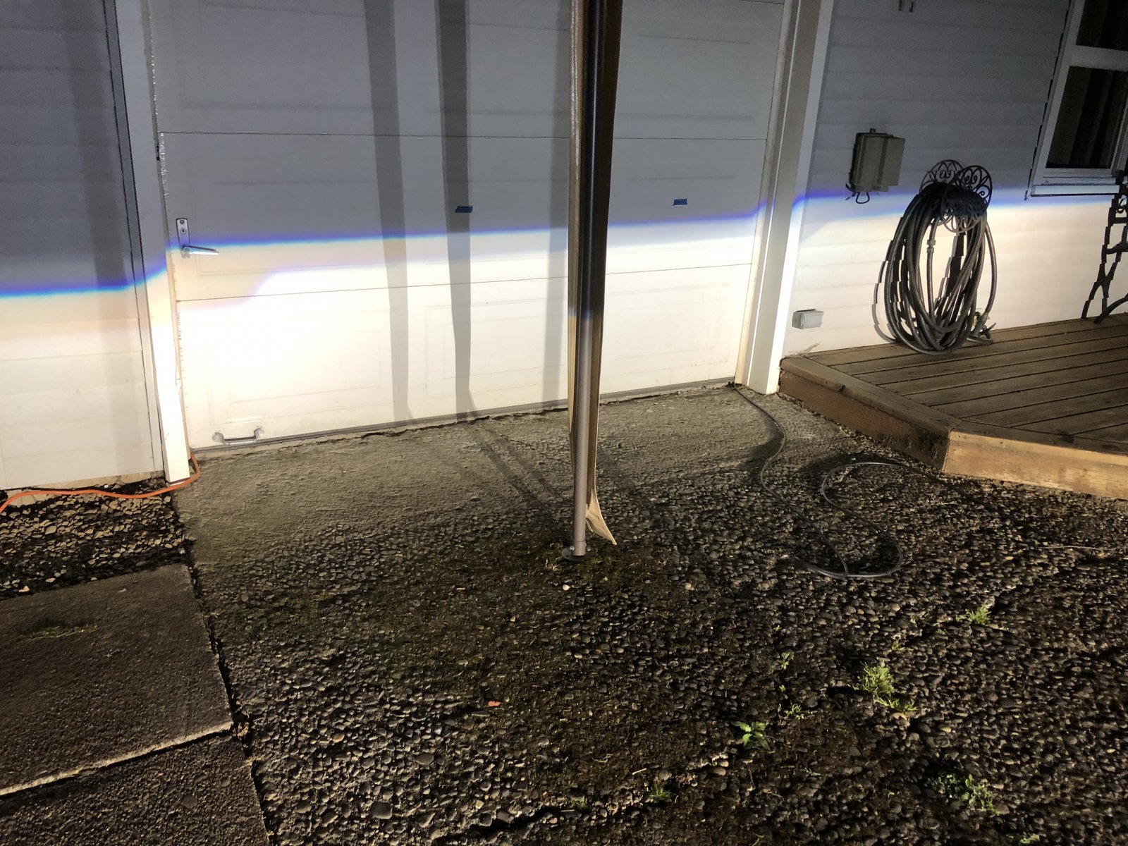

I aligned the horizontal on the Acmes. I’m pretty surprised how good they line up with the Morimoto’s. At first the passenger side Acme was higher than the Morimoto but I just grabbed it and forced it up real hard a couple times and it came out pretty damn even. The driver side was good from the get-go. I’m happy. Tomorrow I’ll epoxy the nuts so the projectors can’t rotate out of horizontal and then try fit them again tomorrow night before I bake them back together. Almost done! And as far as brights, when both sets of shutters open it’s like a damn ufo.
FCDCEF29-2C9C-406E-8723-95DCF599BAB6.jpeg E03E3643-1205-4B41-BAF7-94A664F12E70.jpeg DCF09309-B180-4760-B33F-62949856B57C.jpeg 21E28BEA-88FF-4059-848D-9AC401D68BE4.jpeg CC1B7609-A7AE-43E0-A93A-F5A2BB463F9D.jpeg
52,956
The pictures are kind of confusing. I’m pretty sure the first one was with both sets on before I adjusted the passenger one, then there’s a pic of each set on separately. The color difference is the indicator. Then the last 2 in the post with the demon eyes are with both sets on and adjusted. Sorry, I’m tired...:(. And yes my driveway is a POS. It’s old like me. About the same age I think. :mad:

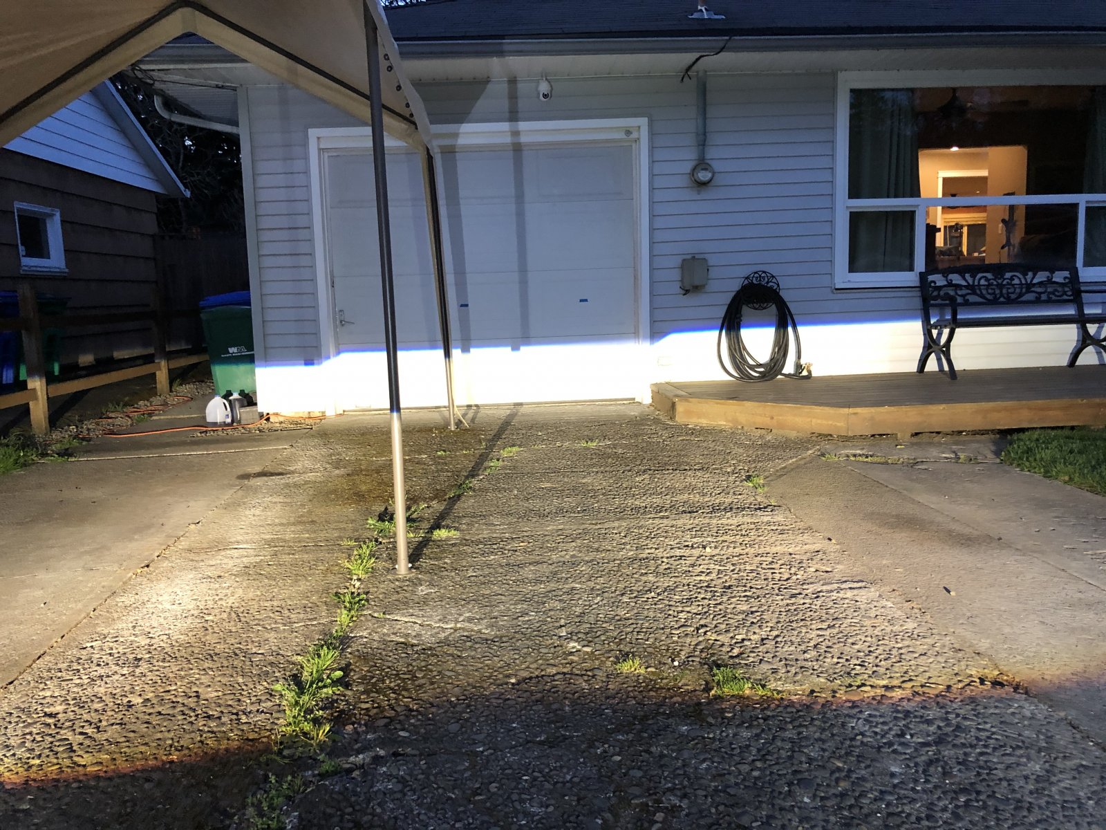

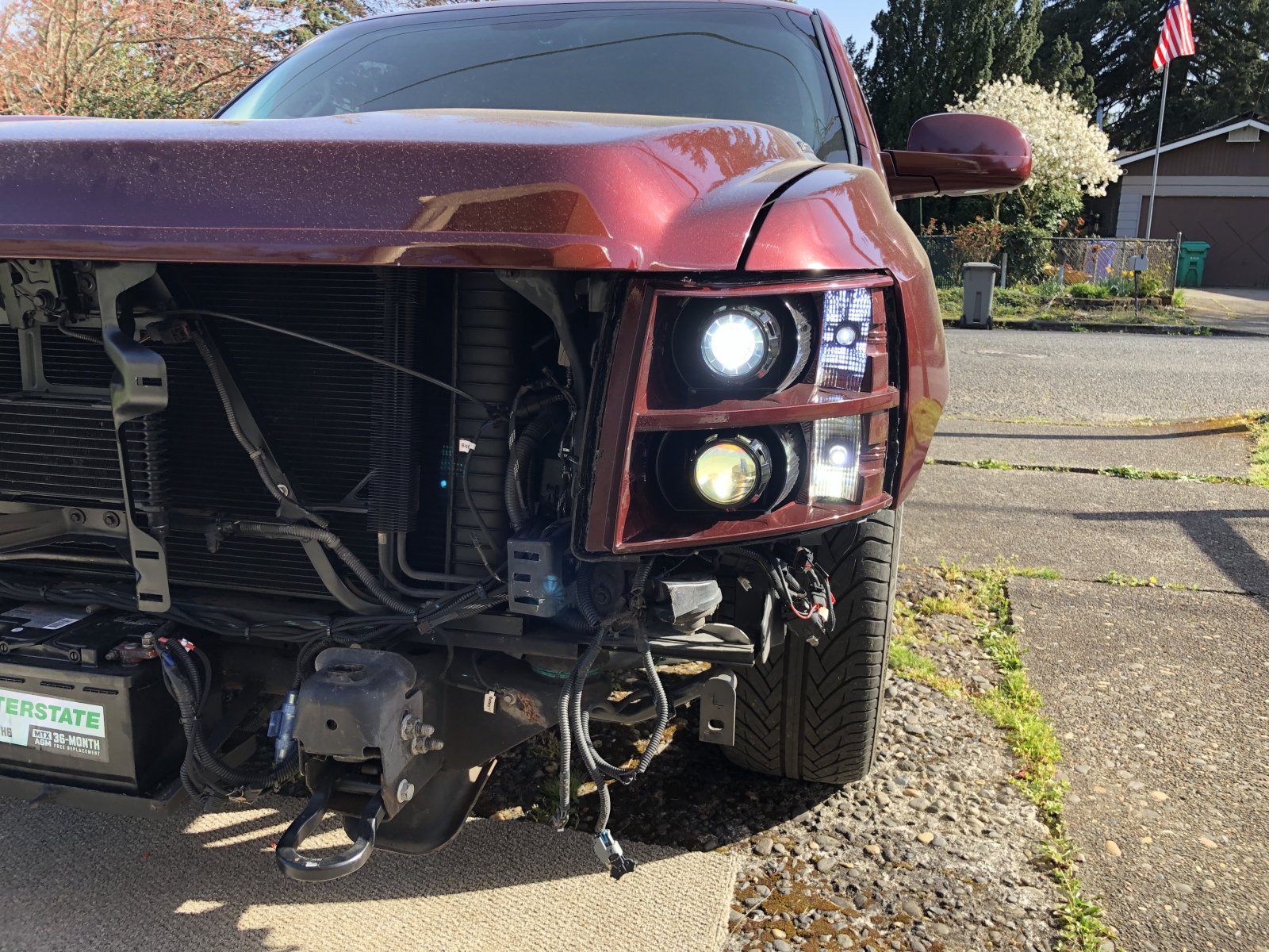

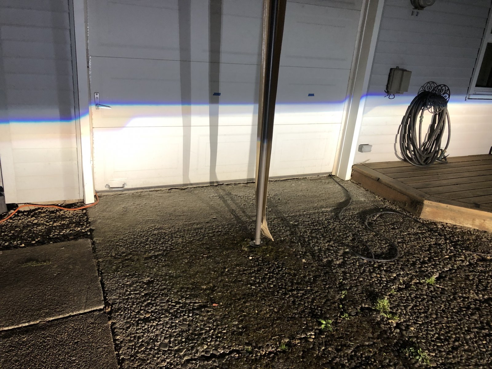

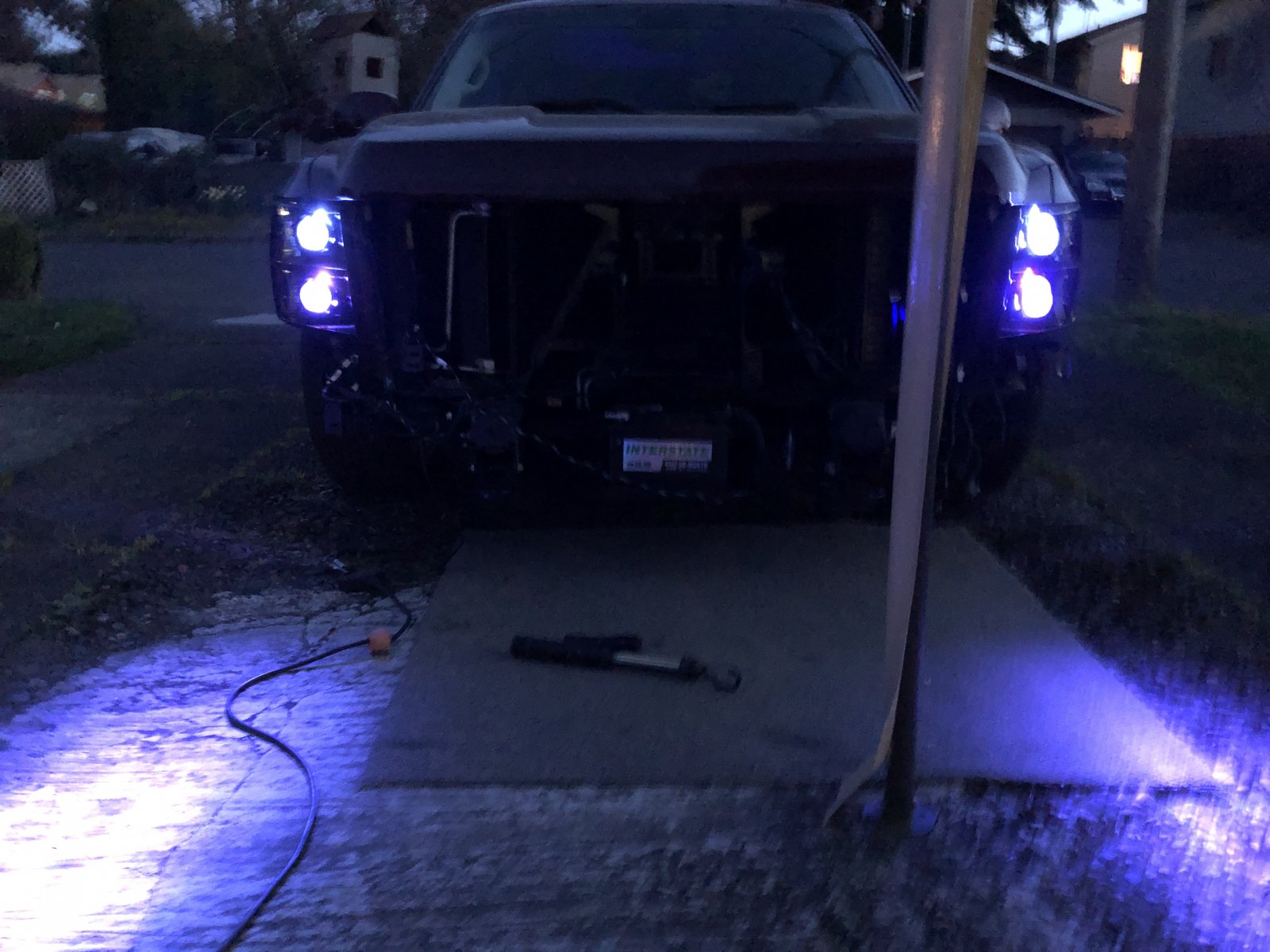

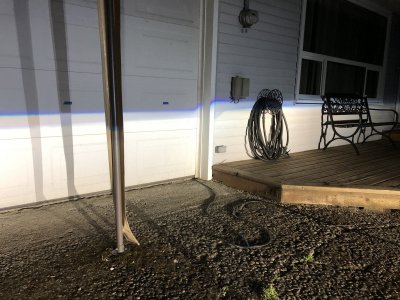

One last set of pics before I go to bed. Now that it’s darker I can see the upper and lower sets better. The upper Morimoto’s are whiter and sit a couple inches higher than the more yellow ish Acmes. But pretty damn even and consistent with both sets of steps lining up too.
E65D0E72-04FA-4259-9557-09BC37706CED.jpeg D1E0CD3F-FCA9-446C-9BDC-64045866E405.jpeg FB0FC34E-1F4E-43F3-A3F0-D8E778F35405.jpeg
52,956
Wait...I swear those pics look different than the actual lighting on the garage door. In the pics it looks like the whiter ones are on the bottom but on the wall they look opposite. And I swear the lower sets project a few inches lower than the upper sets. Love the blue line though.

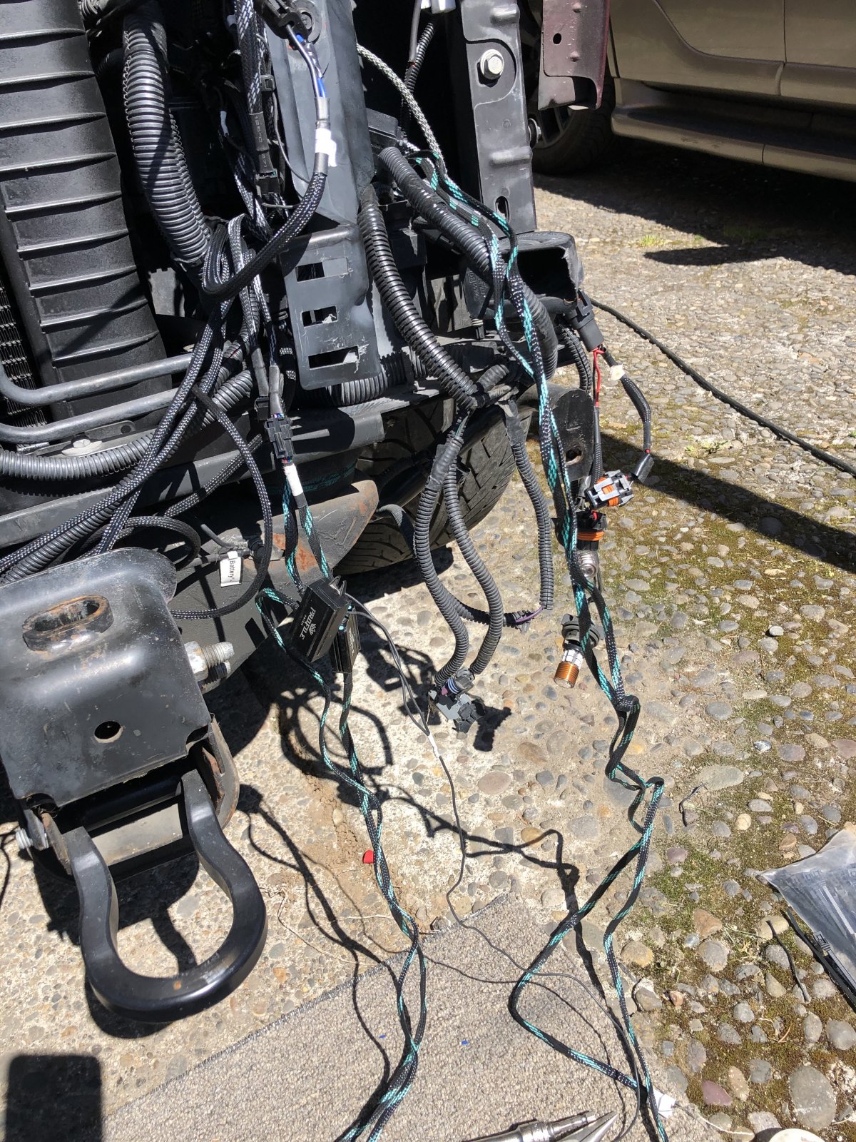

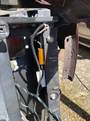

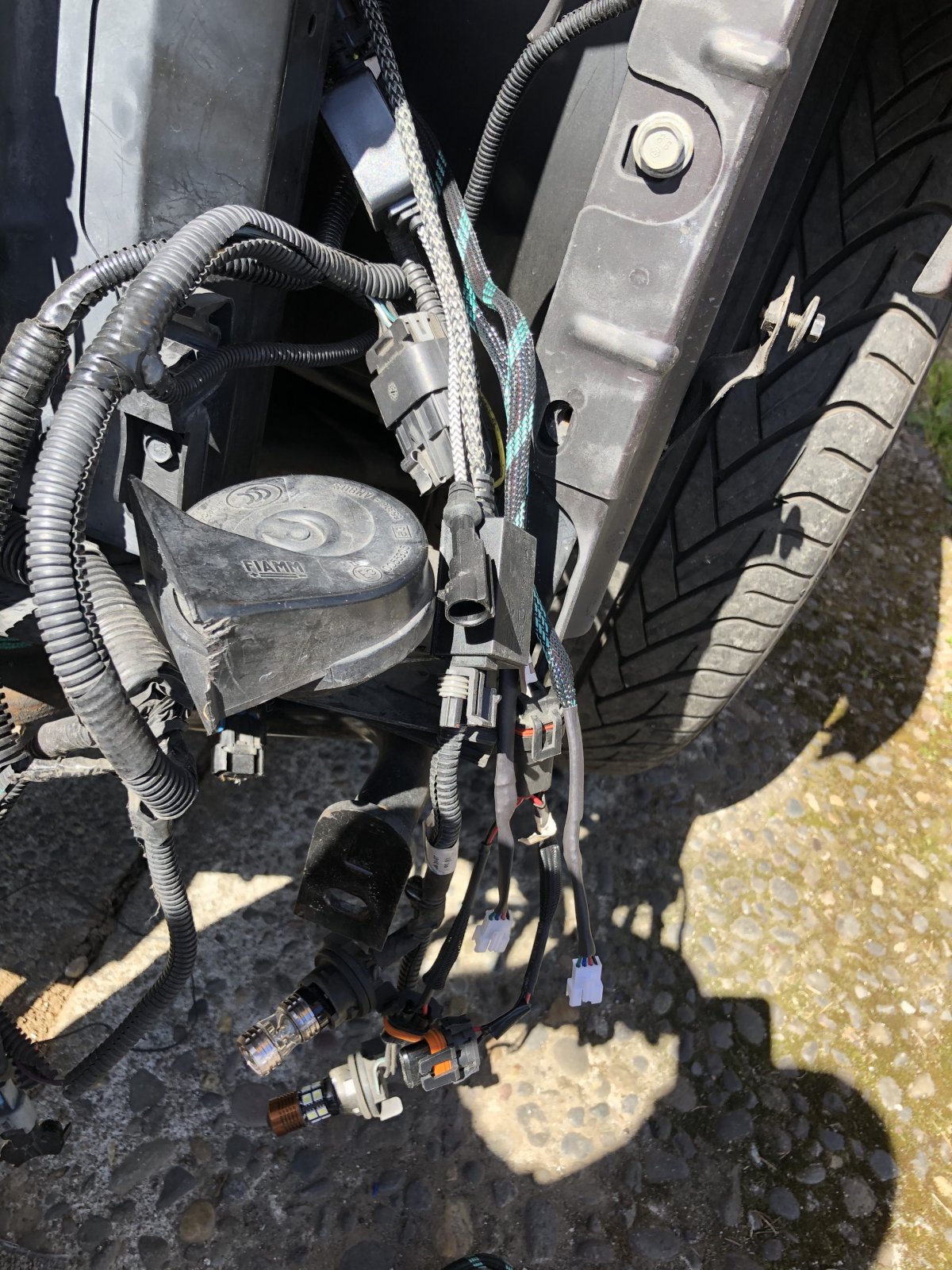

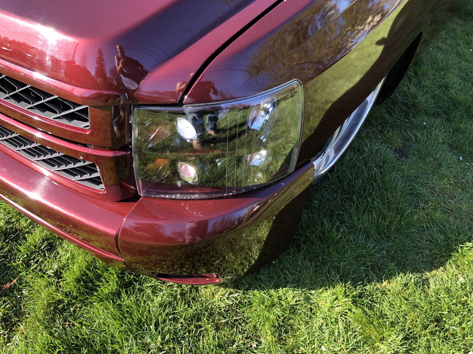

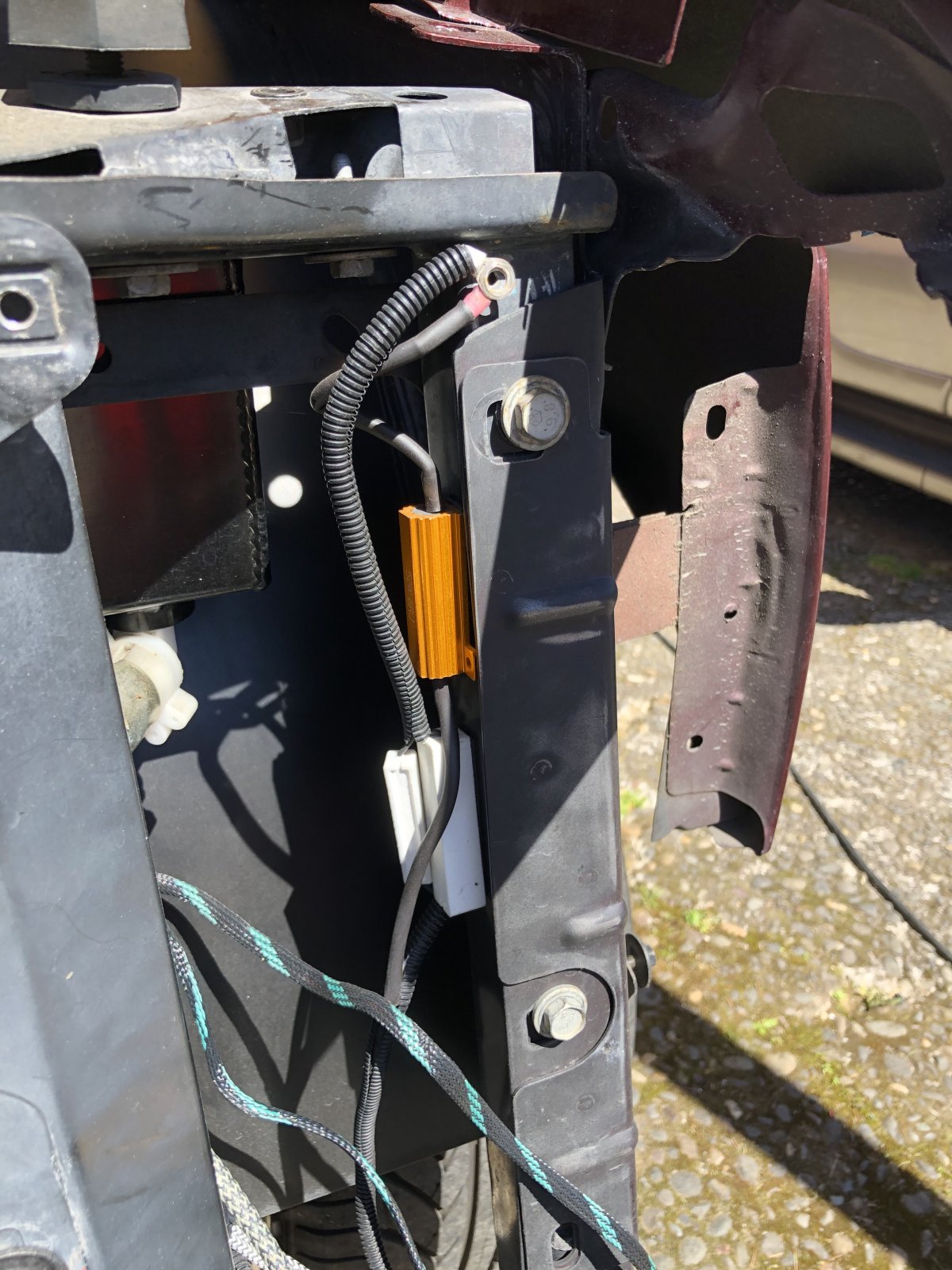

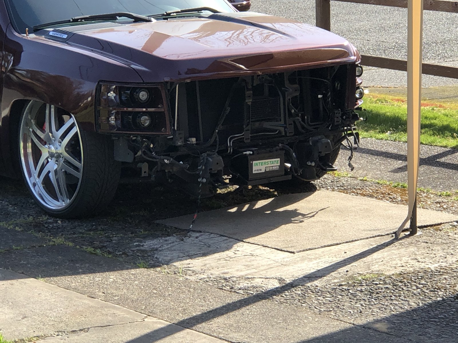

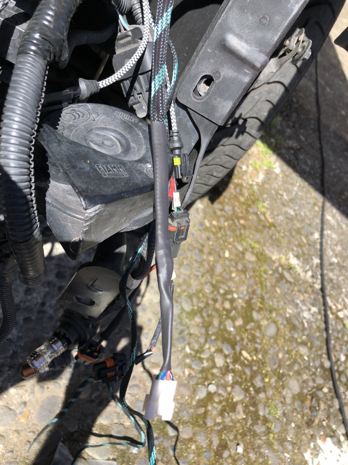

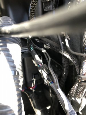

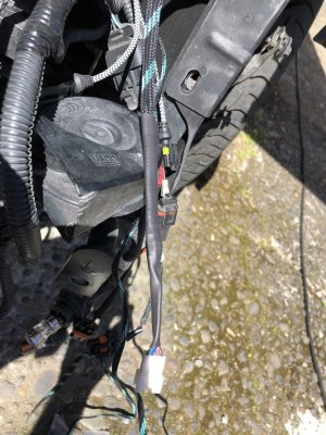

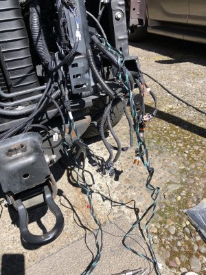

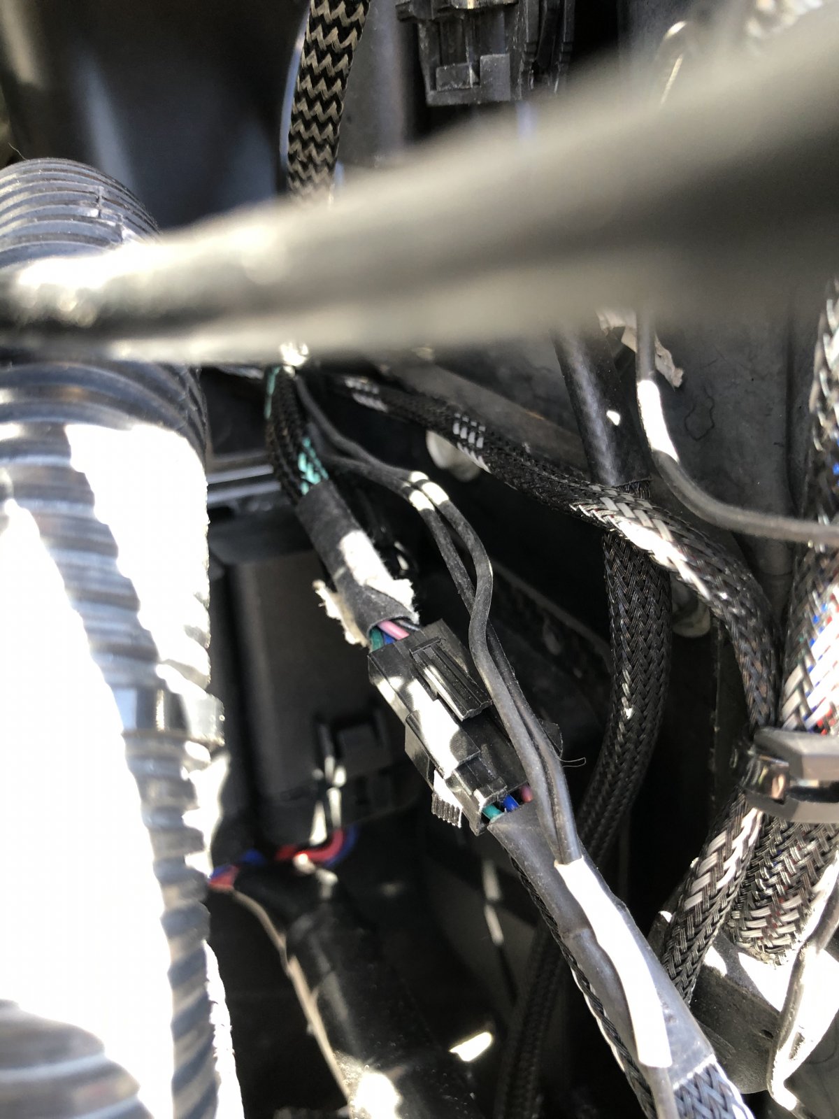

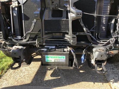

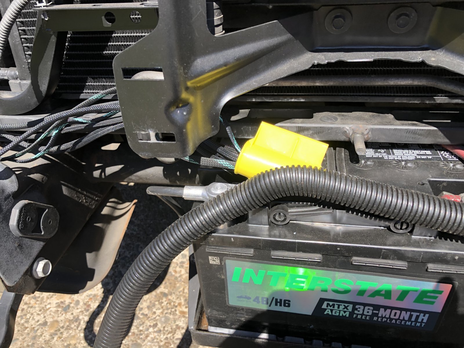

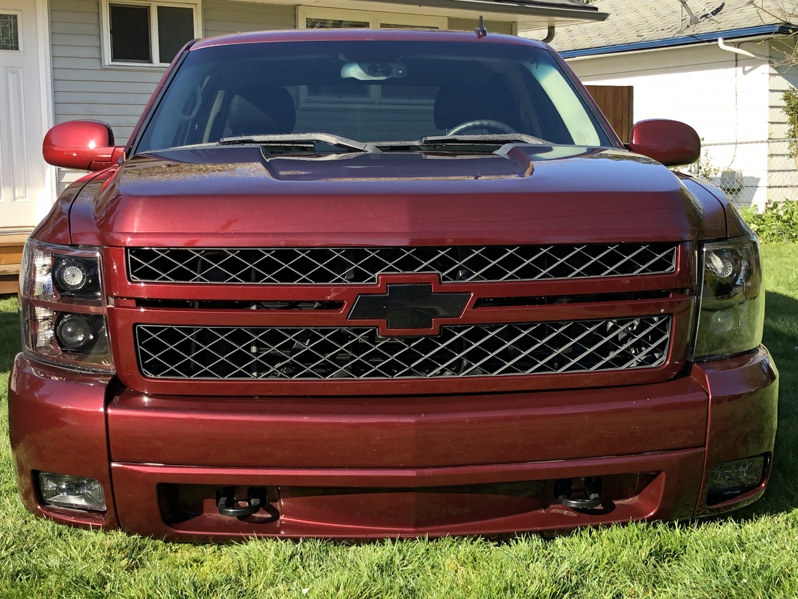

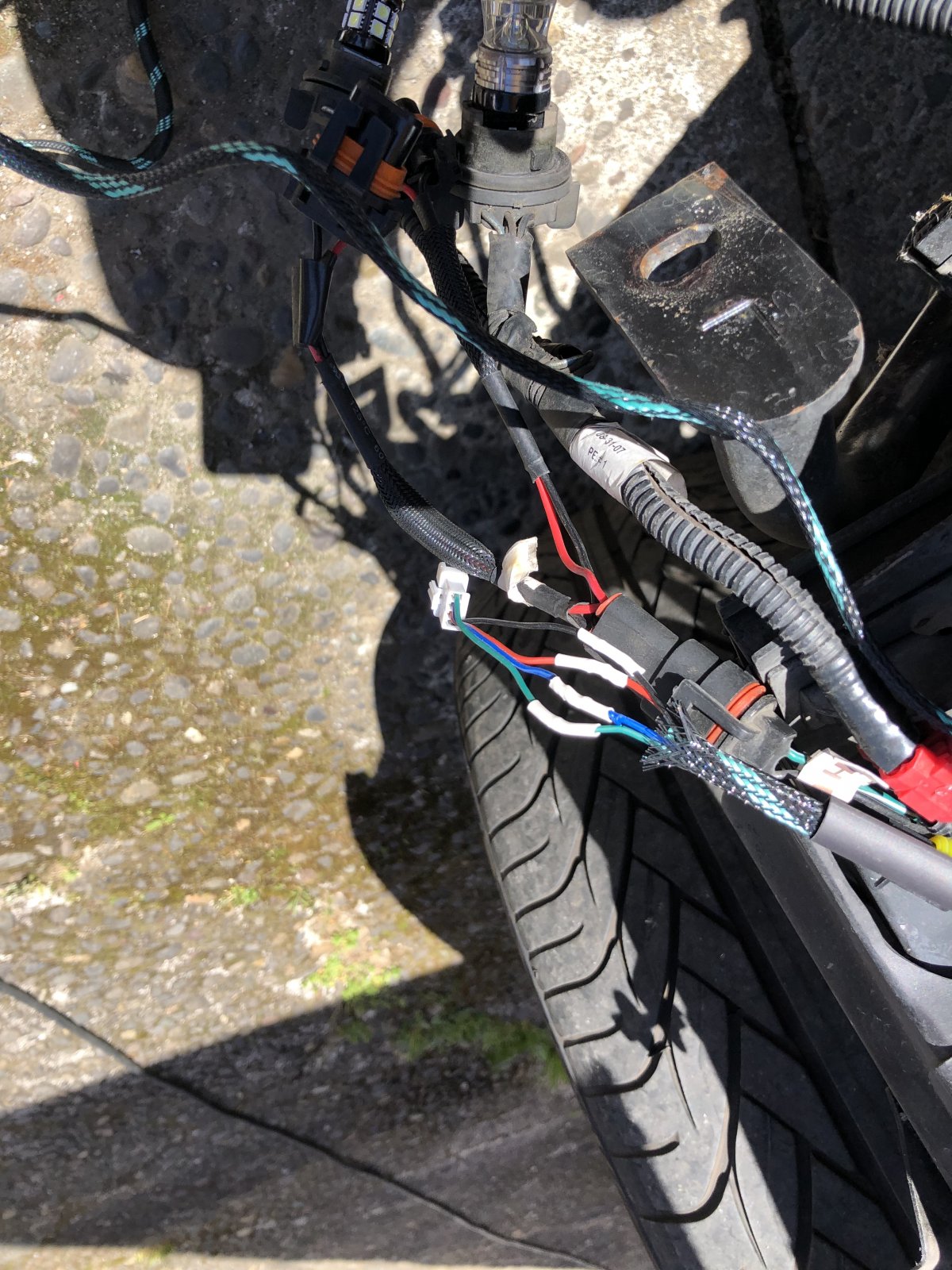

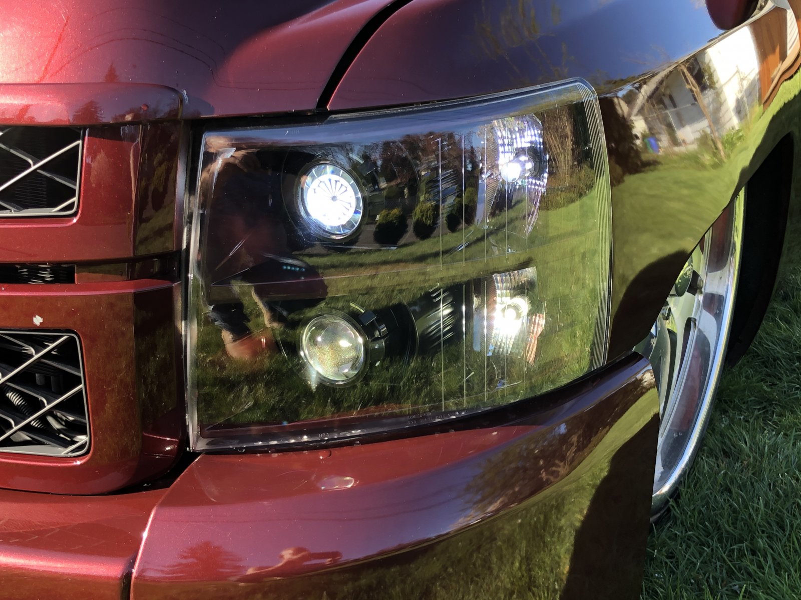

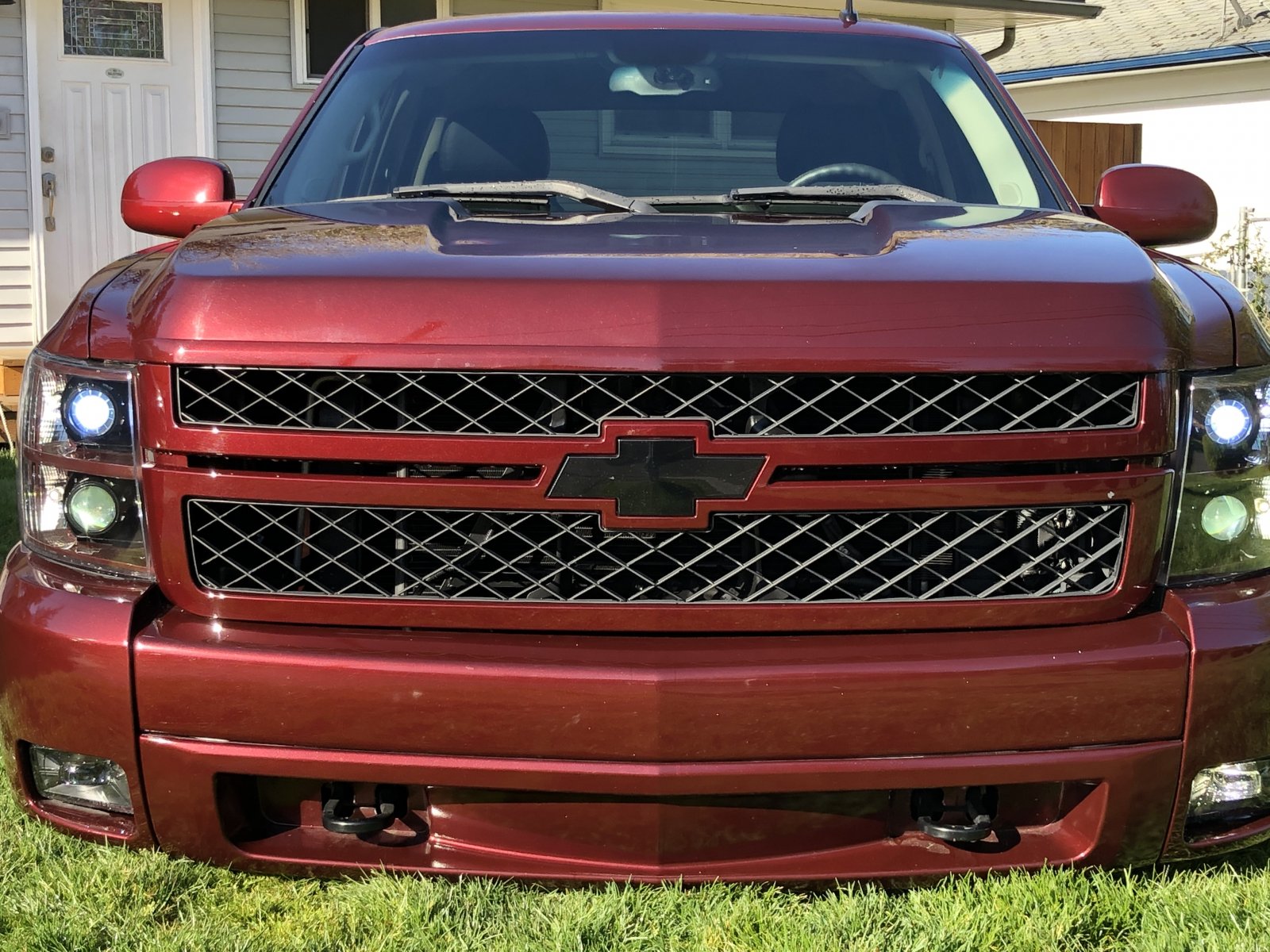

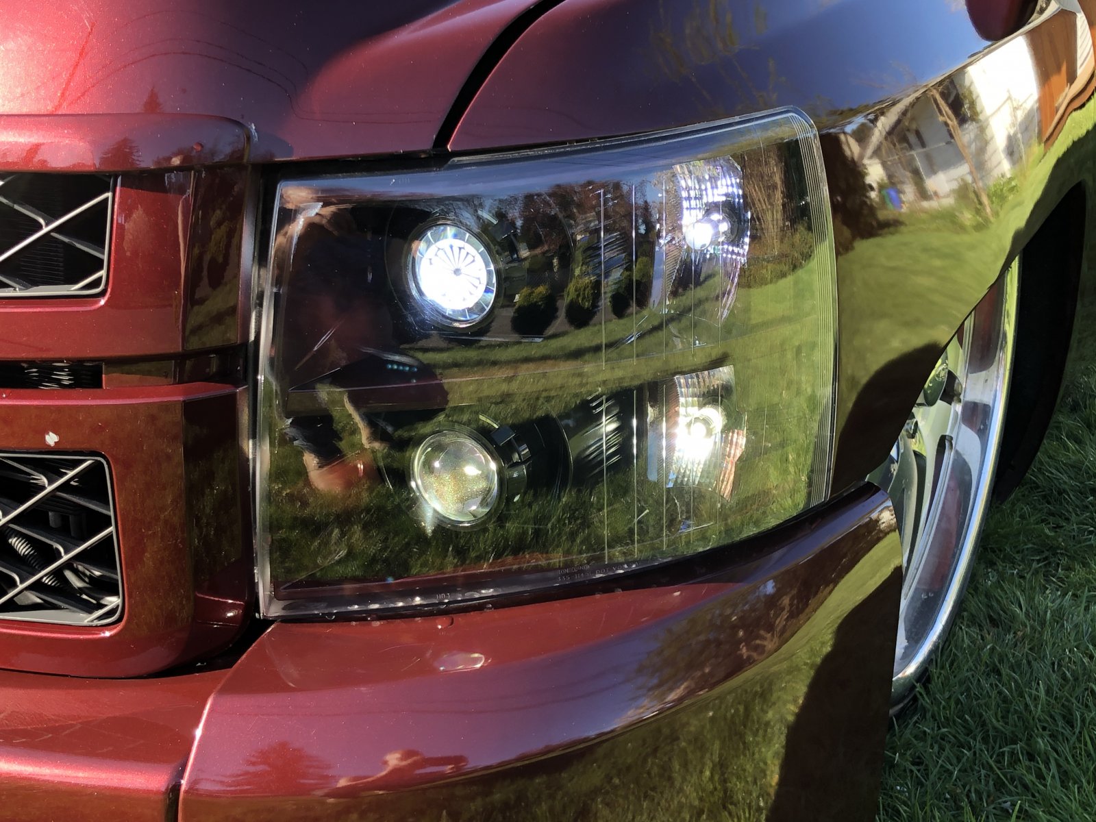

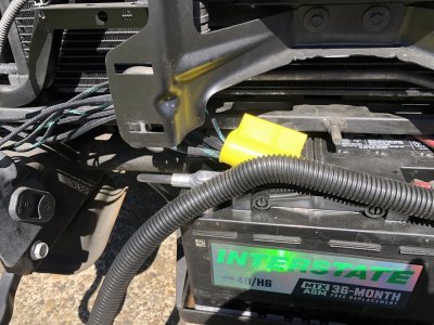

Finished up today. I re-did all the wiring, added split loom, lengthened or shortened harnesses as necessary so they look like they’re made to fit, which they are. I removed all 4 load resistors too since the BCM flash eliminated hyperflash. I replaced the positive battery post. Replaced all the ****** zip ties with the low profile ones. Some pics here just because I spent all day on this tedious shit.
9F045822-D637-46A9-941F-E63FCC37C7FB.jpeg AA9F37FB-243A-4731-83A9-073F1173C930.jpeg D71AF05C-47A9-47EA-94DA-280885FCDC97.jpeg B7110B95-1E21-4423-89DF-5ABE3DBCCAFE.jpeg 80218194-E40E-487E-A692-A934D3466BB4.jpeg
52,956

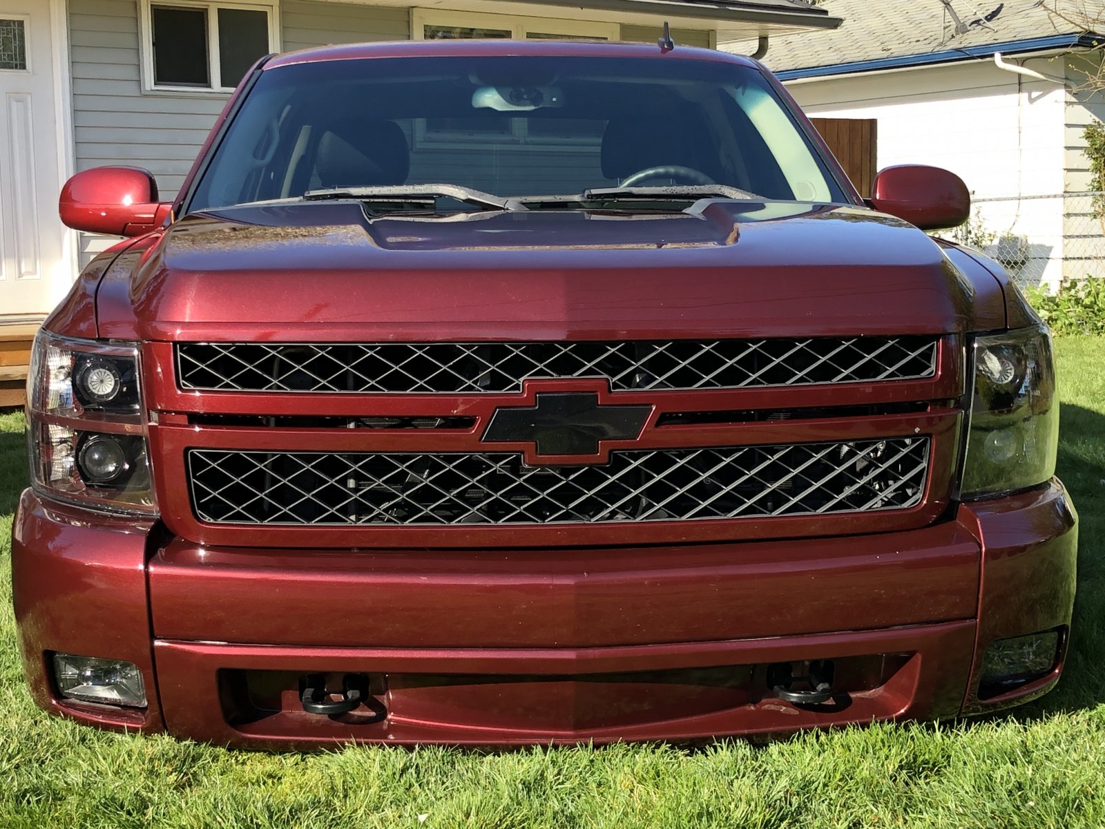

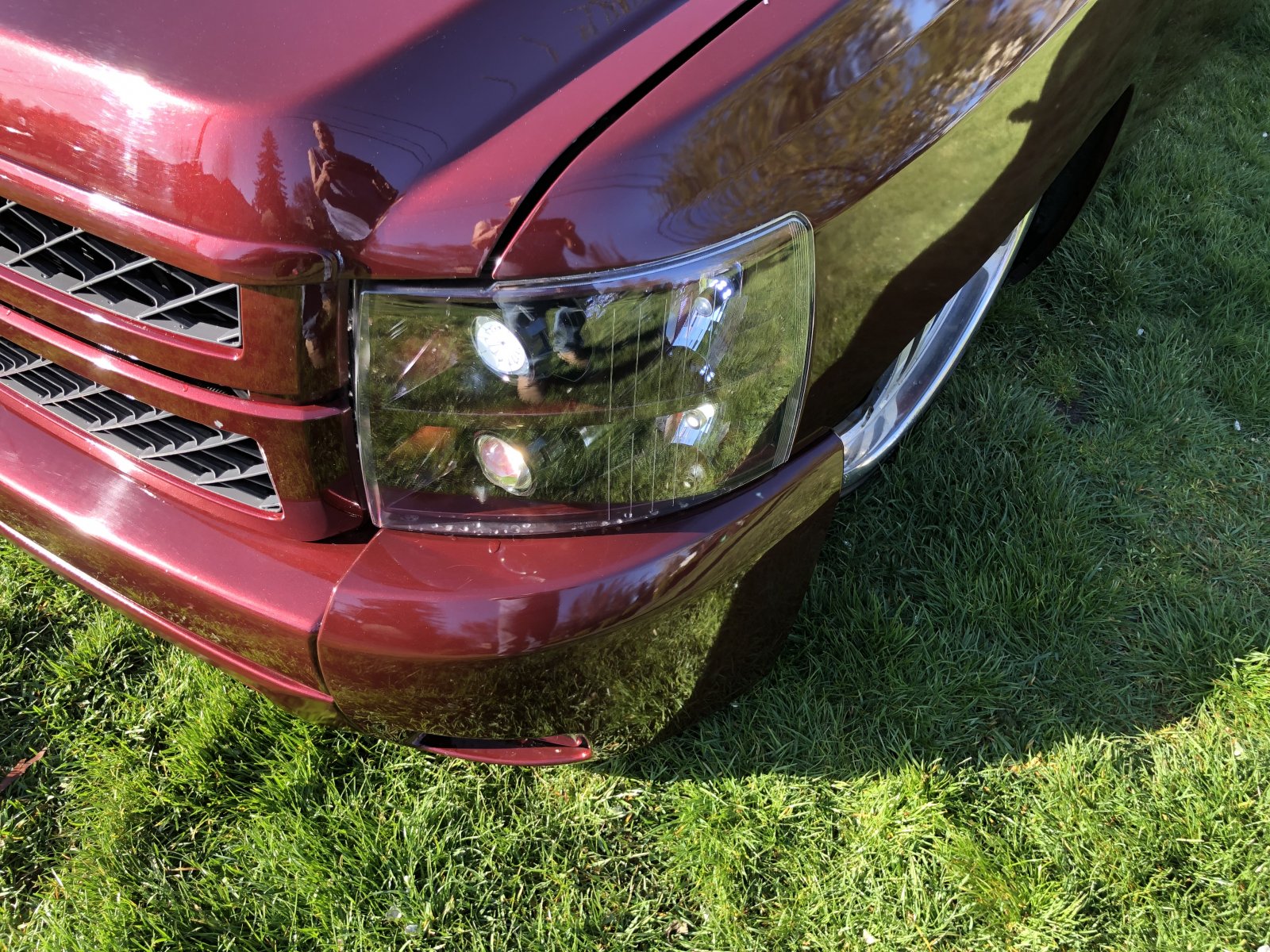

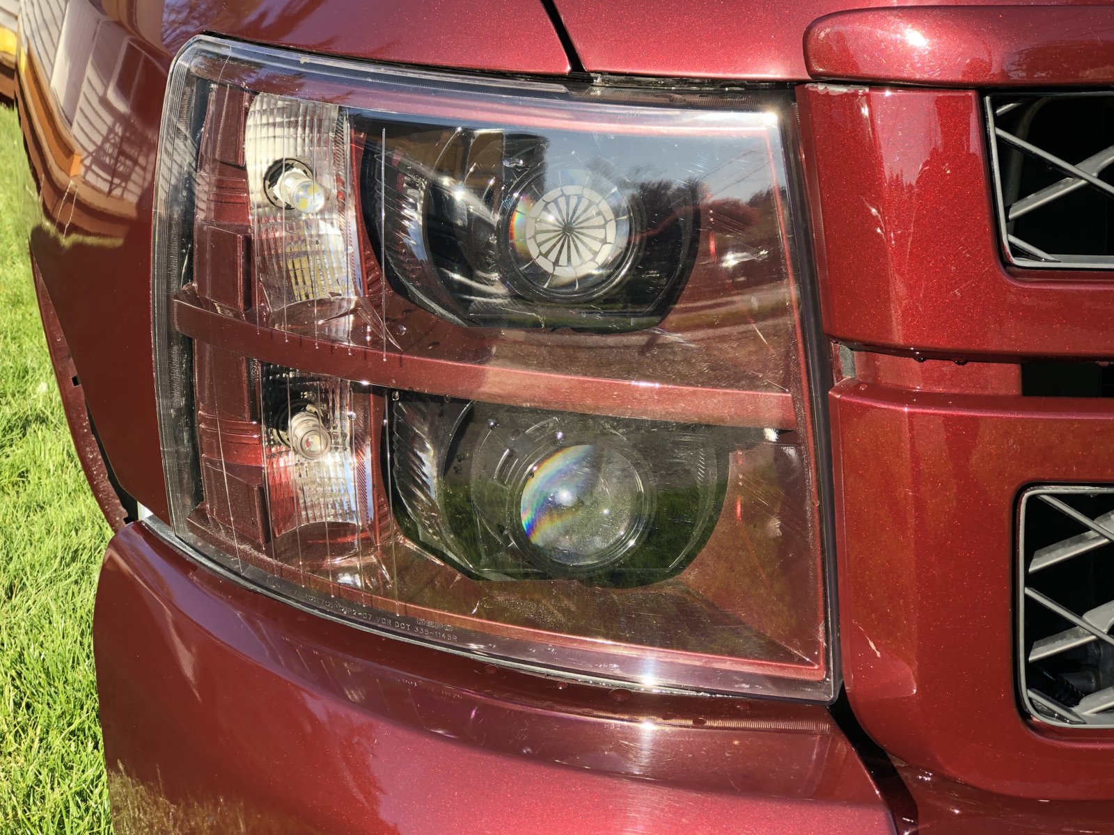

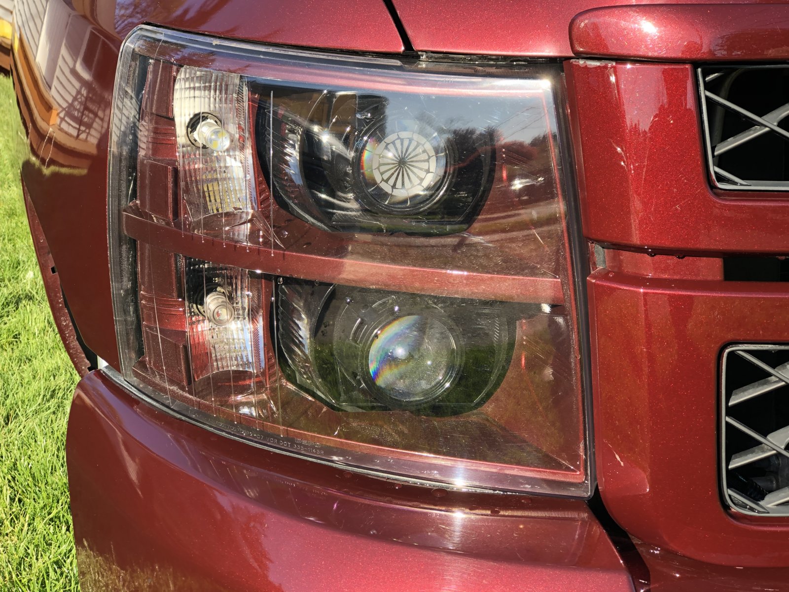

And the finished product. I will change the bulbs out on the new projectors to match the originals. I also might have to bake one open again and clean some dust out that got in as I was removing some of the epoxy around the projector nuts so I could install the holders, using my Dremel. I plugged the small
bulb hole but didn’t even notice the bigger hole around the back of the projector because I didn’t put the big rubber grommet in. FML, some dust entered. I’ll see if it bothers me or if it will settle somewhere out of sight. I think they came out good. I’ll get some night time pics too.
bulb hole but didn’t even notice the bigger hole around the back of the projector because I didn’t put the big rubber grommet in. FML, some dust entered. I’ll see if it bothers me or if it will settle somewhere out of sight. I think they came out good. I’ll get some night time pics too. View attachment 276544View attachment 276545View attachment 276546View attachment 276547View attachment 276548
Shit ton of work. Great job......but I can see that dust from Jersey lol! J/k!!
52,956
I know, I’ll have to open it up again I’m sure. Oh well. I have it down pat now. The first lens I installed this morning was the wrong one, it was off the other set of lights that I was using as a mock up. I thought something seemed wrong, it was scratched kinda bad and then I saw the logo wasn’t Depo. I looked in the other room and both Depo lenses were still in there. F**k. So I opened it up again, cleaned everything again and baked the Depo lens on. Later, on the same light, is when I made the dust mistake. Right after I made sure it was perfectly clean for the second time. Then to top it off, one of the teeny tiny screws that hold the bulb mounting clip to the projector fell. Inside the projector. I couldn’t see it, I could hear it when I shook the light though. For awhile. Then it quit moving. F**k again. I was about to give up on finding it but decided to take a cue from you Tony- I whacked the shit out of the headlight. It started moving, and then I got it to bounce down onto the lens where I fished it out of one of the turn signal bulb holes with a telescoping magnet. It was a rough morning. I wanted to give up. :mad:
