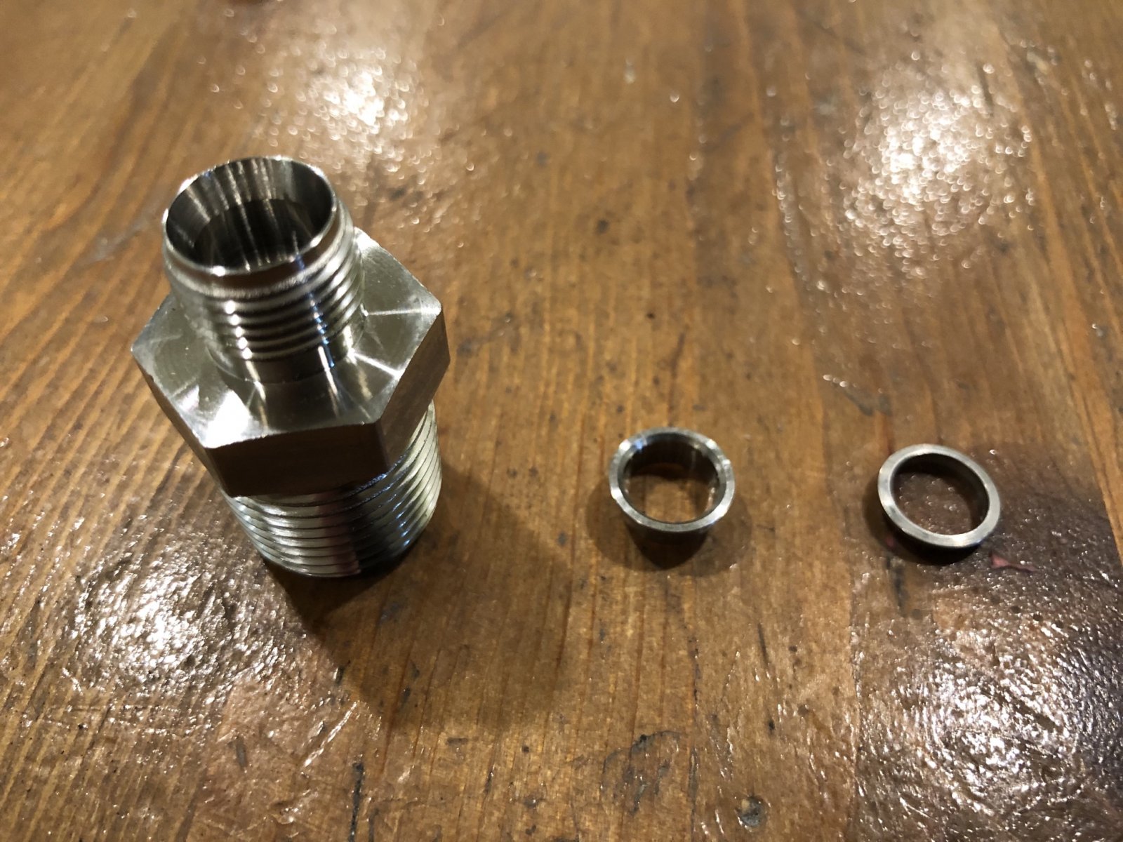

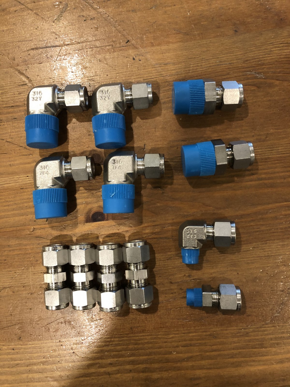

I got the rest of the stainless steel Swagelok fittings today. This shit is quality. These fittings definitely won’t leak. I like the double ferrule design. I know their patents have run out on these but when you want a guaranteed part I always like to go with the original people who invented it.

Swaglock is definitely good stuff. Used their stuff a lot on the pneumatics on the sanitary wash down dairy fillers we made at my last job.

Very nice, quality fittings sir. I’d be disappointed if you went with anything lesser. [emoji106][emoji16]

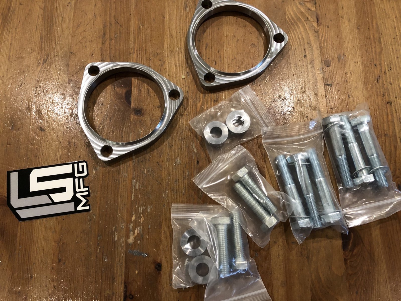

I got the 1/4” spacers today. They’re the exact size of the hub flange so they’re meant to go behind the rotor I believe. I put one on, then added 1/8” of shims just to simulate grinding 1/8” off the outside of the ball joint cup which is all I’m comfortable with. It cleared with the suspension hanging with almost 1/8” to spare but as soon as I put a jack under the hub and moved it into into mid travel it hit the rotor. So no bueno. They have it figured out, 1/2” and like they said, possibly “massage” the ball joint cup. So I ordered the Little Shop kit. I’ll get that installed, install the brakes, then see where I’m at. The control arms have to have the bag cups and shock tabs welded while on the truck so I’m trying to see if my nephew will do that for me. I don’t feel comfortable welding on those arms with my lack of skills.

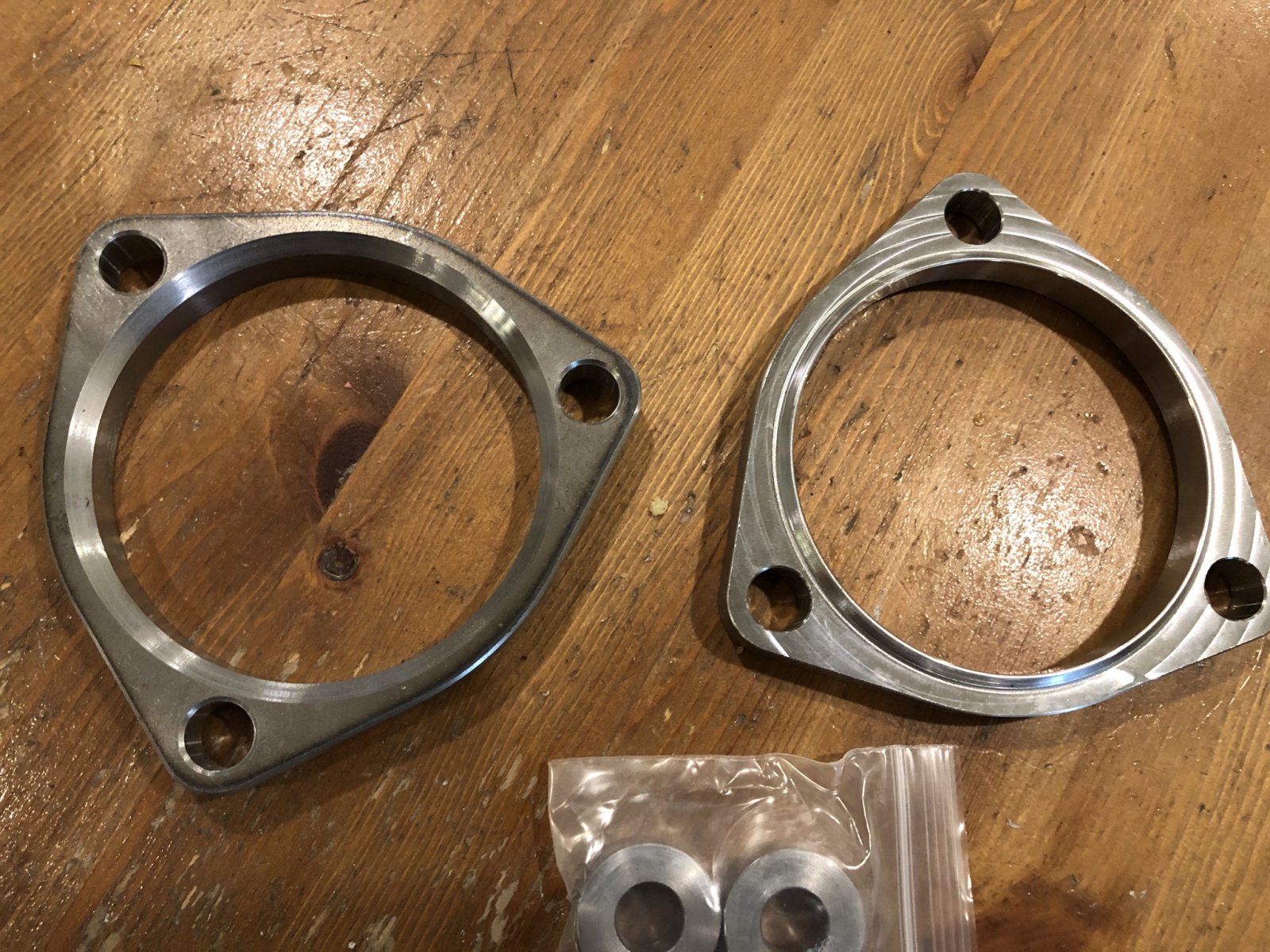

Are those wheel hub spacers?
Yes. To space the hubs 1/2” away from the ball joint cups on the lower control arm so the 16” rotors don’t hit. It’s because the ball joints are flipped on the Ekstensive control arms. Now I might have to get the backspace on the wheels changed, I’ll see when I get it back together.

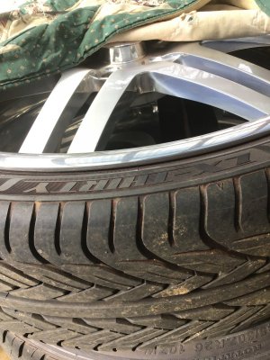

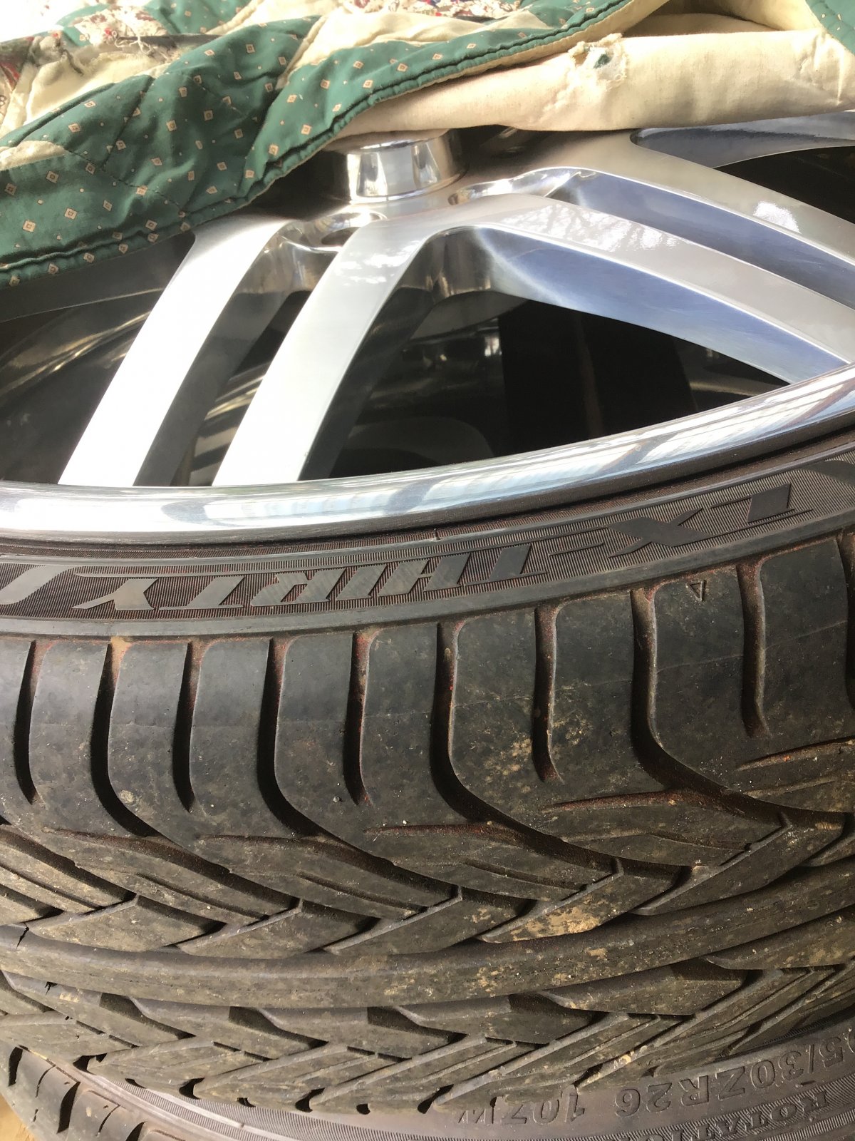

I put a wheel back on and checked clearance with it tucked and not tucked. It doesn’t look too bad. I think it will be about the same as when I bought the truck and the fenders weren’t rolled and it had 285/30-26 tires. Those bulged away from the rims a bit. I rolled the fenders and put 255/30-26’s on which actually are a stretch on the 9” wide rims so they’re rounded at the outside edges. I might be all right. I know I’ll be able to drive it, just depends on how much I have to mess around with the switches when making sharp turns.

Am I seeing things correctly? It looks like they are even piloted on the back side. They do look like they are pretty good quality.
