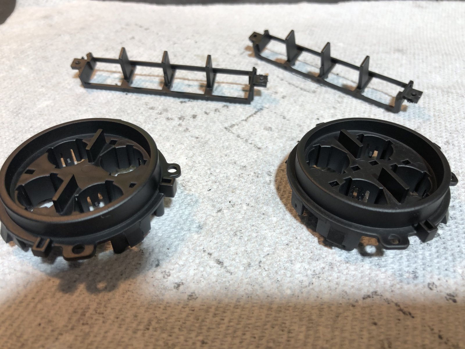

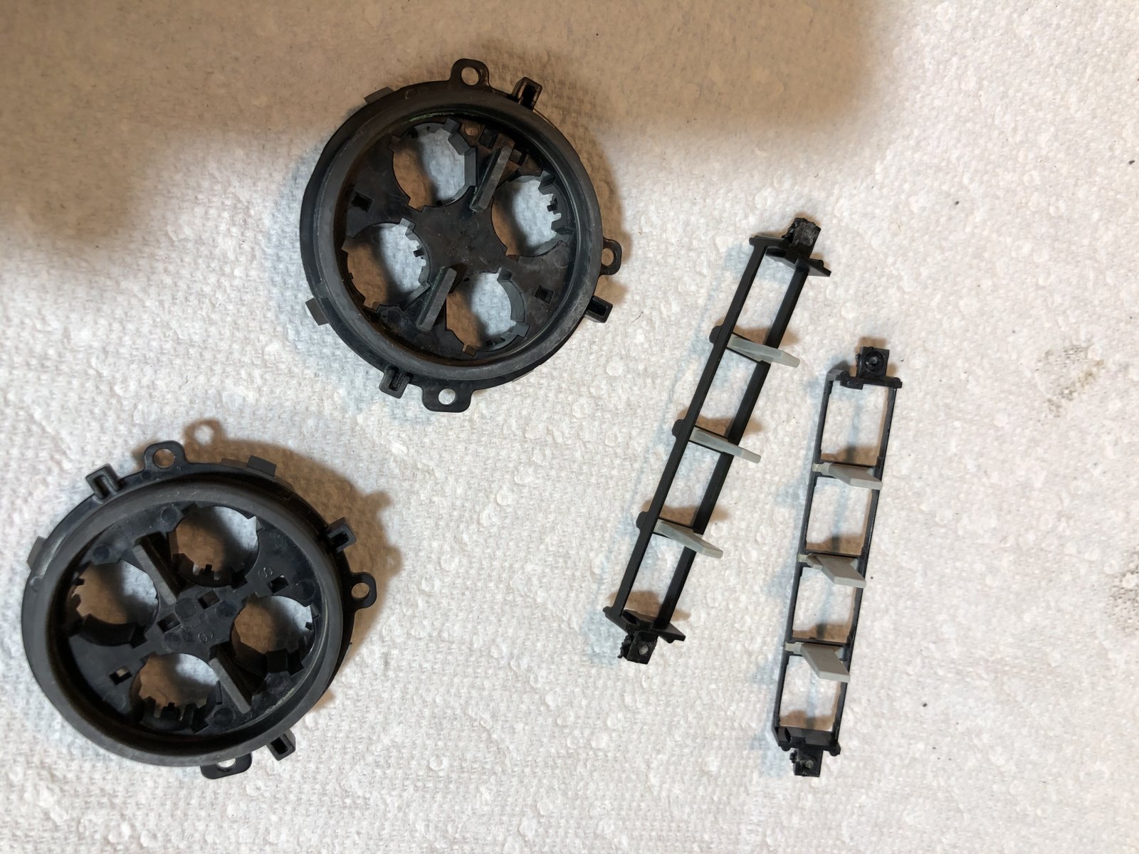

The HVAC parts are finally stripped of chrome after about 3 weeks in the sulfuric acid. I painted them and will build the spare escutcheon to swap out. I don’t want the paint to chip on the other one and have chrome showing in the future. It’s the little things as they say.

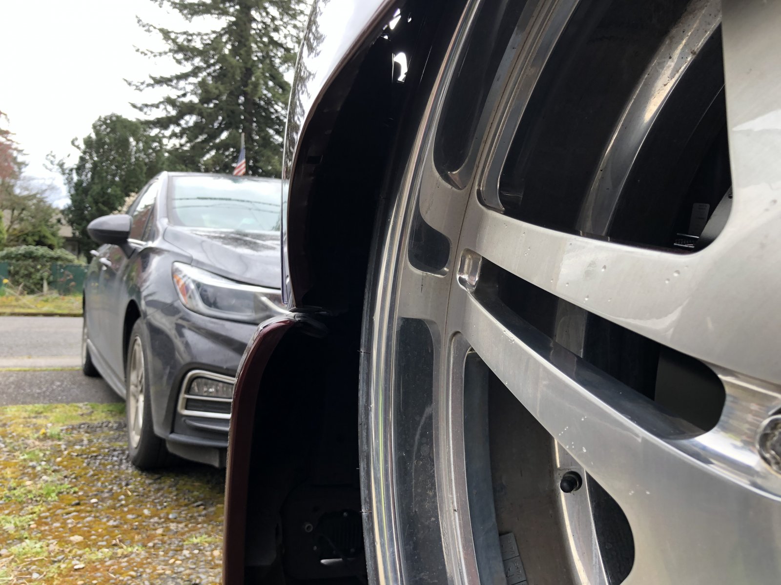

I just had a great idea- have a new set of front wheels made. It’s $3k and I could sell the others for $1500- $2000 in a heartbeat which would put me out the same or less than if I paid to have these fixed. And I wouldn’t have to put my truck on jack stands for a month while I sent the wheels to Cali. I thought of this right after I realized the Wilwood rotors are 1/2” thick at the hubs and my OEM are 1/4” so that pushes my wheels out a total of 3/4” which I’m afraid is just too much.

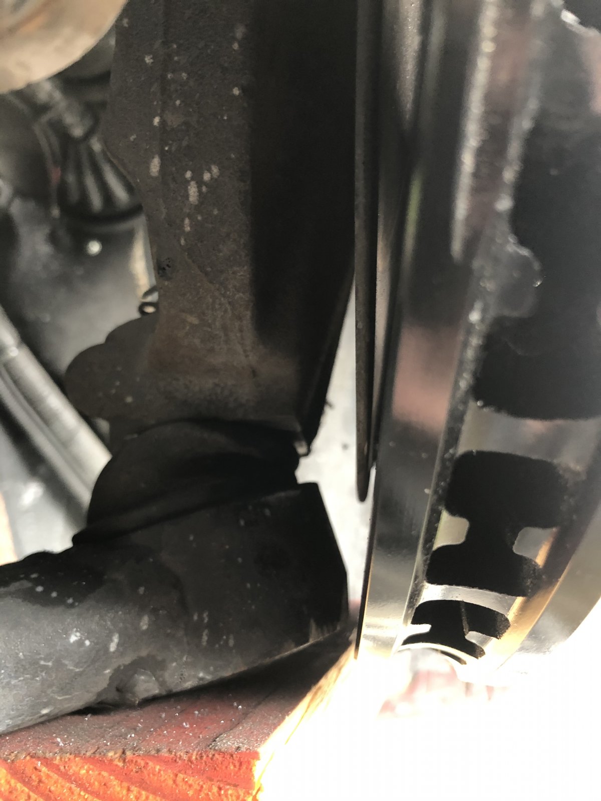

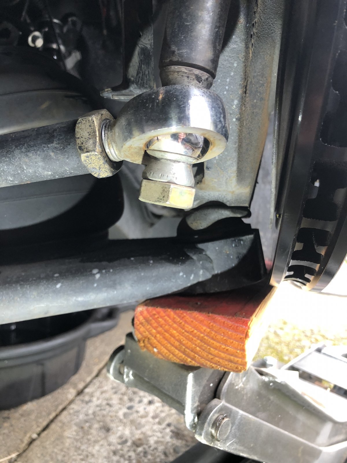

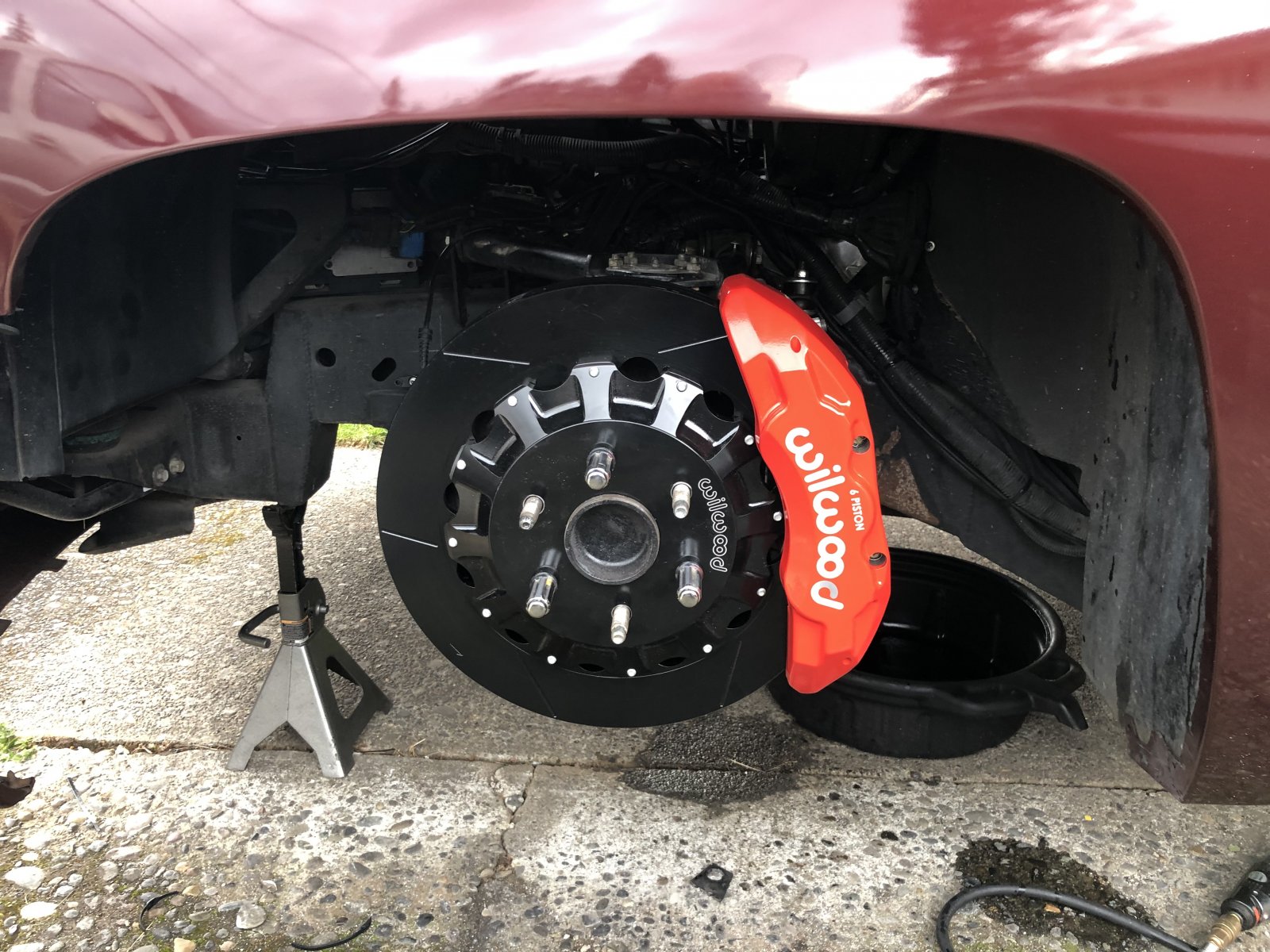

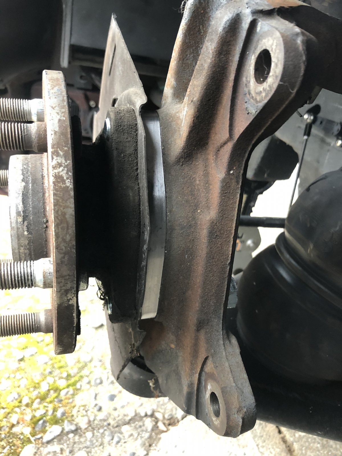

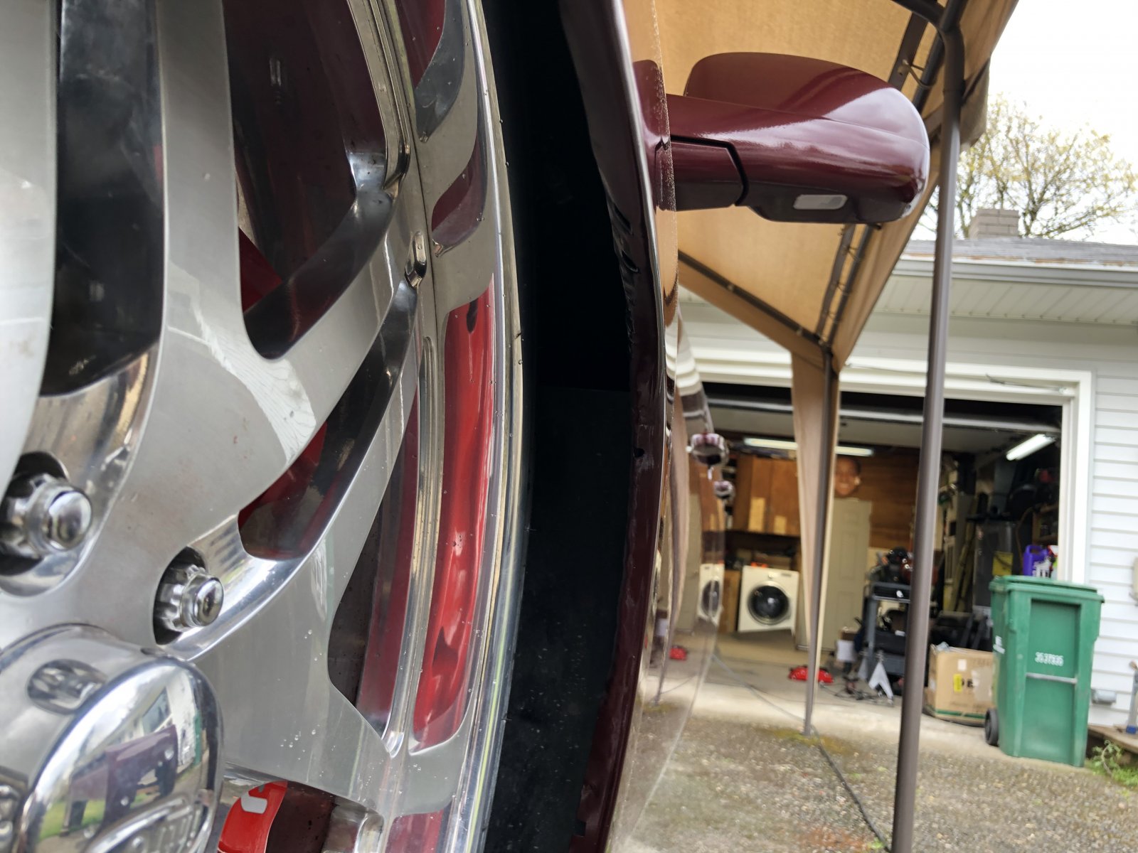

I spent pretty much all day on the DS front Wilwood. The spacer was super easy / remove 3 bolts, insert spacer , install 3 longer bolts and torque to 138 ft lbs. Then I temped a rotor on and moved it through full suspension range. It came within about 1/16” at its closest so I ground a bit off the lower part of the ballpoint cup. It’s a bit over 3/16” at its closest now. It’s kind of hard to see, it’s right above the wood that’s on top of the jack.

I had tried to install an adapter on the truck side hard line the other day but couldn’t get it to start threading. The old hose was hard to unscrew the entire way to the end when I had removed it but I could get it to start threading, but not the adapters. I took them back to the place I bought them but they threaded in a fitting there just fine and the guy said they probably over tightened it which caused the flare on the line to get bigger that the inside of the threads. Anyway after 2 hours of trying I finally got it on, and finished up shimming the caliper. I installed a wheel and moved it through the entire suspension range and I think I might be ok, there’s still pretty good clearance for turning. A road test will tell.
View attachment 243851 View attachment 243852 View attachment 243853
That spacing is real close! Glad you were able to work it out for the most part

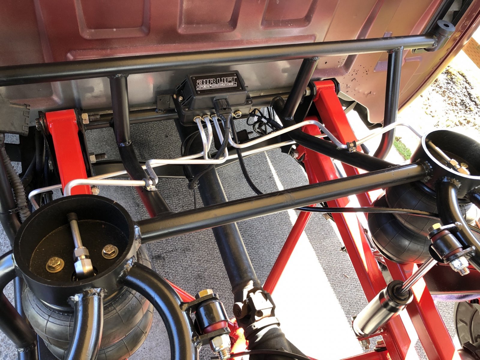

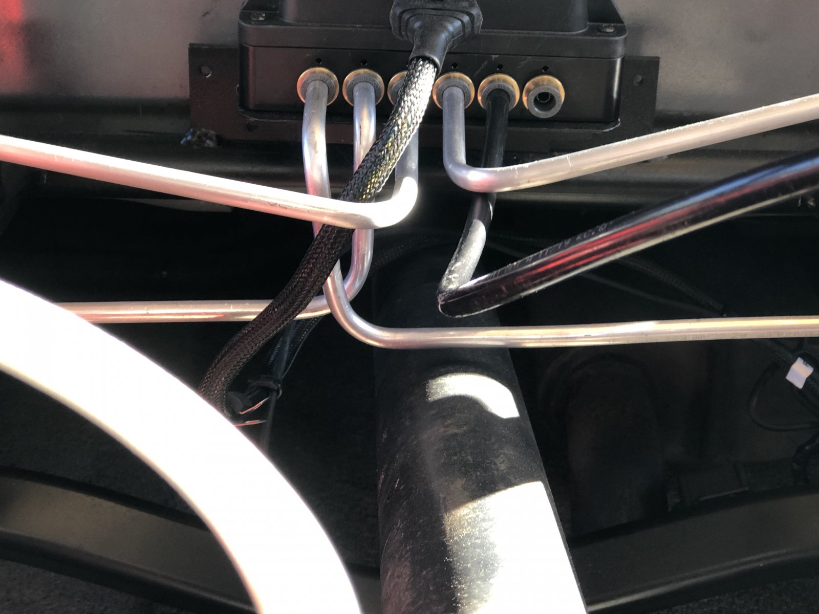

I got it on it’s wheels again. I decided to not use the 90 degree elbows at the manifold, they just make things too complicated so I made sure to sand the edges of the aluminum where it enters the manifold. I’m pretty sure it was the sharp edge that’s left when the tubing cutter makes its final pass that damaged the o-ring in the fitting. And don’t say anything about the plastic line that’s still there lmao. I made a (couple) mistakes bending the hard lines again so I had to order another stick. I almost made one line drop too low out of the manifold where it crosses over the driveshaft. Aired out leaves me with 1/4” to spare. It was a ***** getting the lines through the frame and links after I bent them. If you’ve ever run new brake lines you know what I mean. Twist and turn and scratch your head. Anyway I just have one left, from the filter to the manifold. It’s an easy one.

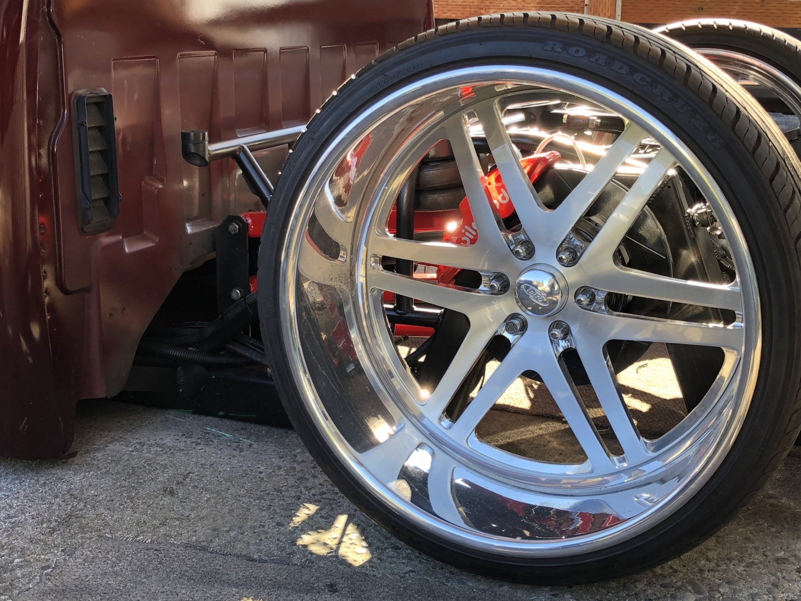

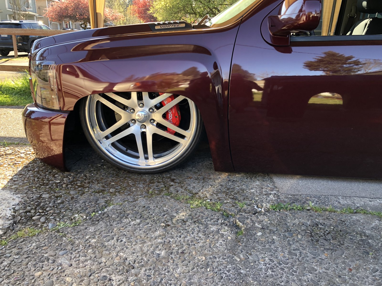

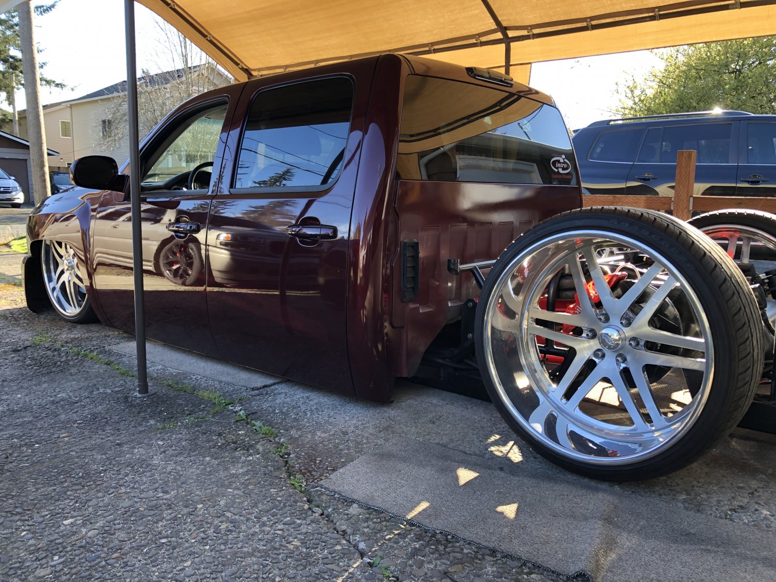

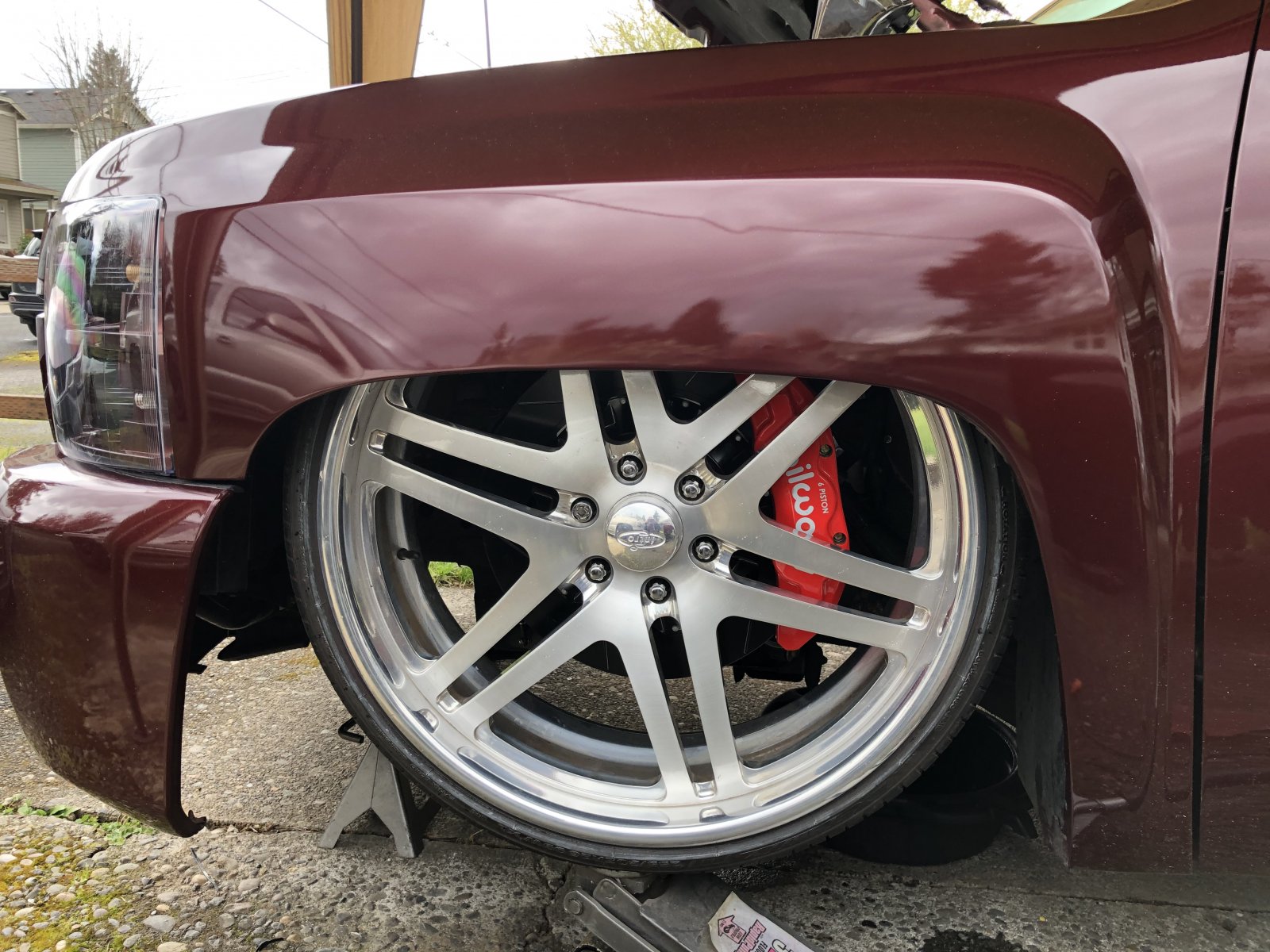

And no leaks with the Swagelok fittings, but those aren’t easy to tighten in a tight space. Anyway here it is all aired out with Wilwoods. I’ll drive it up the street tomorrow and I’m crossing my fingers the steering at ride height is acceptable. I really don’t want to have new wheels made.

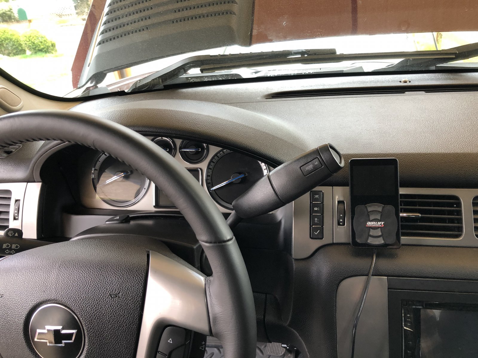

Interior after the cluster bezel and things put back together. I haven’t decided if I’m going to hide the wire for the Airlift control. It’s mounted with a mag holder and I like being able to pull it down and hold it when I’m messing around. I guess I can use the phone ap but for setup and stuff it’s easier this way for now.
View attachment 244031 View attachment 244032 View attachment 244033
Can always hide the cable after you get things setup to where you need first

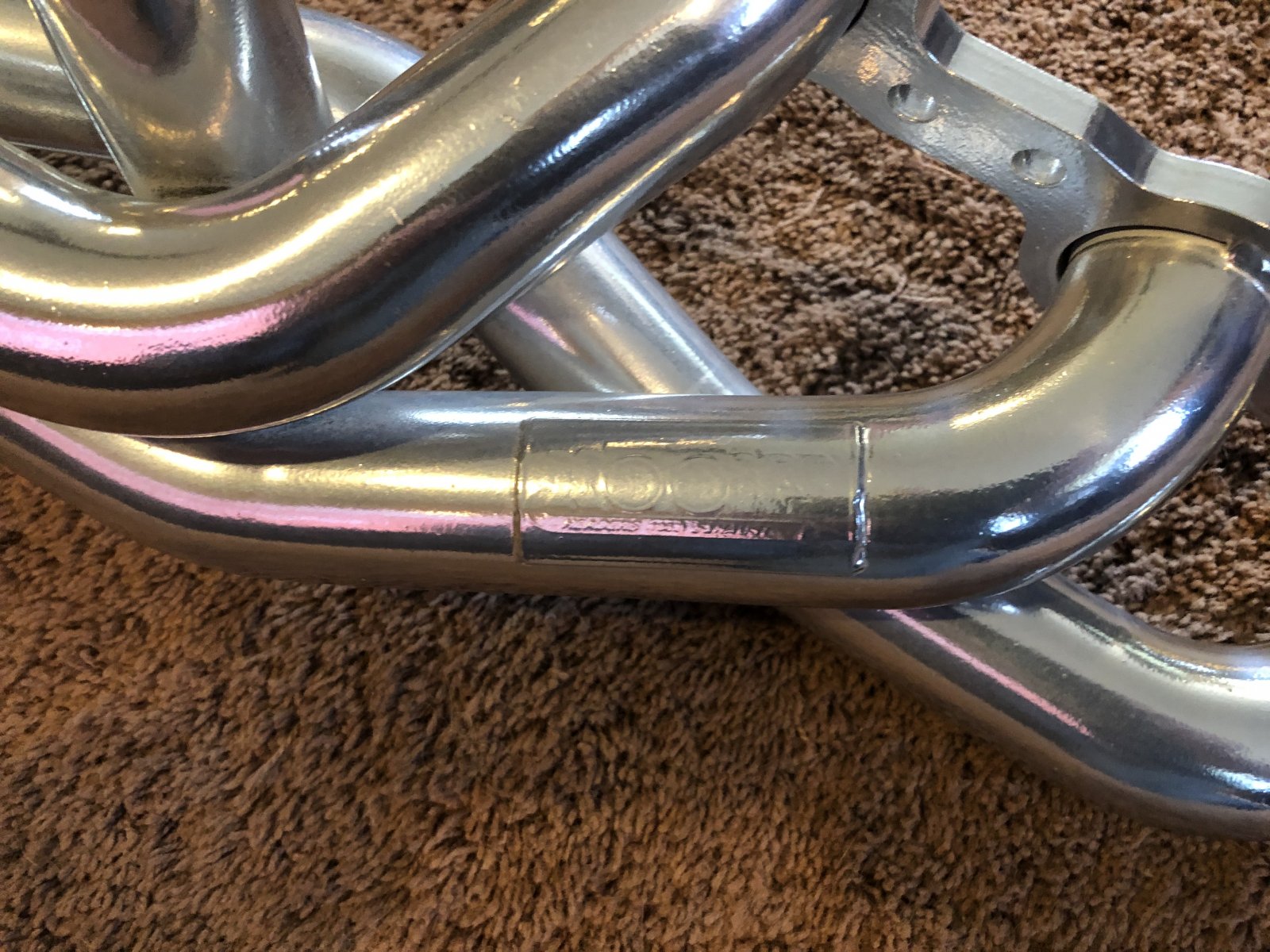

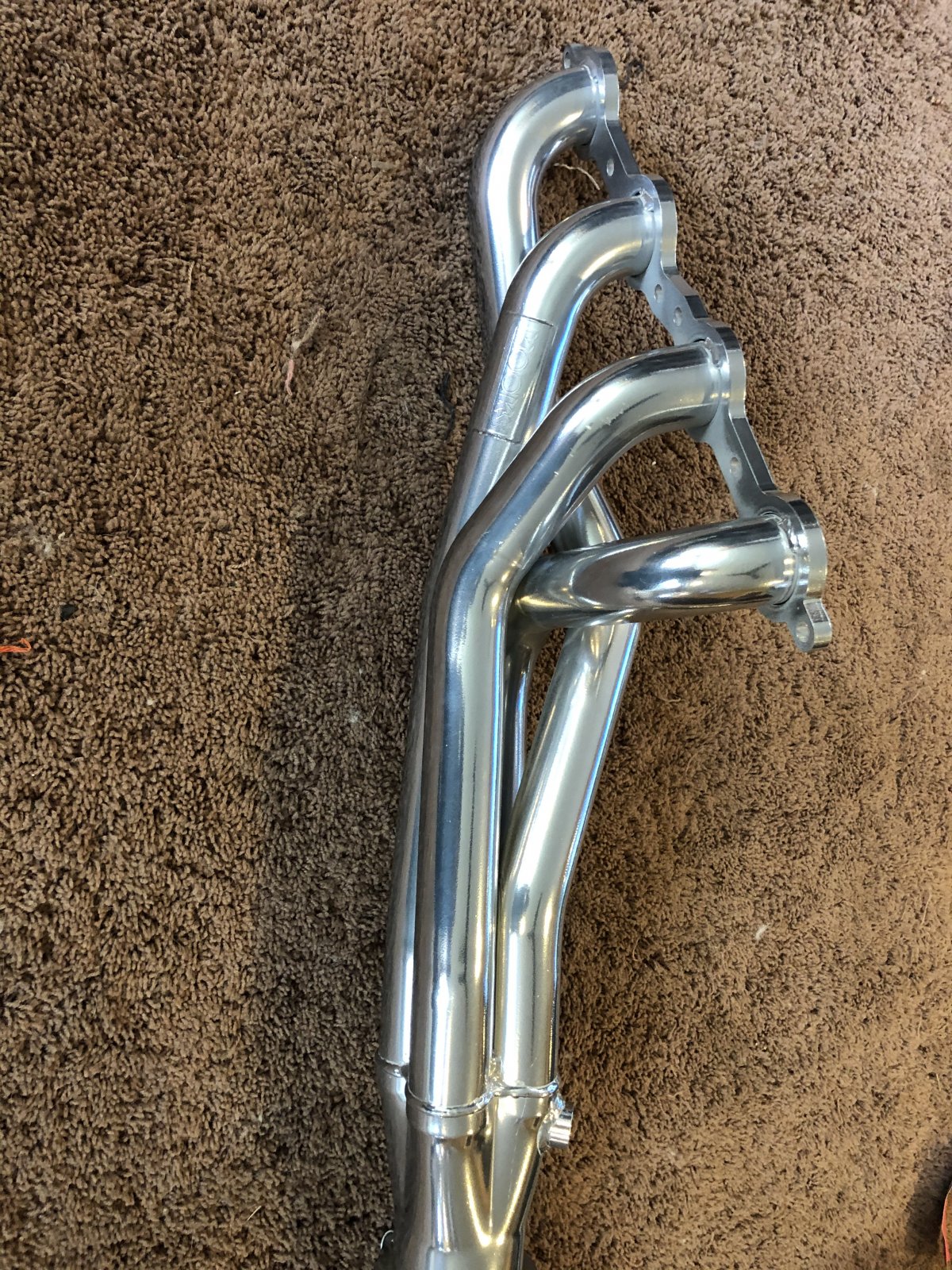

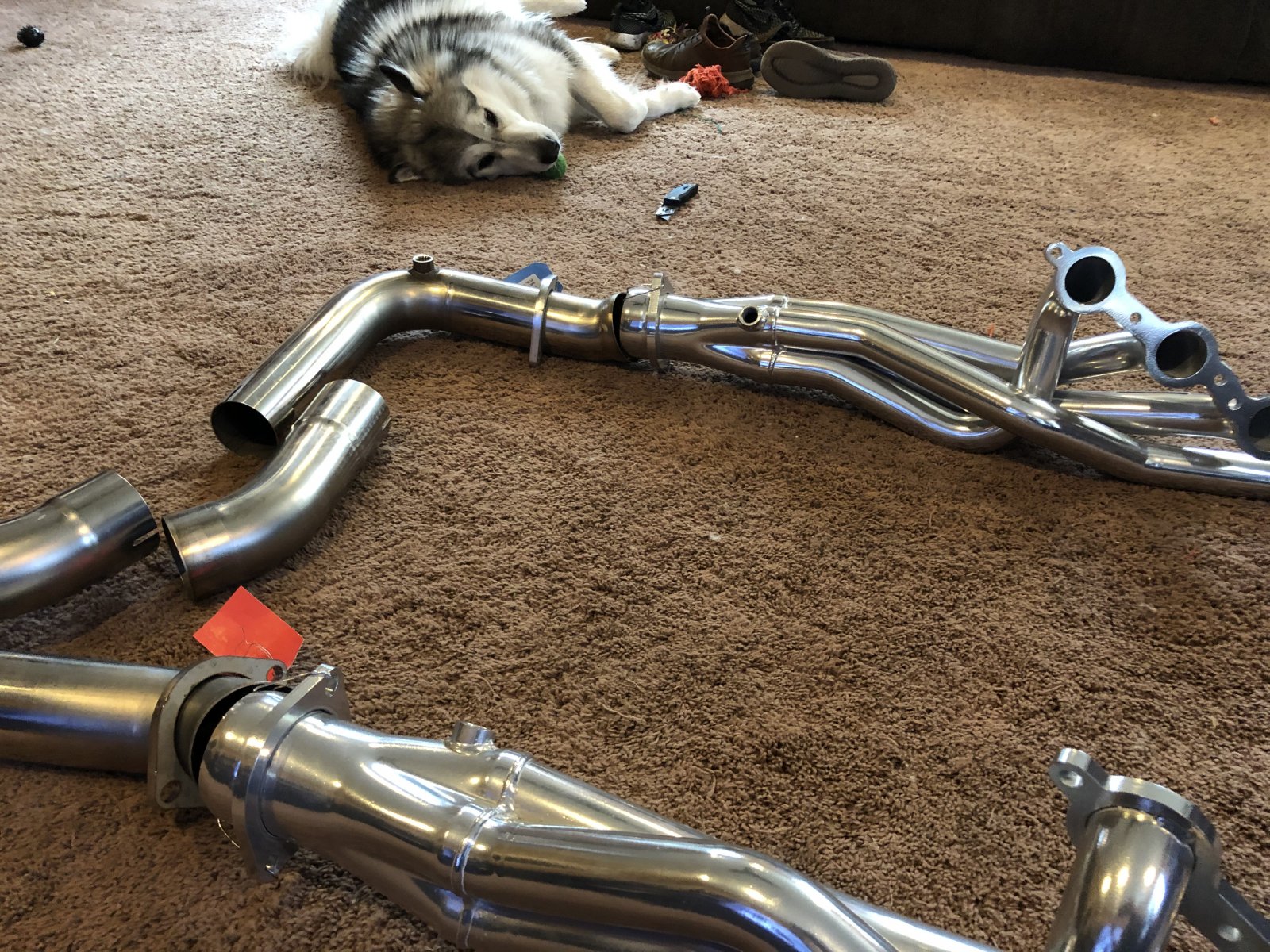

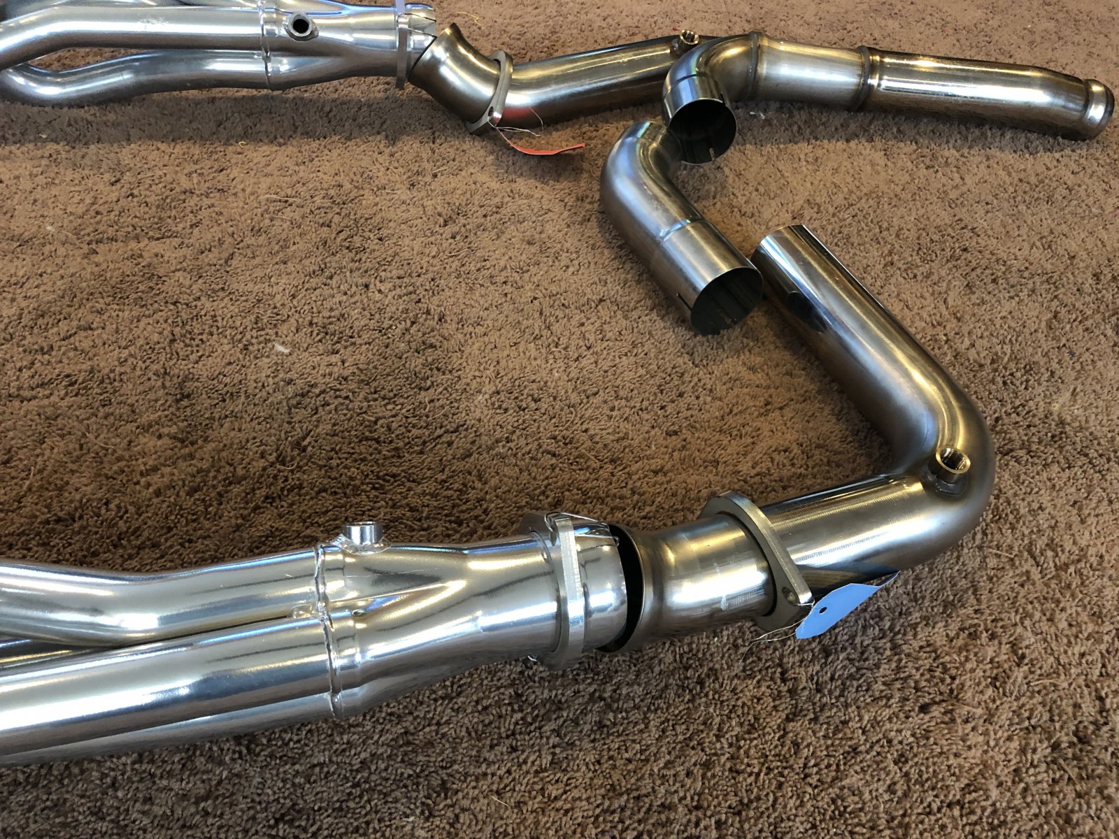

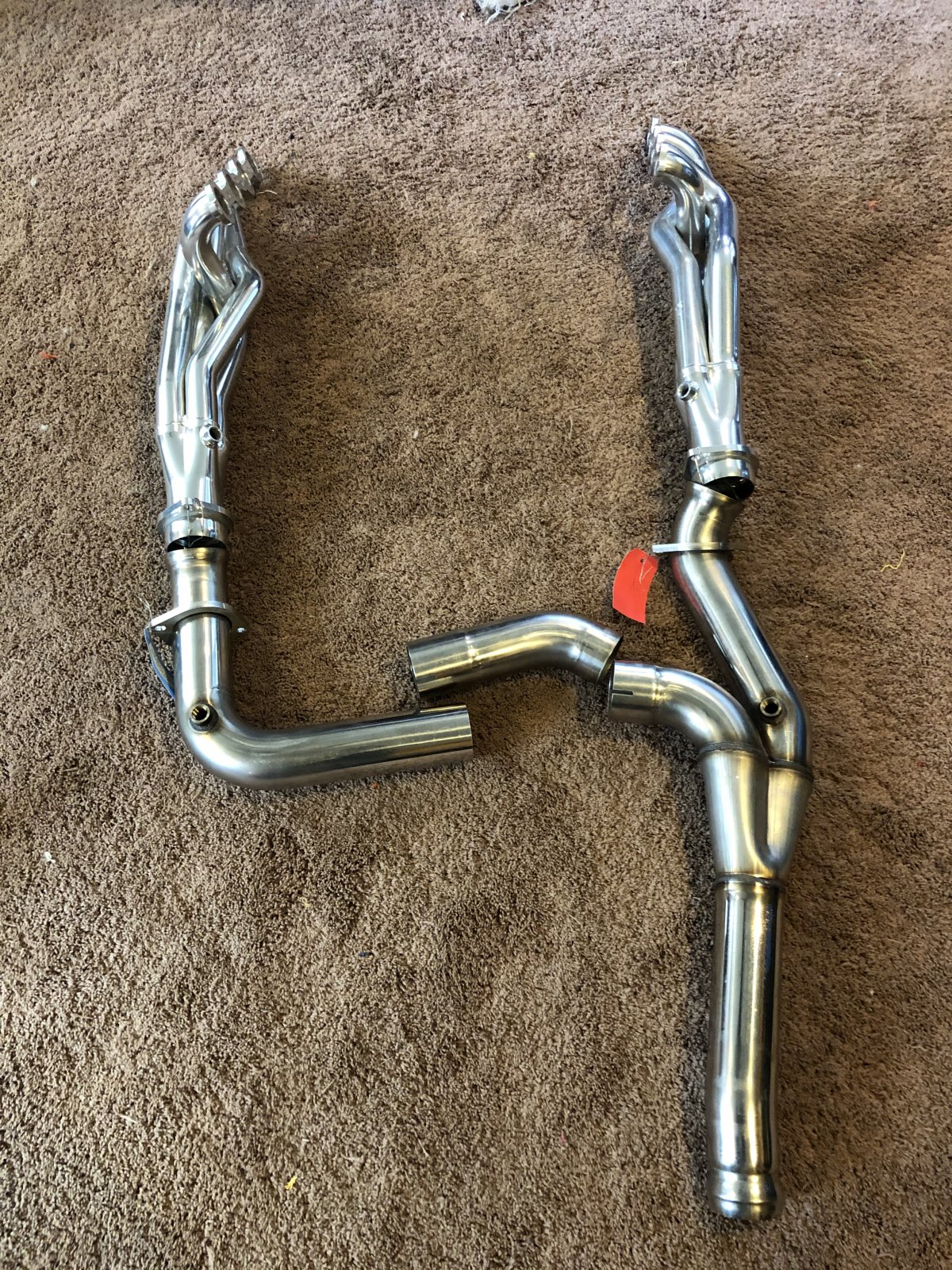

I got the headers today. The P.O. had never even removed the shrink wrap from the powder coater. They were an awesome deal for $1050 shipped. The dog wanted to play ball but finally left me alone long enough to unwrap them.
