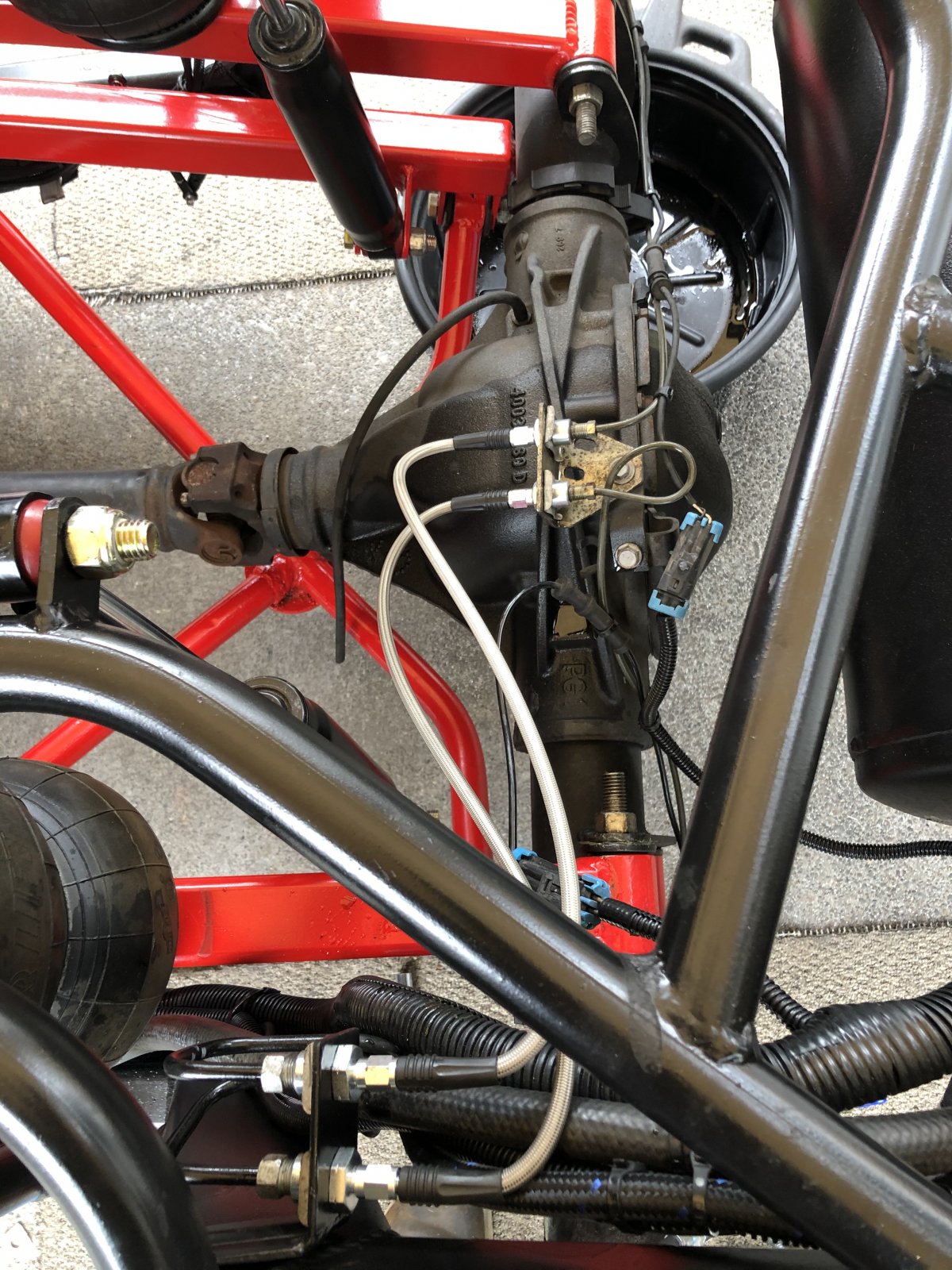

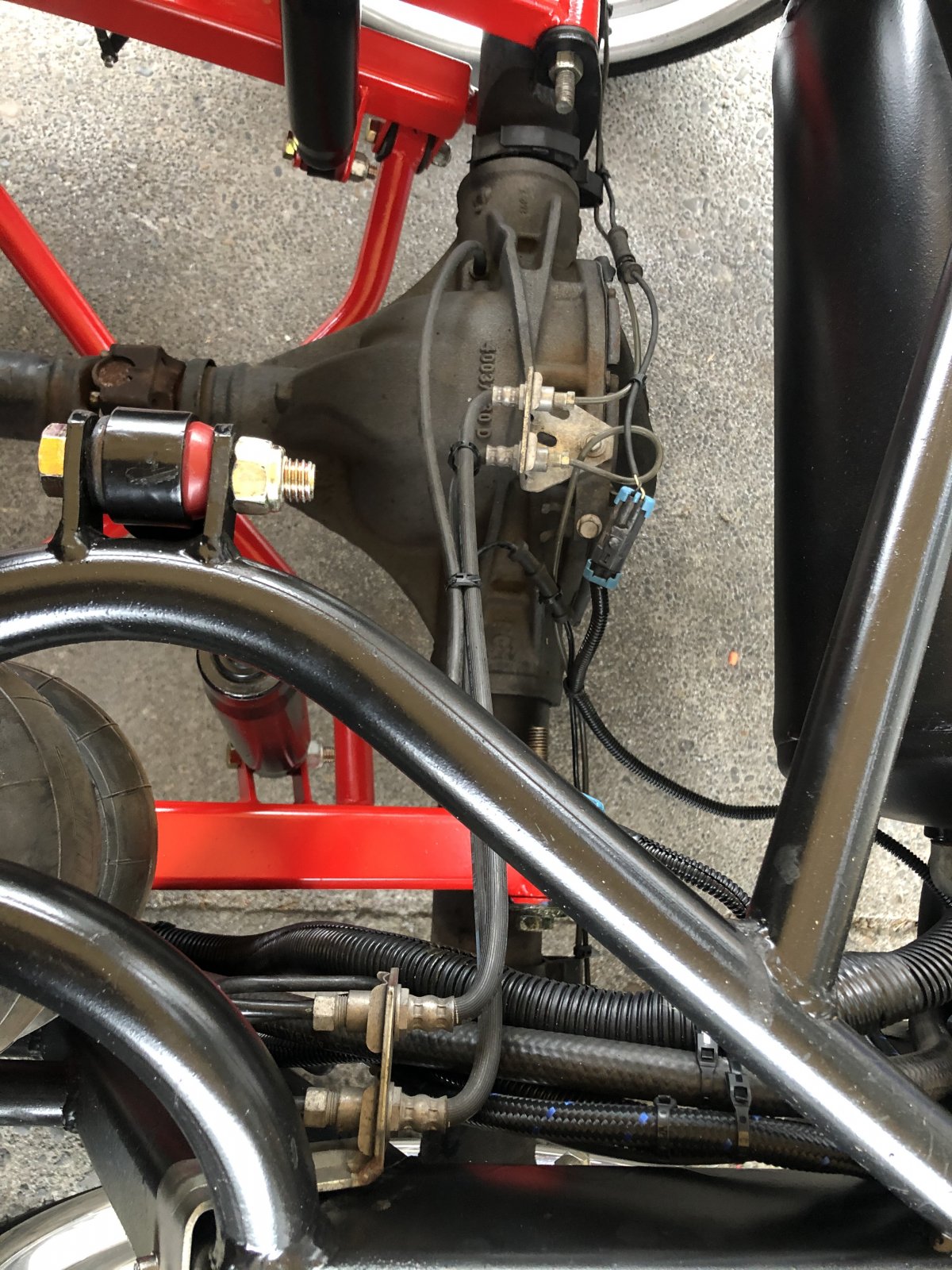

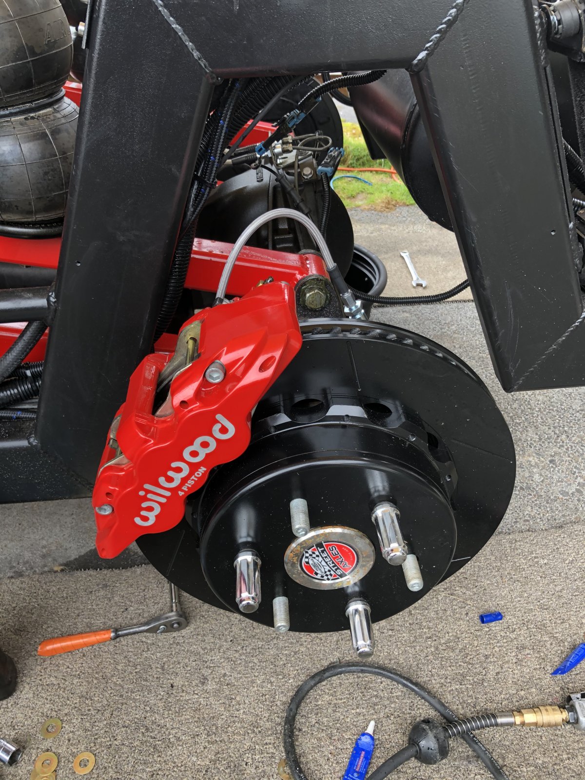

I worked on the rear brakes about 4 hours today but had a bit of a challenge so I only got one side done. I had a feeling I might have trouble due to the nature of the conversion and the Moser axles. At first try the caliper on the DS wouldn’t even go over the rotor, it was too far to the inside. There’s shims to space it to the outside but I needed to go the other way so I had to cut the mounting ears off the inside of the aluminum mounting plate and even that wasn’t enough so I pulled the bolts that held it on and added washers behind it where it mounts to the axle flange. That did it, it went too far to the outside then and I was able to use the shims to center the caliper on the rotor by moving it back inside a bit. I also painted the center hose bracket and installed the new lines I had made earlier today. The rubber ones were stretched tight when the bags were fully aired up (which only happens when I’m jacking the truck up) and now they’re ok. I had them made 3” longer but could have gone a couple more but they’re much better. The suspension is almost never this aired up but I just wanted to be safe when it is. The red matches pretty good with the parts I painted.
BC4BEDD0-F3FA-4189-9D6B-2A9CE8B2BA4F.jpeg 9CA2ECAC-0C8D-4B21-AC41-A834F629D36E.jpeg EC72F62B-B39B-449E-B10C-59217F1B3315.jpeg DA0C33A6-014E-4BCE-BA07-36ECE10E869A.jpeg

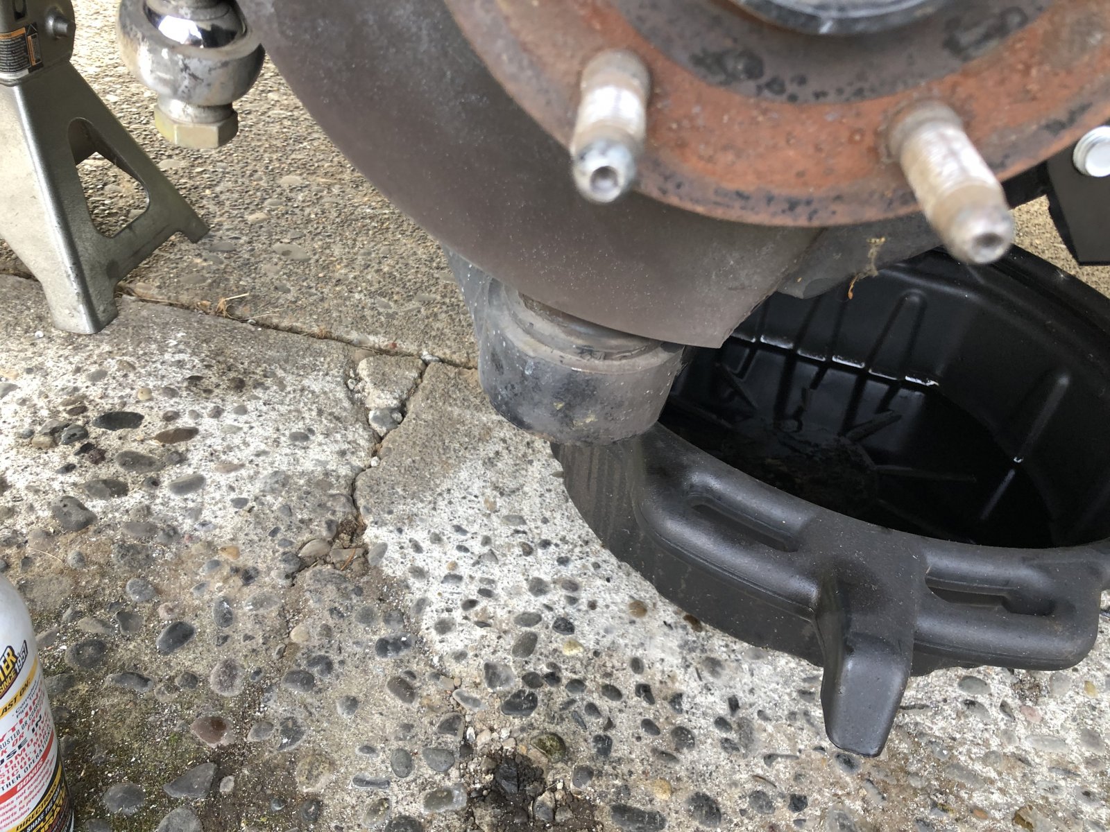

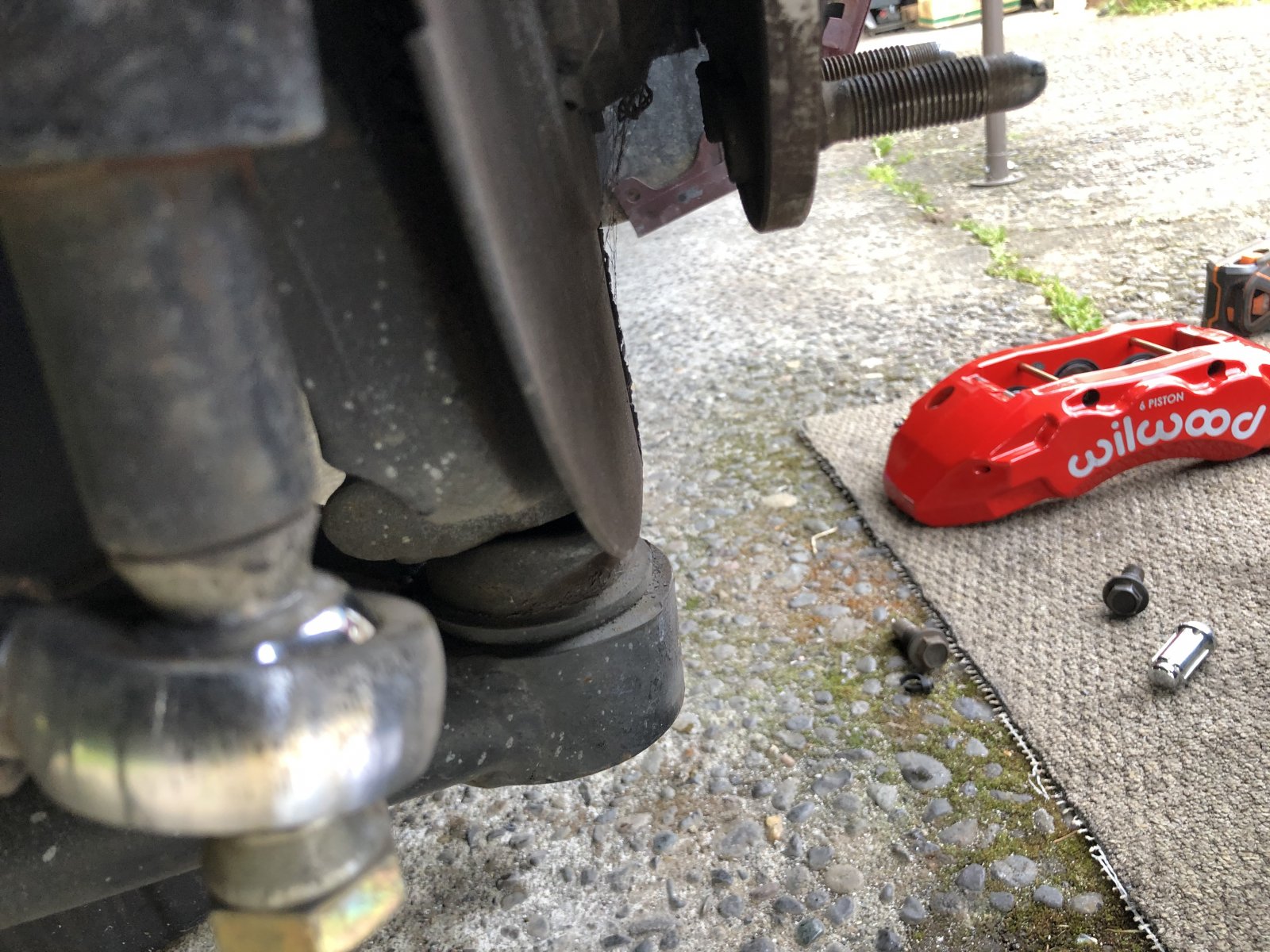

Got the rear brakes done but the fronts have been nothing but trouble. First, it took me an hour just to remove the driver brake line due to the fact it’s in an impossible to get to spot. The upper control arm is in the way. Then the new Wilwood adapter won’t thread to the truck hard line. I’ll have to buy new adapters from a local place. Well, I figured I’d bolt up a caliper and rotor and check clearance. It’s a stock knuckle I think but the ball joint area hits the back side of the rotor so it won’t seat on the axle all the way. I determined I need 1/4-5/16” so the plan is to use 1/4” wheel spacers between the rotor and axle flange and then grind a little on the control arm. I’ll have to use spacers on the caliper bracket too. It’s not the preferred method but I don’t know of any other. I can’t even switch to Wilwoods 14.25” rotors, same problem. The stock 13” barely clears. I don’t want my tires any closer to the fenders but I think 1/4” will be ok.
EC680BFA-2210-4469-A8B6-5EF0DB8F0013.jpeg C39A6FBC-BAB5-41A2-8946-003F495C781B.jpeg

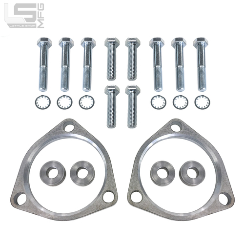

So apparently it’s a thing with this setup- the ball joints are flipped. There’s a company called Little Shop that makes a spindle spacer kit for this. Problem is it’s 1/2” which means the wheels are pushed out 1/2”. I’m going to see if I can add the 1/4” spacers and massage the ball joint cup a little bit. If that doesn’t work I’ll buy the kit and have some material machined off the inside of the wheel hubs. I know from previous experience with the engineer at intro that it’s ok to remove 1/4” from the wheel hub. It’s just time and money, right?
