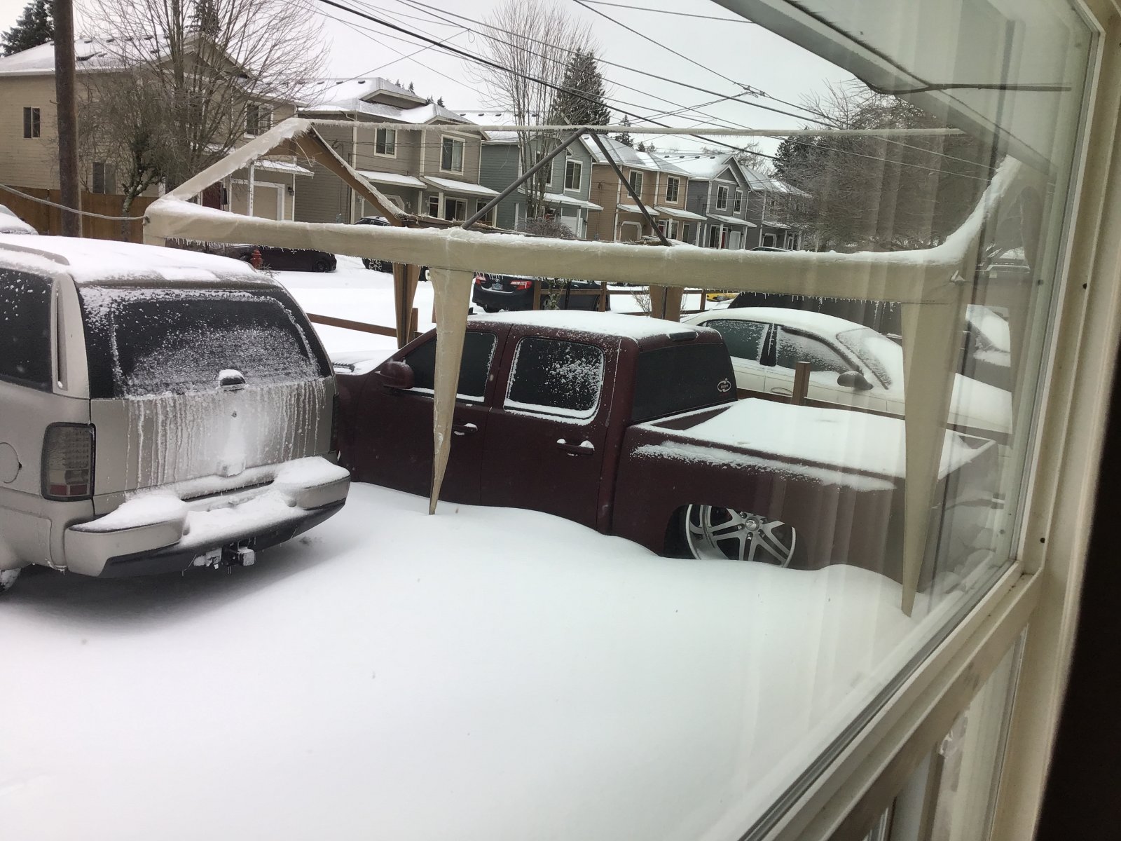

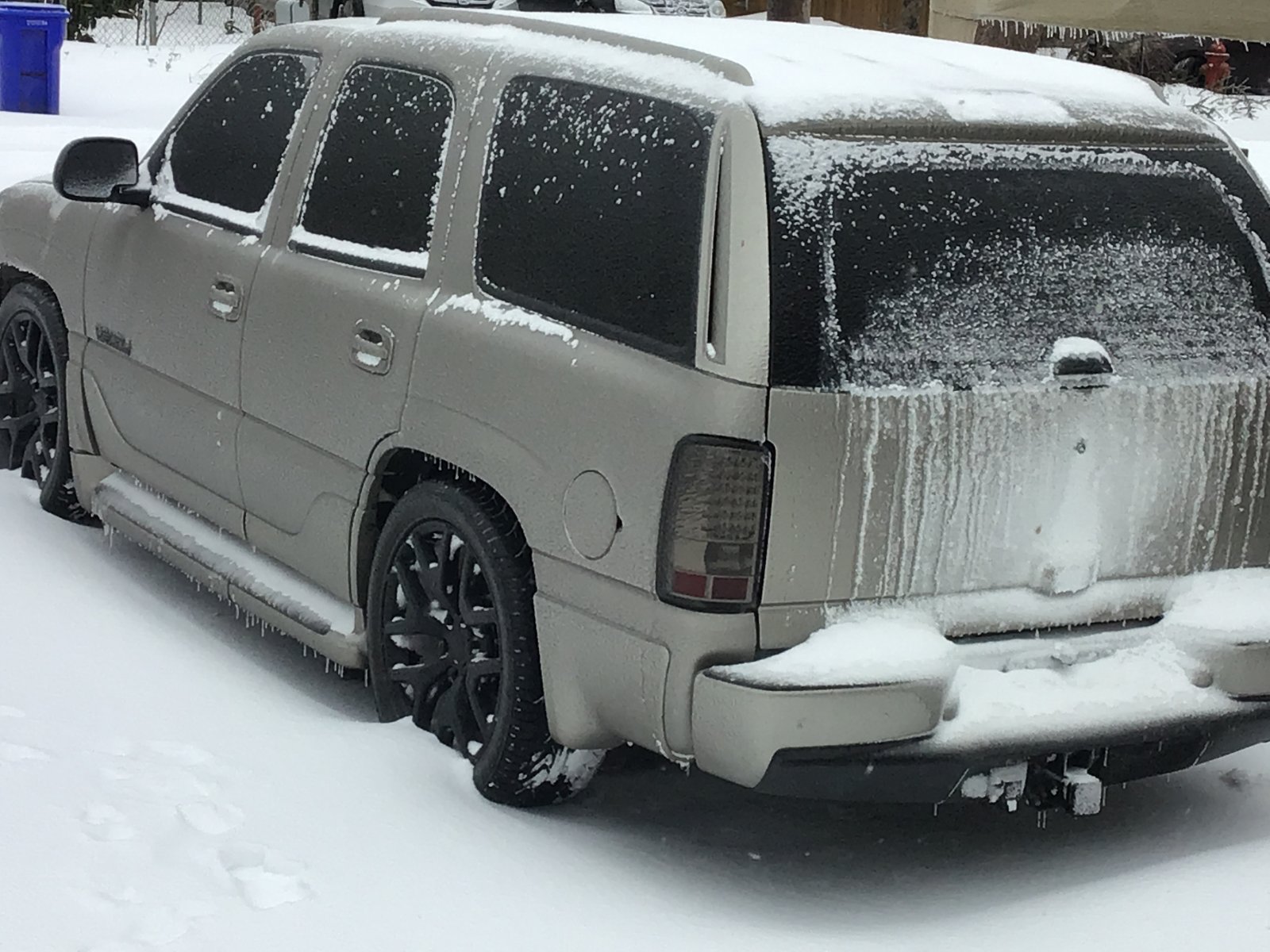

Well...first we got freezing rain, just about 1/8”. Then it snowed about 2-3”. That was yesterday morning and the daytime. Then freezing rain again started just before dark but this time it was more like 3/8” it looks like and then during the night it snowed again. It’s hard to tell how much snow we got all together since the east wind was blowing 30-50mph here all night and it drifted as it snowed. The drifts are glued in place by the ice. The ice was cleared off The Beast yesterday when I went for a drive but that 3/8” layer is on it now and I’m not going to try to thaw it out this time. I don’t need to go for a joy ride that bad. Looks cool though. From in here where it’s warm. :) The awning doesn’t look so good though.:mad:

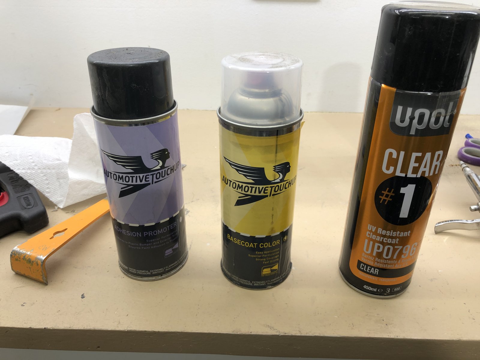

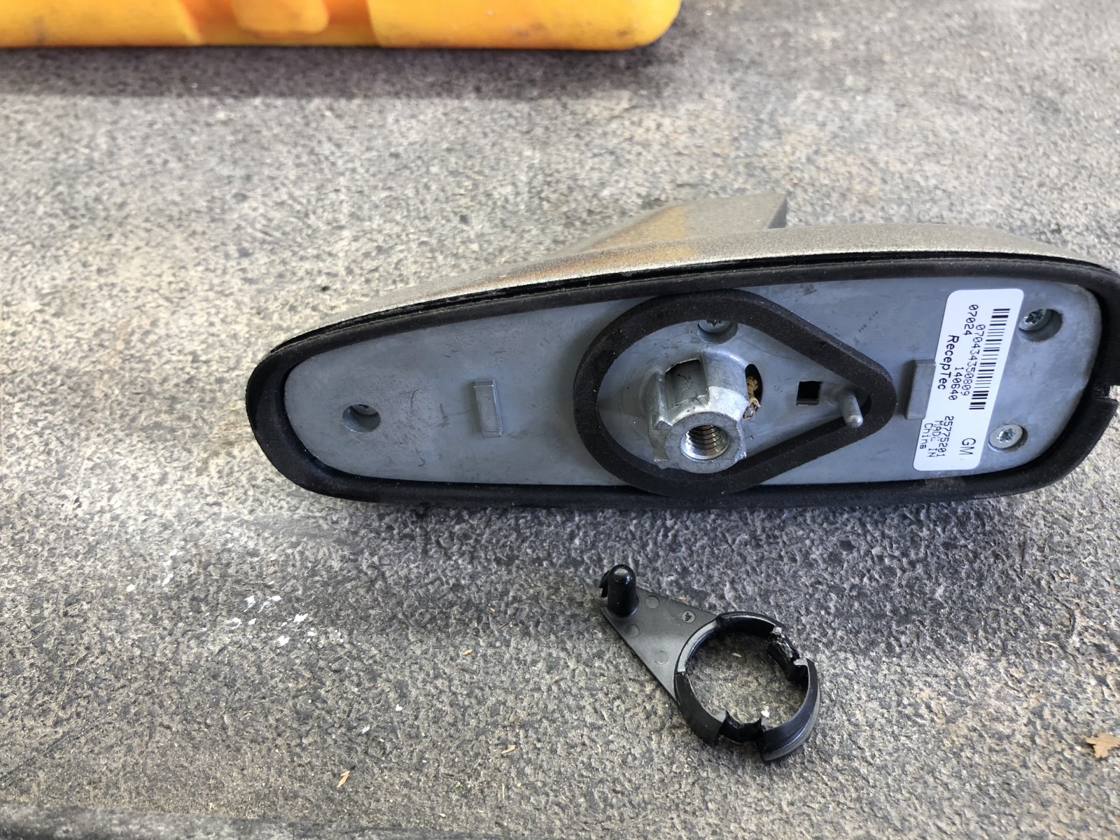

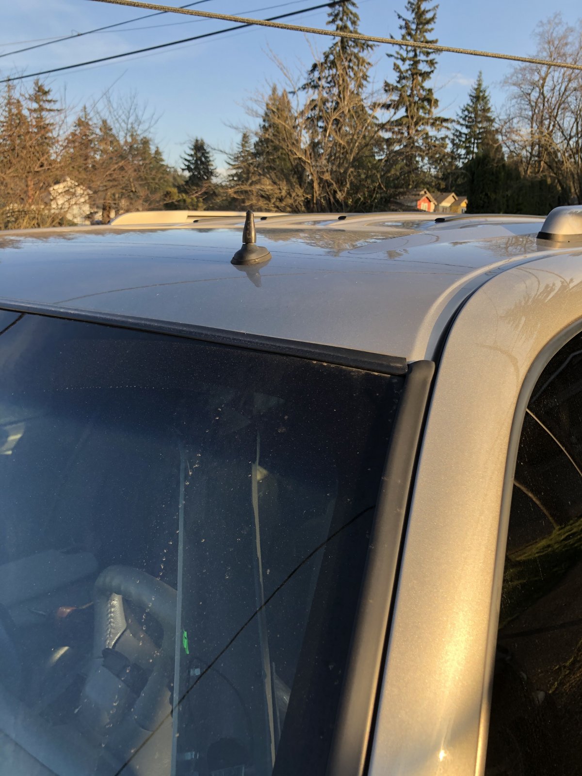

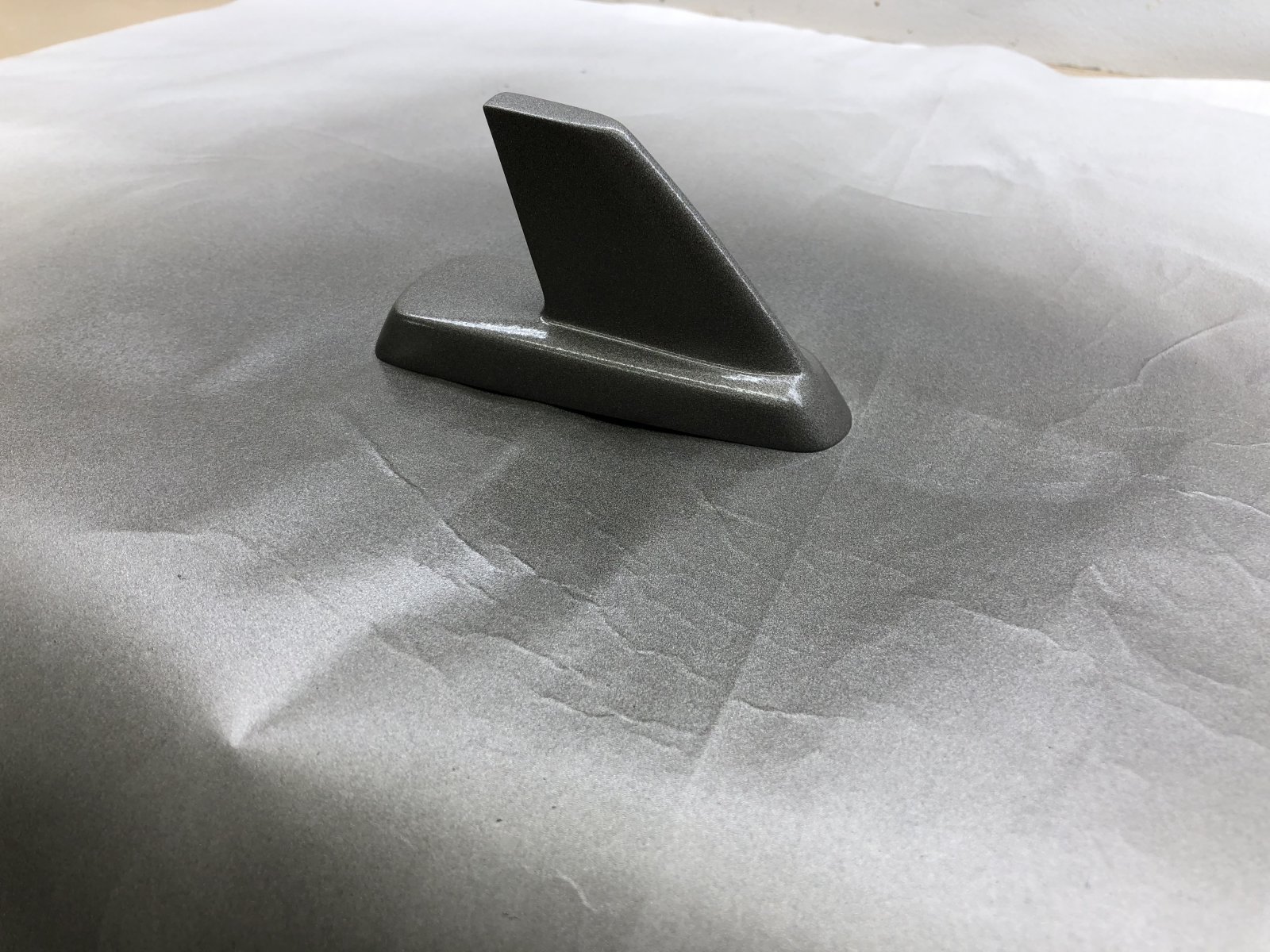

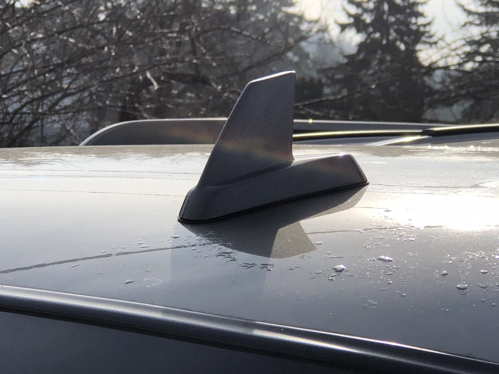

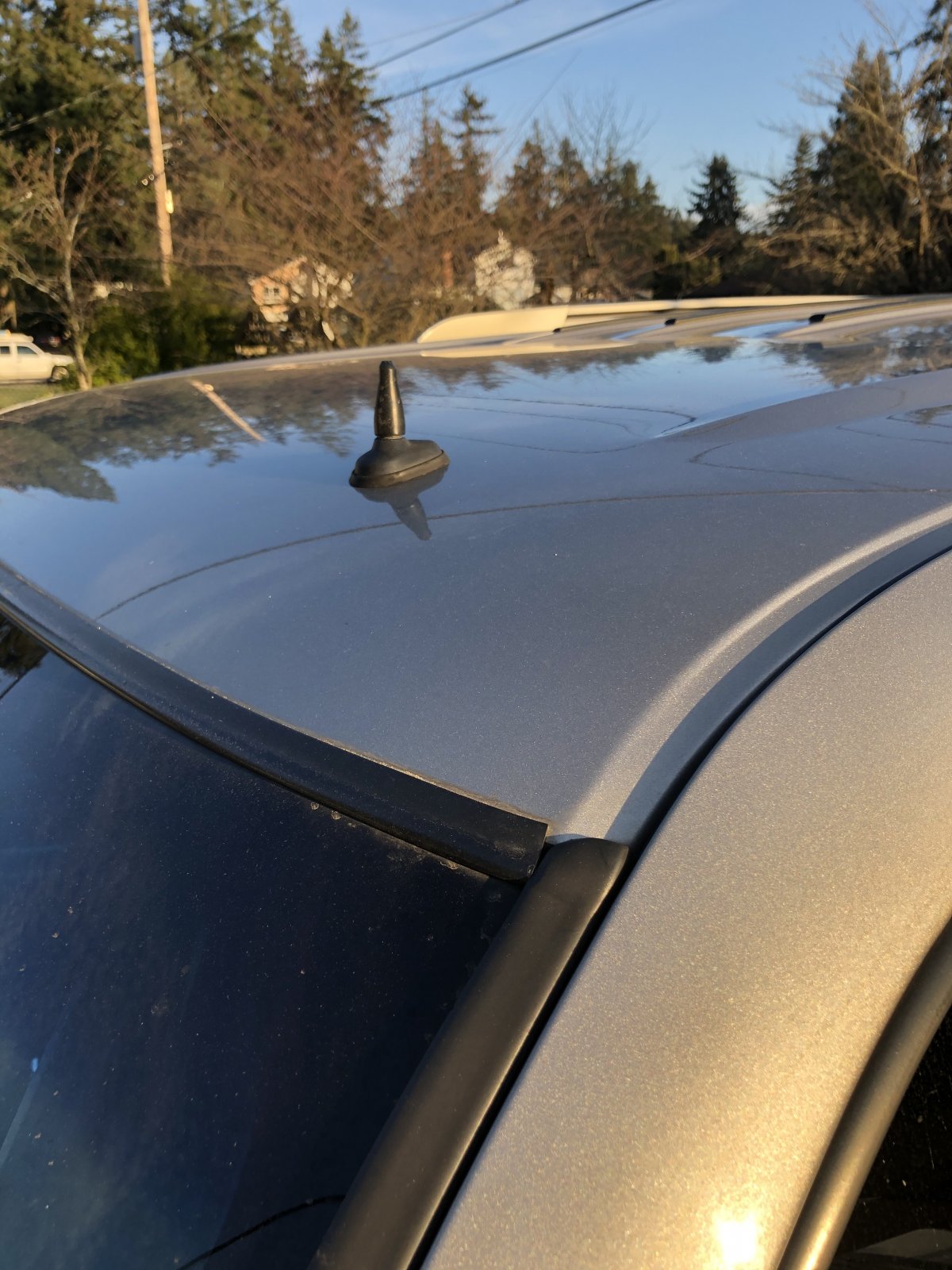

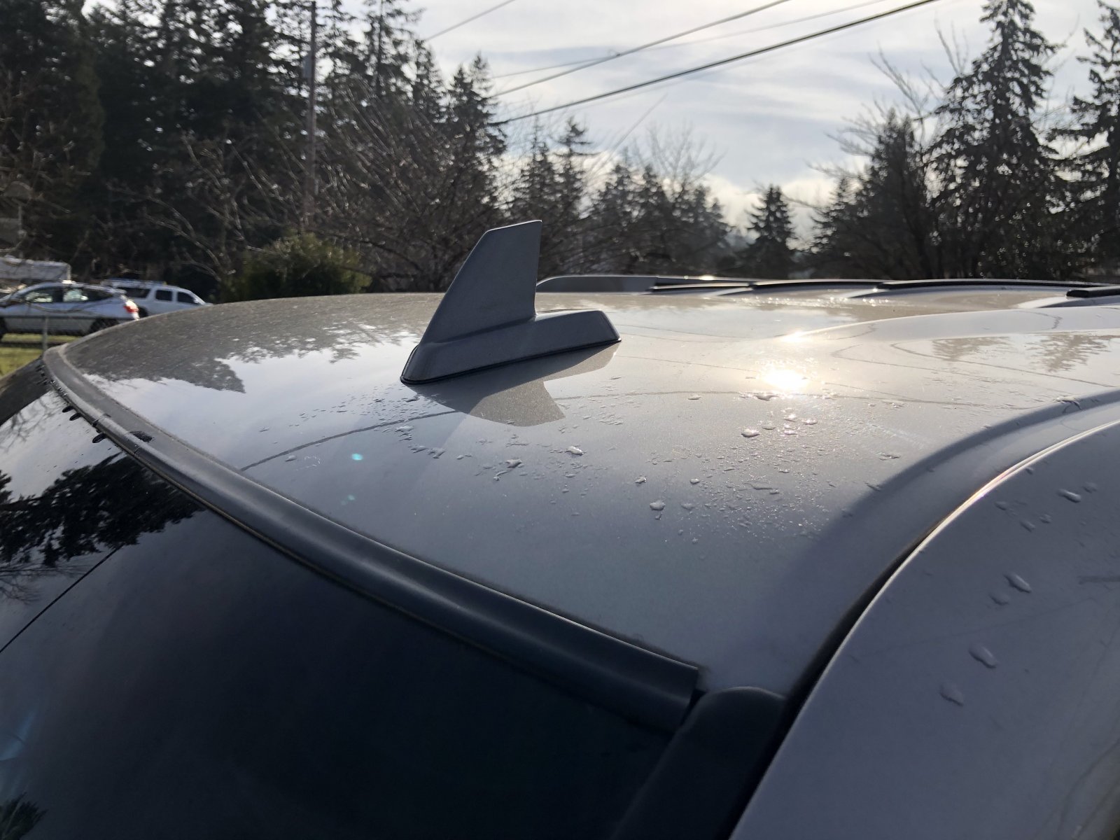

I got a new shark fin antenna thanks to @Sam Harris, painted and installed it today. This p/n is listed as OEM for an 06 Denali and Sam said he saw one on an 06 I think. Anyway thought I’d give it a try to see if it fits in place of my old ugly one. It does fit, however the coax connector doesn’t plug in. That doesn’t matter to me since the OnStar is outdated in this truck and hasn’t worked in forever. I cut the damn cable off. Also the mount is a bit bigger with the plastic locator piece on so I just removed it and it fits perfectly. 80 in/lbs on the mount bolt and it sealed right up. Non functional just like the old one but it looks way better. PN 25775201, fits 00-06.

Old antenna was "lacking" lol:D

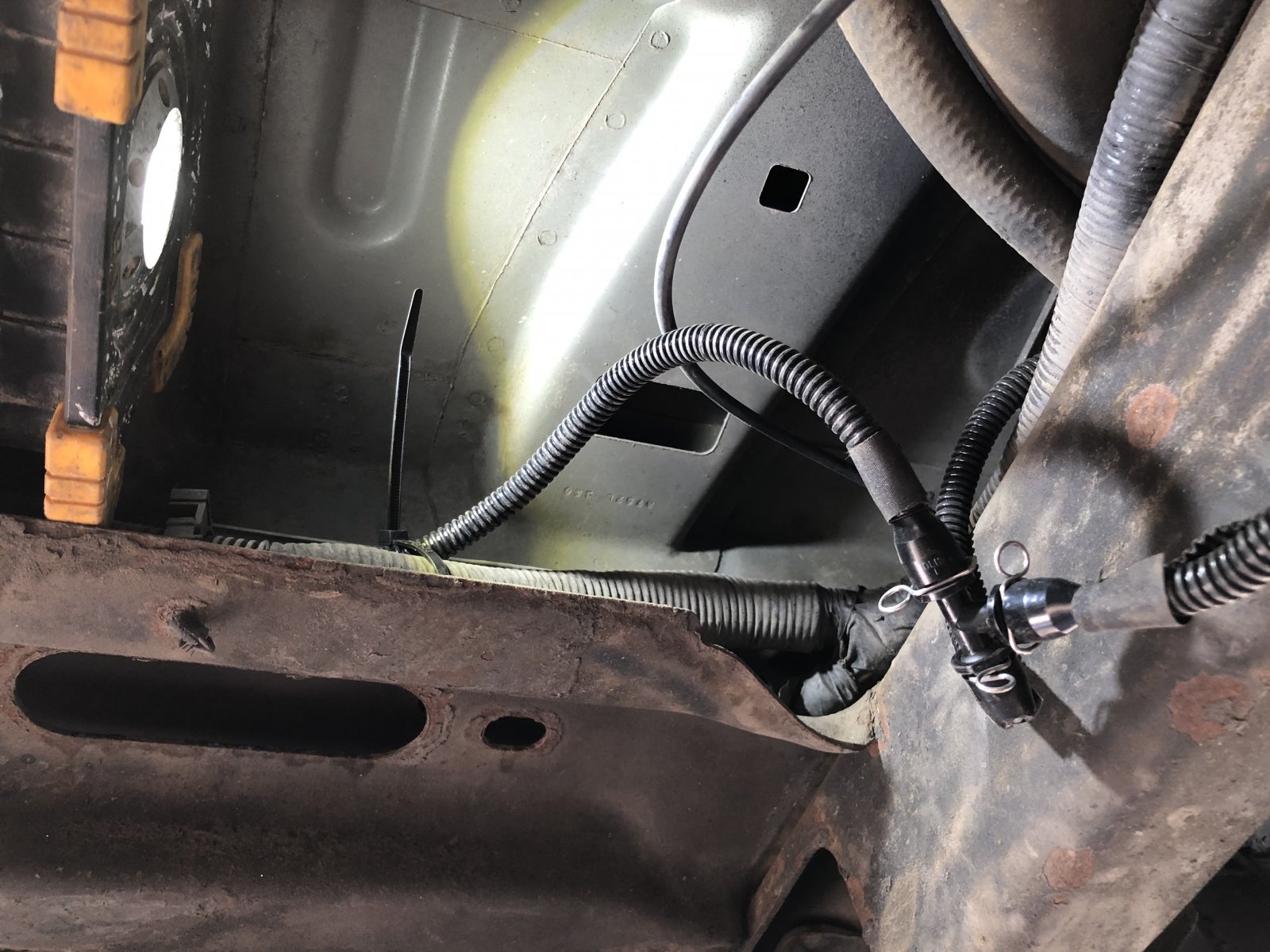

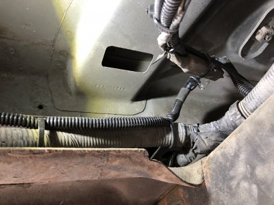

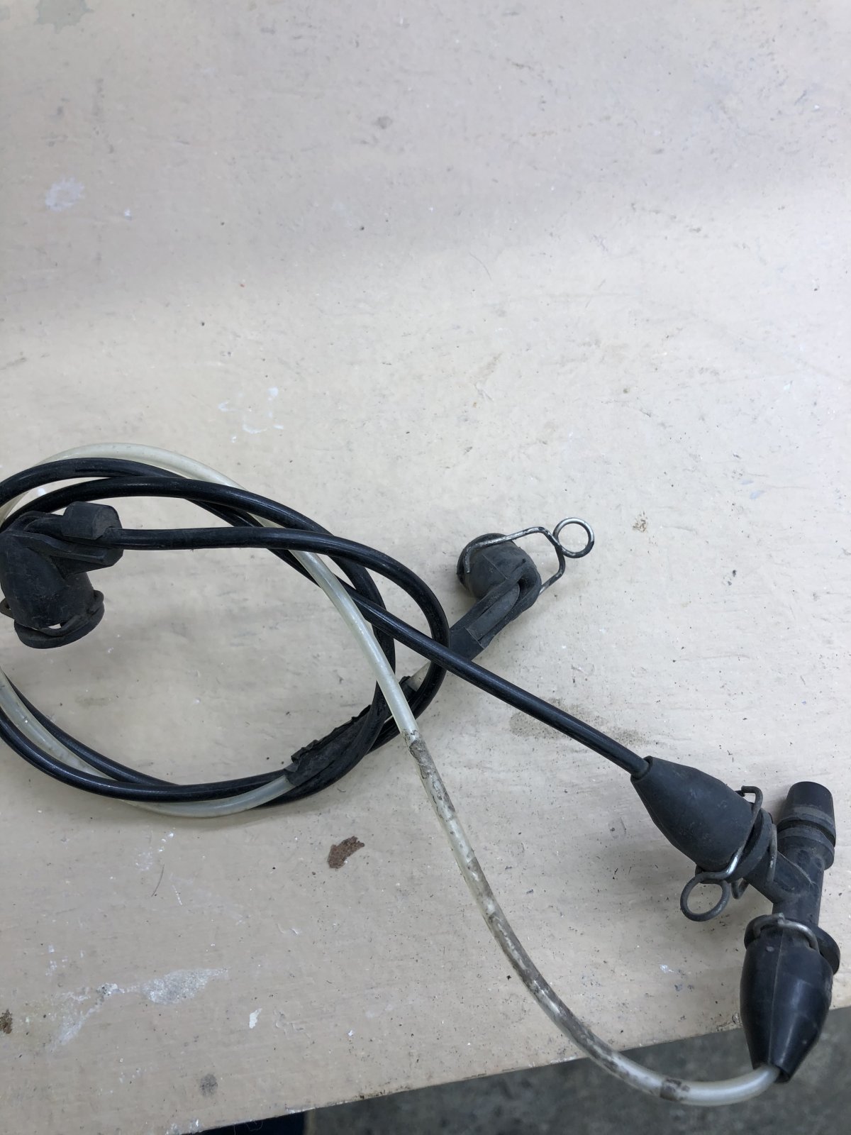

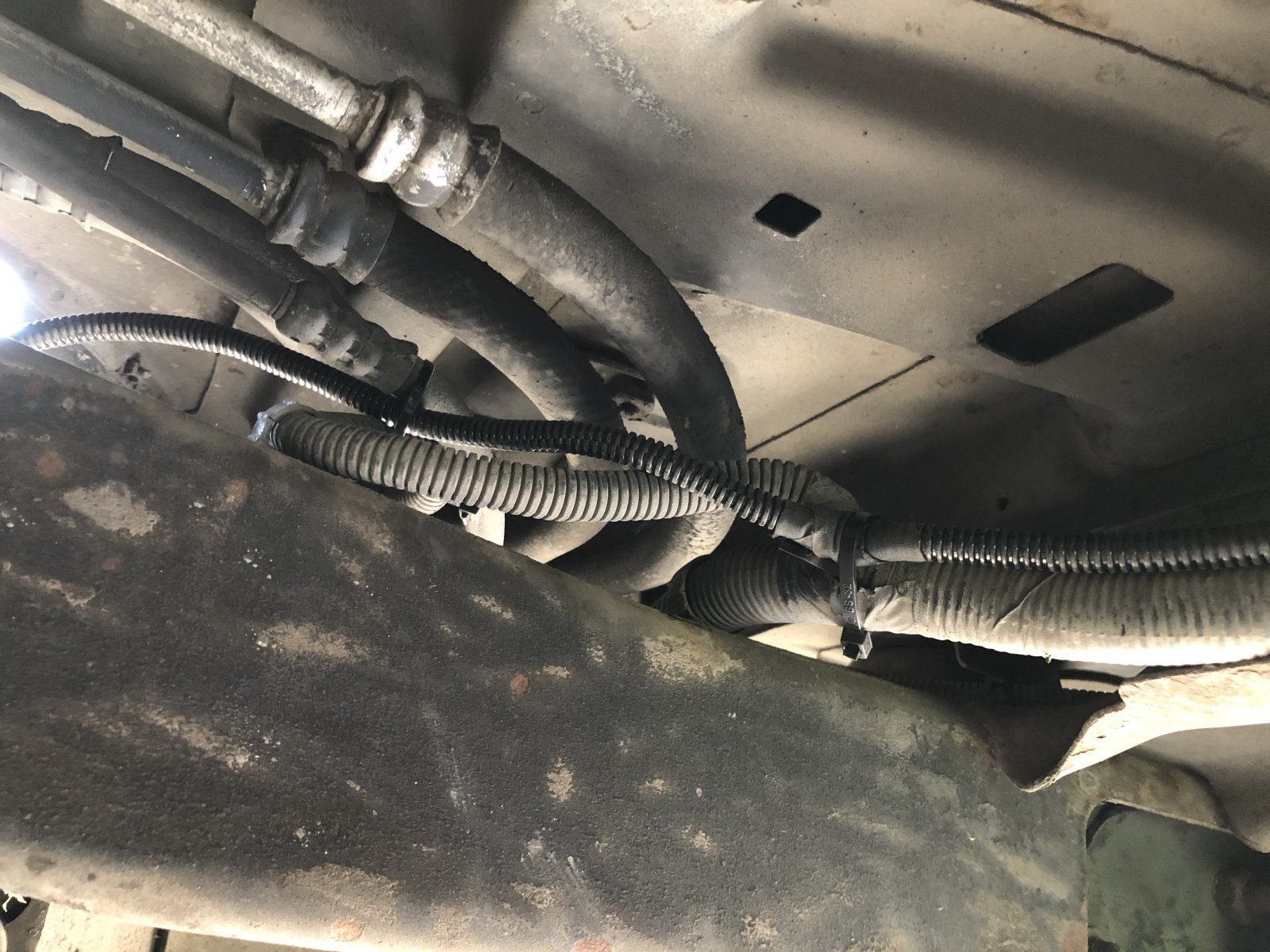

I installed the new air line set I bought from RA for the rear shocks and compressor. It doesn’t take much for me to remember how much I hate working under the truck on my back. Anyway, I covered all the lines with split loom just because. Actually the one that goes to the PS shock was wrapped inside the main loom originally and I wasn’t going to undo that loom so I just cut the line off at both ends and ran the new line inside it’s own loom, then decided to wrap the others. The old lines looked good especially considering they’re almost 20 years old. Hooked up the Tech2 and tested to see if it holds pressure. All is good!
