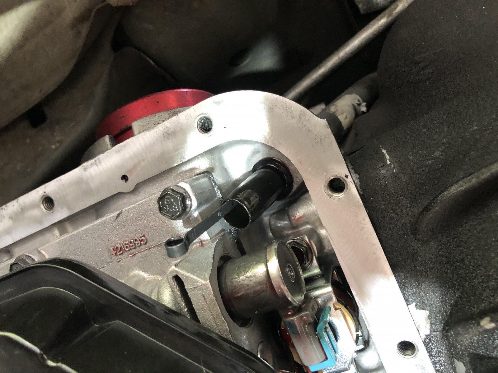

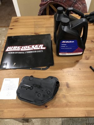

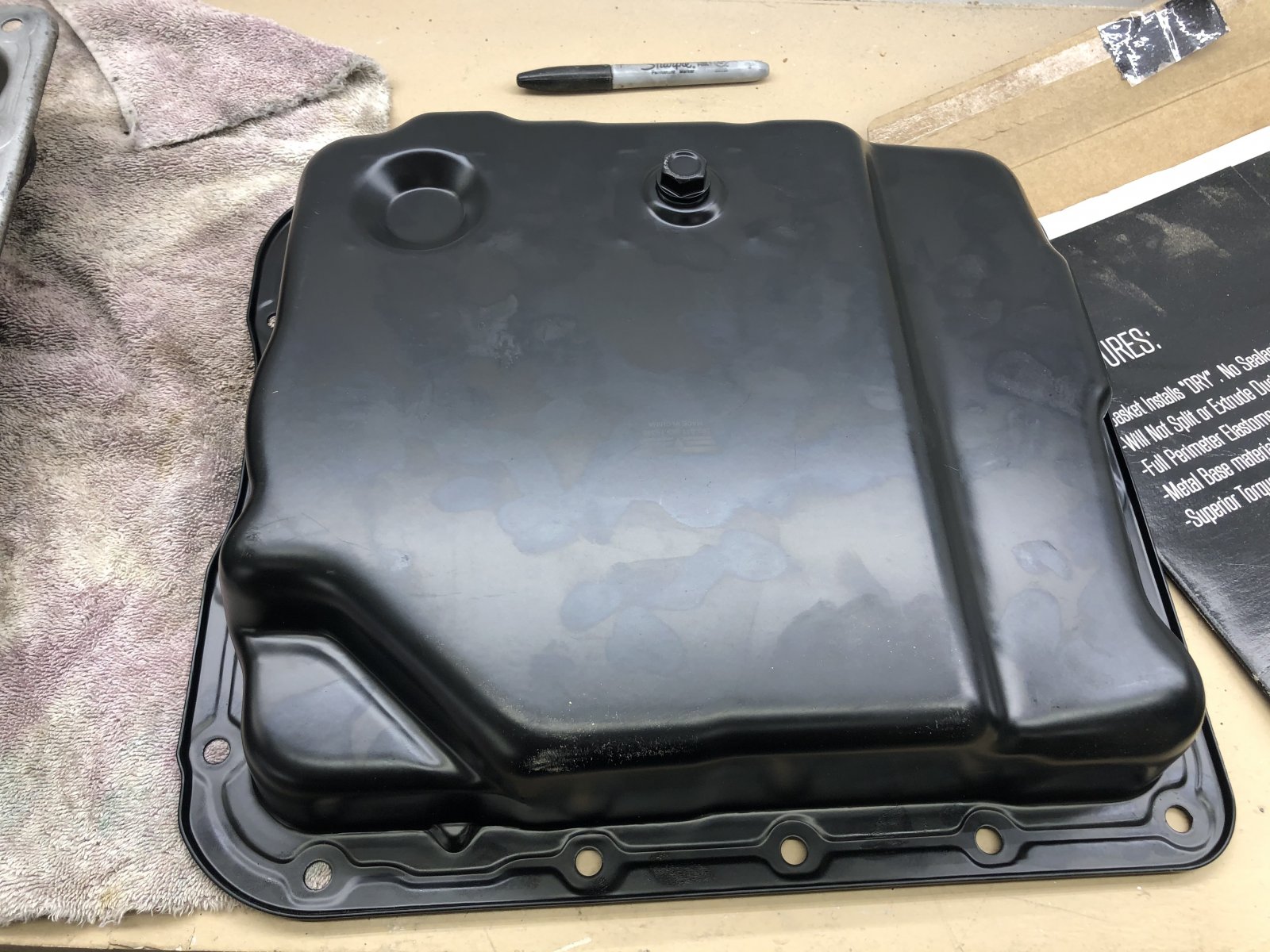

Guess what time it is? Surprisingly I managed to put 2000 miles on it since the trans was installed, 5 miles at a time. And now it’s supposed to rain for a week so it might be a minute before this happens. I got a Lubelocker gasket this time so there will be ZERO use of RTV. I hope the trans lasts this time around and according to Performabuilt it will, as long as I don’t clog the damn servo passages with silicone.

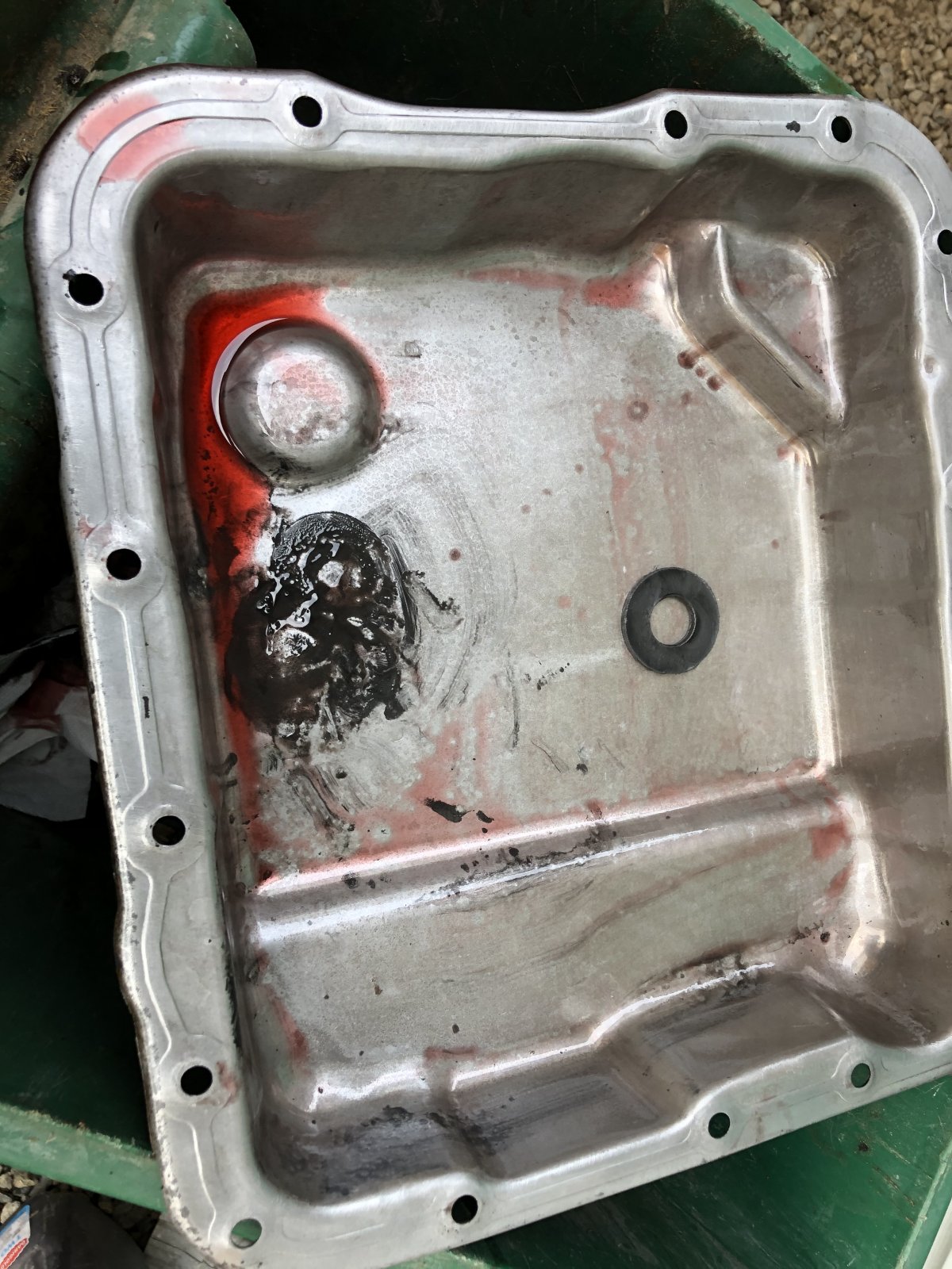

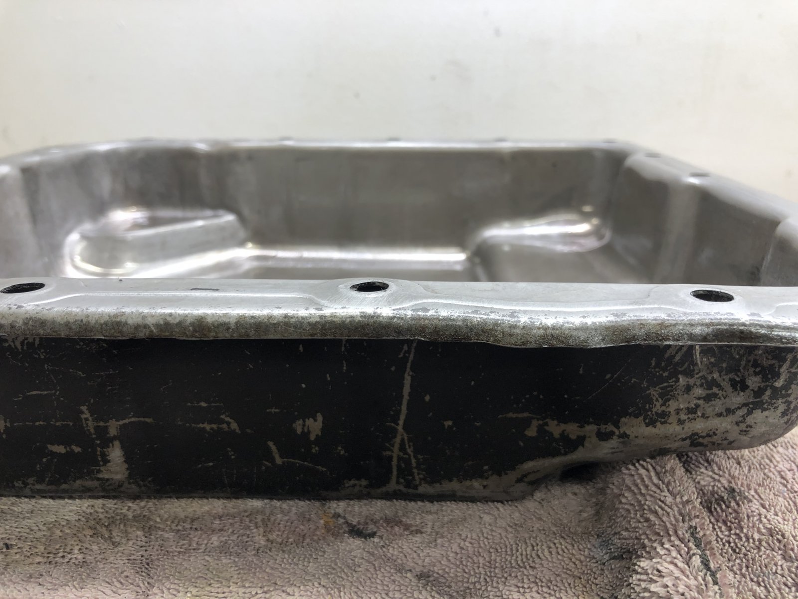

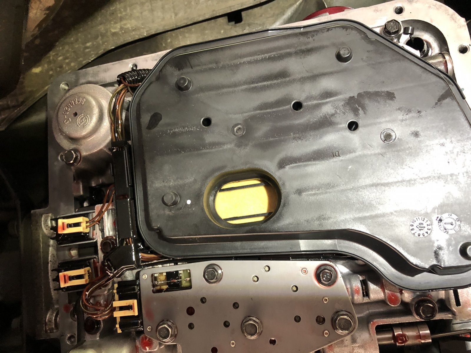

Replaced the trans filter today. It wasn’t too bad, luckily the ARH midpipes come off easy and I just bent the shifter bracket a little bit so the pan could drop down. The magnet looked pretty good, just a bit of fine material but nothing to be concerned with. I’ll cut the filter open tomorrow to check for friction material but I don’t expect much. It’s just broken in with 2000 miles on it. I checked the dipstick to see if the crosshatch was at the pan gasket line as per Performabuilt’s instructions and as far as I can tell it’s good. It’s kinda hard to tell for sure since the seal hangs down but it looked close. The pan has been on and off a few times and it wasn’t flat around the bolt holes anymore so I ran to Oreilly and bought a Dorman one that has a drain plug because it sucks dropping a pan without one. Plus the OEM ones are 3x as much and don’t have a drain. There’s not many Dorman parts I’ll use but a stamped steel pan can’t be ****** up I don’t think.

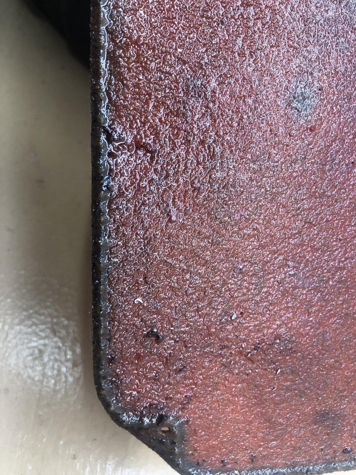

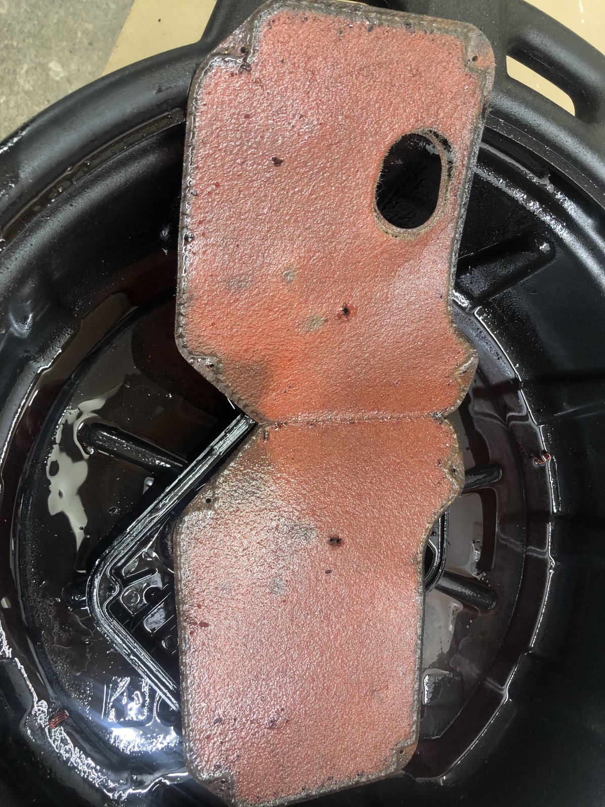

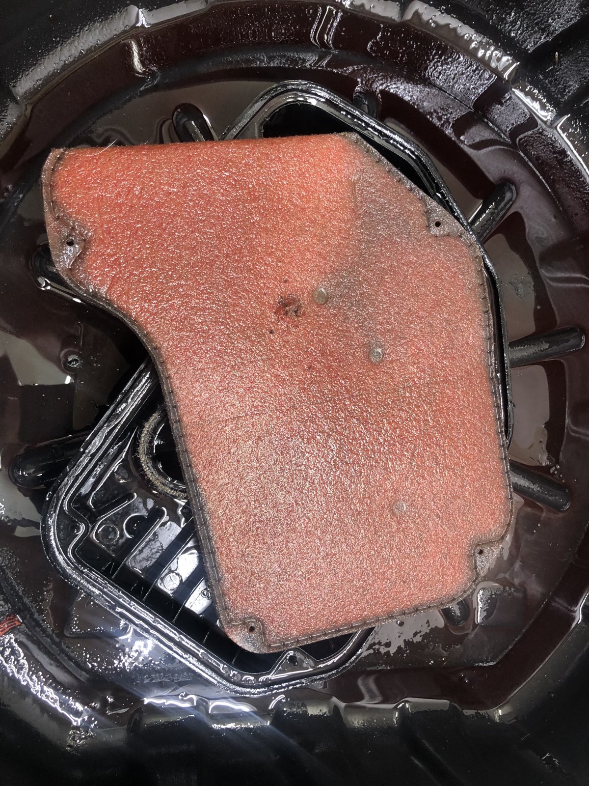

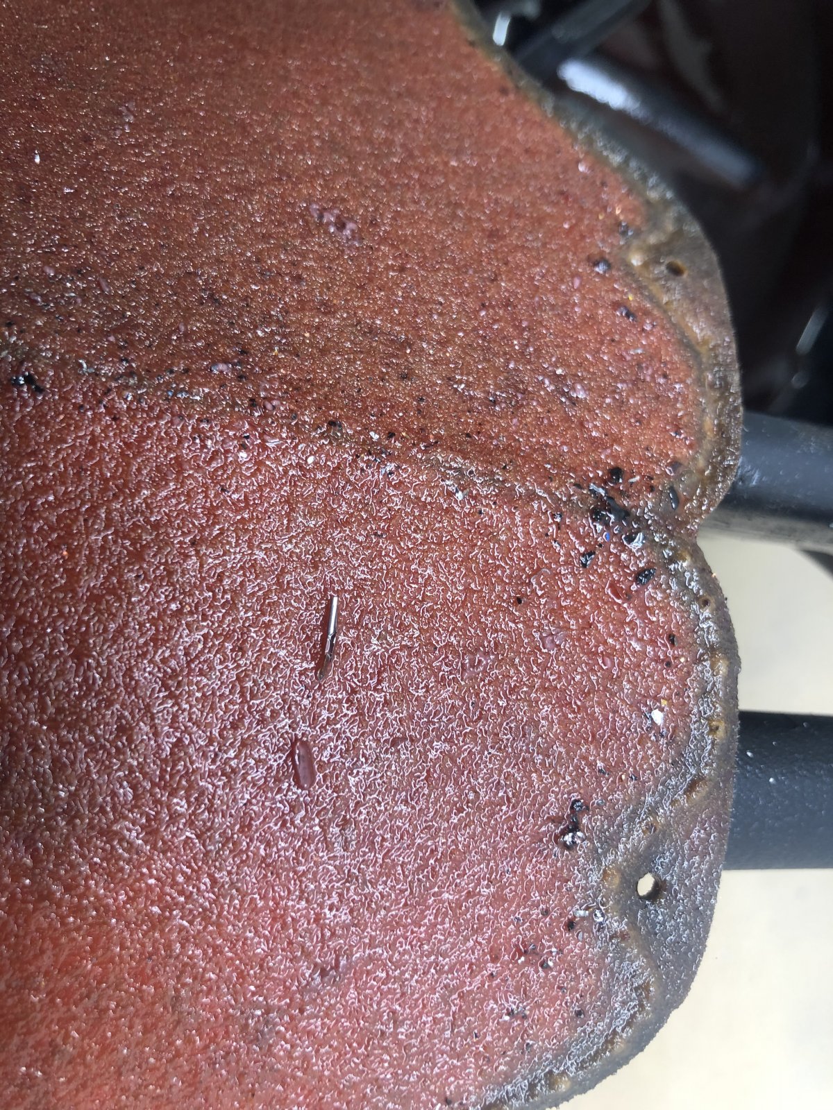

Opened up the trans filter. Nothing to worry about, just a couple of tiny pieces of metal which interestingly were on the interior of the filter media, sandwiched inside. It does only have 2000 miles on it but I’m not seeing any frictions that I can distinguish. I was expecting some. The black plastic shavings are from me drilling out a plastic rivet thing in the center.
