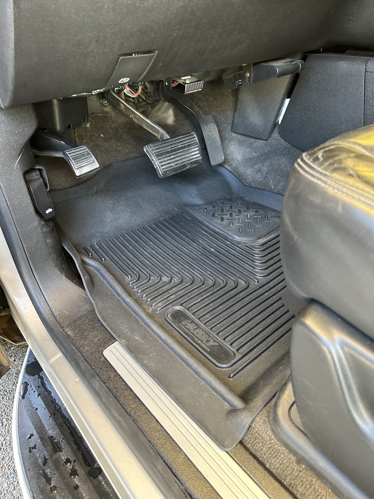

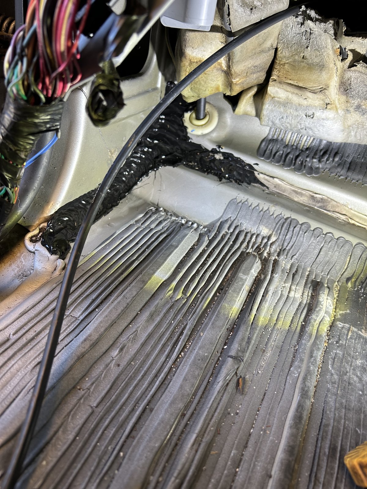

If the rubber backed padding wasn’t completely covering the firewall and going behind everything a person could at least see where it’s coming from. I finally was able to get access to the bottom portion. I have a prybar jammed up there and then propped up on top of the brake pedal to force the pad up as much as possible . I could stick my hand up further and it felt dry all the way across except in that lower left area and I could see above there as it was leaking. It wasn’t coming from above, I’m almost 100% positive. I really believe I got it. I hate waiting to find out but the last thing I want to do is get the new sealant wet before it cures. Tomorrow I’ll find out.

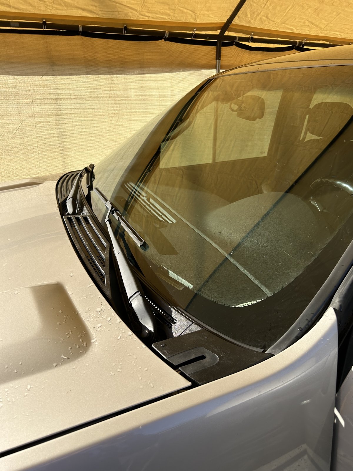

Looks like that last fix finished fixing the leak. The work I did under the cowl did seem to slow it down but when I was finally able to pry up that rubber pad by the hood release cable grommet I could see where it was coming in at. At first, I could see water coming in fast as soon as I applied any at all inside the cowl, even just spraying a little close to the fender in there. After sealing that seam it would take a little longer before I could see water coming inside. I might have just diverted how it runs down that area, there’s no way to see the route the water takes once it goes through that flap area. But once I sealed up those seams in that interior inside
corner, I couldn’t get any water at all inside and I flooded the inside of the cowl for several minutes, more than it will ever see. I declare victory! Time will tell I guess.

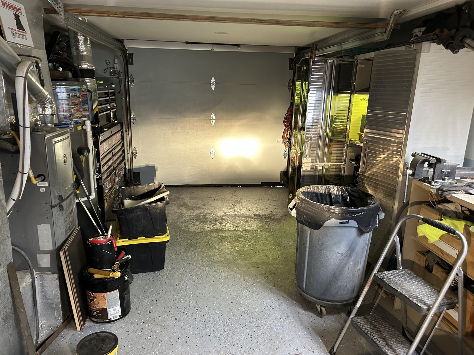

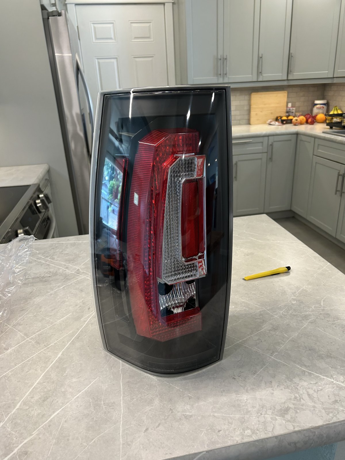

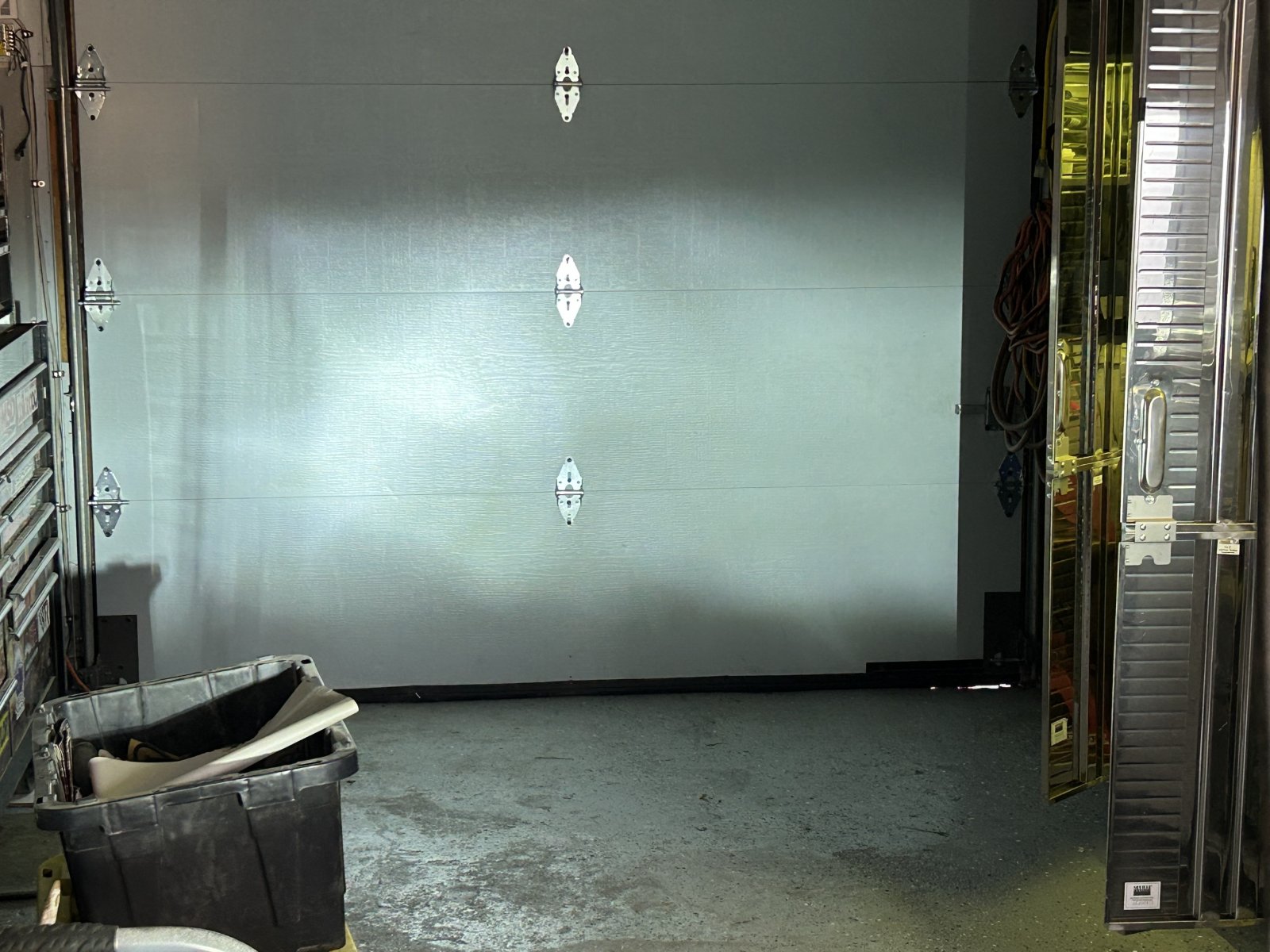

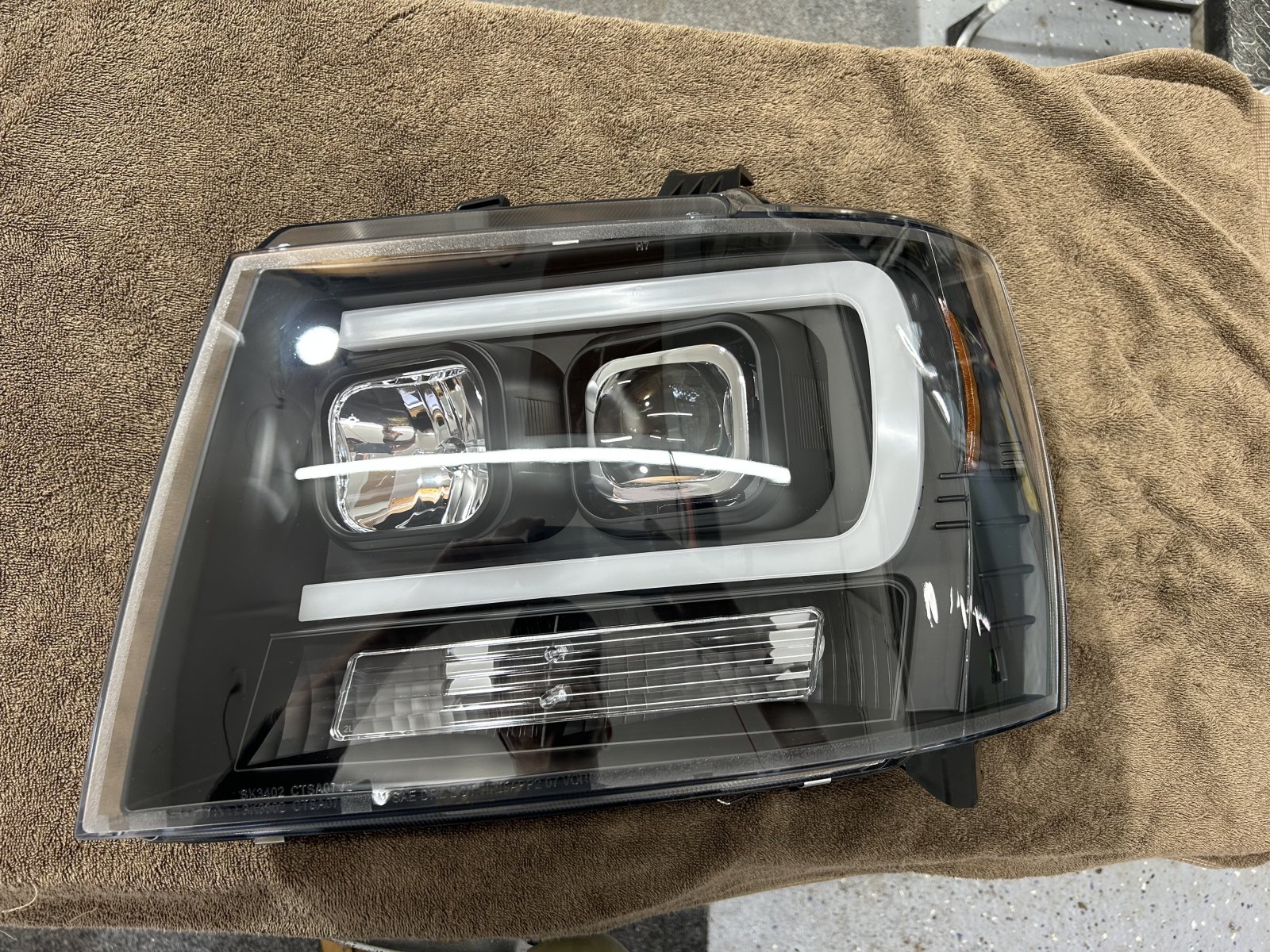

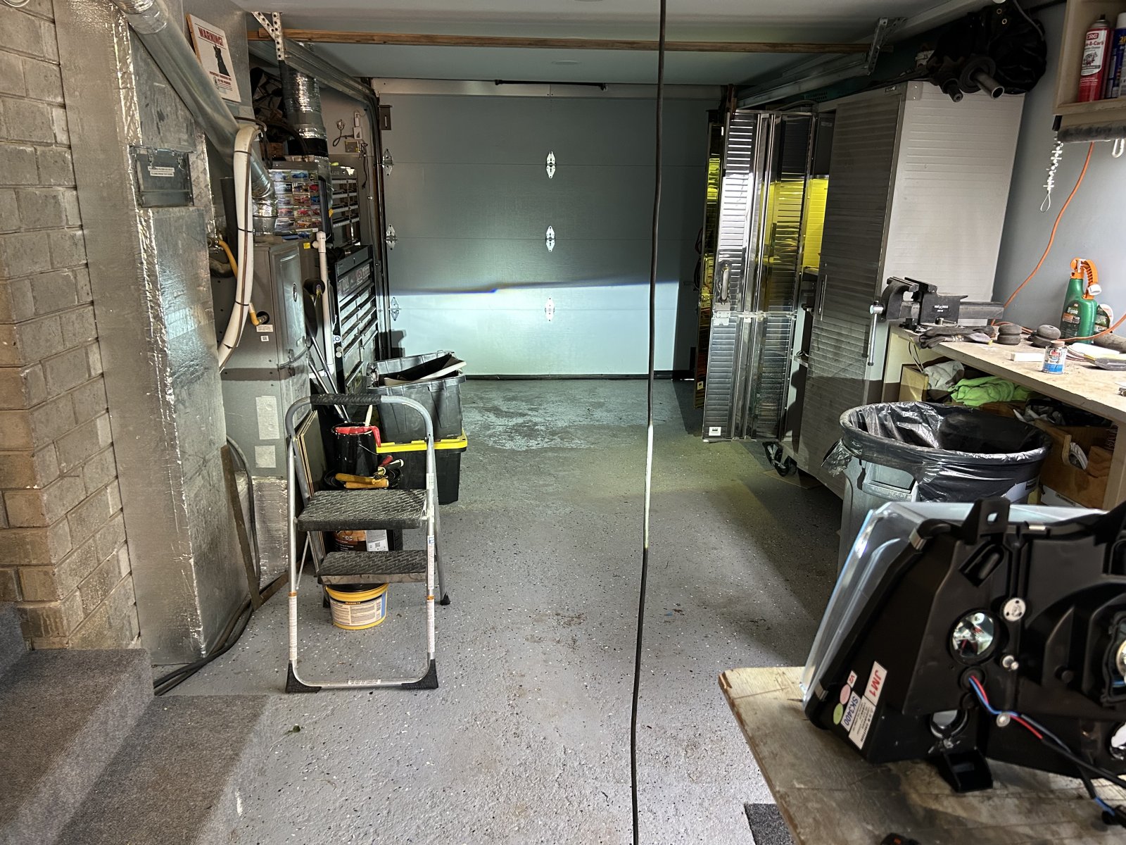

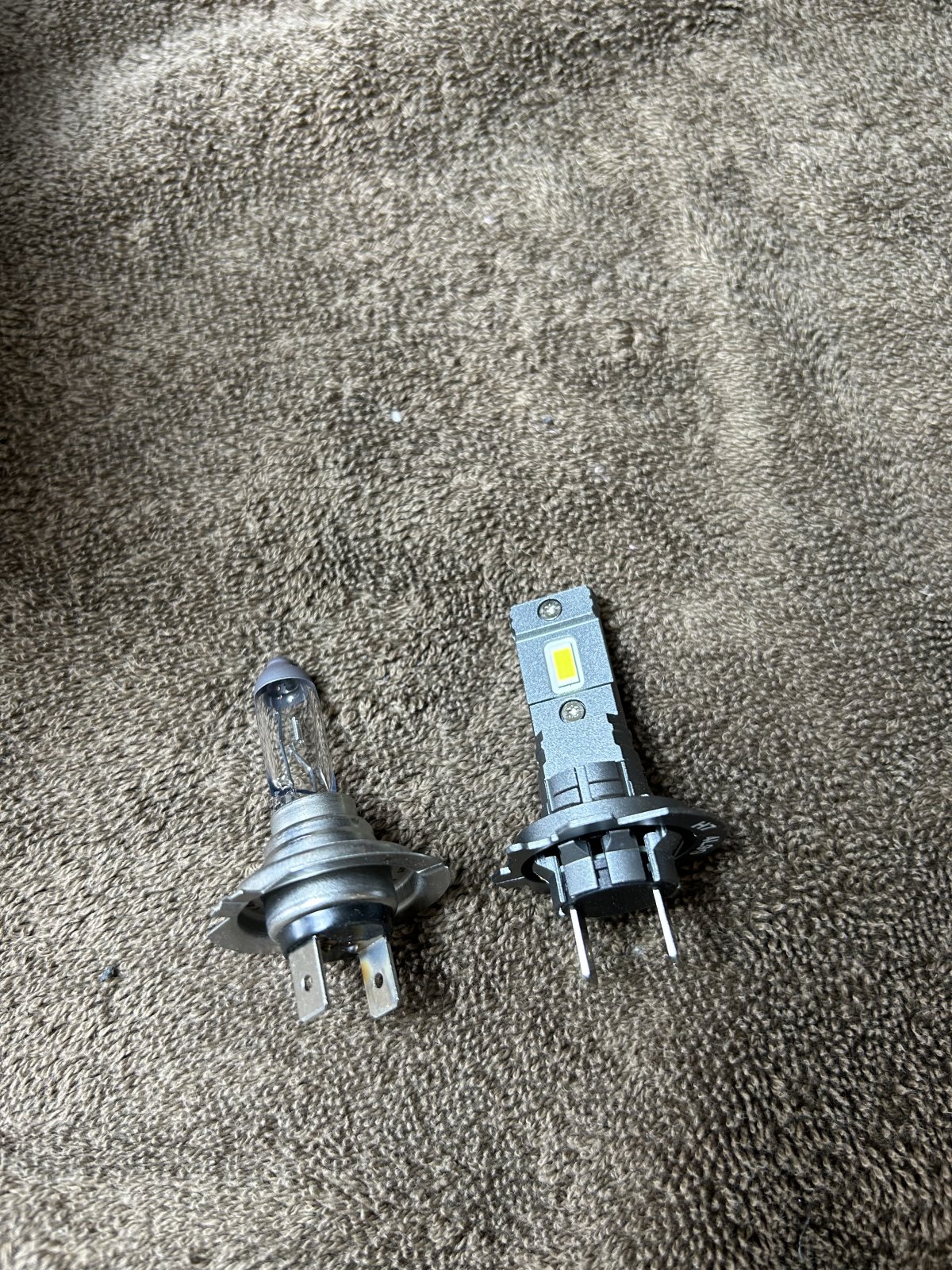

I had decided to spend some money on it by now so I ordered some of Spyders best head and tail lights. I swapped in LED bulbs into the low beam projectors with great results, see the cutoff lines in the bench test. Those are H7. The high beams are H1 and use reflectors and ship with halogens. I tried several LED bulbs and all end up orienting the bolt at a 45 degree angle and you can see the bench test. The white light is the LED and the yellow is the halogen. The LED at the 45 degrees throws a scattered beam, so I left the halogens in the high beams. There are H1 LED bulbs with adjustable collars for about $125-up. No thanks.View attachment 461675View attachment 461676View attachment 461677View attachment 461678View attachment 461679View attachment 461680View attachment 461681View attachment 461682View attachment 461683
