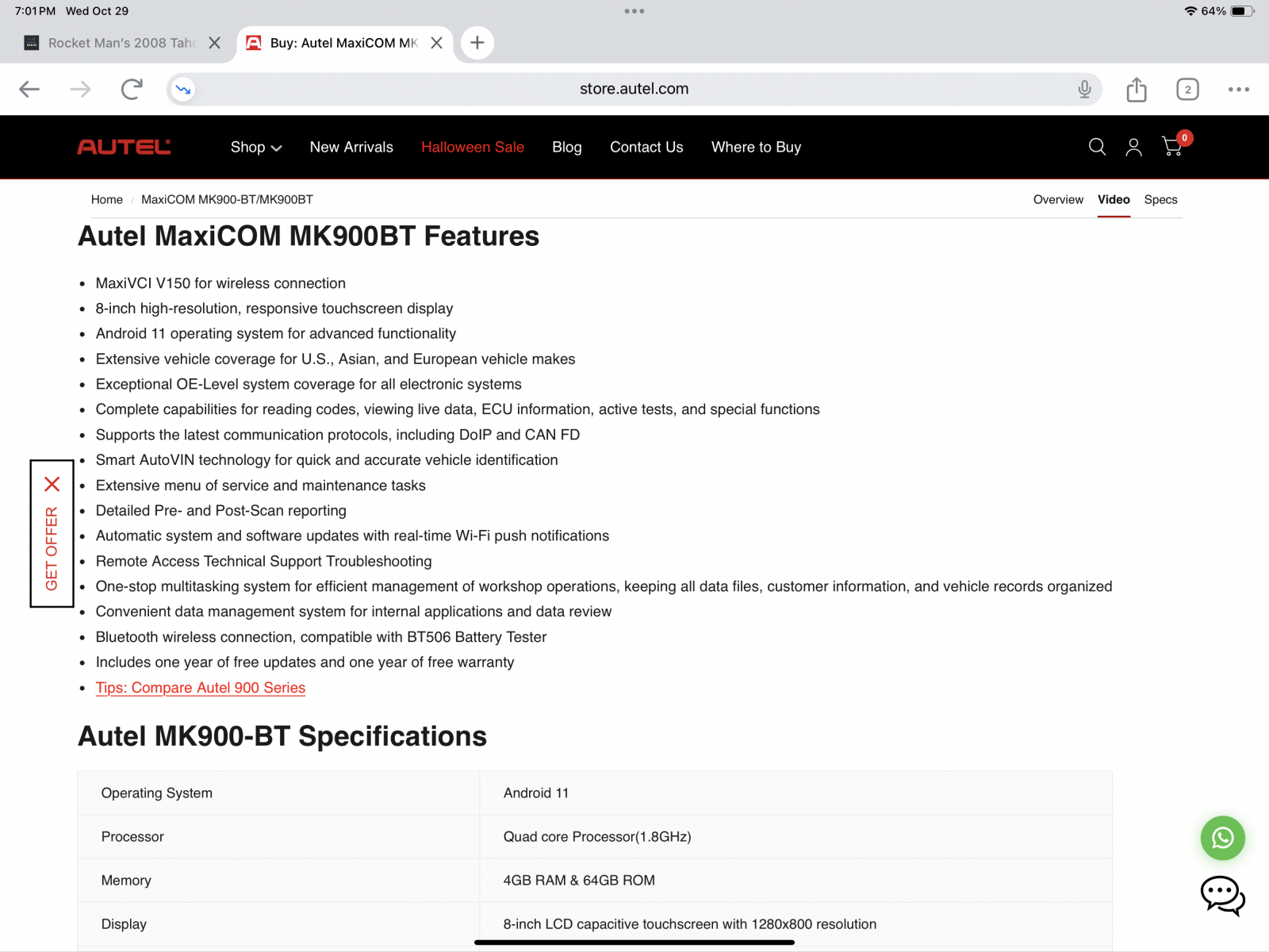

I’m not sure where you purchased it, but the Autel website does clearly state it comes with one year of free updates and one year of free warranty, its listed on the bottom of the features section. I don’t believe any diagnostic software comes with lifetime free updates anymore especially vehicle diagnostics. You’re talking new vehicles added by the thousands every year. Anyway, I knew what I was getting. It works perfectly fine, the updates aren’t for my old vehicles. With a Tech 2 , I had one old set of software from who knows when that never updated once in 10 years. ;)

I’m not sure where you purchased it, but the Autel website does clearly state it comes with one year of free updates and one year of free warranty, its listed on the bottom of the features section. I don’t believe any diagnostic software comes with lifetime free updates anymore especially vehicle diagnostics. You’re talking new vehicles added by the thousands every year. Anyway, I knew what I was getting. It works perfectly fine, the updates aren’t for my old vehicles. With a Tech 2 , I had one old set of software from who knows when that never updated once in 10 years. ;) View attachment 471037
I bought mine from scAmazon. I see where it clearly states the $299 update in your screenshot as well;)
I get what you're saying and I did see the one free year of software updates. I've also never owned a scan tool that has a million stupid updates every time I power it on. Not ******** on the product as a whole, just not a huge fan of the little things. It does its job. It's programmed every tpms sensor I've needed it to, and it even pointed out my bad airbag sensor on my avalanche. All in all, it's ok I guess.

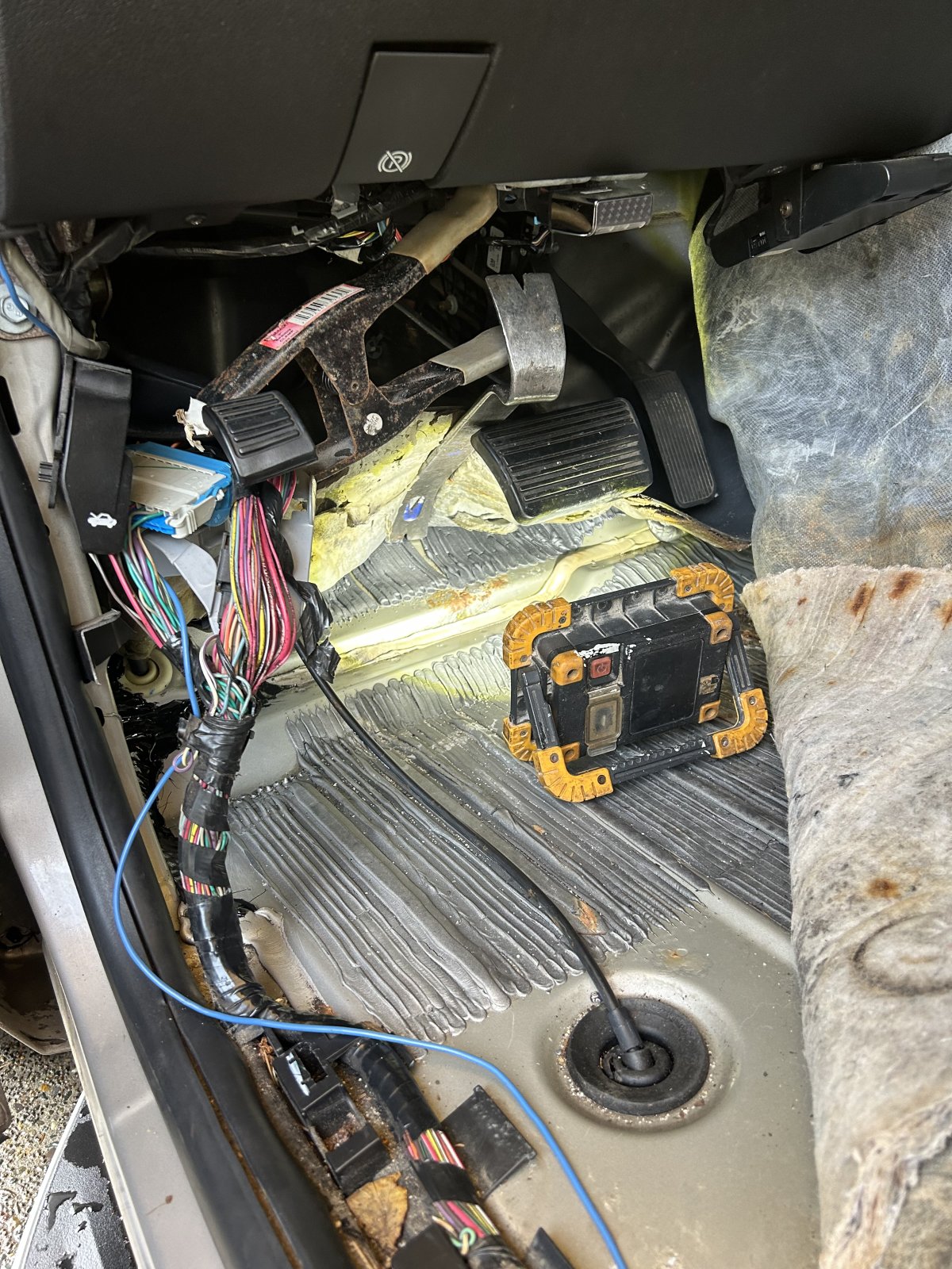

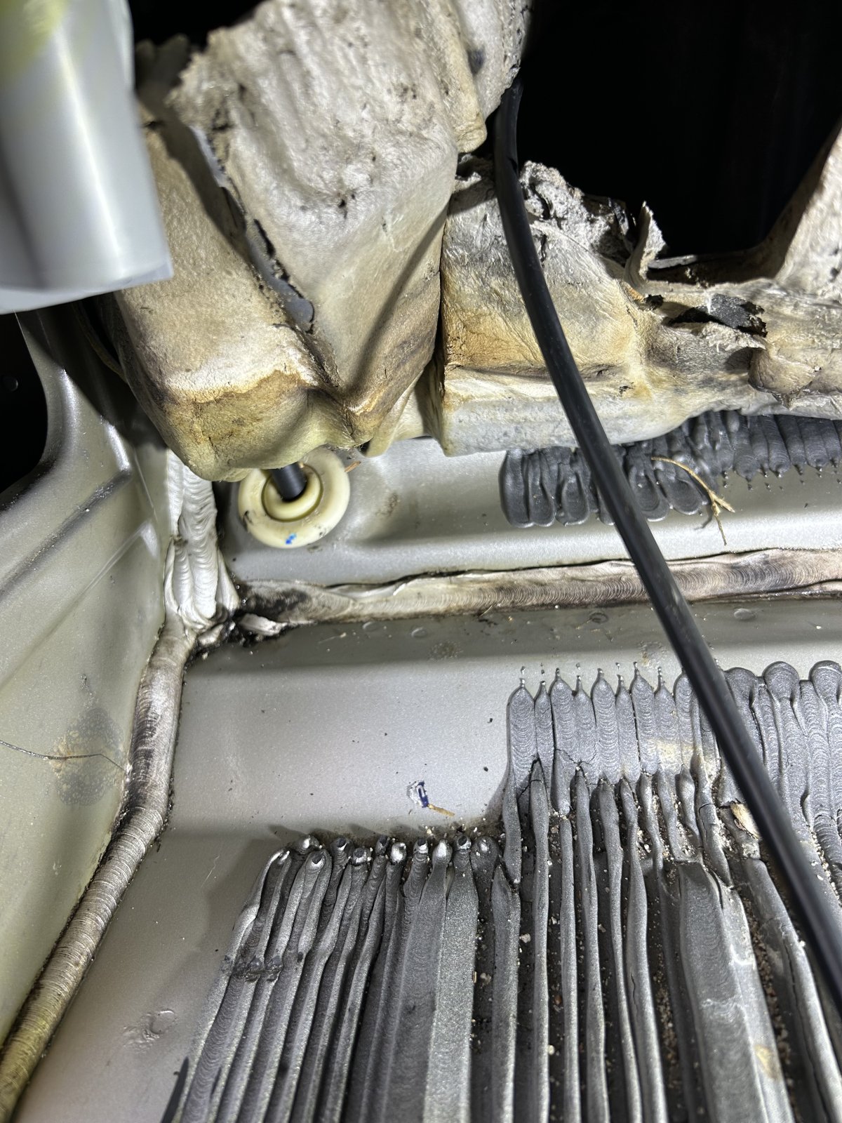

Too bad the new scanner wont tell me where the damn water is coming from on the left cowl area. It’s soaking the driver side front carpet. I took everything apart on the driver side interior and removed the cowl. The drain with the flapper thing was full of leaves and crap so I figured aha that was it. But no bueno. I have the carpet, pad and the padded plastic piece that goes up the firewall already by the electrical harness propped up so I can see the actual metal pan and where it angles up towards the firewall. As soon as I apply any water inside the cowl area outside, I see it literally flowing like a small stream inside. Do any of you know what I need to look for and seal up? I have it parked under cover until I figure this out.

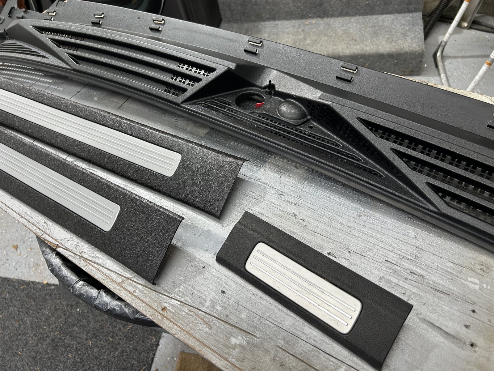

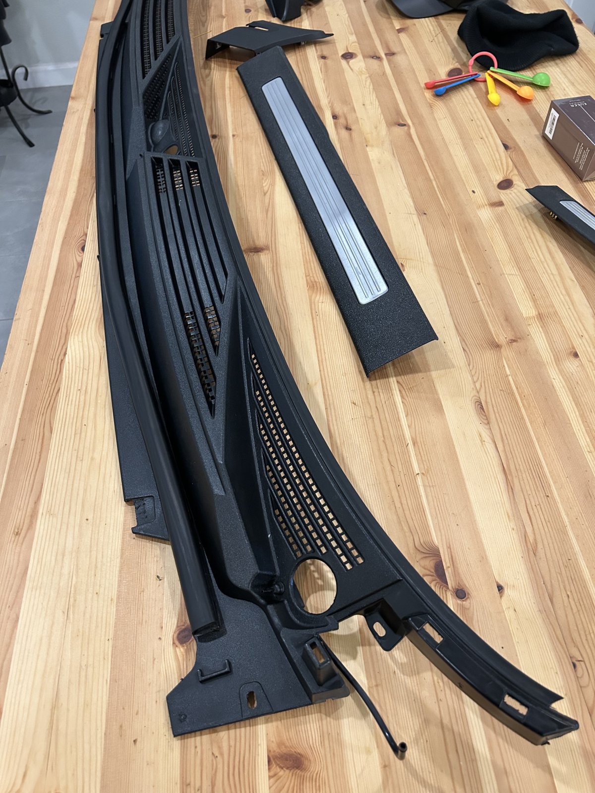

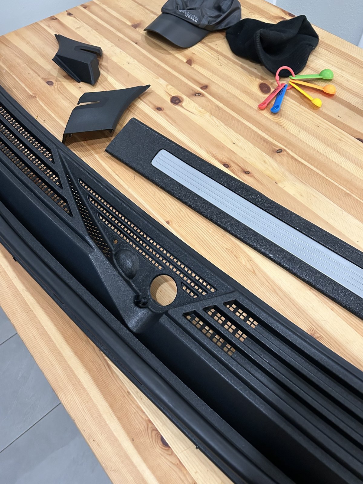

While I’m working on the leak, I had to pull some plastic pieces off and of course had to restore them. I love using Cerakote. The door sills looked terrible, the aluminum inserts were all messed up. I removed them and found out they were clear coated and that was most of the problem. I removed it and painted them. I still don’t think I’ll go with them though because they have dents and slight waves. New ones are about $200 if you can find them. I think the driver side is NLA. I ordered a set of used like new pickup ones that are black. They will fit, I tried the ones off my Silverado. The back doors are a different story though because the Tahoe ones are shorter than the pickup ones so I can’t get black ones. I don’t know if I’ll be able to handle different ones in the front than the back but I’ll see. The back ones are in good condition.

While I’m working on the leak, I had to pull some plastic pieces off and of course had to restore them. I love using Cerakote. The door sills looked terrible, the aluminum inserts were all messed up. I removed them and found out they were clear coated and that was most of the problem. I removed it and painted them. I still don’t think I’ll go with them though because they have dents and slight waves. New ones are about $200 if you can find them. I think the driver side is NLA. I ordered a set of used like new pickup ones that are black. They will fit, I tried the ones off my Silverado. The back doors are a different story though because the Tahoe ones are shorter than the pickup ones so I can’t get black ones. I don’t know if I’ll be able to handle different ones in the front than the back but I’ll see. The back ones are in good condition.View attachment 472070View attachment 472071View attachment 472072
Those look brand new. What is ceracote and how is it used? Ive used wipe new a time or 6 on the avalanche, but I haven't used it in a while.
52,954
Cerakote makes a wipe-on product that lasts about a year, depending on the environment; they state 200 washes. It makes the black plastics look like brand new no matter how faded they start out. I’ve been using it for years and wont do without it. It keeps the exterior plastics looking new and its super easy to use as well as inexpensive. Their headlight restoration kit works amazing too for hazy headlights.

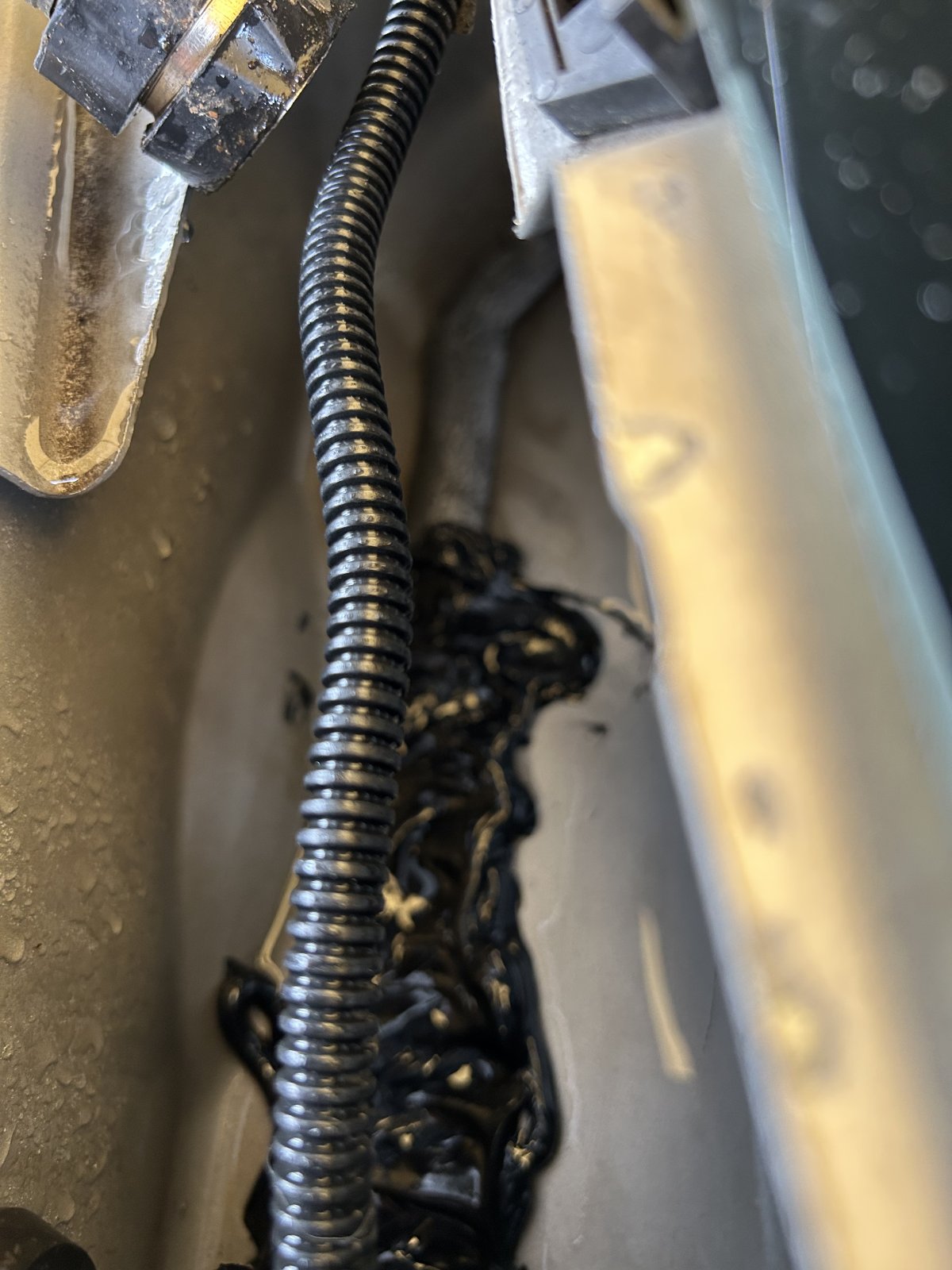

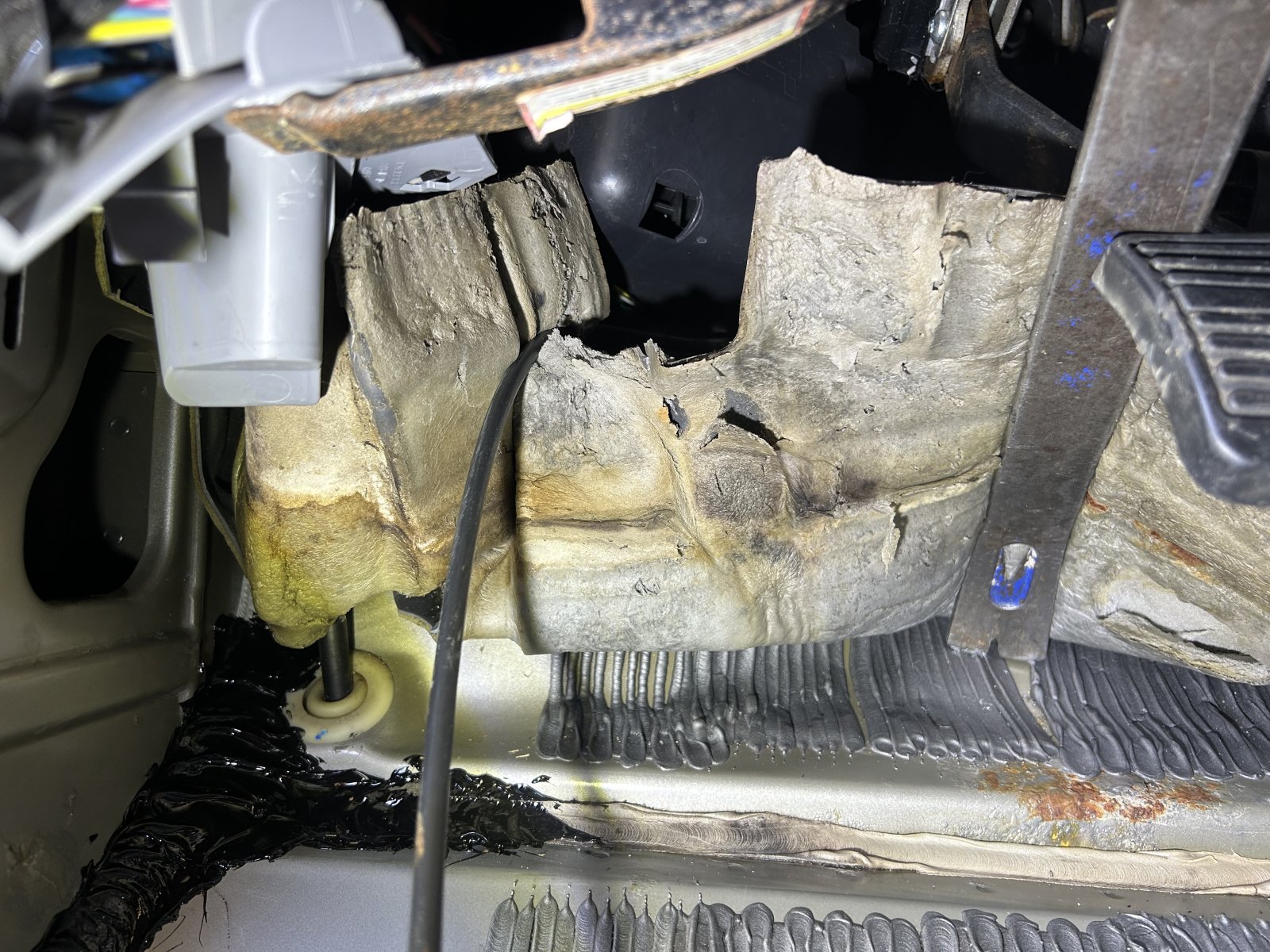

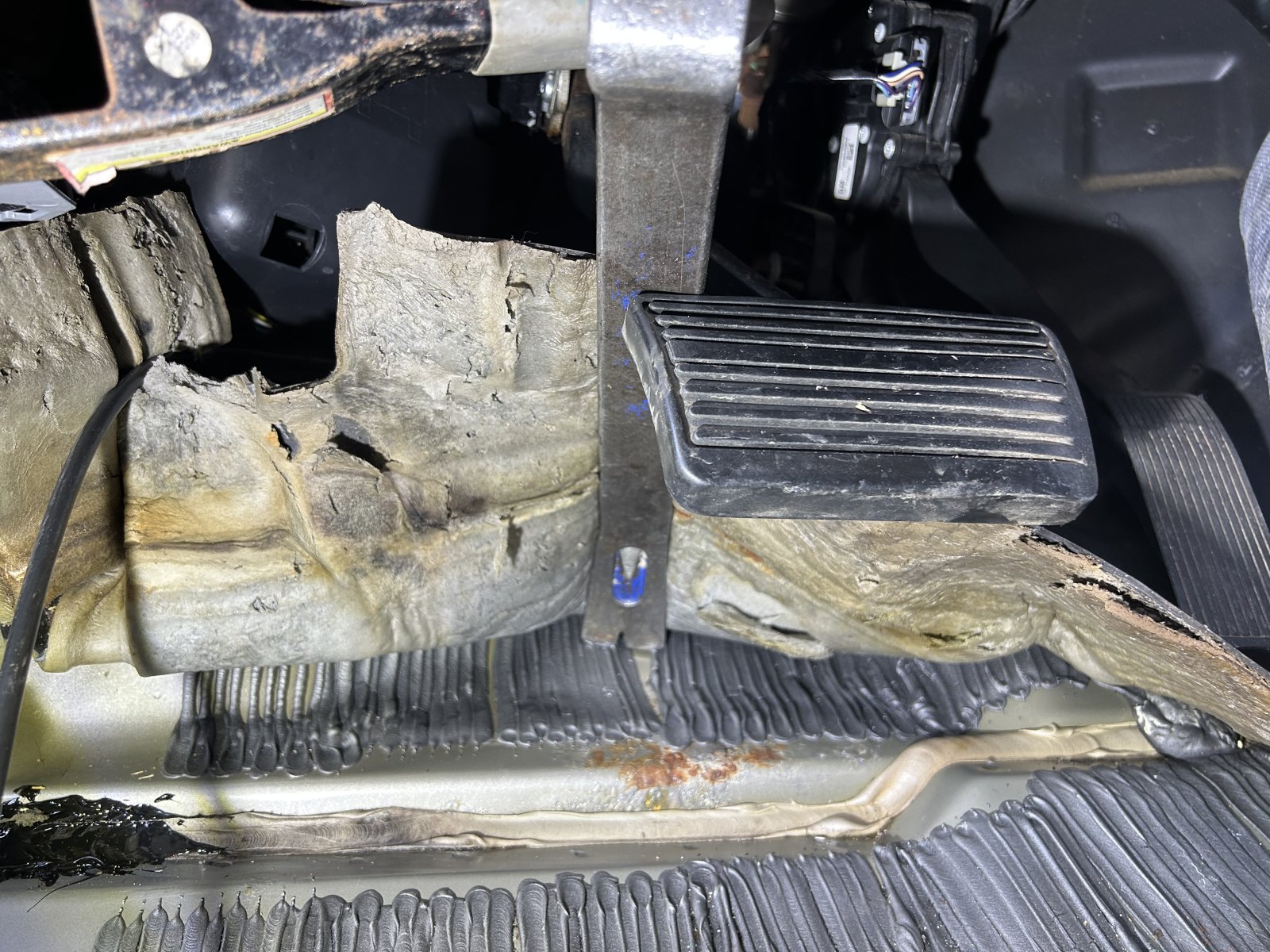

Water leak update. I removed the wipers and cowl and propped up the carpet and pad so I could see the water coming in. I started by applying water at the far outside of the cowl by the fender. As soon as I put water inside the cowl, I could see it flowing out inside. It was running down and out the flapper that’s inside there but also coming inside. I figured it was that seam in the cowl. It runs all the way side to side and down inside a ways. The part of the sealer that is squished out seems to be a foam material. I cut that out and used a polyurethane seam sealer and let it dry a day. That area is super hard to access without laying across the engine so it’s not a pretty job.

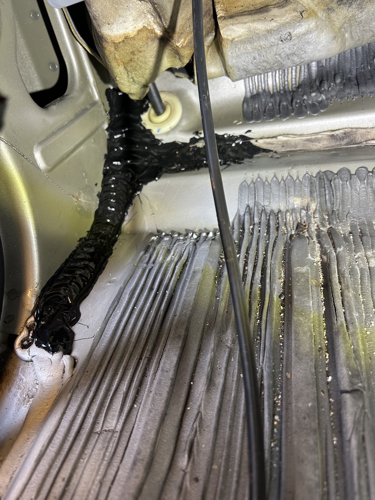

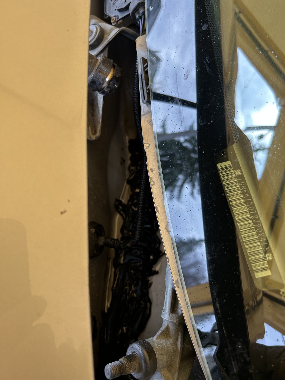

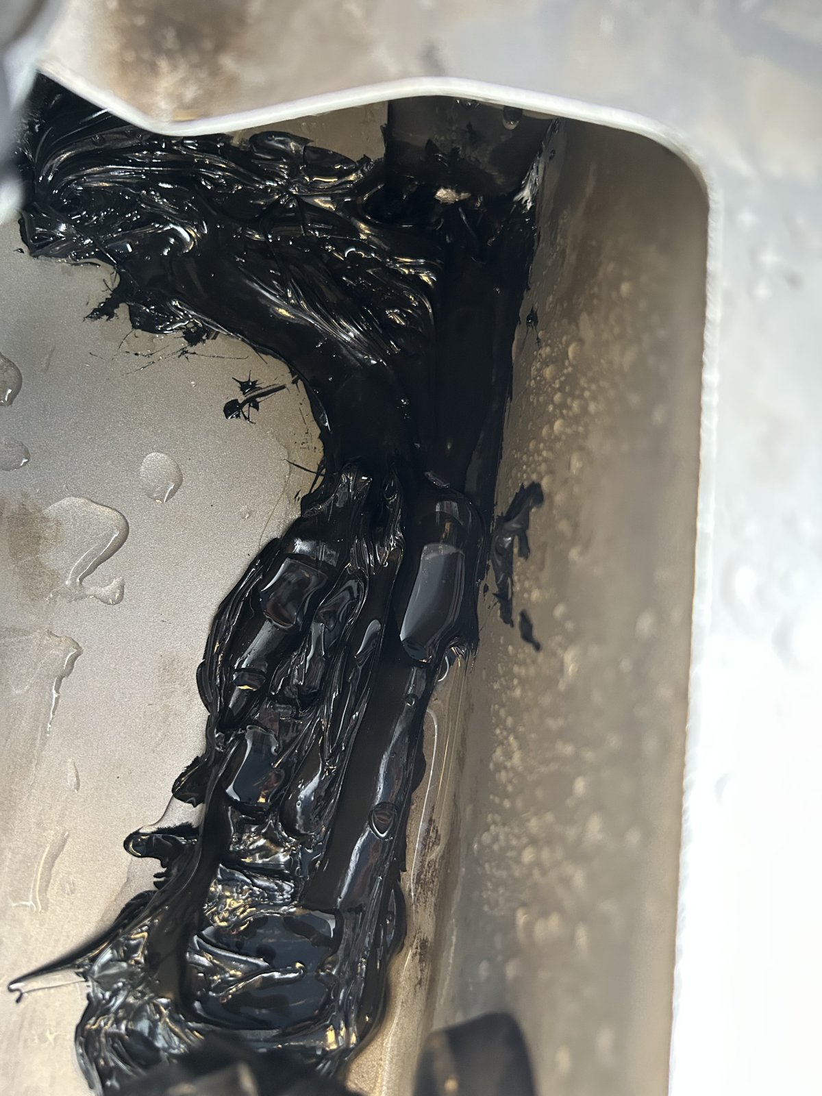

Today I water tested and thought I had it. It didn’t leak for quite awhile as I started slowly again, starting by just applying it near the fender , inside the cowl. I slowly worked towards the middle of the cowl and kept stopping and going inside looking. After 10 minutes or so I saw a stream inside at the far left corner of the floorboard where it meets the left kick panel sheet metal. I couldn’t get the rubber pad to lift up until I figured out to remove the hood latch duh. So now I’ve got that rubber pad that’s still wet pulled up and I can see where there’s a couple of seams there and right where there’s this dark dirty hole I could watch the water come through. At least I think it was coming through there. I did not cut the factory sealer out- that stuff is super tough. I opted to clean it all with alcohol and scotch brite and seal over the top. I will test again tomorrow. :rolleyes:

Today I water tested and thought I had it. It didn’t leak for quite awhile as I started slowly again, starting by just applying it near the fender , inside the cowl. I slowly worked towards the middle of the cowl and kept stopping and going inside looking. After 10 minutes or so I saw a stream inside at the far left corner of the floorboard where it meets the left kick panel sheet metal. I couldn’t get the rubber pad to lift up until I figured out to remove the hood latch duh. So now I’ve got that rubber pad that’s still wet pulled up and I can see where there’s a couple of seams there and right where there’s this dark dirty hole I could watch the water come through. At least I think it was coming through there. I did not cut the factory sealer out- that stuff is super tough. I opted to clean it all with alcohol and scotch brite and seal over the top. I will test again tomorrow. :rolleyes:View attachment 472360View attachment 472361View attachment 472362View attachment 472363View attachment 472364
Damn. I am watching this. I have the same leak. It's a ***** to figure out.
