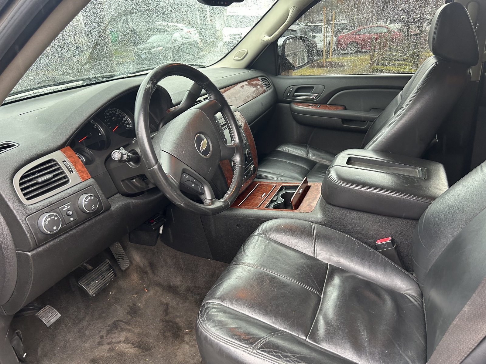

Yesterday I did a second row seat swap from my buckets go a 60/40 bench seat for my 115 lb dog Kinjo. He was used to that in The Beast so when I started driving this one he managed but he was not comfortable. I kept looking for a used set but finally found a guy to trade. It’s difficult at this age of truck to find decent seats that are not only in great shape but are black leather, heated and power fold and the other person is happy with yours and willing to meet up and swap them out. It finally worked out. It’s Kinjo’s Christmas present and he is super happy. Today he was riding with his whole body laying on it and his front feet on the carpet, with a big smile. Win win.

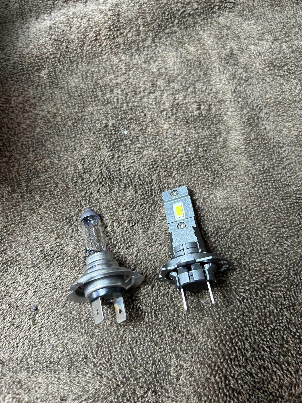

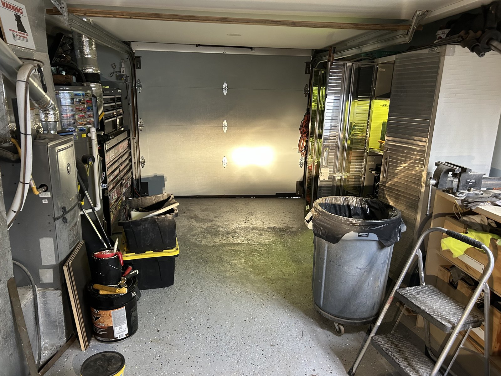

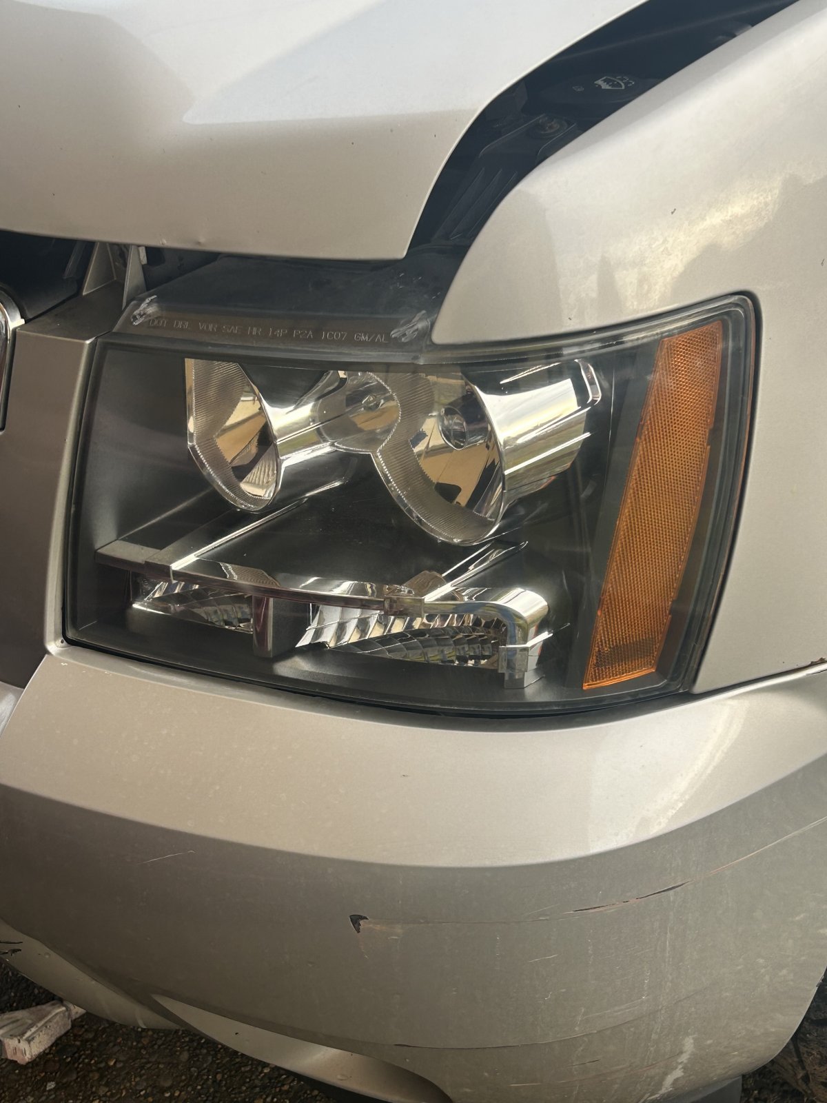

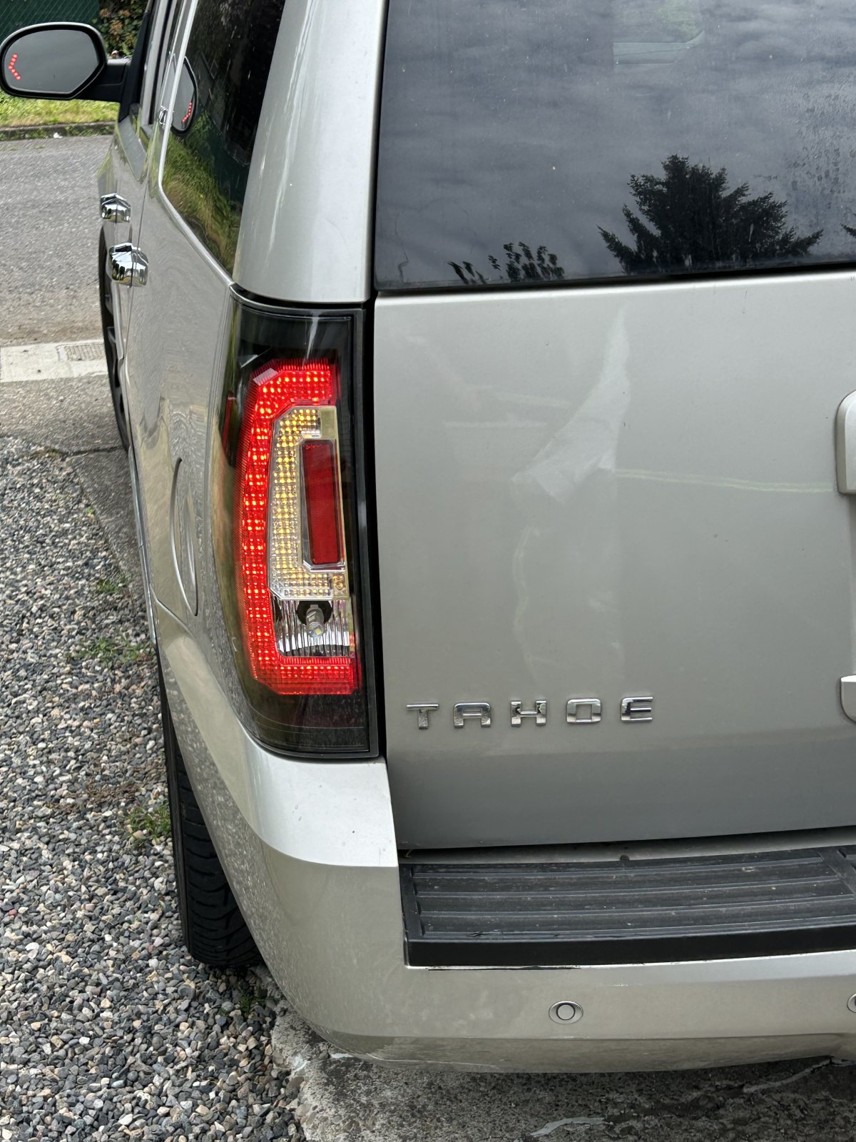

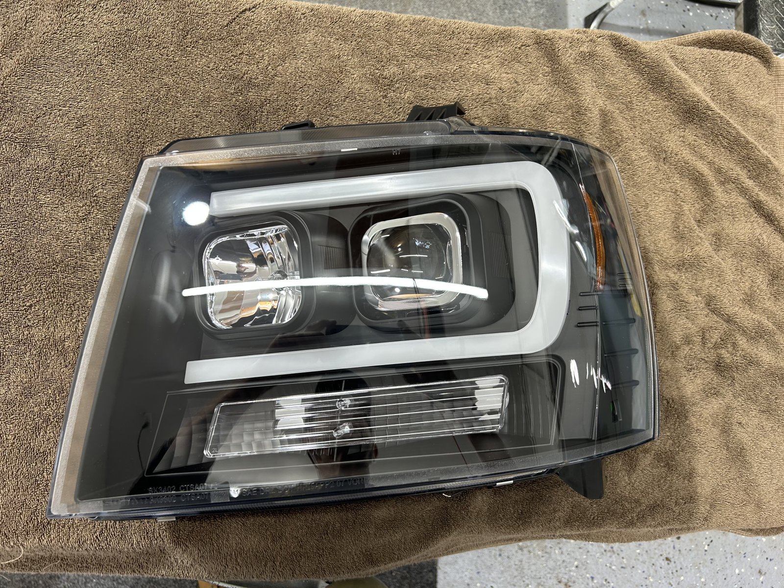

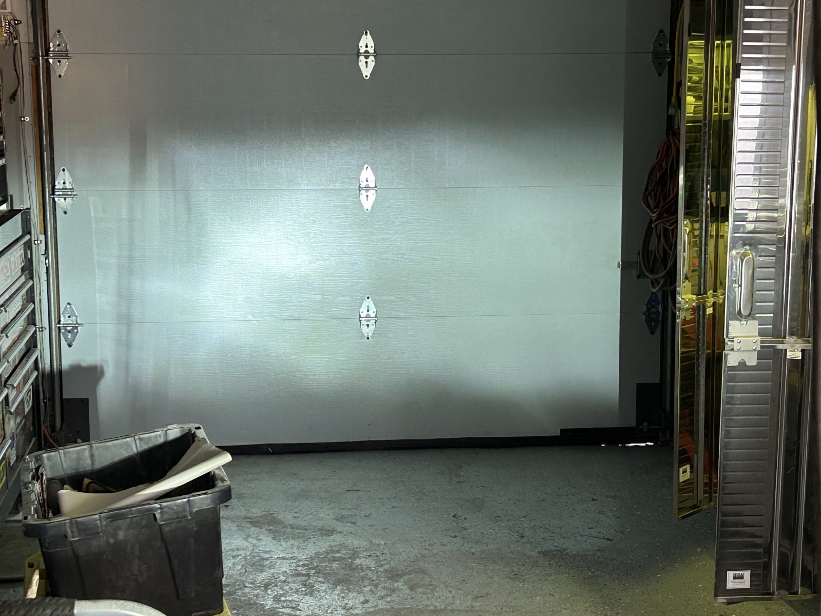

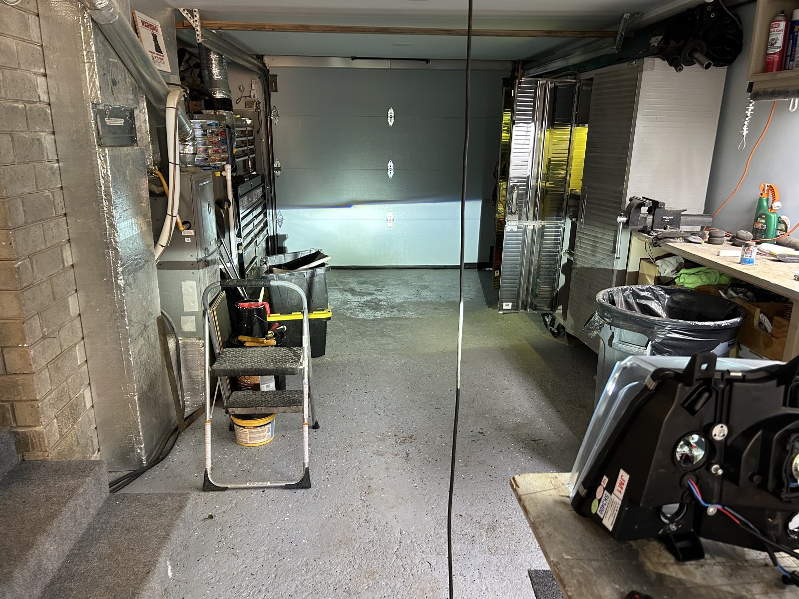

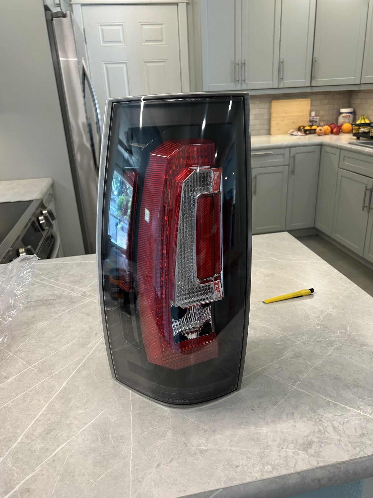

I had decided to spend some money on it by now so I ordered some of Spyders best head and tail lights. I swapped in LED bulbs into the low beam projectors with great results, see the cutoff lines in the bench test. Those are H7. The high beams are H1 and use reflectors and ship with halogens. I tried several LED bulbs and all end up orienting the bolt at a 45 degree angle and you can see the bench test. The white light is the LED and the yellow is the halogen. The LED at the 45 degrees throws a scattered beam, so I left the halogens in the high beams. There are H1 LED bulbs with adjustable collars for about $125-up. No thanks.View attachment 461675View attachment 461676View attachment 461677View attachment 461678View attachment 461679View attachment 461680View attachment 461681View attachment 461682View attachment 461683
Got a link for those H7 LED's?

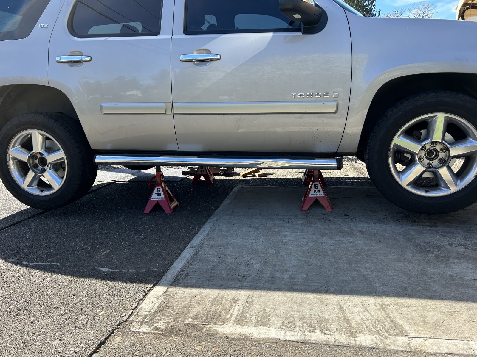

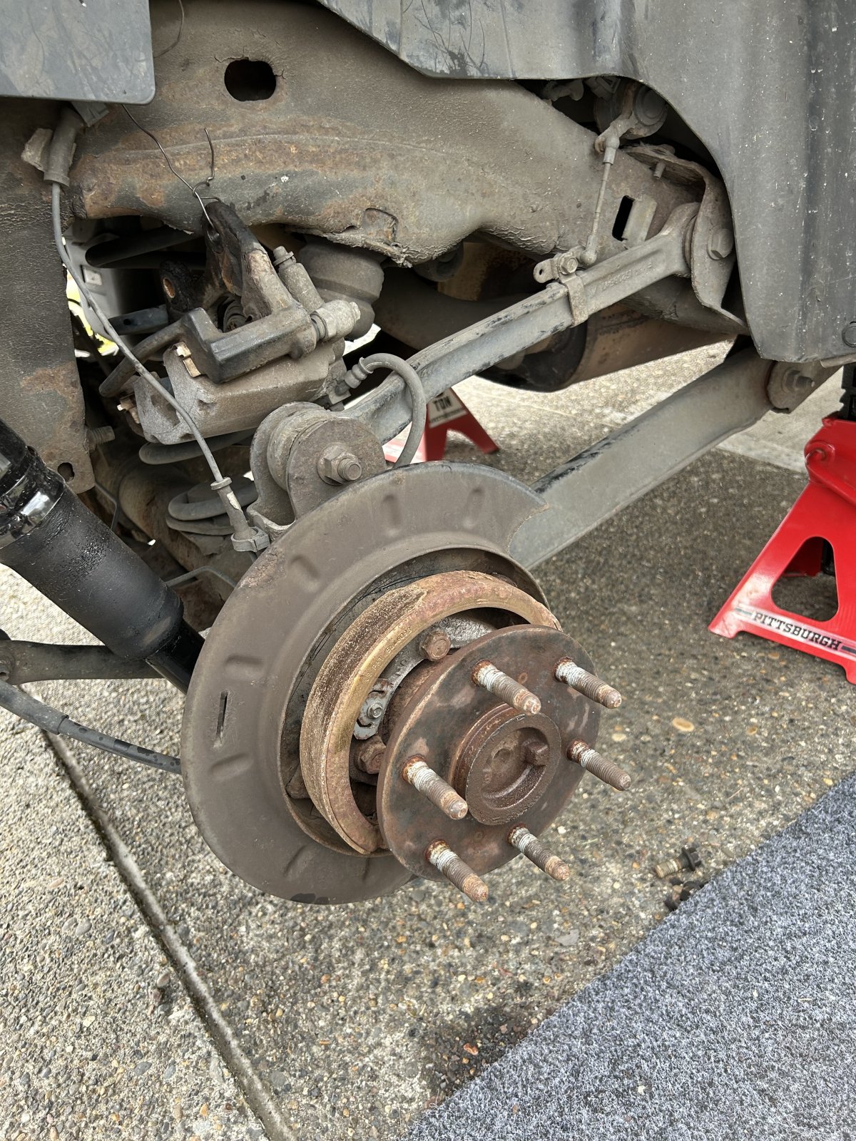

It’s still sitting under cover, waiting. I think I’m going to have it towed to a shop to diagnose it. A lift is needed in order to figure it out. I have to jack it up, do one thing like remove the front prop shaft, lower it, try to drive it, see what’s it does, jack it back up,etc etc and I can’t do that anymore than I’ve already done. And all it did was confuse me more. I must have tried 4 different combinations and sometimes it would drive a little ways and then slowly bind up until it wouldn’t move. I still don’t know if it’s the transfer case or the front or rear diff. 95% sure it’s not the transmission. The other thing I’m considering is buying a used transfer case and swapping it in, which will have to wait until spring because no shop. Either way I’m not in a hurry. I did start it up the other day, and yesterday I put a new car cover on it; the one from Amazon got tore from our wind event here (30-40 mph gusts for a week ) and they sent a new one since it had a 12 month replacement warranty. I tie my carport to the house in these events lol.
