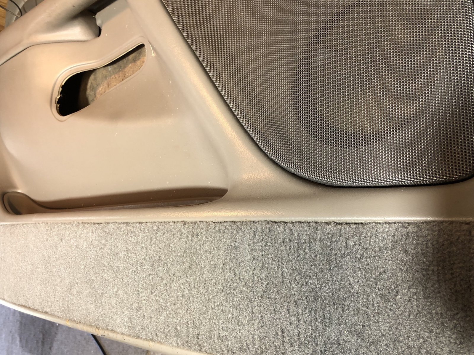

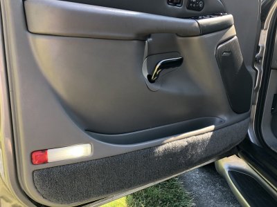

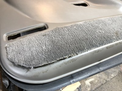

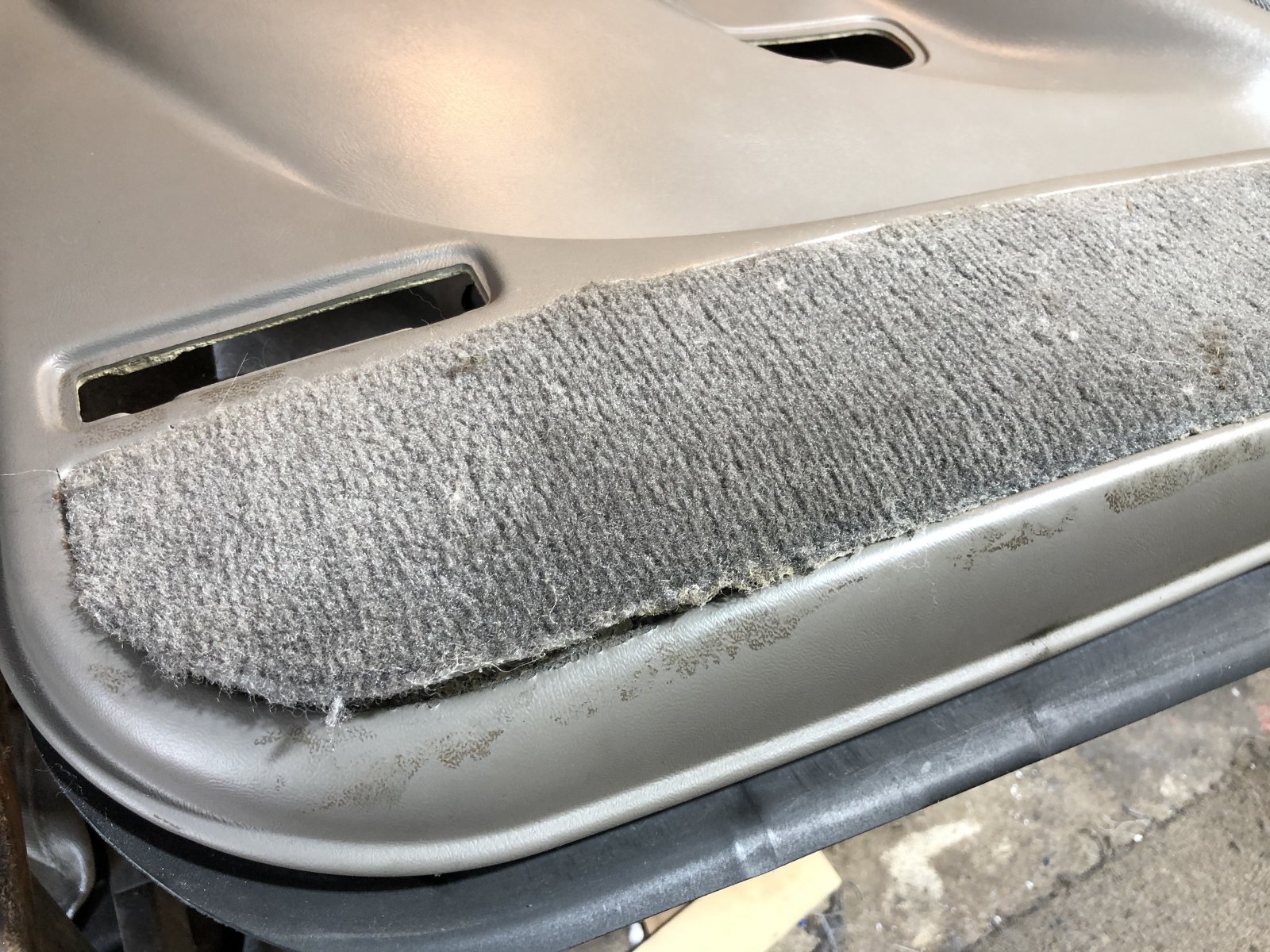

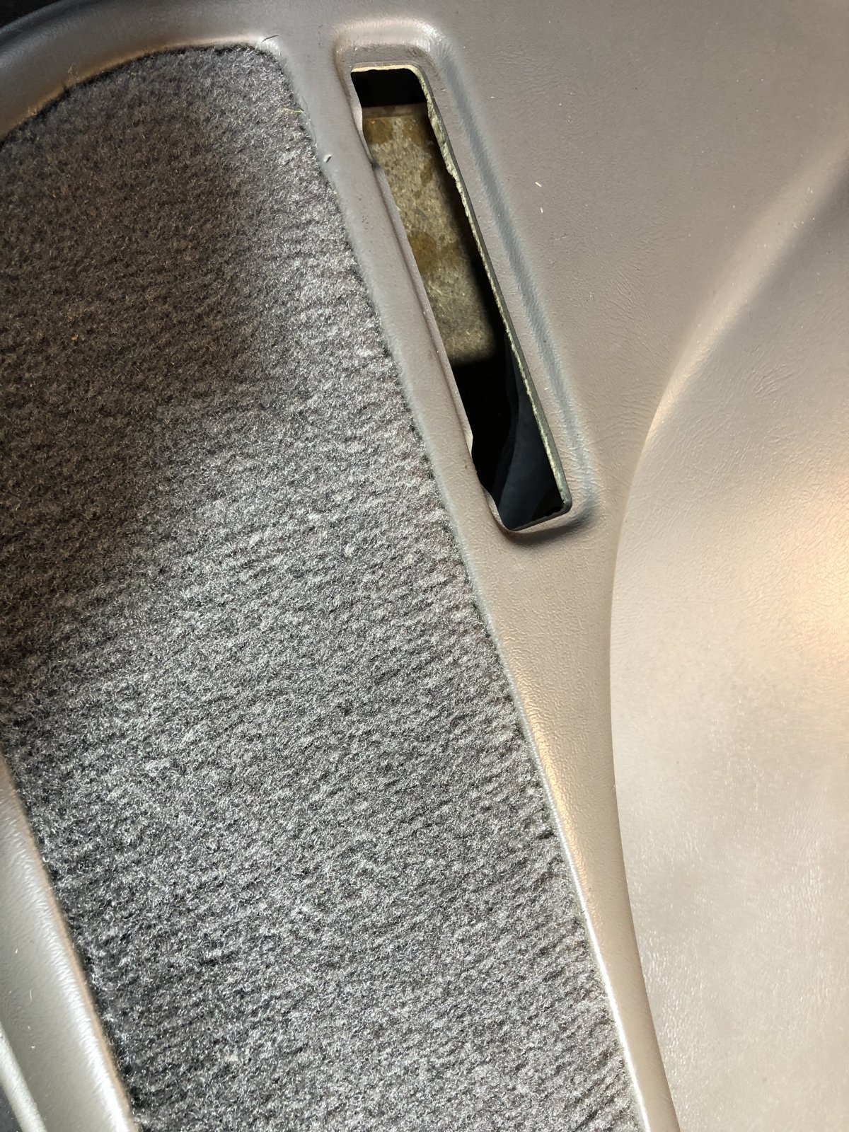

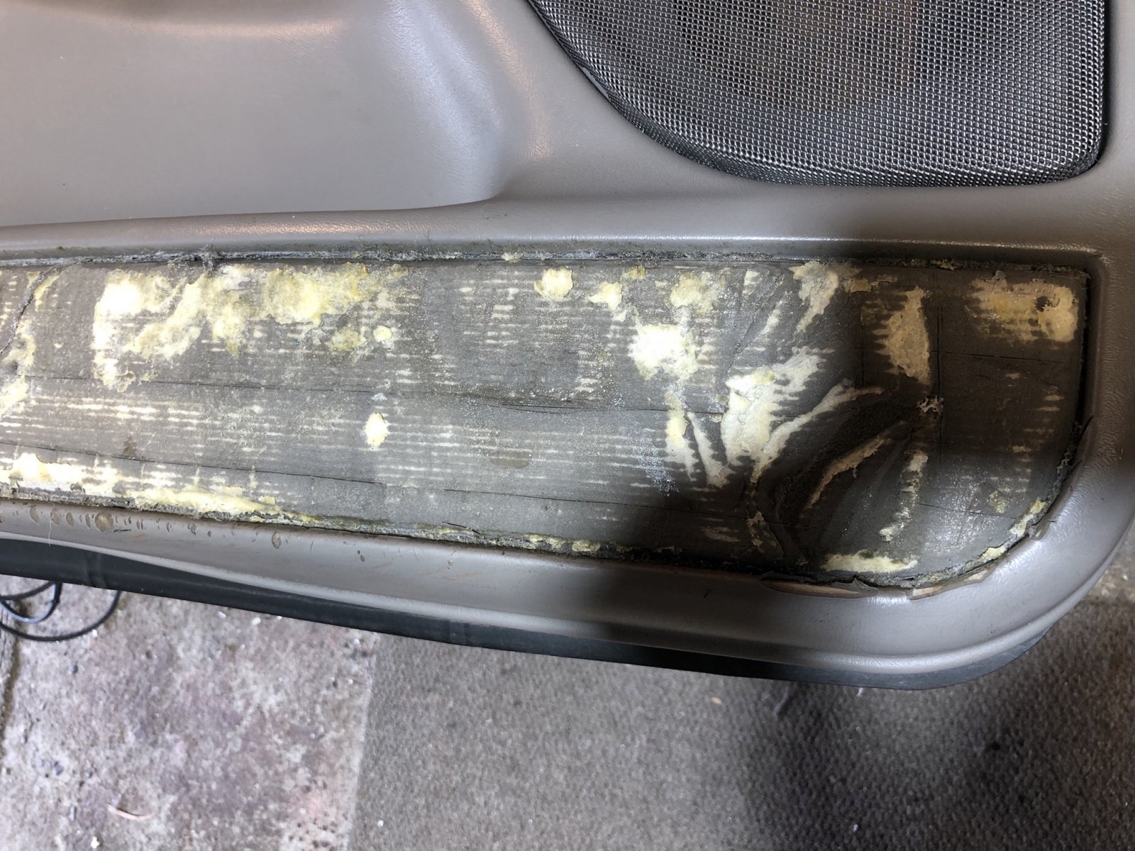

Long ago, when I replaced the carpet, I made the mistake of deciding to strip the carpet from the bottom of the front door panels and replace it with matching carpet I ordered with the kit. If you’ve ever thought of doing this, don’t. The factory stuff is foam backed and bonded to the door panel and it’s about impossible to strip it and get the surface to accept new stuff. Anyway it’s been peeling ever since I did this. I used 3M Super 77 spray adhesive. I decided to replace the carpet again and used the same stuff but this time I cleaned everything with lacquer thinner. It’s been on a few days in hot weather and the passenger side started coming off already. Anybody know something stronger? I’m considering using construction adhesive but not sure. It’s frustrating. I did a damn near perfect job and still having issues.

I assume you sprayed both pieces and let them tack up 1st. That stuff usually never fails. I bet that construction adhesive wouldn't give up the ghost. Gonna do liquid nails? If you use that, just spread it out thin so once it dries it'll dry flat and not bumpy.

Yeah I sprayed both pieces and let them sit for 10 minutes, it said max was 15 and I wanted to be sure it was ready. I ordered 3M Industrial High Strength 90. I’ll give it a try, and if it fails I’ll use construction adhesive. The 90 is supposed to be way stronger than the 77.

Does the glue pull off the door skin or off the carpet backing? You may need to find a compatible glue that will bite i to that backing. Or, use something to prime it for adhesive.

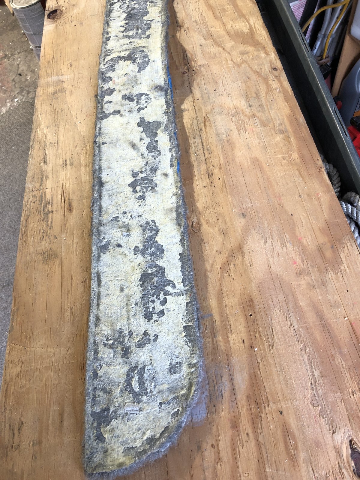

A little of both. I’m thinking it’s the heat since it seems to fail after a stretch of hot weather. The 90 is supposed to be better in heat. Here’s the first carpet I installed, I cut new pieces this last time again.
