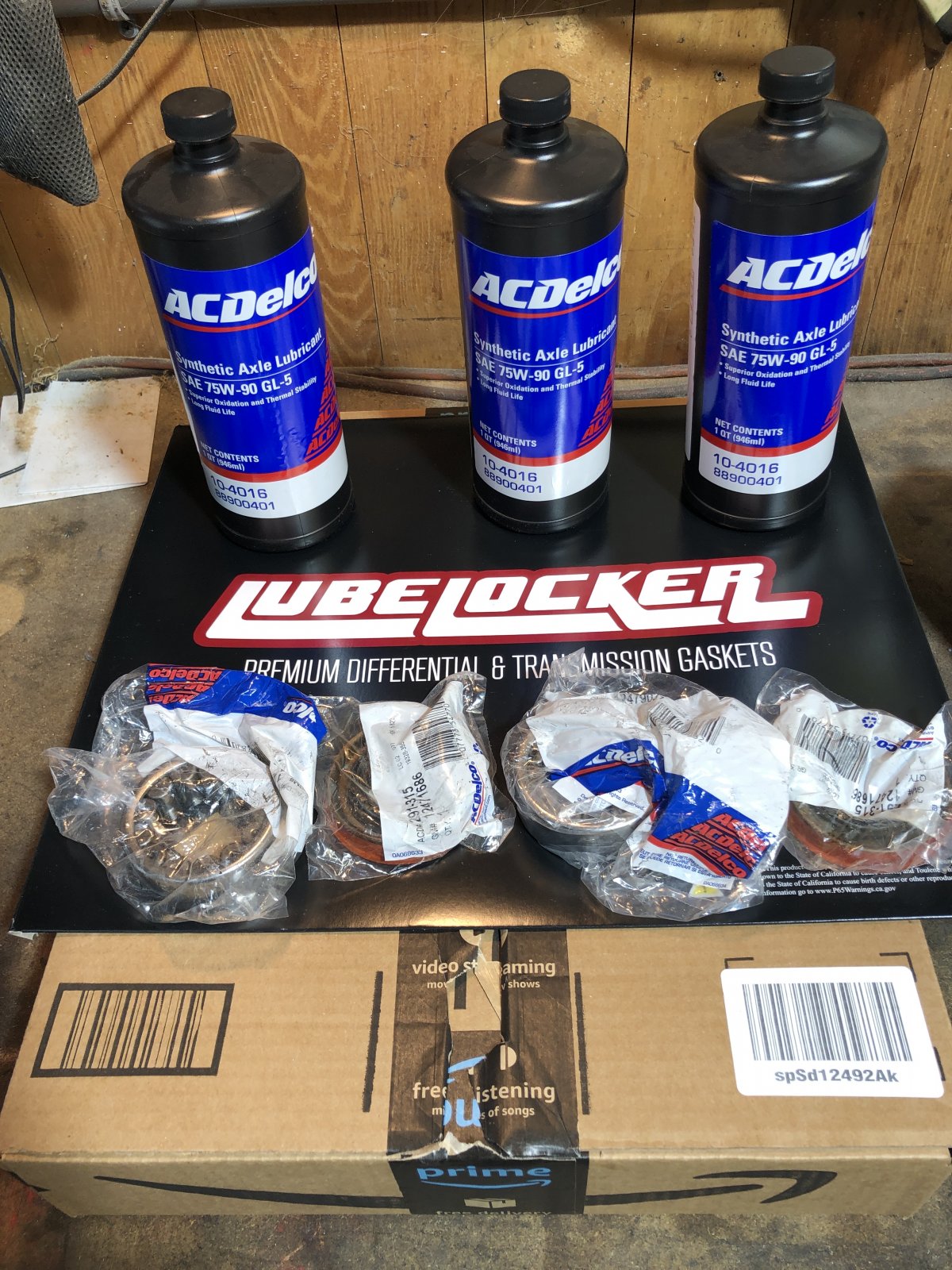

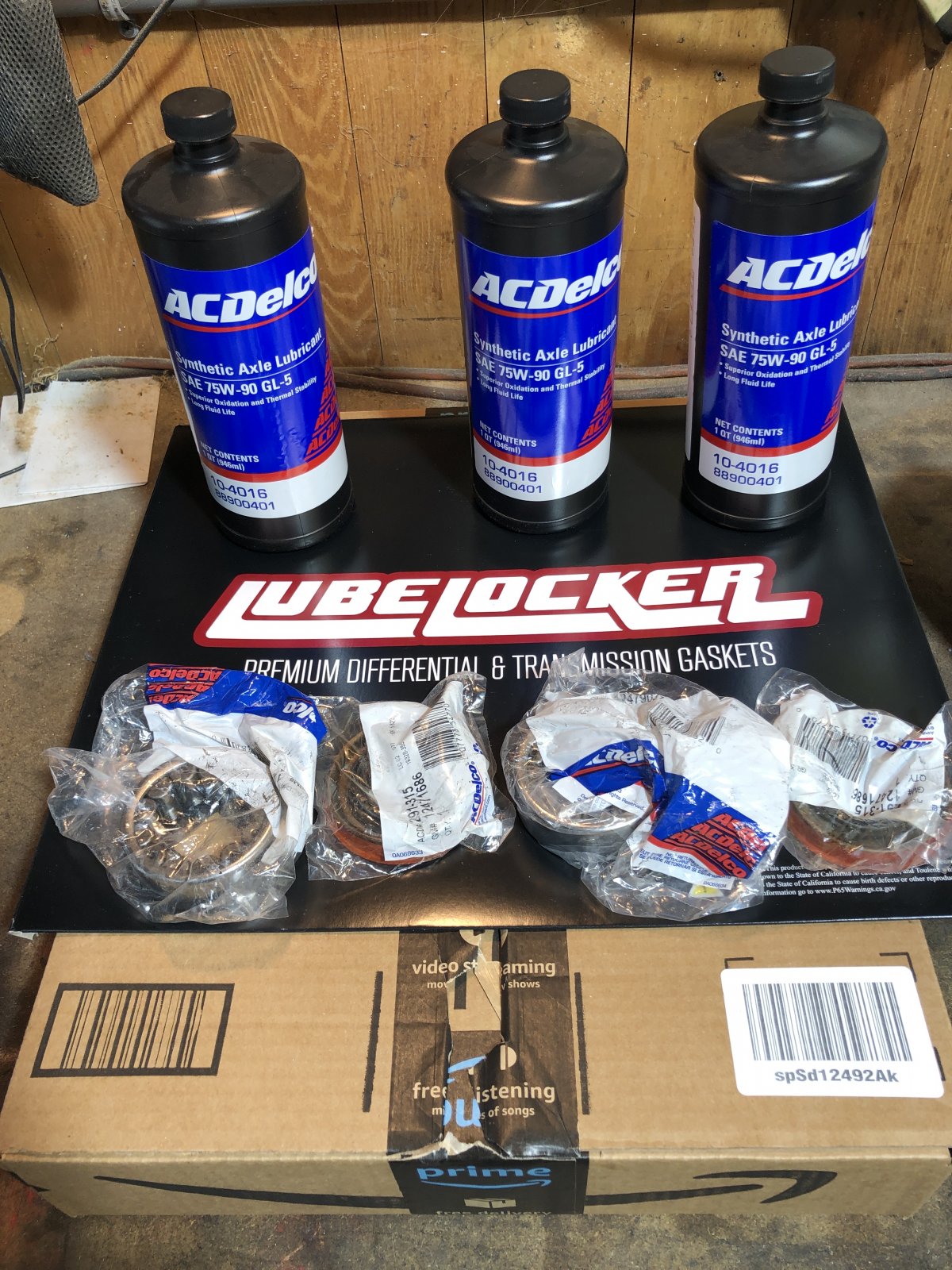

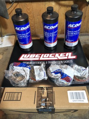

After watching @Doubeleive doing some maintenance and thinking about what I’ve replaced I realized the rear wheel bearings are original at 170k so I’m gonna replace them. This will also give me the chance to change out the Royal Purple gear oil with the ACDelco that’s specified. Thanks to @Jolly Roger for bringing this whole gear oil and Friction Modifier matter back into my psyche after I thought I had put fluid in that didn’t have any, only to find out the RP has it but it’s probably ok. :mad: I ordered ACDelco bearings, seals and gear oil and a Lube Locker gasket. There goes another $200 down the drain.
I don't ever see much about rear wheel bearings going out. But 170k is impressive especially with big wheels and big POWA!

It would be nice if you did a DIY on the bearings, I've been wanting to do them as well. I heard it's a lot of work.

labor wise in a shop yes because you have to take the wheels off, take the brakes off, drain and remove the rear diff fluid and cover, pull the carrier, remove the axle pins, remove the axles, then you can get to the bearings. PRAY the new seal's don't leak and put it all back together. (not sure if you can the leave the carrier and just pull the axles or not I haven't actually done it but that's basically how it goes) basically it's a bunch of labor and little parts.

I did one in my Silverado, it wasn’t too bad. Don’t need to pull the carrier, just axles. No need to pray the seals don’t leak just use an install tool or right size socket so they go in square. They’re not like the rear main- that’s the one you need to pray doesn’t leak since you have to install the transmission before you find out.

I say that because mine leaked and leaked again everytime I would have to go have it re-done, then of course it's warranty work so you have to wait a week to get scheduled in or drop it off and pick it up the next day or whatever.... I think the axle housing was worn because even with oem or very good aftermarket seals it still leaked, even tried new axles, still leaked. PIA

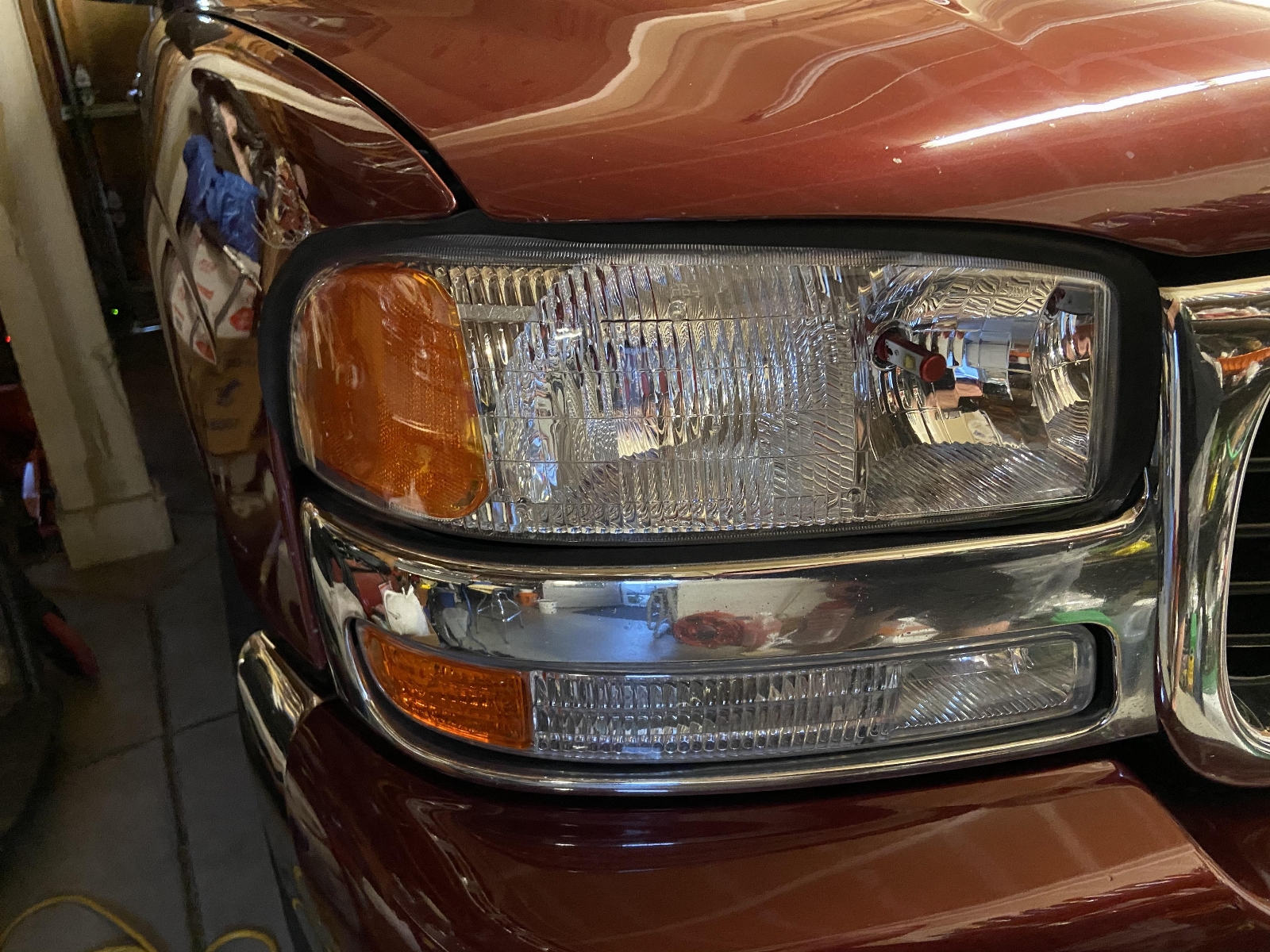

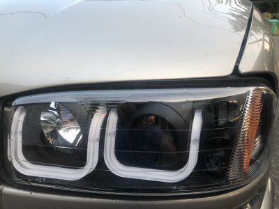

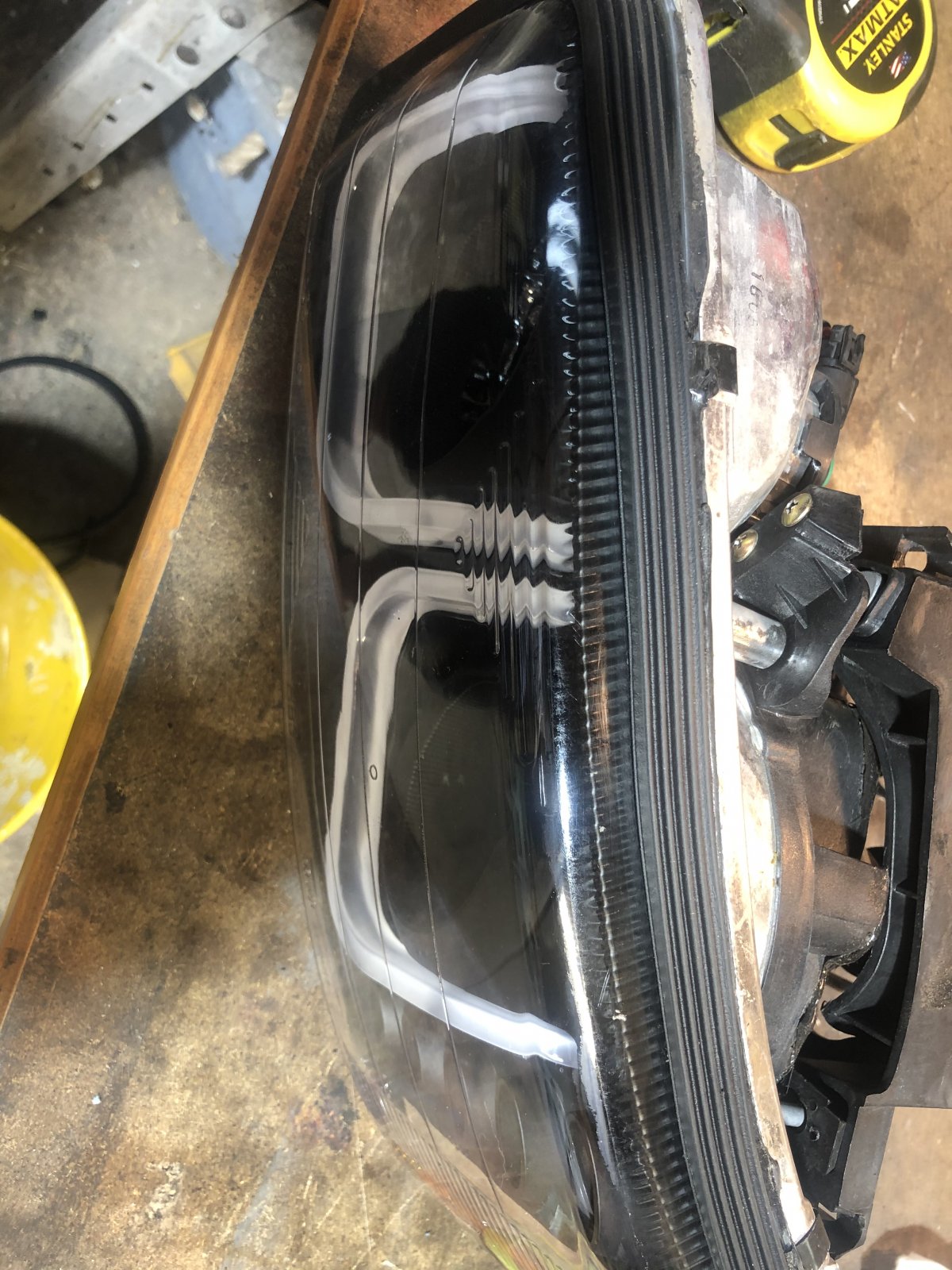

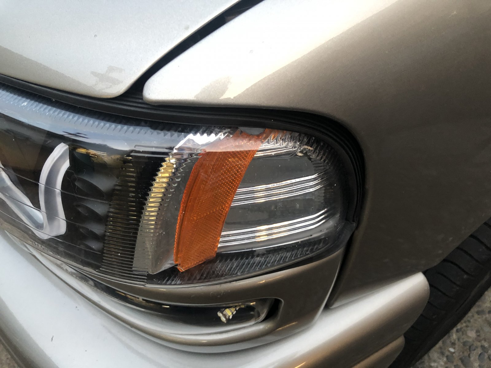

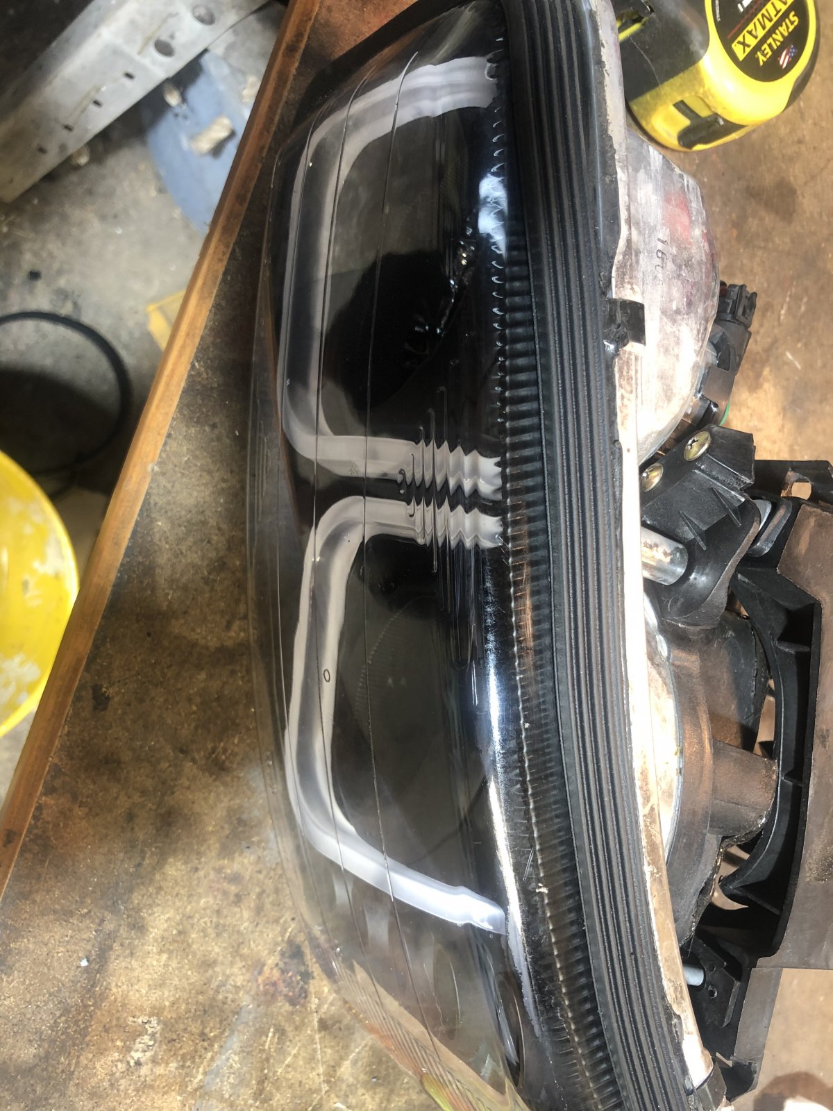

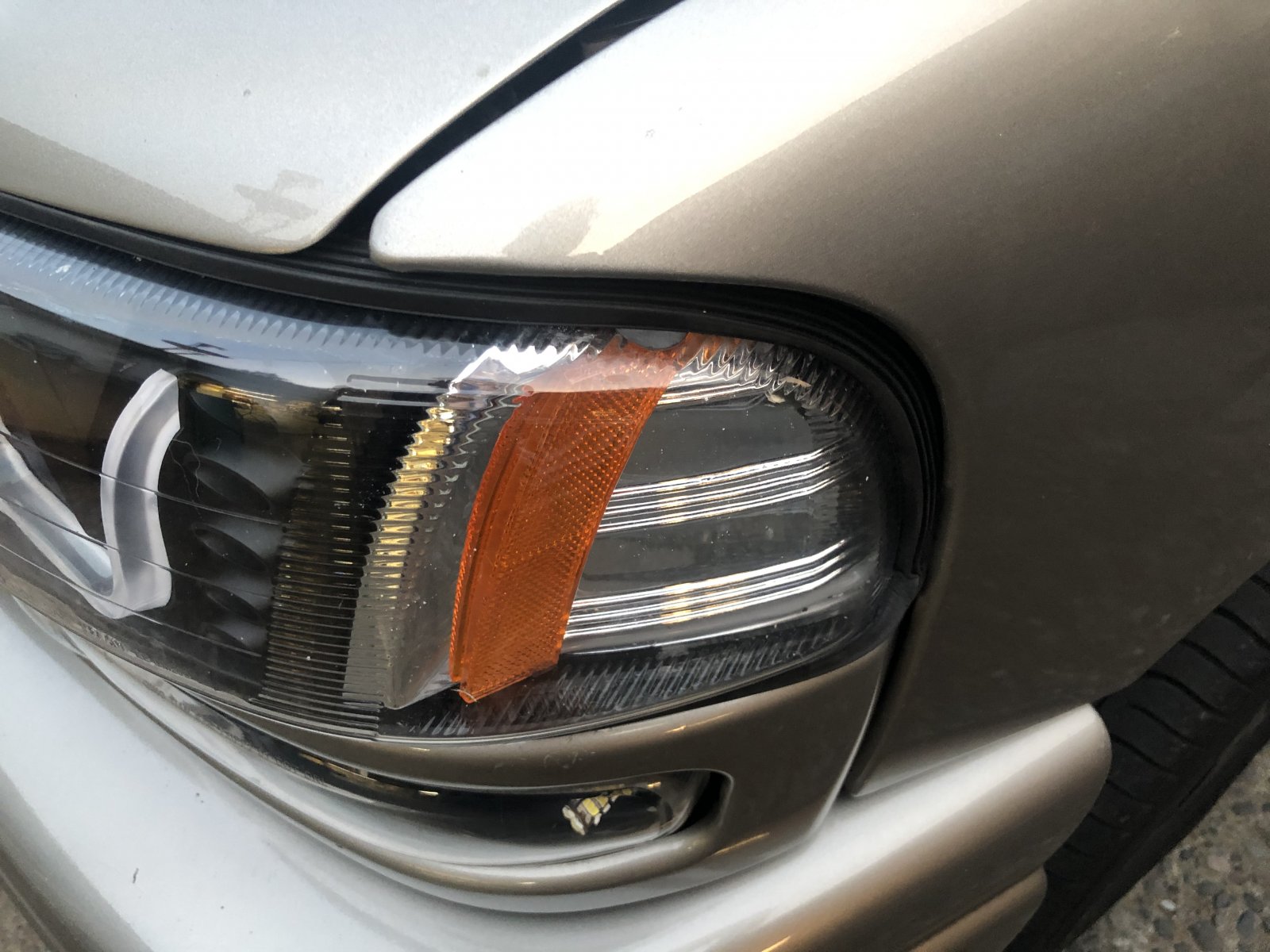

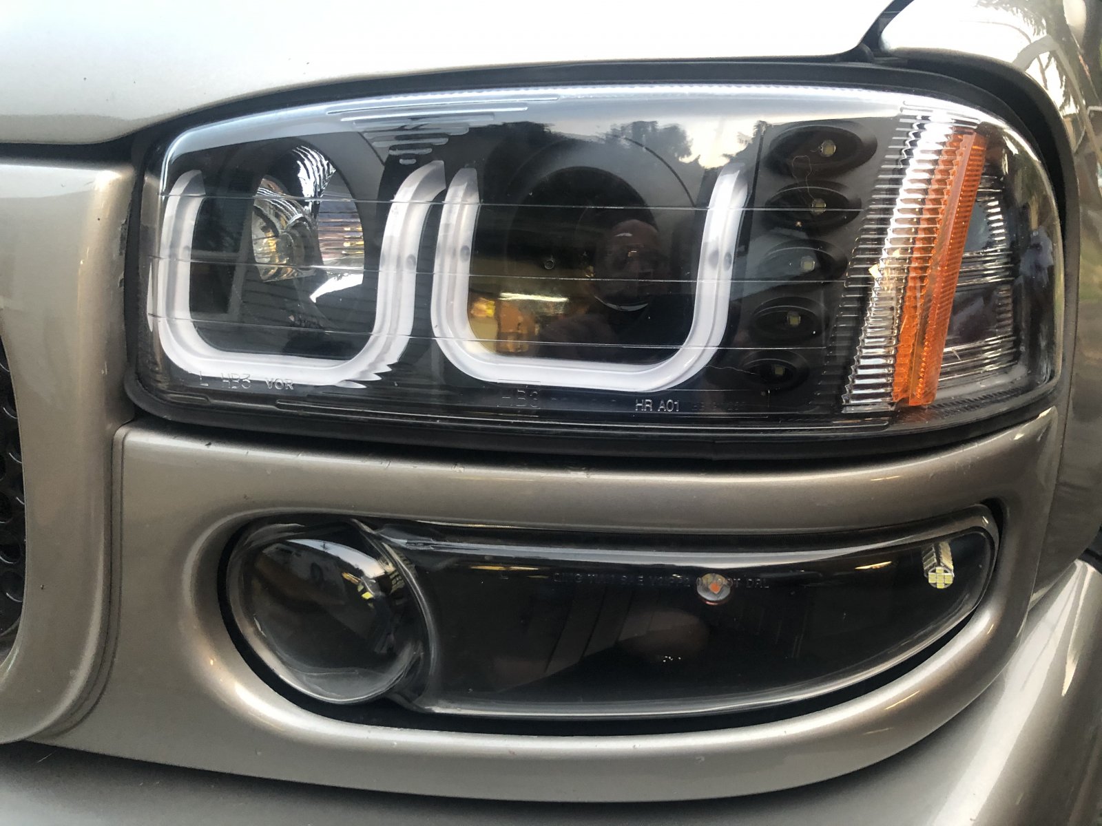

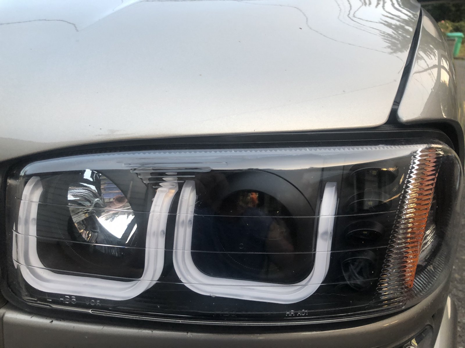

I finally got around to installing new rubber weatherstripping around my DS headlight. I took it off because the headlight was fogging so I needed to seal it with RTV last Winter. Anybody with a NBS Denali that hates the big gap around the headlights I highly suggest my mod. Here’s a link to the rubber. It just sticks on. I suggest marking the headlight where the hood line is with narrow masking tape so you know where you want the outside edge of the weatherstrip to end up and clean the area with alcohol before sticking it down.
M-D Building Products 1033 M-D 0... https://www.amazon.com/dp/B000I1QHA8?ref=ppx_pop_mob_ap_share

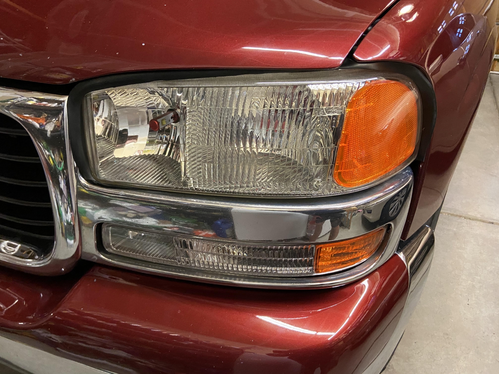

That’s a great idea! My OEM style lights came with a fairly decent rubber edge, but I think those would be much better, and not so visible..
52,949
I have. They don’t stay put.. this is one part of the benefit of using your method.. [emoji106][emoji16]
Are you trying to pull them out or push them in? You should be trying to push them in so they lay flat against the headlights, not be pulled out to the outside. If that makes sense.

Pushed them i
n a number of times. I think the gap is just too big for them to stay pushed in. I’ll add the weatherstrip. Already ordered it.
