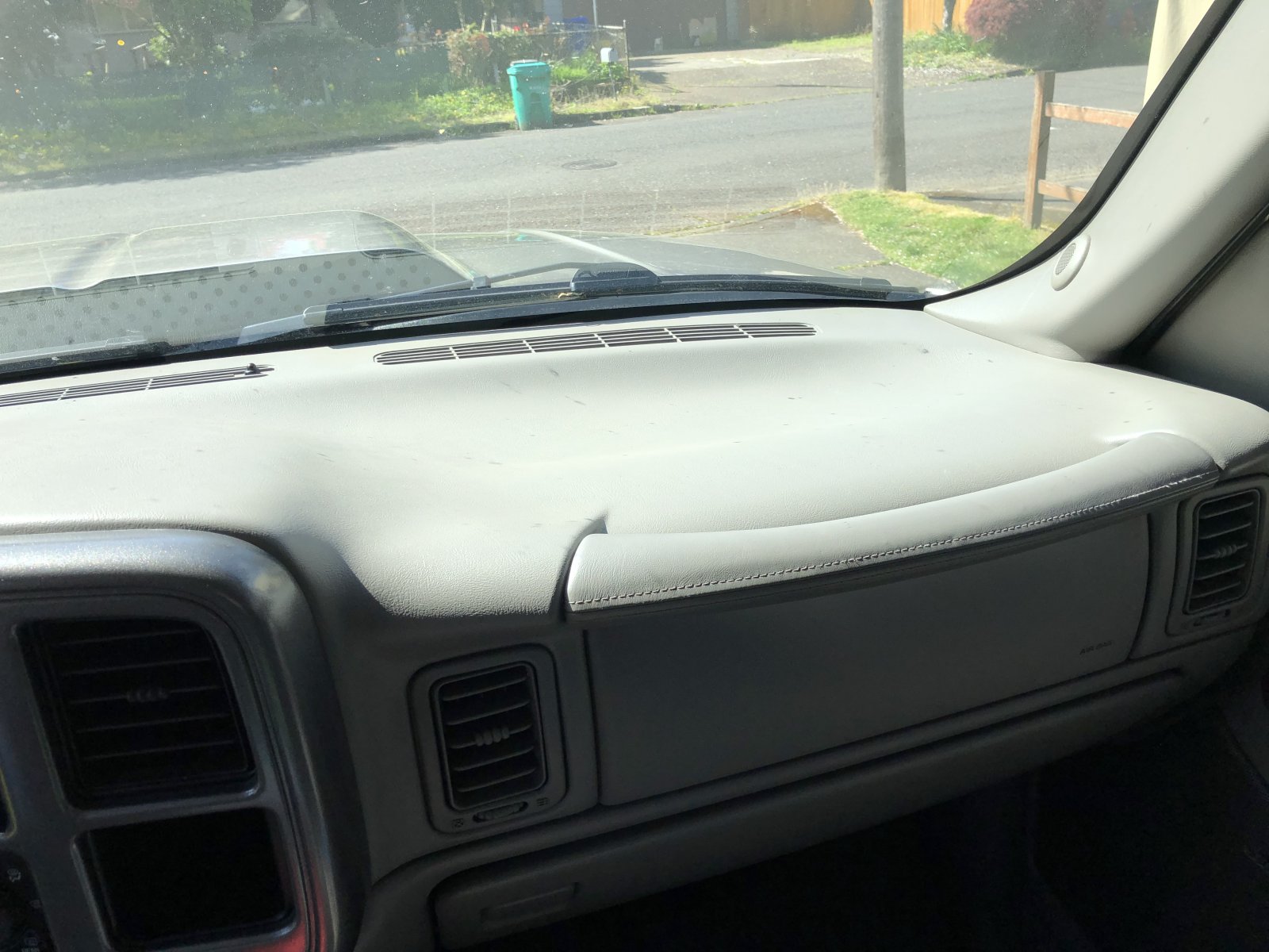

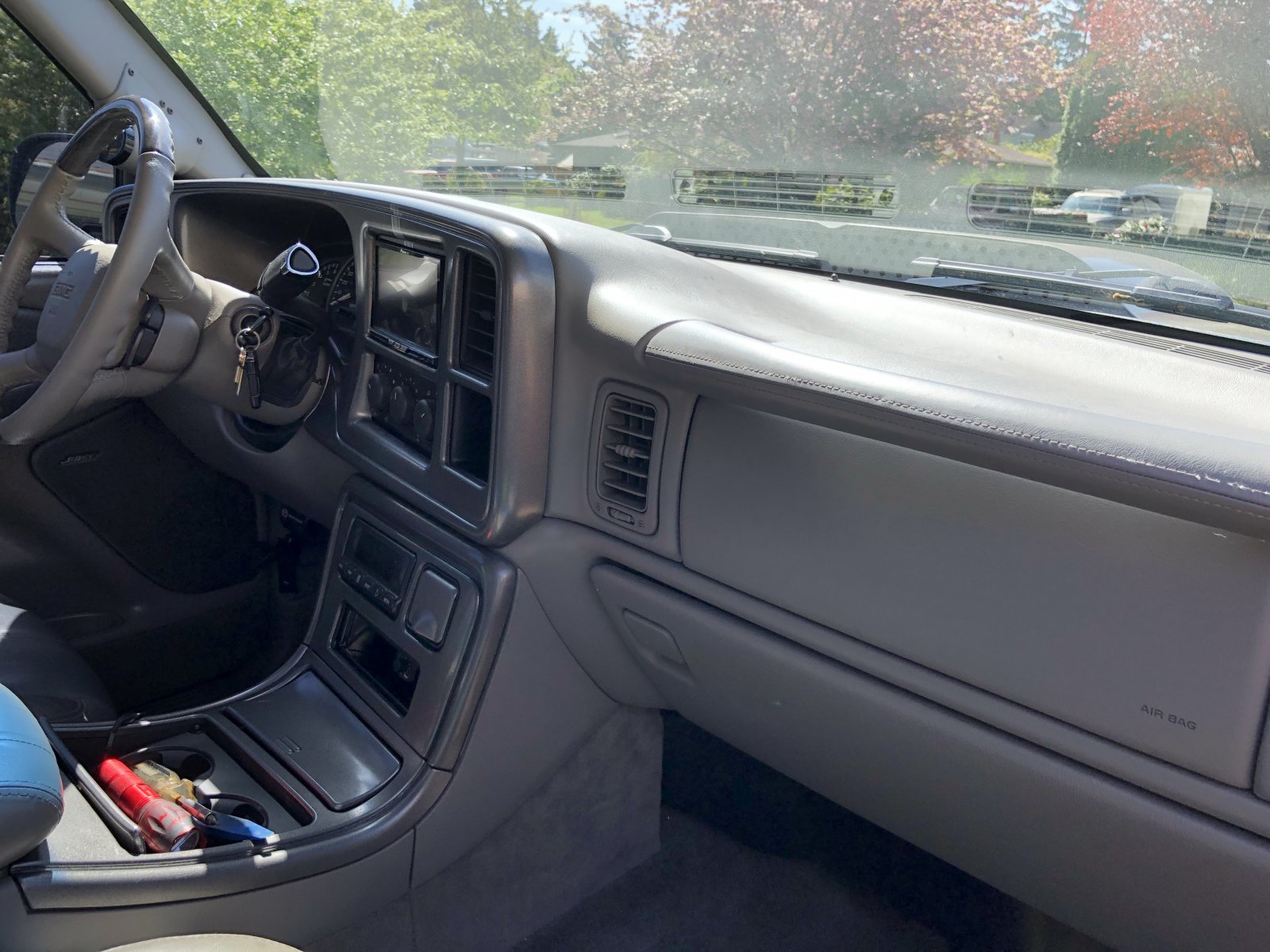

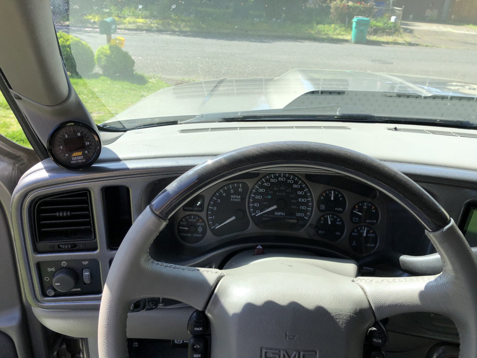

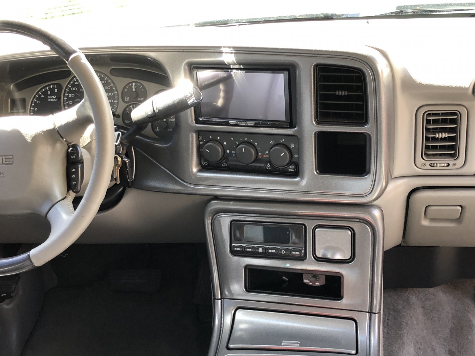

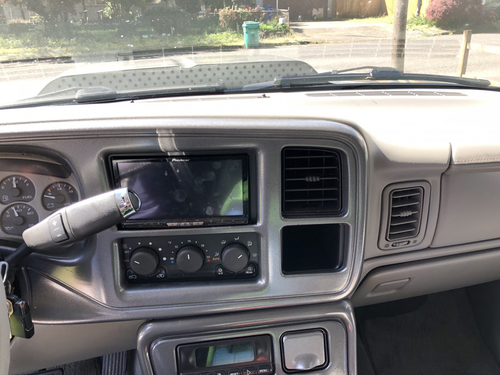

Finished the dash install this morning. Looks way better with fresh paint on the top and no more wood grain on the trim.
View attachment 245644 View attachment 245645 View attachment 245646 View attachment 245647 View attachment 245648
That dash looks great, exactly like it came from the factory. How does the paint hold up? My buddy just traded for an 03 silverado and the previous owner painted the dash red to match the truck. He wants to go back to factory. I have shared your photos with him, just curious about the longevity. Thanks for sharing.
52,949
The first time it was 3 years and it only chipped a bit around where the main bezel touched it. I’m not sure why it did that but I had pulled and installed that piece a dozen times so that might be why. So overall it lasted good.

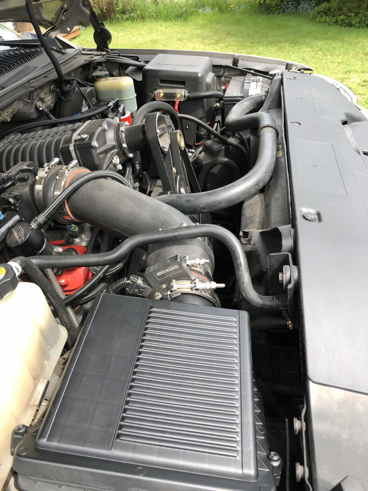

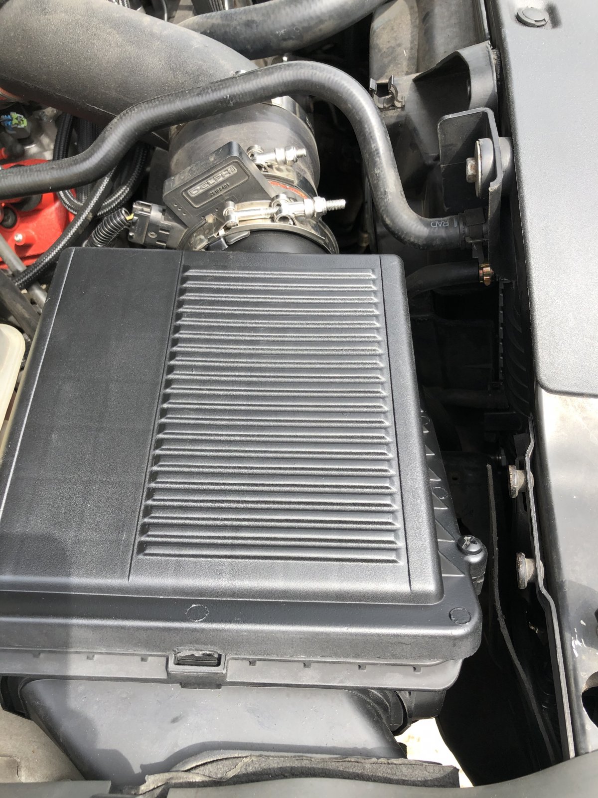

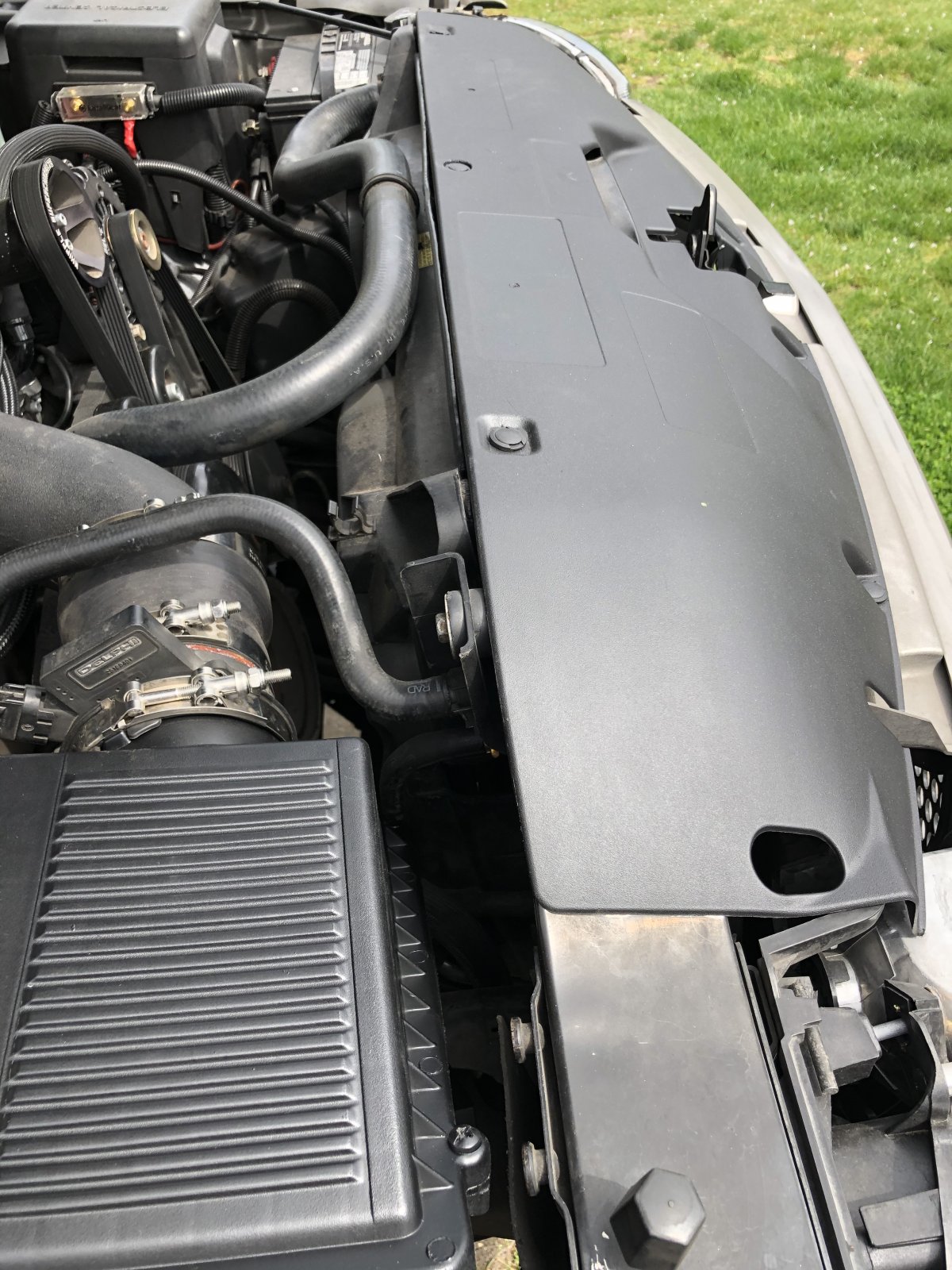

I removed all labels from the core support cover and the new used air box I bought from @reedal, repainted them and reinstalled them. I think they look a lot better. My air box was damaged, a couple of the screws that hold the top on had broken tabs and the mounts holding the base to the truck were broken. Never mind the dirty engine bay, I don’t want to wash it while the trans is out and the electrical connectors are hanging.

Am I next in line for you to paint mines up? Lol
