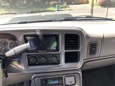

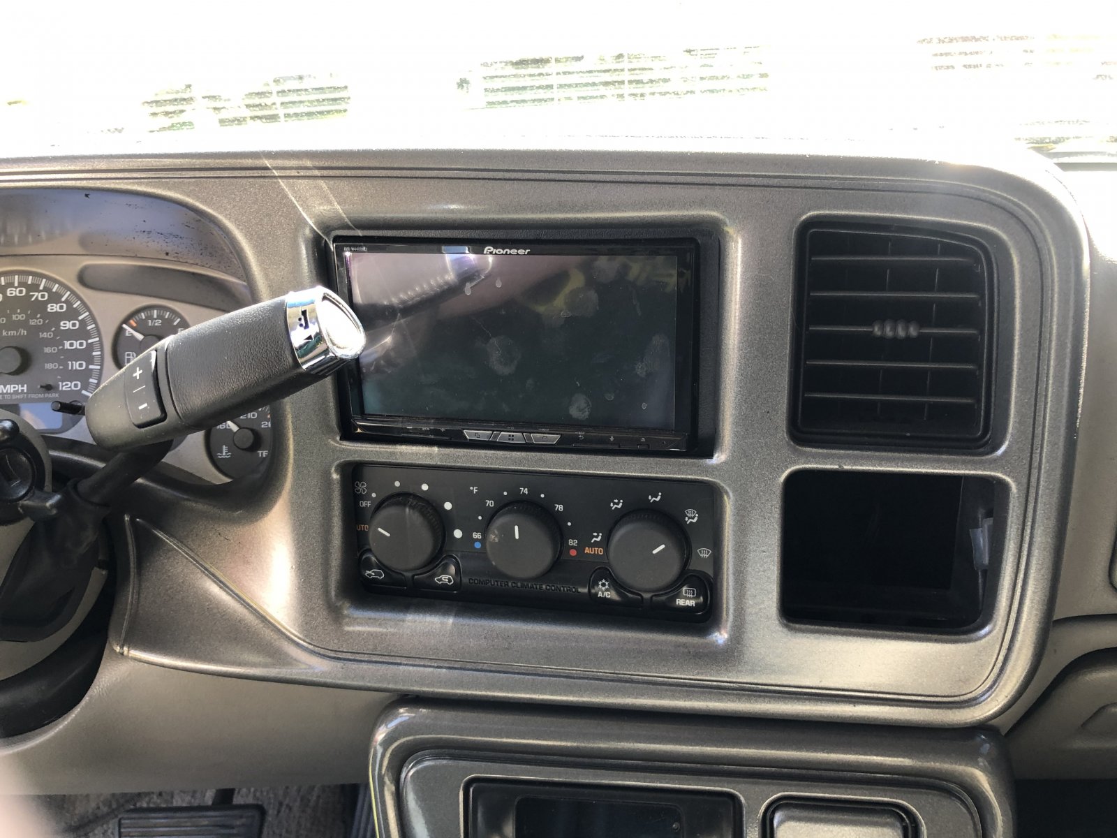

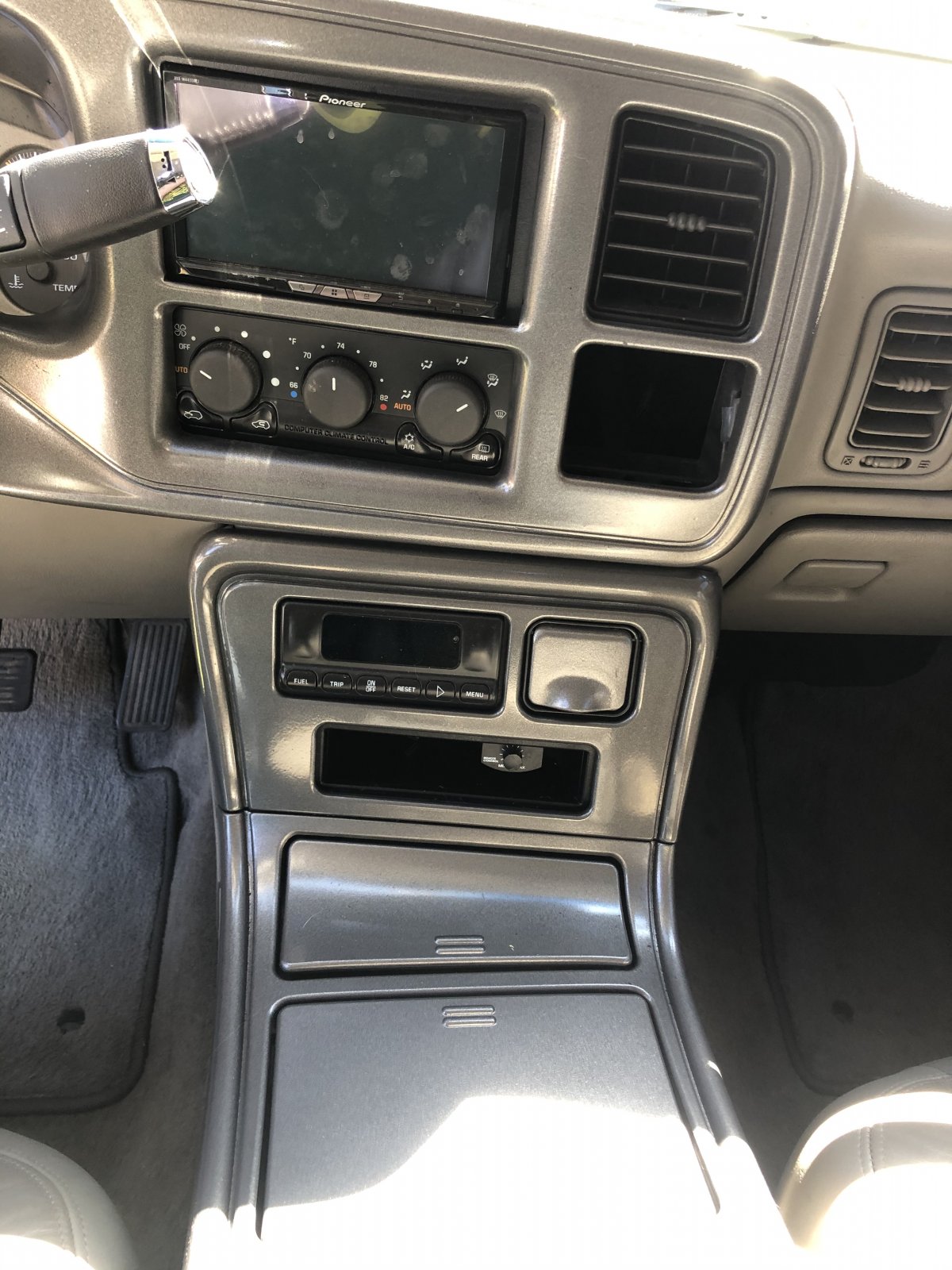

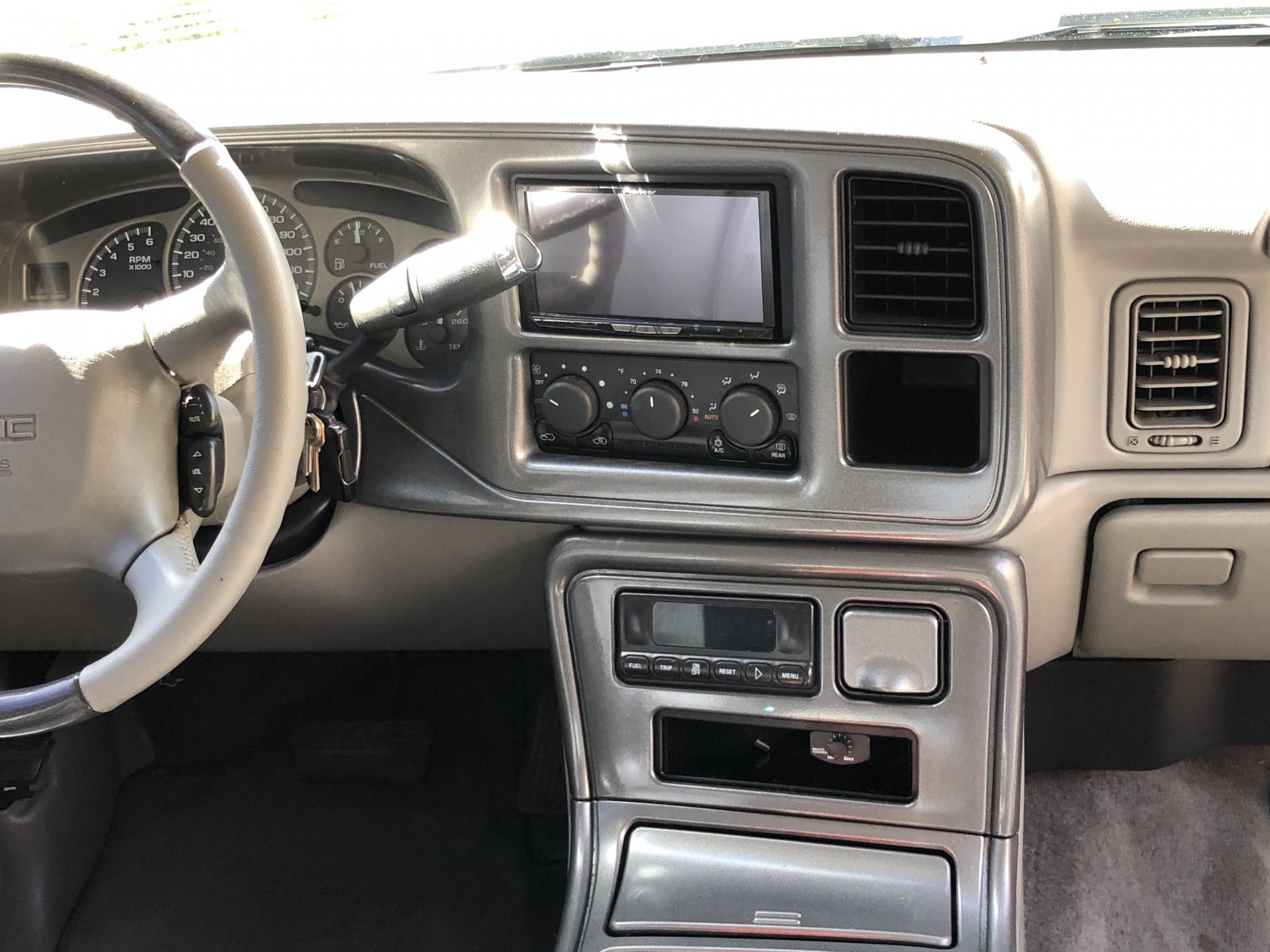

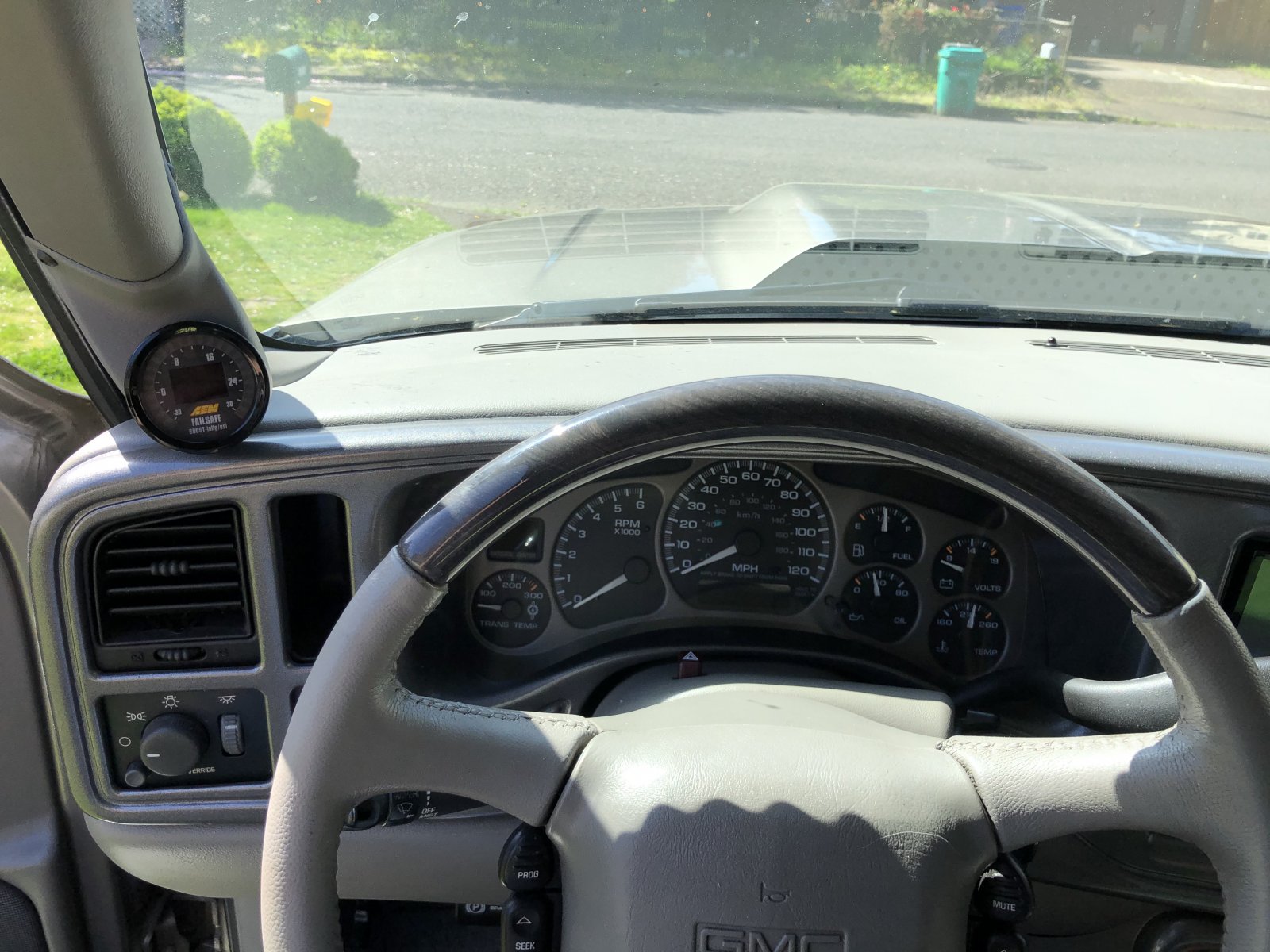

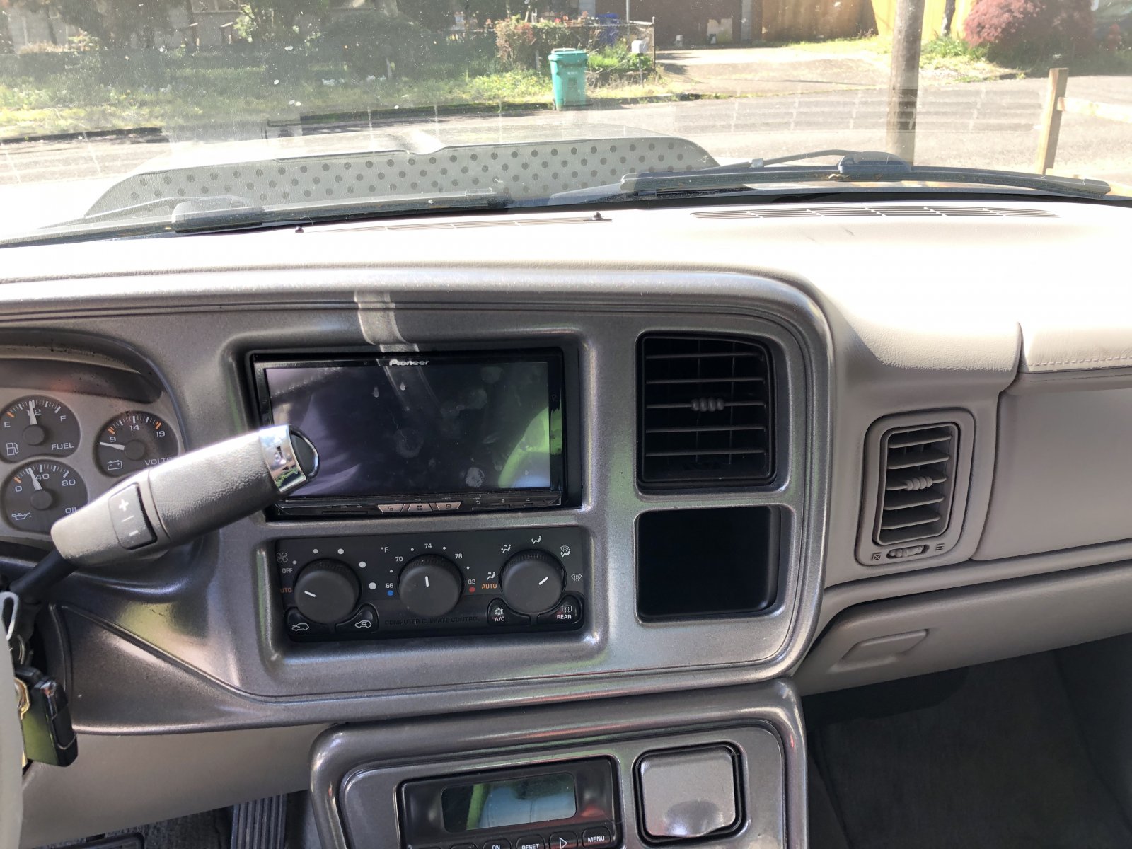

On a better note....the dash bezel looks great. So much better than the wood grain. I deleted the phone mount and ordered a pocket for that spot off EBay.

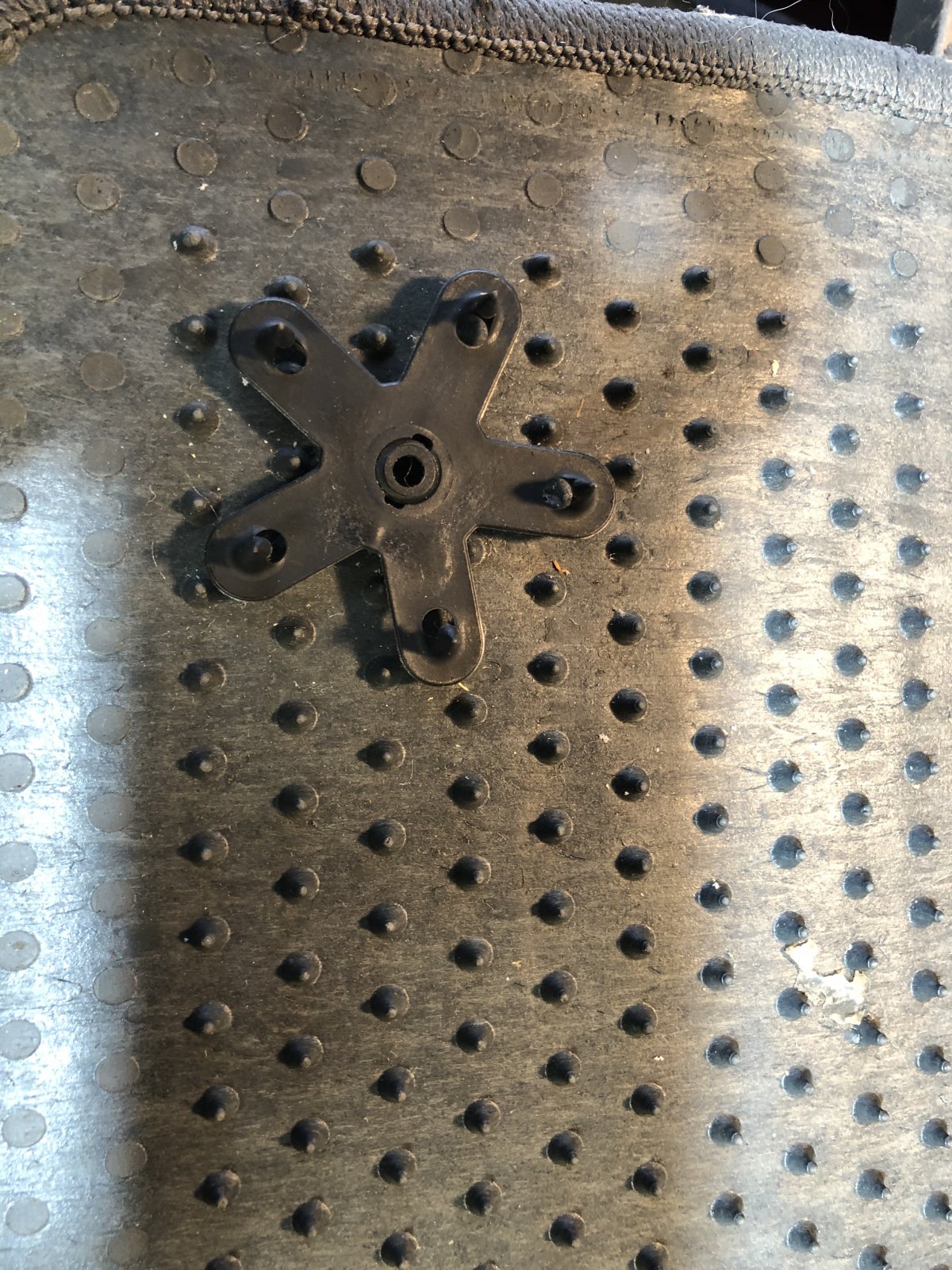

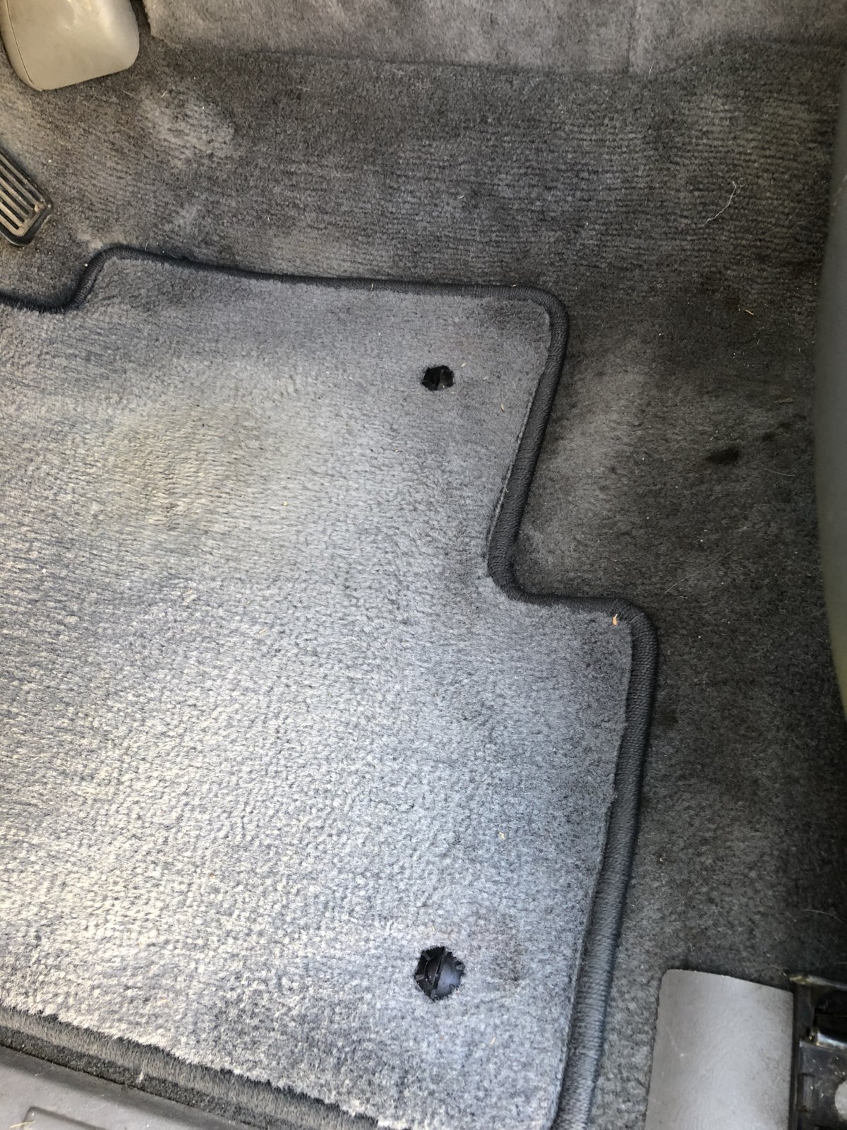

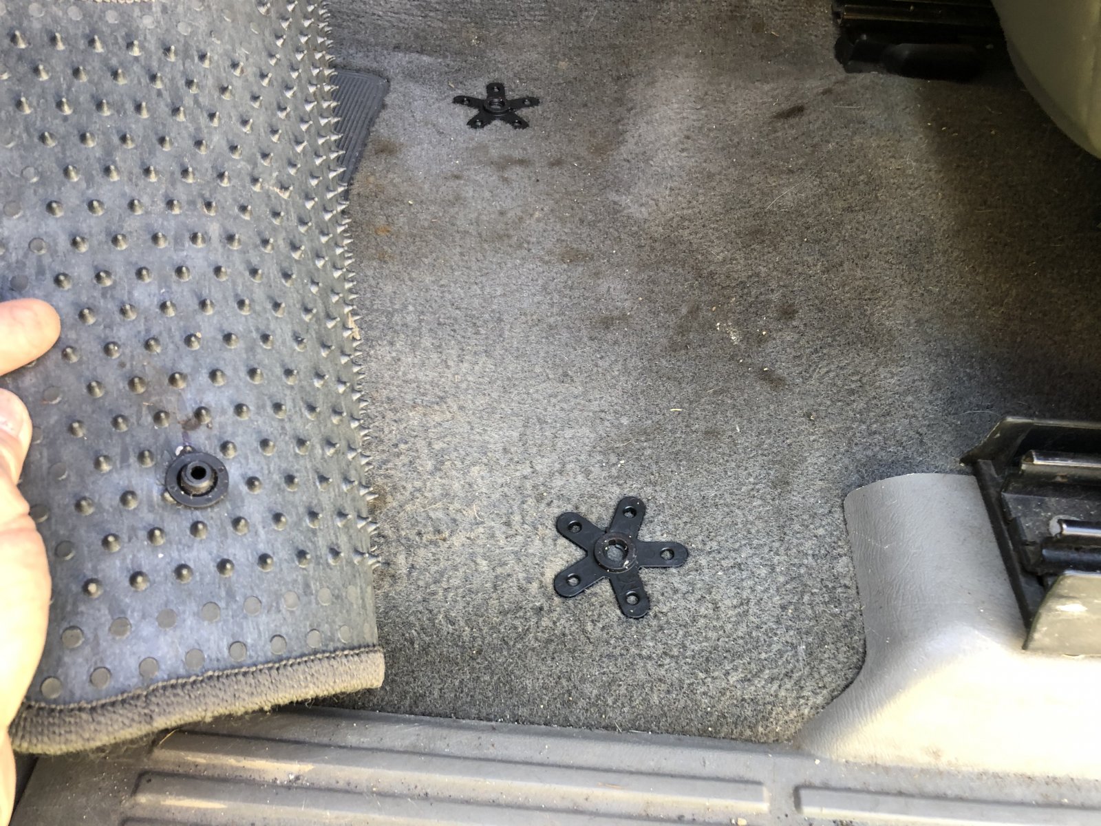

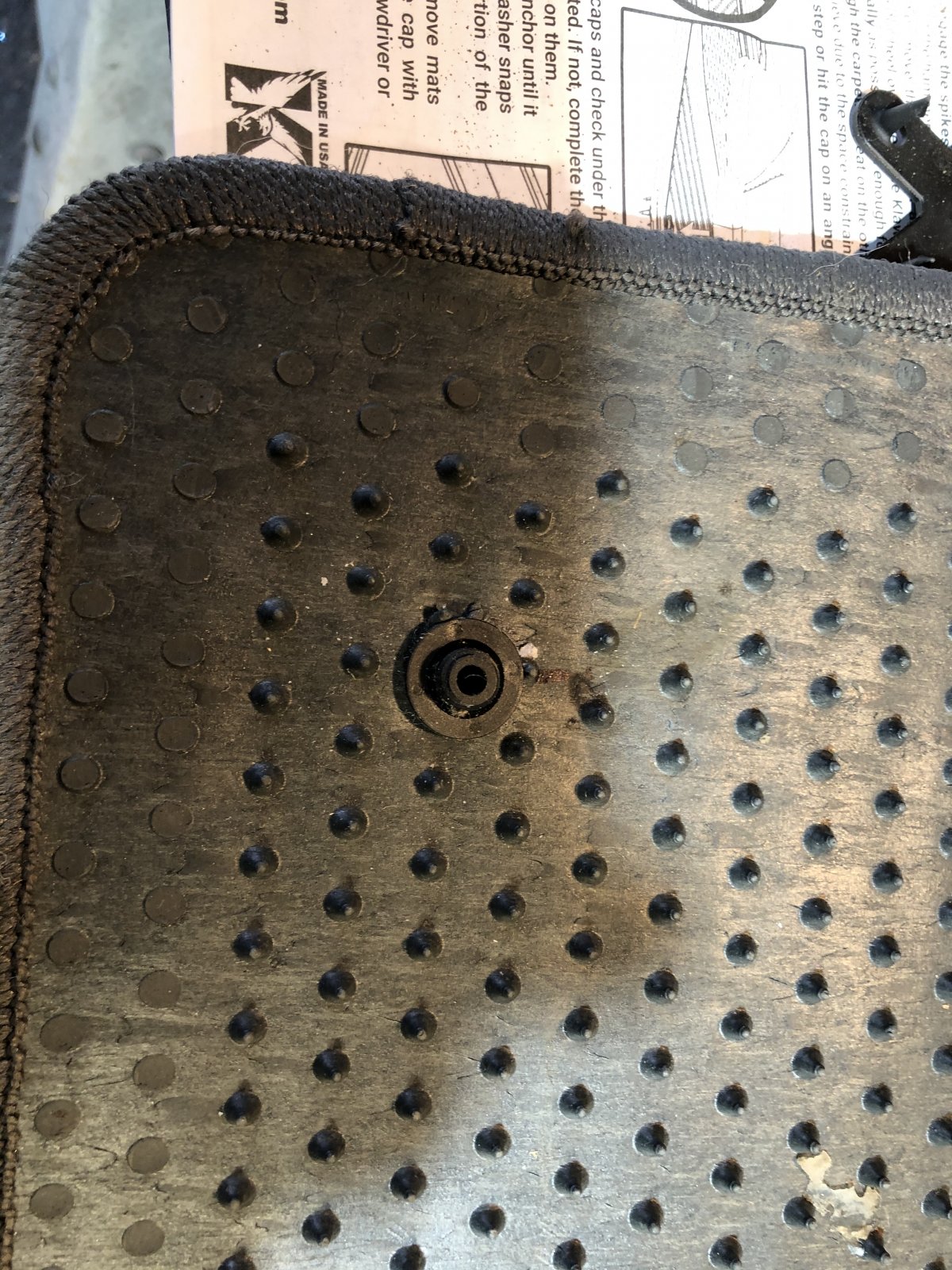

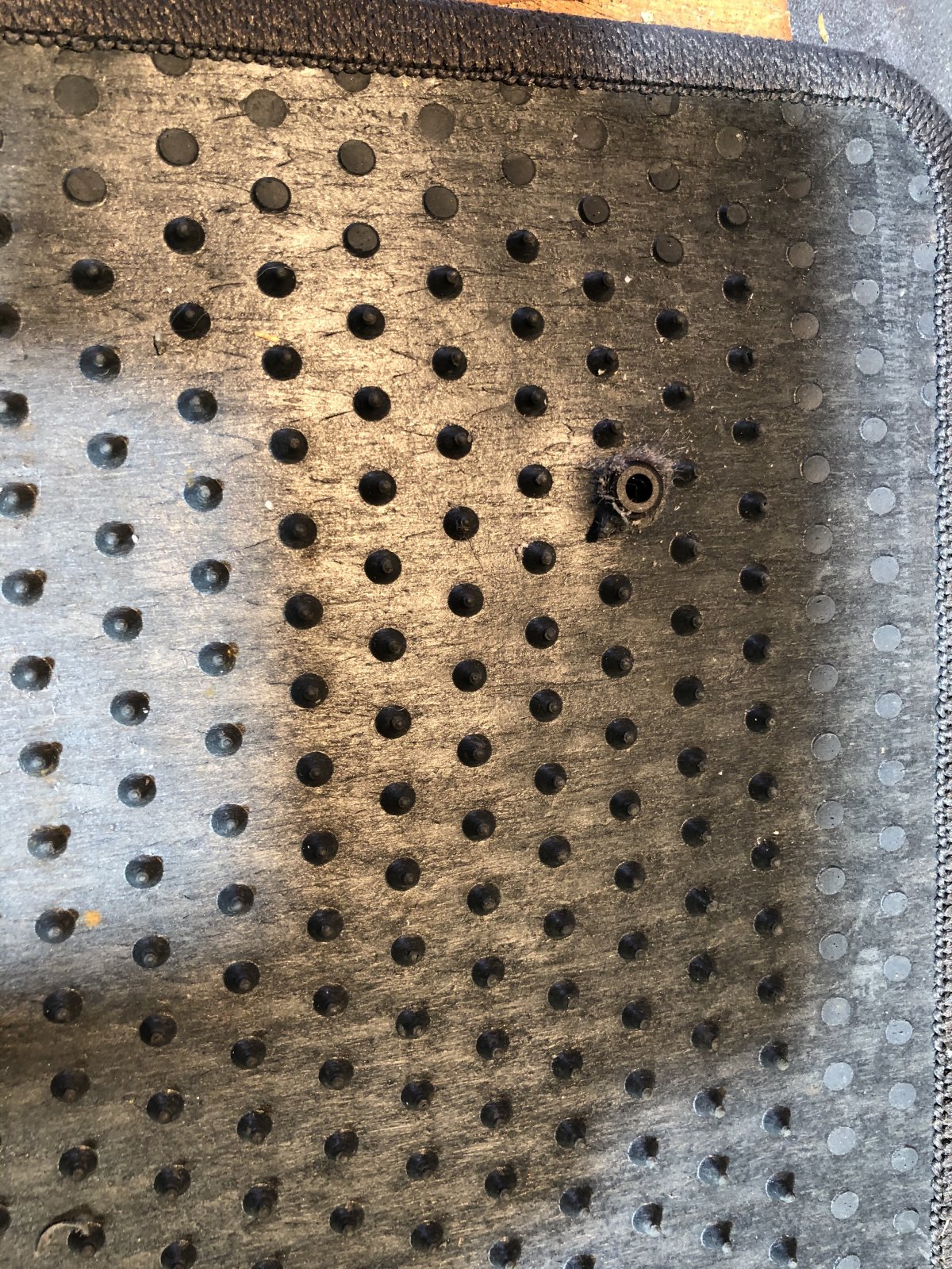

Also I’m going to do a little product endorsement. My floor mats, especially the driver one, slide around. They always drove me crazy. The driver was terrible because it has the plastic heel pad ( I should have deleted it when I ordered the new carpet) and that caused that mat to slide like crazy. Every damn time I got in and out it would slide. I saw the Eagle Klaw holders online and ordered a set for 2 mats. These things are awesome. You install one part in the mat ( you have to cut holes for them to attach through, I used a drill) and then screw the claw part on, then position them in the truck and either stomp on them or use a dead blow like I did, then unscrew them and lift the mat to be sure the claws ********* the mat and pad. Then screw the mat down onto the claws. It actually pulls the mat down into the carpet a bit. These things aren’t moving. You just unscrew them to vacuum and then screw them back on when you’re done.

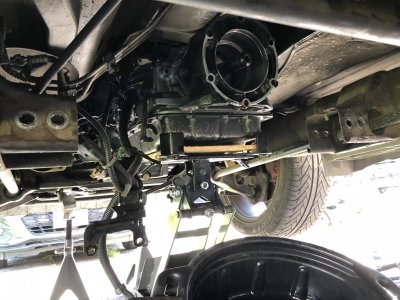

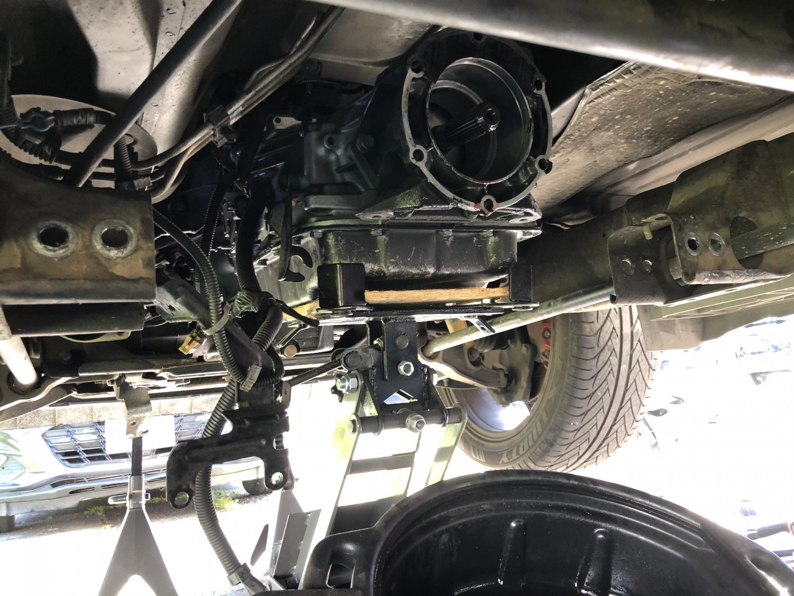

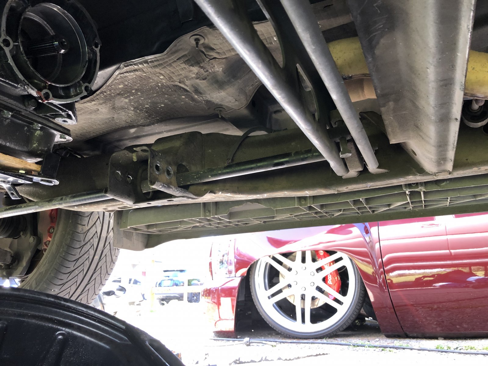

It’s boxed up and UPS will come pick it up this afternoon. Performabuilt said UPS has lost 5 transmissions this spring since the virus shit started and told me to insure it so if they lose mine they will pay for a new one. I insured it for $5k. I hope they lose it lol.

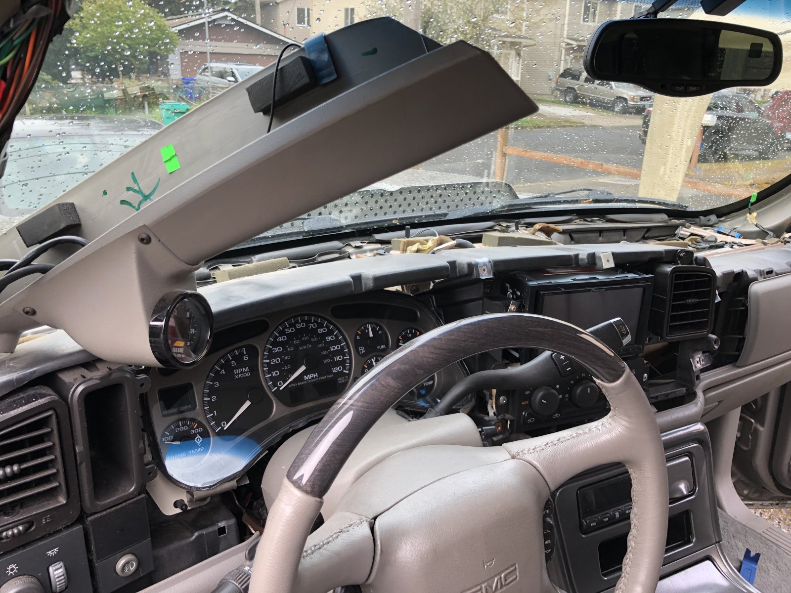

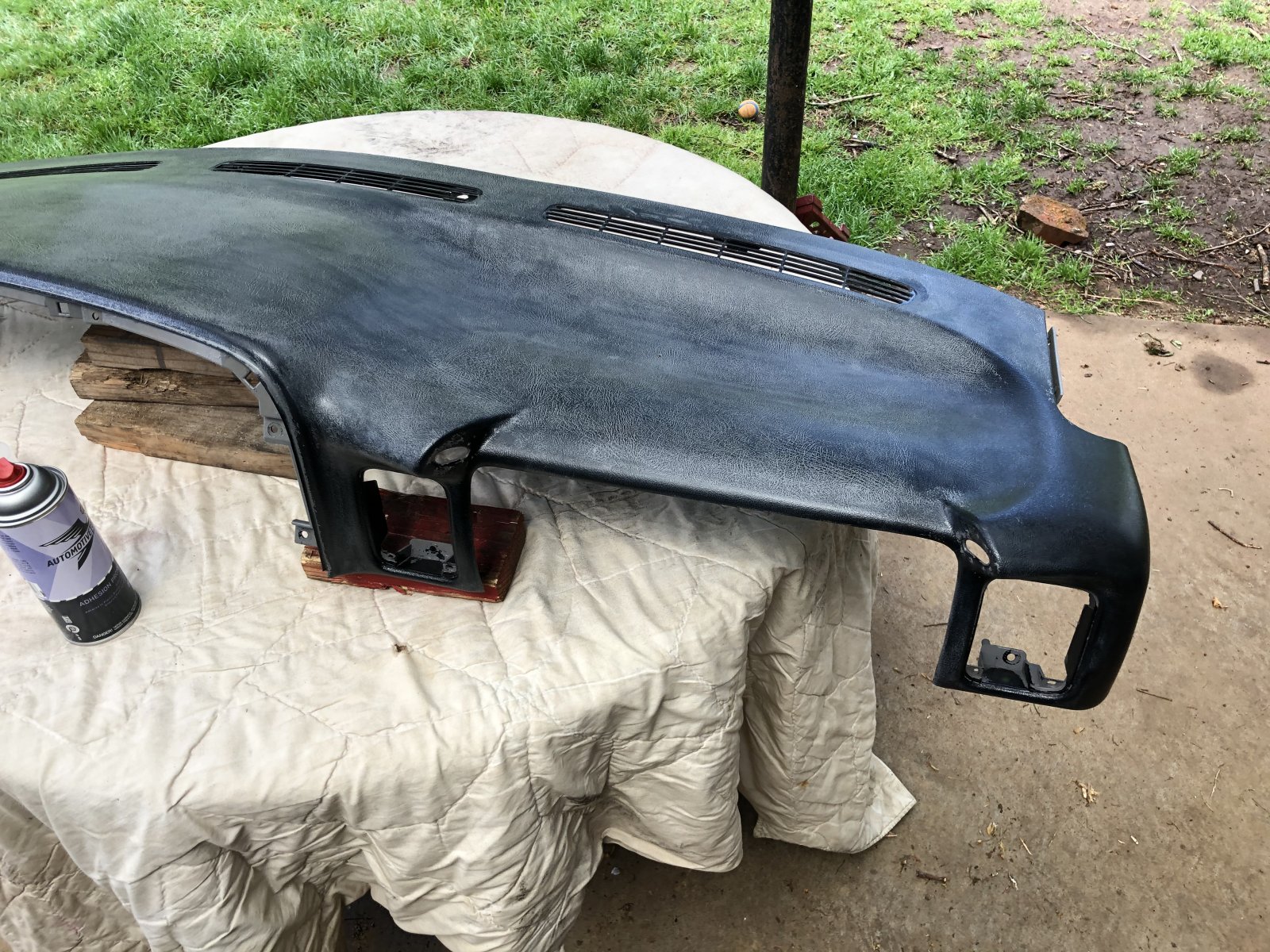

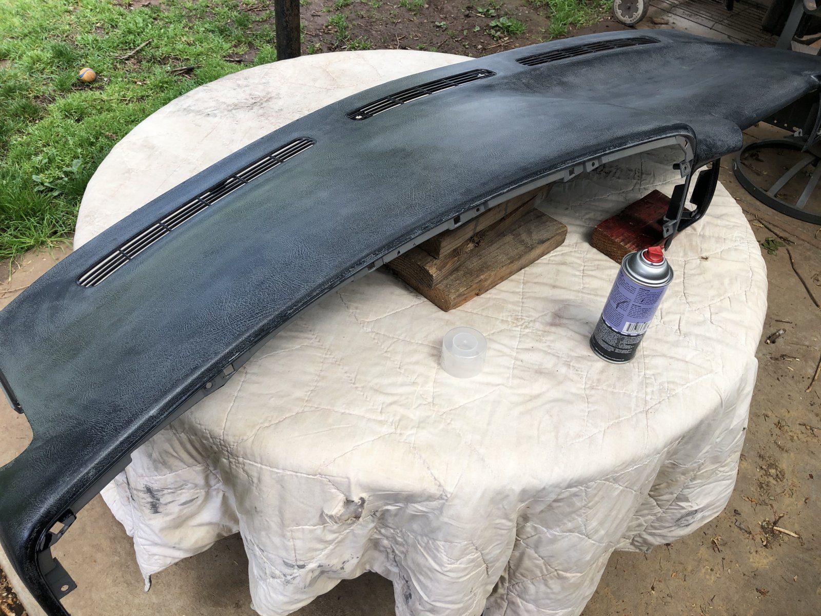

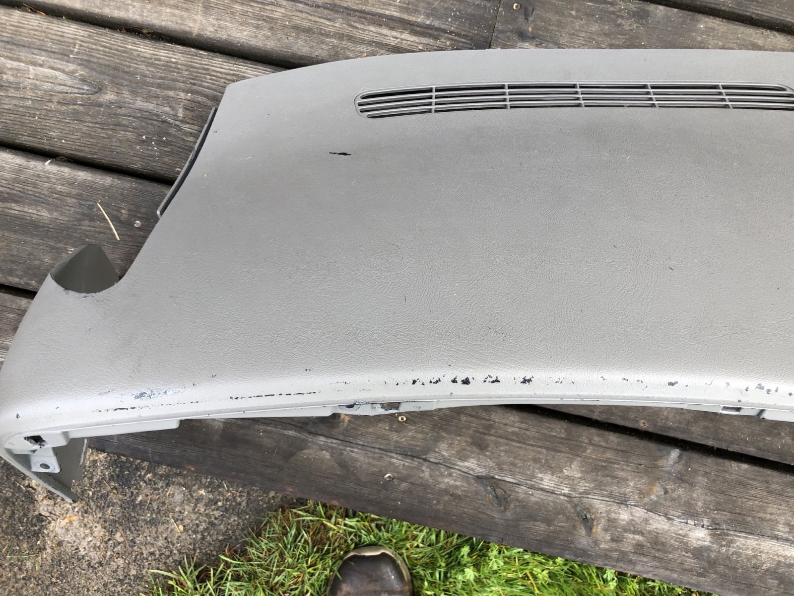

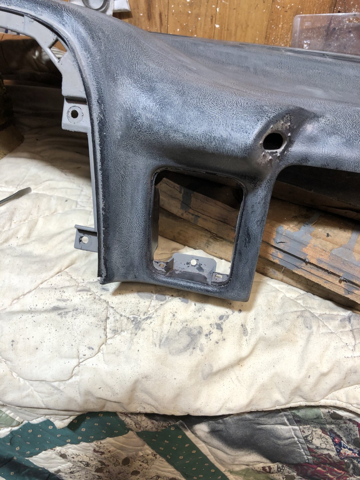

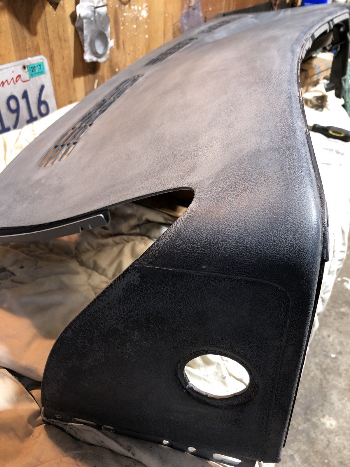

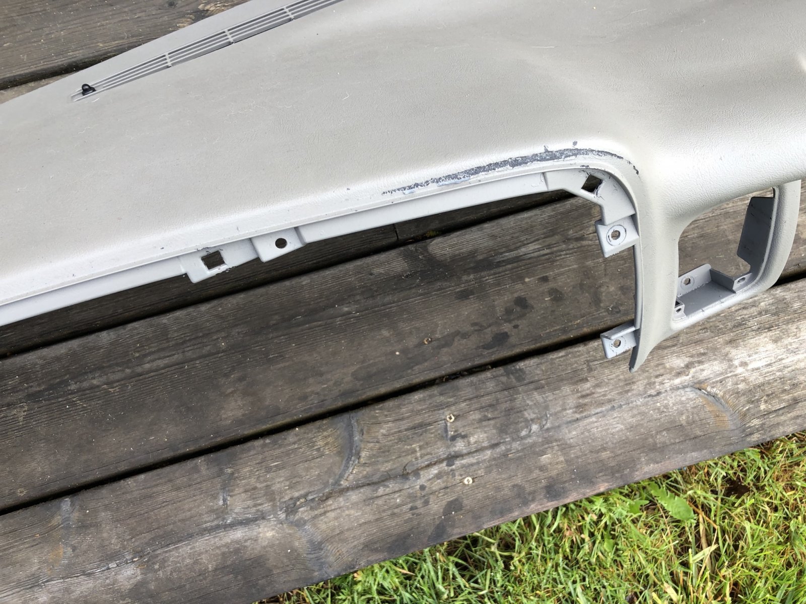

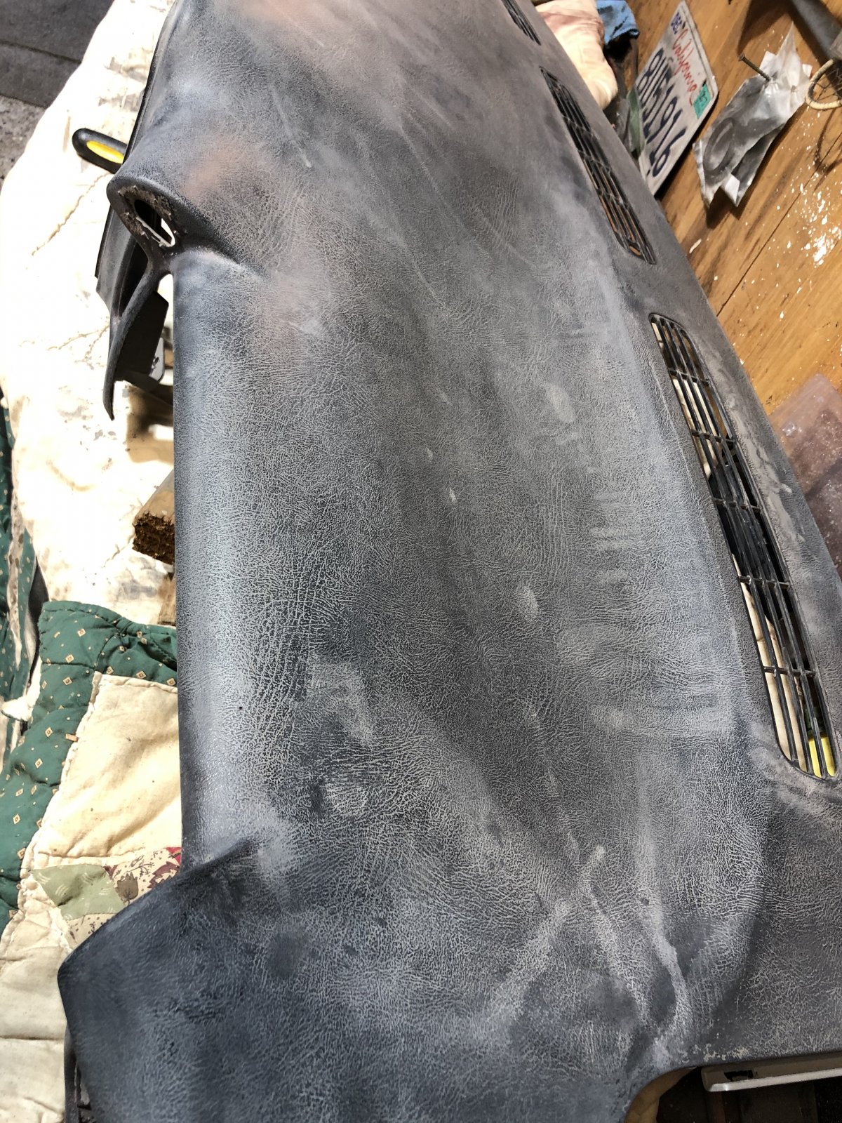

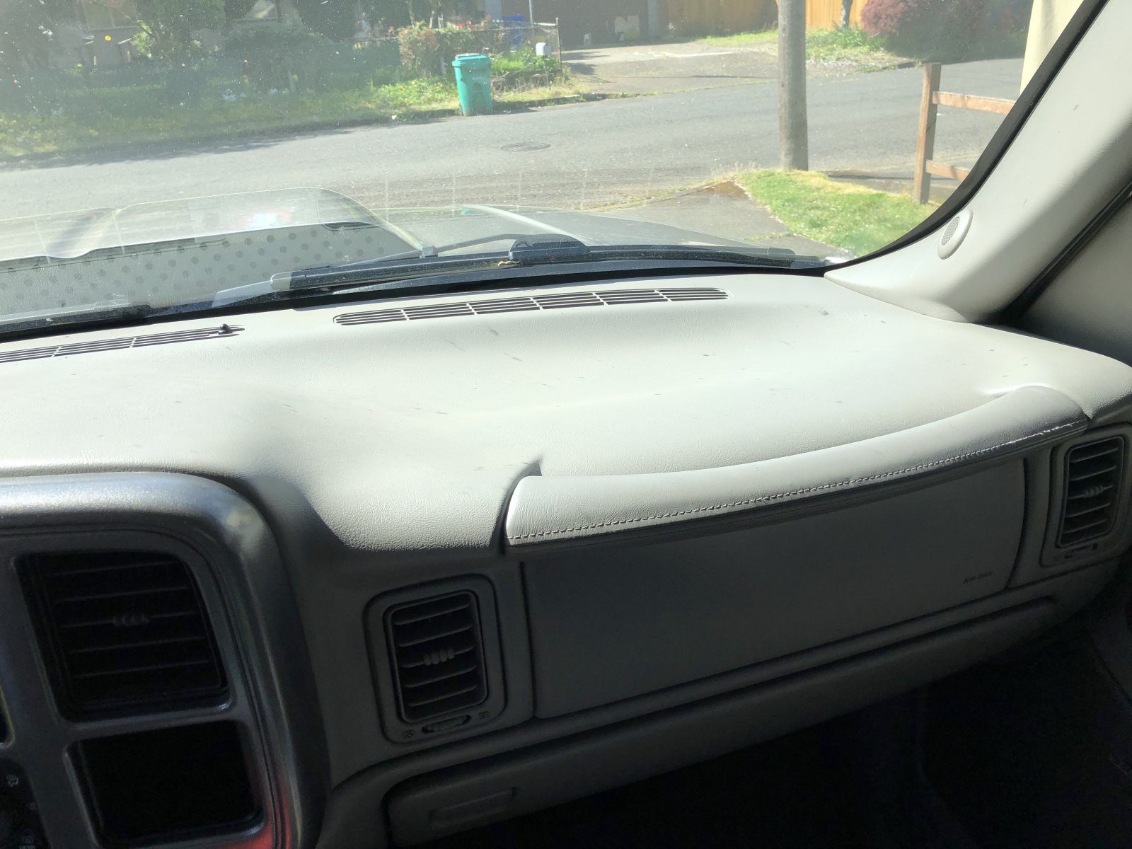

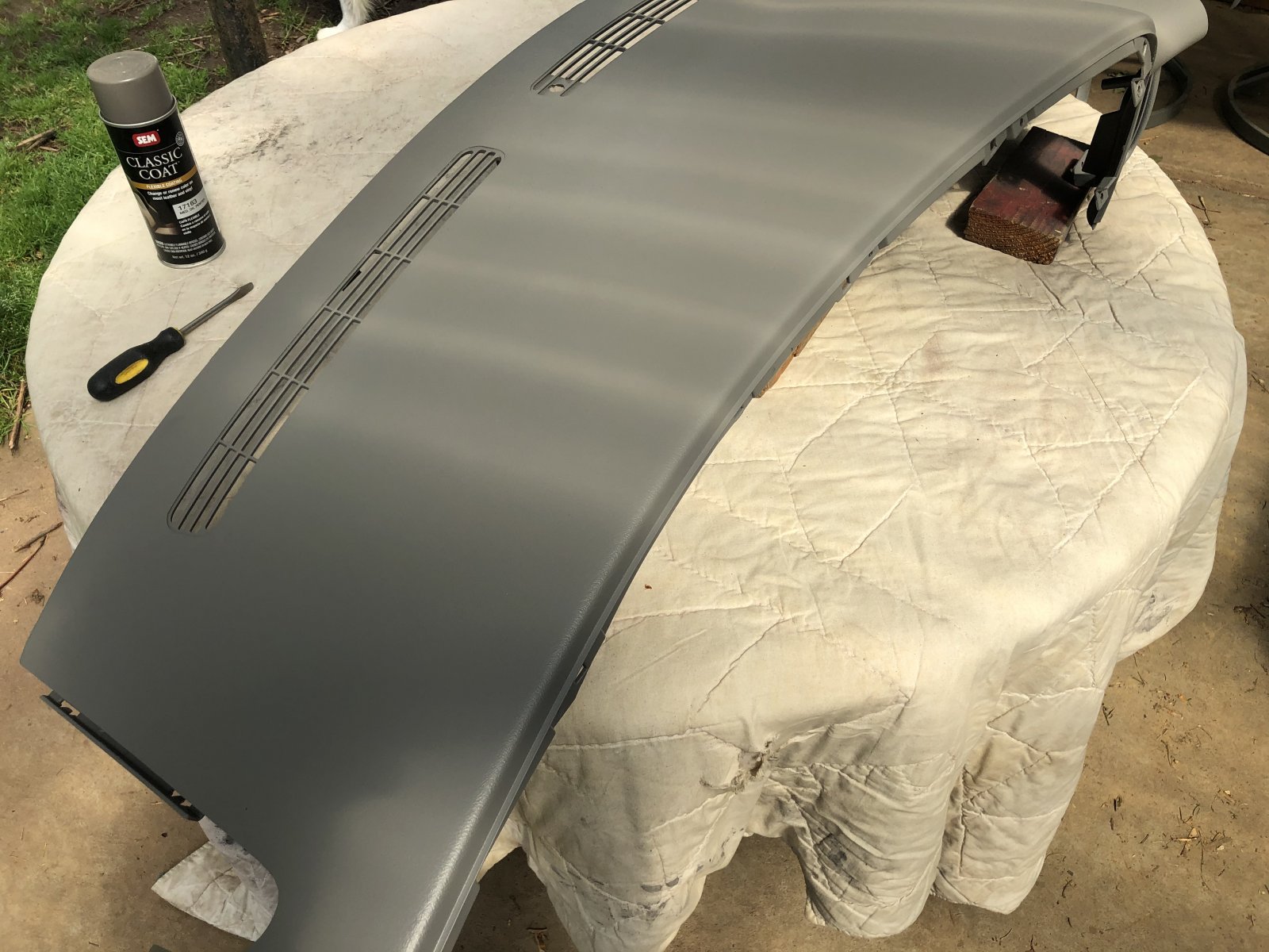

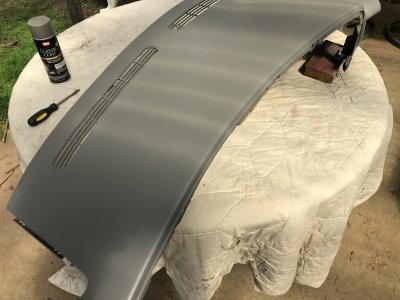

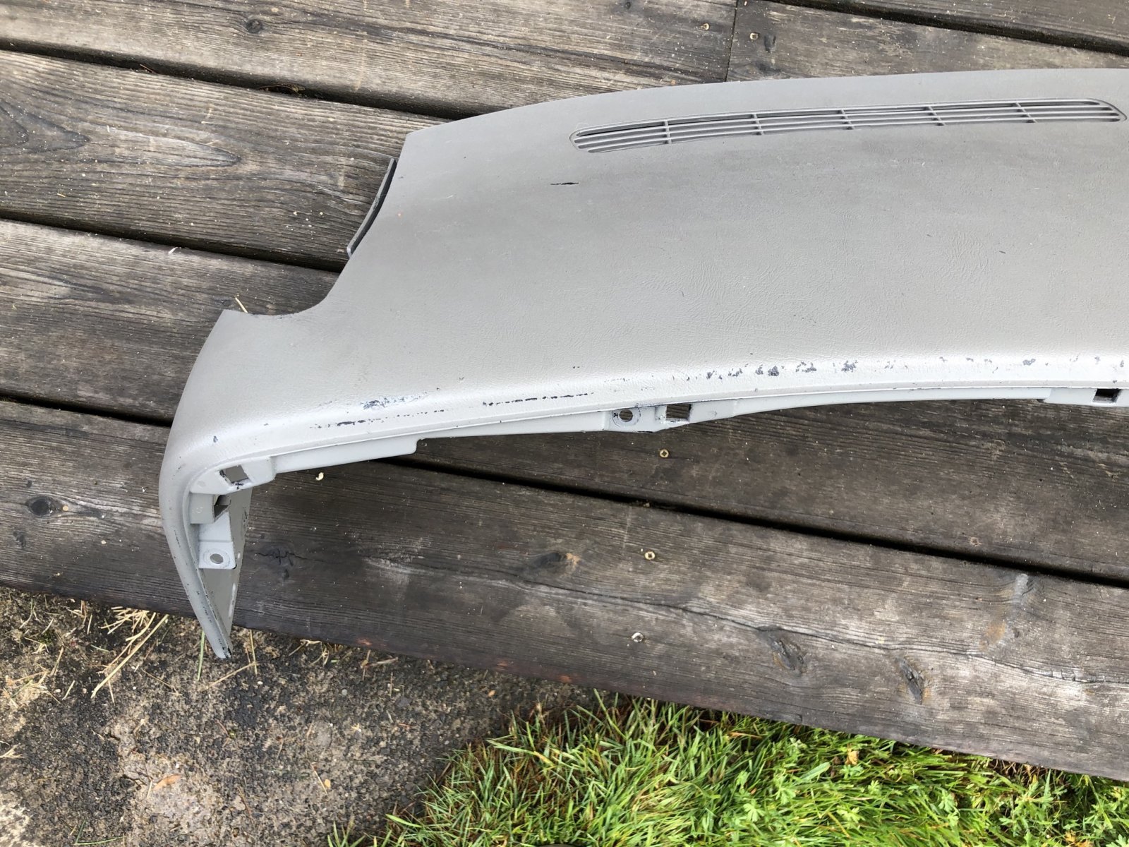

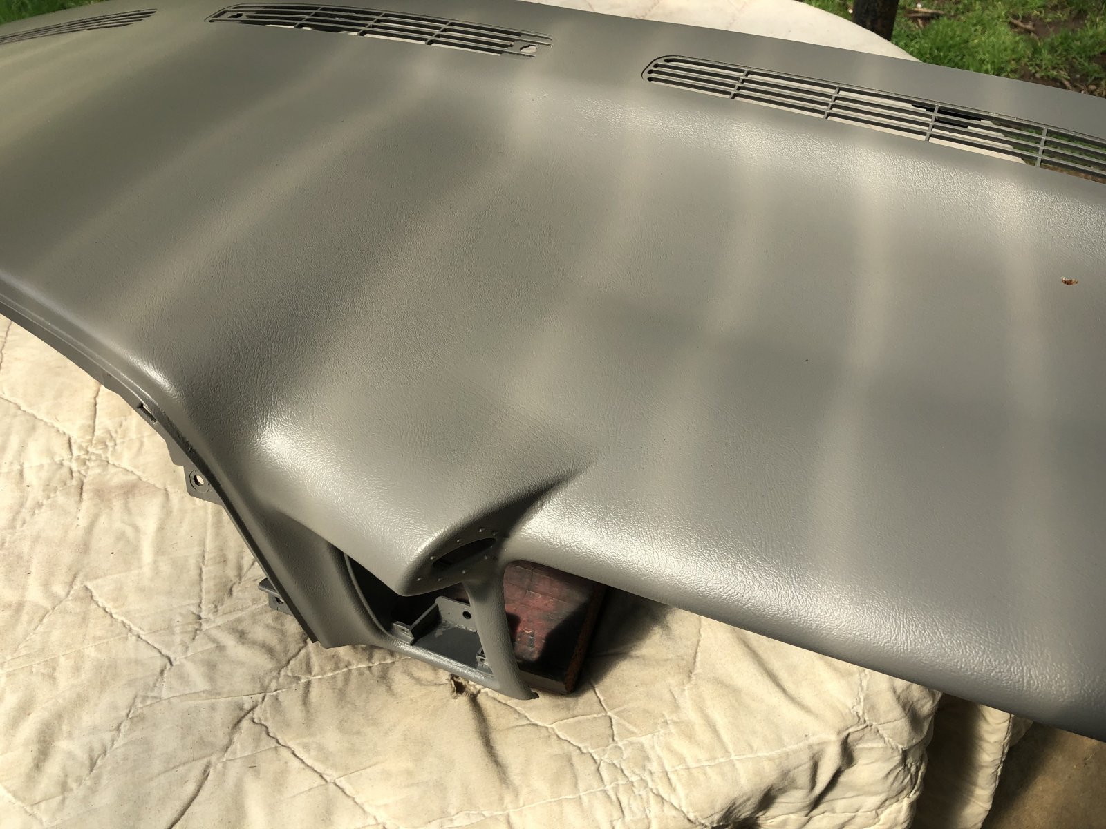

Pulled the dash to repaint it. The first time I did it lasted pretty good but the area where the main bezel touches it is chipped and since I painted the bezel I want the rest to look good. The SEM paint is being delivered today. I can’t believe how easy these dashes are to remove. It took about 10 minutes. The NNBS take about an hour.

Wanting to know if you sanded it all by hand or did you use a sander? Seems like a lot of tedious work!
52,949
I didn’t sand it. I used maroon (fine) scotchbrite and lacquer thinner, then wipe the dissolved paint up with paper towels. It dissolves pretty quick. The main areas go pretty fast but the grooves and screen parts are slow. It has probably taken about 3-4 hours. If I was to sand it, that becomes tedious because you’re removing the texture and you have to sand it out perfect. And I don’t like that smooth look.

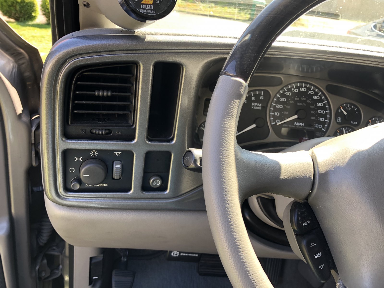

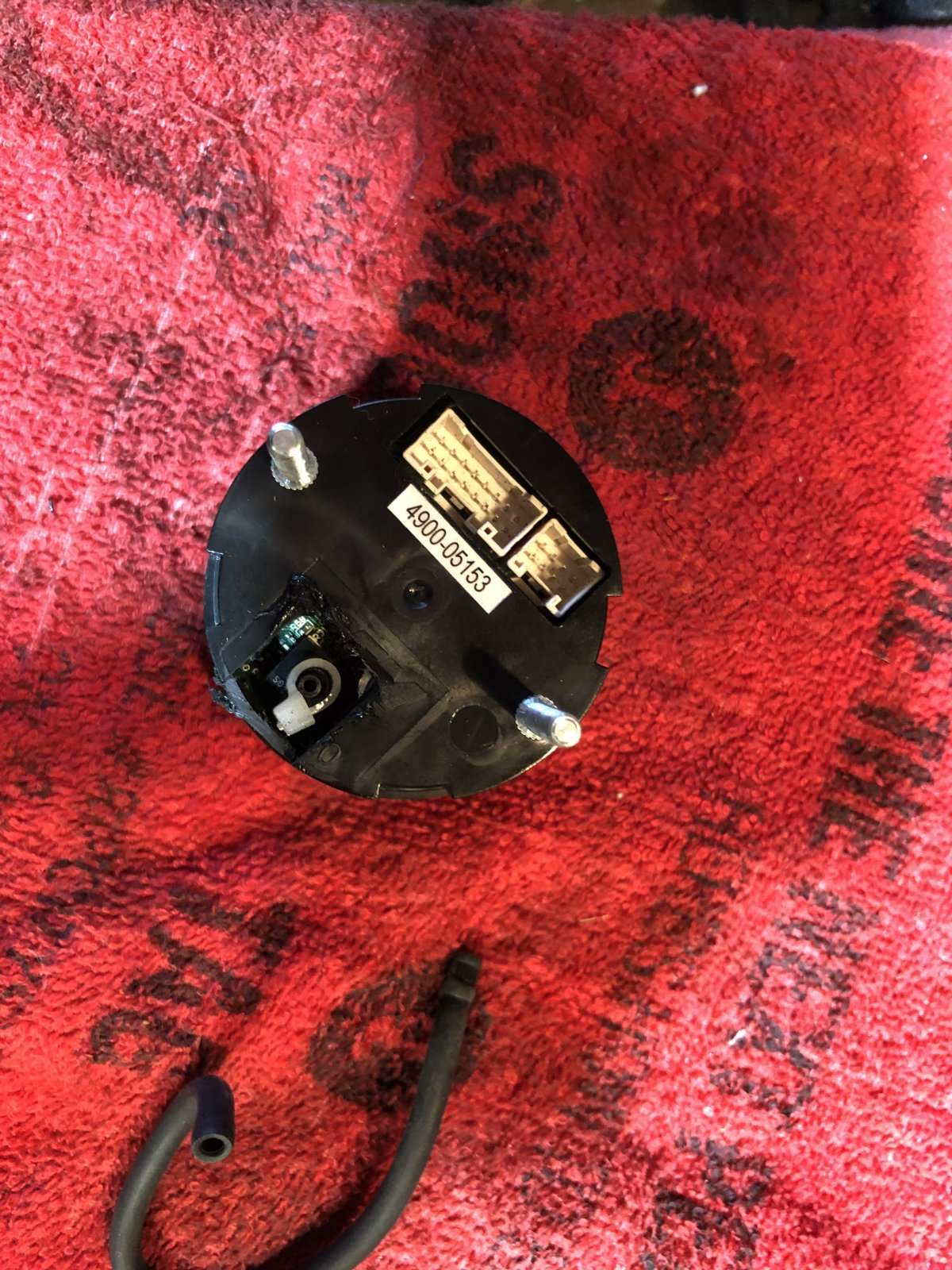

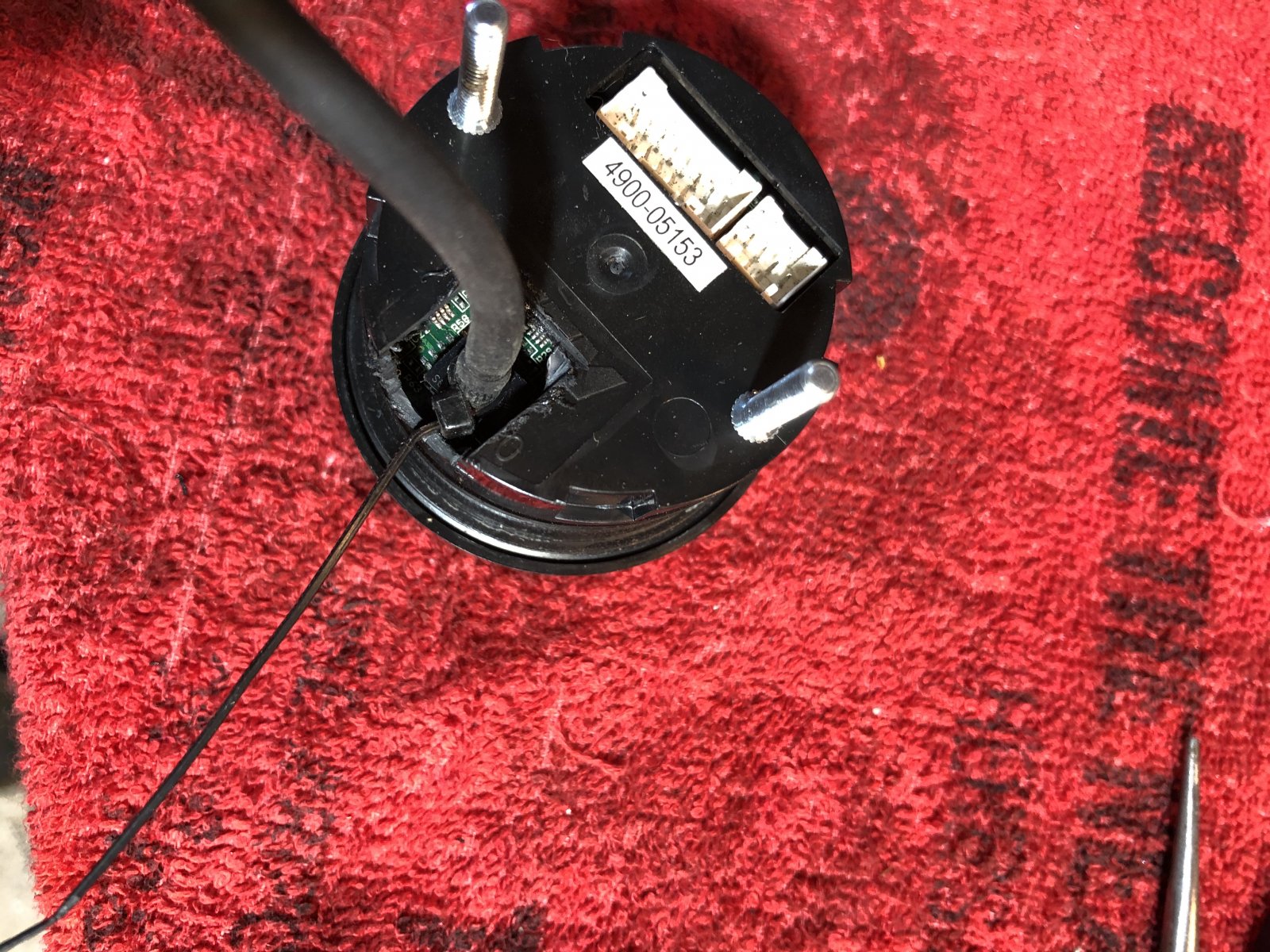

I pulled my afr/ boost gauge off so I could repaint the pod and pulled the vacuum line off the back of the gauge instead of separating it at the barbed connection a few inches down the line. Oops. It was attached INSIDE the gauge back and I could hear the zip tie rattling around in there so I cut an access hole in the back and reattached it.
